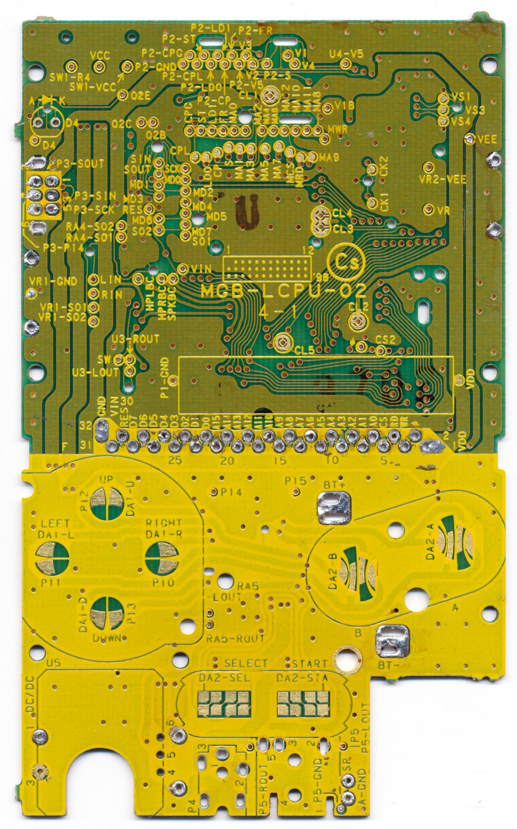

ooh nice one. if poss, can you trim off as much superfluous board from the bottom below the start select buttons so I can get 2 copies on a 100x100mm panel? (a height of about 48/49 mm would be perfect. enough to fit some mousebites between them)

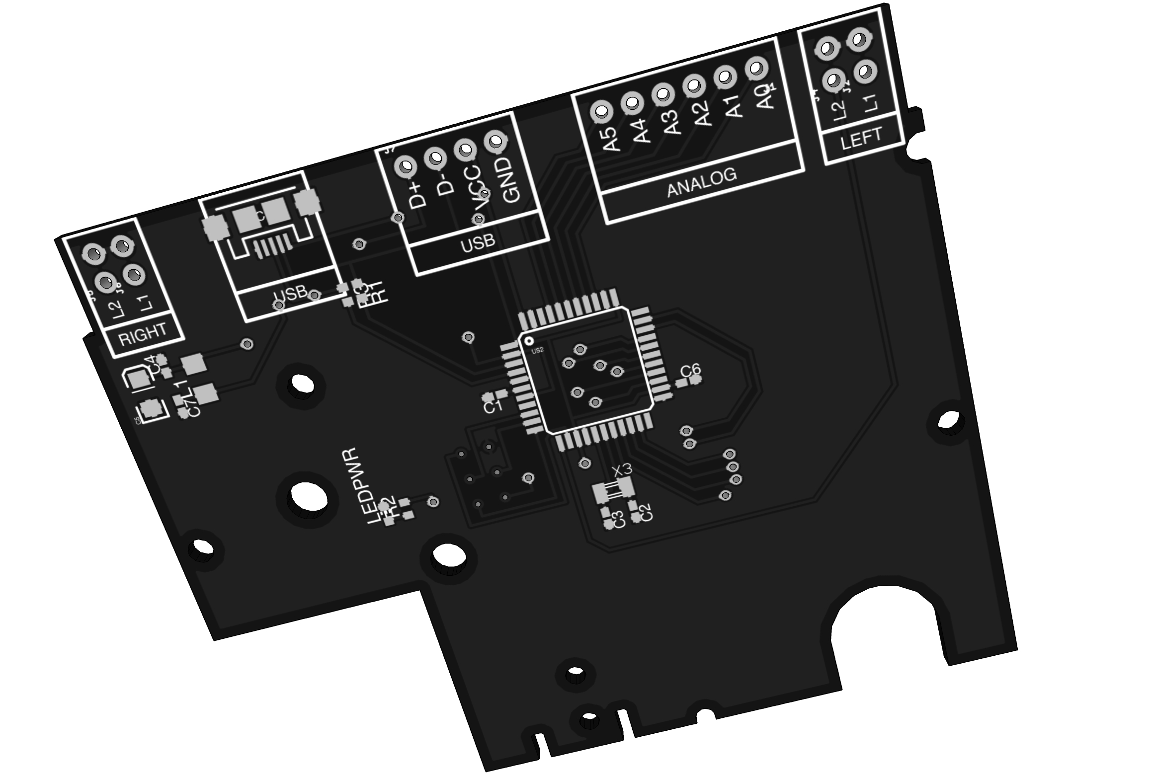

Hey,
apologies for the delay.
Finally had some time and updated the files in my https://github.com/32teeth/GameboyZeroPocket

Nice. I'm tempted to do a project with this instead of the GBA one I'd been thinking of...
I'm curious what the micro USB port is for. Connection to the Pi? Power? Are there solder points if you don't want to use the port?
EDIT: I bet it's for programming the Arduino, isn't it? That's a nice idea.

though I'm not entirely sure, but it looks like your button landing zones don't have holes in the soldermask...
If you mean for the 'x' and 'y' button, correct.
I've only finished the hand routing this morning ;P
reference
in the file above, you will notice that by adding the x and y buttons, you will lose the cartridge connection :(

no, i meant the main D-pad and A,B
I love the curved traces on the original PCB. really suggests it was hand "drawn"

abrugsch wrote:
Wed Aug 09, 2017 9:30 am
Indeed.
I removed a few of them, will put them back (they are the mounts from the inside of the battery pack (doh)

Post by 32teeth » Mon Aug 14, 2017 3:05 pm
Quick question for the folks out there
I added a solder mask with the break out sections identified
They are:
  • shoulder buttons (L1/2 and R1/2)
    USB native
    USB breakout
    Additional Analog Pins (usable if you need to do something else
Your feedback
Would you like to see
  • Analog Breakout for Analog sticks?
    USB breakout with D+/- or Green/White (wire color instead of intent)
Let me know your thoughts
GitHub updated as well

That looks great! All those features in a PCB would make it much easier to cram into the smaller shell. I was hoping for just a generic button PCB.
