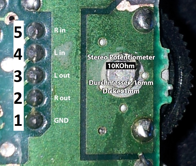

dirtybeagles wrote:Looking at your picture and looking at your diagram, I am not seeing where you soldered both AMP GRD to the Switch B on the headphone jack? Also I do not see your USB Sound Card GRD either?
Now with labels! See if this helps...

Cannikin wrote:Now with labels! See if this helps...
Is there and reason you used LIN (left channel on the amp) instead of RIN? I used RIN which is why I ask to make sure that doesn't matter in my connection.

I think I might have found my issue. After looking at your last post, I noticed on the GB Wheel you had your first connection going to L on the sound card. I saw this from someone else and it looks like it is backward for R and L.
I think the way it should be is
5 = L in
4 = R in
3 = R out
2 = L out
1 = GRD
Question though, why not ground the GB Wheel to the ground on the headphone jack?

dirtybeagles wrote:I think I might have found my issue. After looking at your last post, I noticed on the GB Wheel you had your first connection going to L on the sound card. I saw this from someone else and it looks like it is backward for R and L.
Well, you should be able to swap L and R without any problems, as long as you swap both 5 and 2, and 4 and 3. 2 is the output from 5 and 3 is the output from 4.
dirtybeagles wrote:Question though, why not ground the GB Wheel to the ground on the headphone jack?
So if you leave off the ground it acts like a "rheostat" instead of a potentiometer. Even after reading this I'm not sure I fully understand the difference: http://electronics.stackexchange.com/qu ... a-rheostat
But when I was using my voltage meter to figure out how to wire up the volume knob I saw the resistance range from about 20 ohms to 9.5k ohms between 5 and 2. That gives a pretty wide range for volume so that's what I did.
If you hook up the ground wire I think the range wasn't as wide...but I wouldn't swear to that: I'm not an electrical engineer, maybe someone else can explain the difference!
