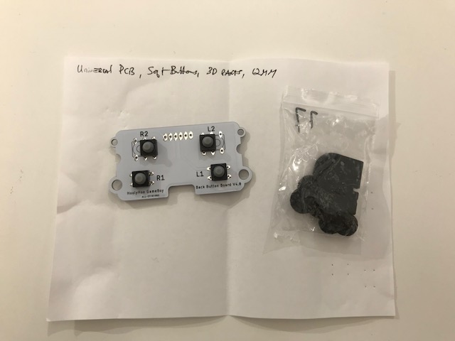

Universal PCB, Soft Buttons, 3D Parts for DMG Caps
and
Universal PCB, Soft Buttons, 3D Parts for 12mm Caps
It doenst say.
Im tempted to buy but would love to see how the two looks like.
One comes with 3D parts for use with original gameboy buttons (DMG), the other comes with 3D parts for use with the 12mm extruded buttons. The PCB’s and soft switches are the same in each kit, meaning if you got one and changed your mind on the specific type of buttons caps you want to use, it’s as simple as having HoolyHoo send you a couple of 3D printed pieces.
If I understand correctly, those 3D printed pieces are just to close the hole on the bottom of the button caps so the soft tactile switch underneath can be pressed. Just two different types of hole plugs. That’s the only difference.
Please feel free to correct me if anything I said is inaccurate, HoolyHoo.
That sums up it perfectly!

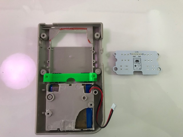

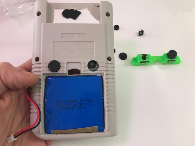

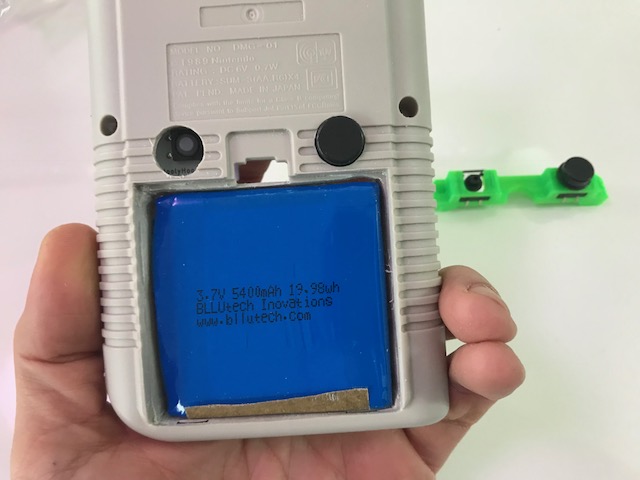

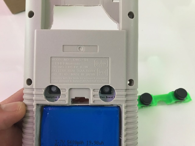

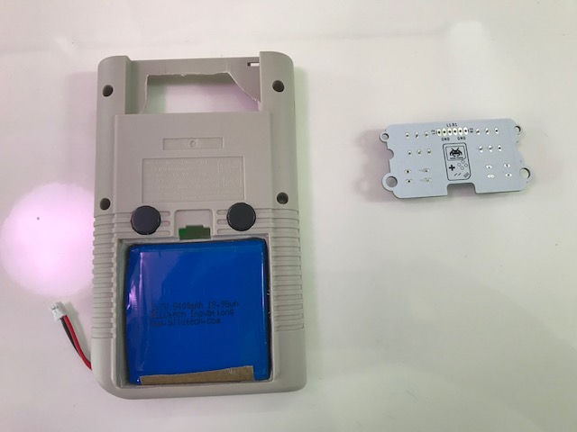

I can say this to you. I have already make the holes for eriks bracket and i hoped that Hollyhoos bracket will have the same alignment. But eriks bracket holes are in a lower place and hoolyhoos are bit more up. I can post later a pic.
EDIT: here the pics....maybe it works

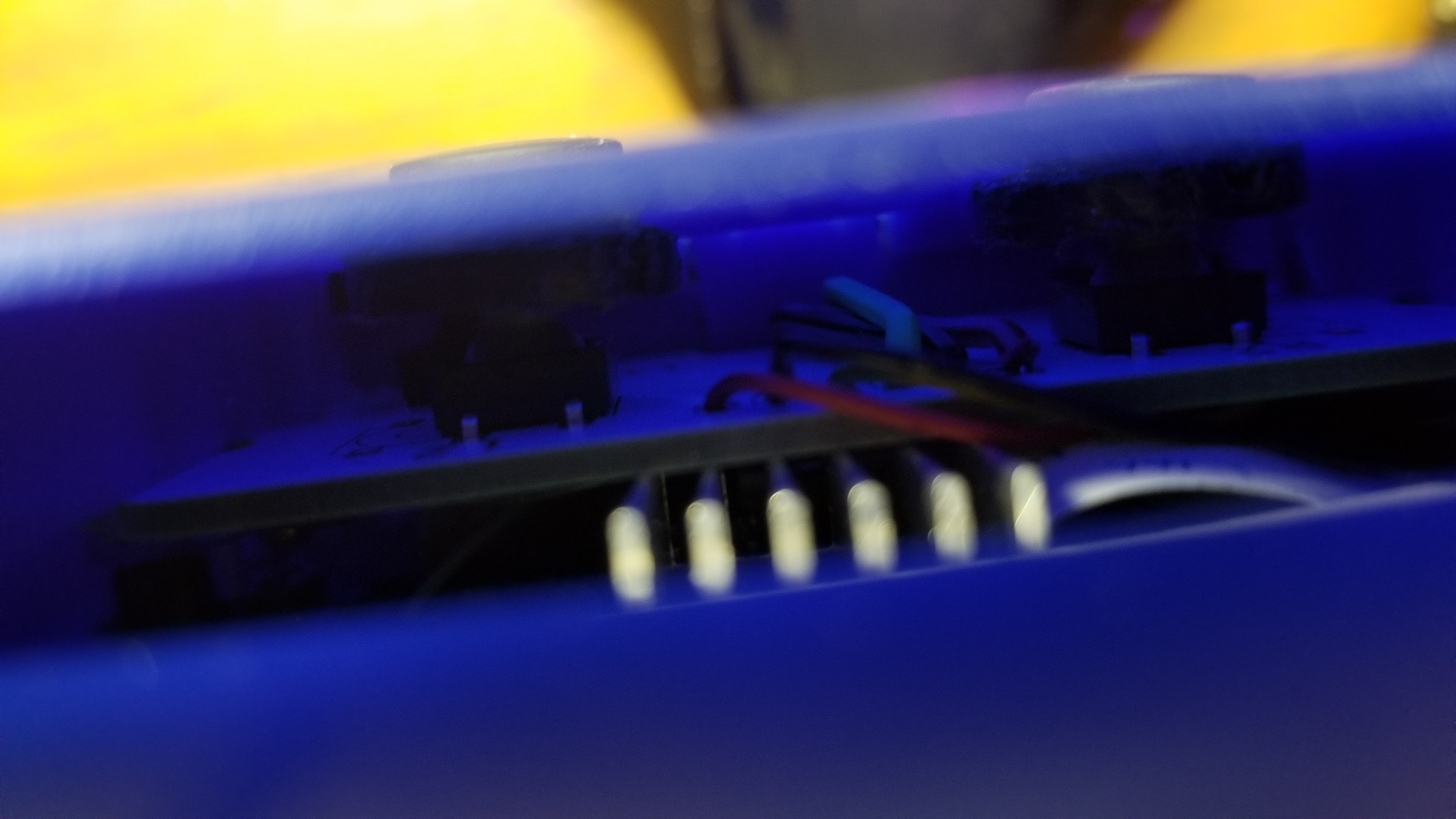

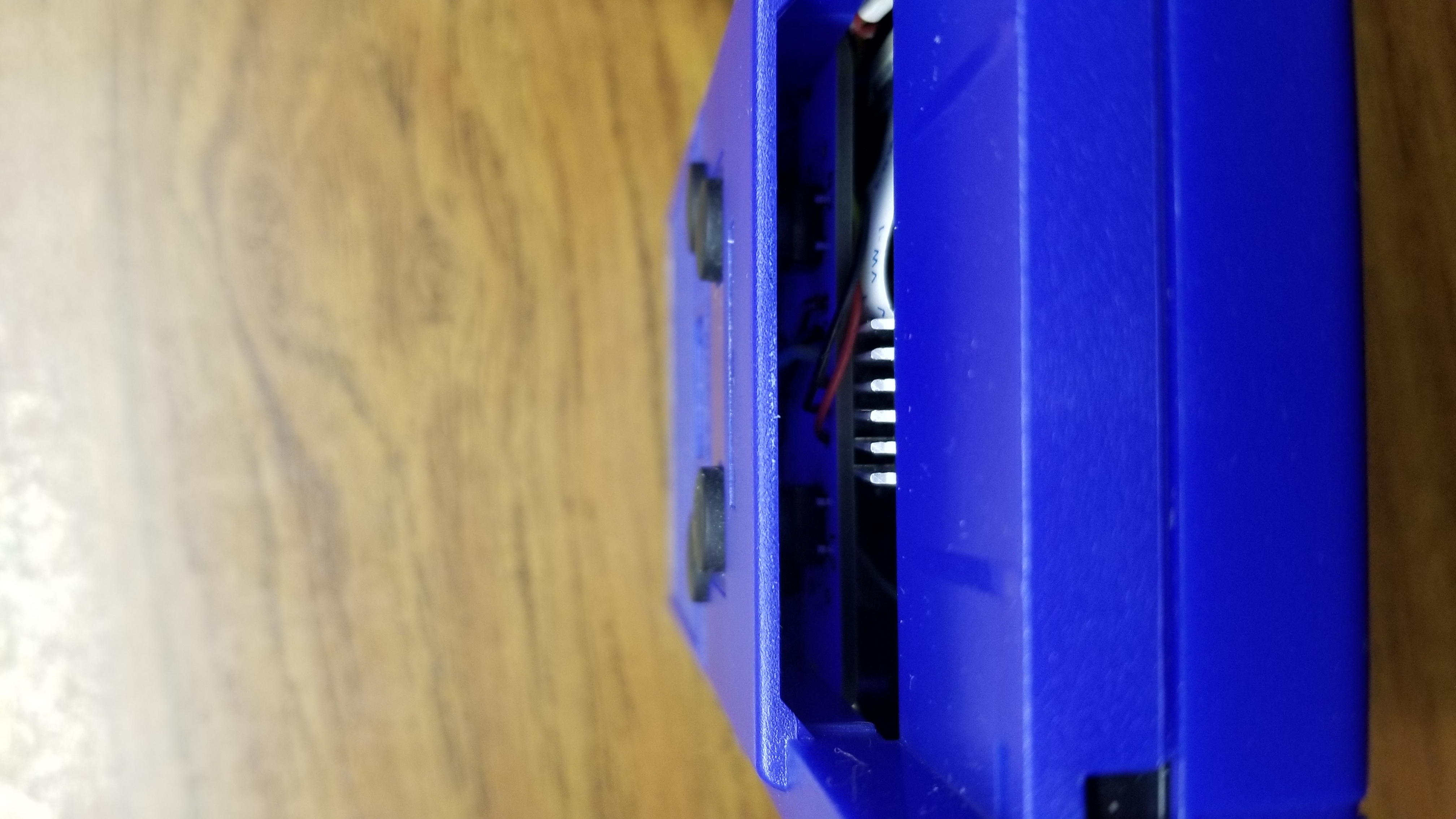

Post by gnarlynick » Fri Apr 13, 2018 8:14 am
Hey,
This product is awesome and allowed me to add L2/R2 in a sensible way to my Circuit Sword build.
As a note for anyone else using the Circuit Sword with the included heatsink, this backboard and the heatsink on the CM3 come in contact on my build when the shells are closed up so I would assume the same is true for anyone else making similar builds.
When I initially installed the backboard and fired it up to test I was noticing L1 only worked. After investigating, I found the other 3 buttons also worked when the system was opened but as soon as I closed it up, L1 only worked. I found out the solder point through-holes along the top of the backboard were right inline with the fins of the heatsink on the CM3 and were causing shorts. I simply covered that portion with electrical tape (kapton tape may be more necessary since it is in contact with the heatsink) and all four back buttons were functional when my build was closed up.
Just an FYI for anyone else who may experience shorting issues, there's a simple and quick fix.
