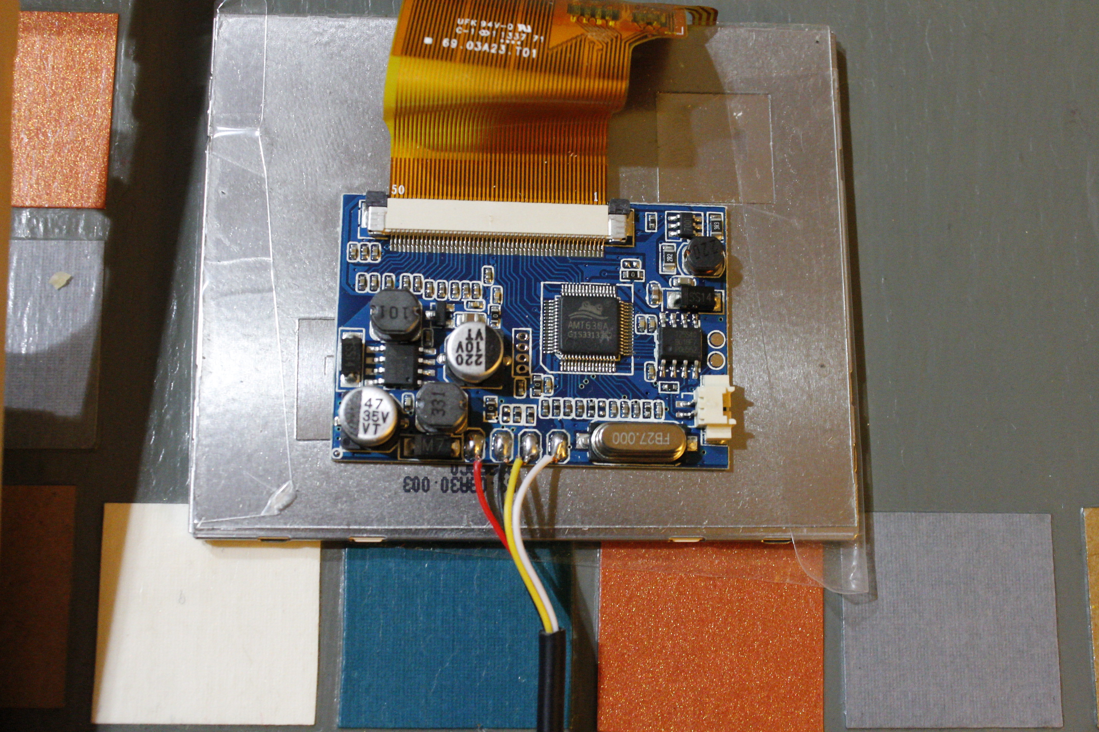

I ordered another because i damaged my first board that was the same as yours. I ordered the same model from the same supplier but it had a different board. No mod was required with my new board. Very glad because that ic removal is a nightmare

Robots86 wrote:I ordered another because i damaged my first board that was the same as yours. I ordered the same model from the same supplier but it had a different board. No mod was required with my new board. Very glad because that ic removal is a nightmare
Bw Corp? Got a picture of your board?

This isn't my photo but its the same board
Yeah it BW sold by BW corp amazon uk with prime delivery

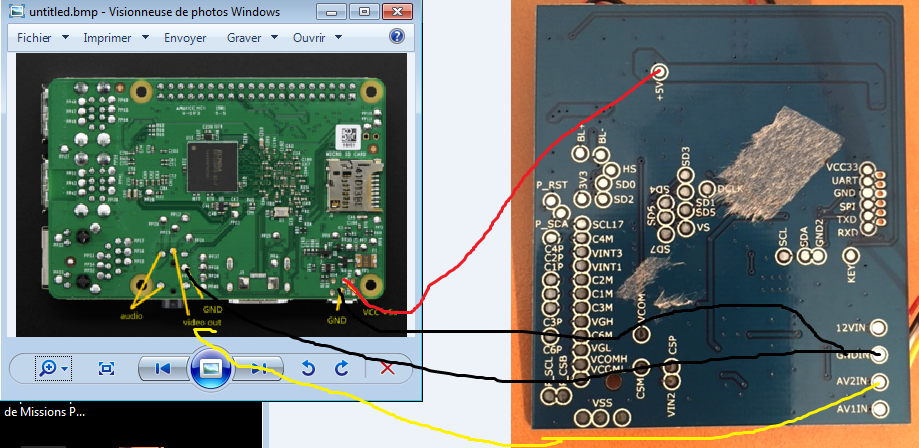

Could you confirm that I don t make a mistake If I do that for 12V->5V:
THANKS

m0rphman wrote:Hi guys,
I have a question related to this and maybe you can help me with it.
I got a similar screen from amazon and I want to try it out. The controller board looks like this:
I am aware that in order to run it on 5V I would have to desolder an IC but I thought it would be useful to test it out before I did any soldering. I used an old 9V/500mA power supply which I had lying around and wired up the RCA output from the PI (yellow wire to the "square" outlet, white wire to the round one).
Unfortunately the screen did not display anything at all. I was expecting at least to see the backlight turn on but nothing at all.
I have two questions now:
Do you think that maybe the amperage of the power supply is simply too low?
Do I need to adjust any settings on the PI0 to get composite output?
Thanks in advance!
I have this same screen. Any luck getting it running ? Reason I ask, is I wanna know what works for this screen in particular. I haven't tried anything yet cause I'm such a noob and I don't want to damage it. I've seen some connect the red wire to the ic on the bottom left or removed the top one.. Let me know what's worked for you

I tried using the 5V outputs from the pi0 and it worked fine when I was using a normal 5V/2A power supply for powering the pi. It worked without any soldering or other mods but it will only display anything if the video inputs are also connected to the pi.
However, when I was using a powerbank which usually should give 5V (I have not tested whether this is correct) the screen flickered. I am currently waiting for my powerboost 1000c which can generate 5.2V, so that I can try again. It is most likely a voltage issue which I hope to alleviate with the powerboost.

I had to do the mod to get the screen to work without flickering while powered off the powerboost.
