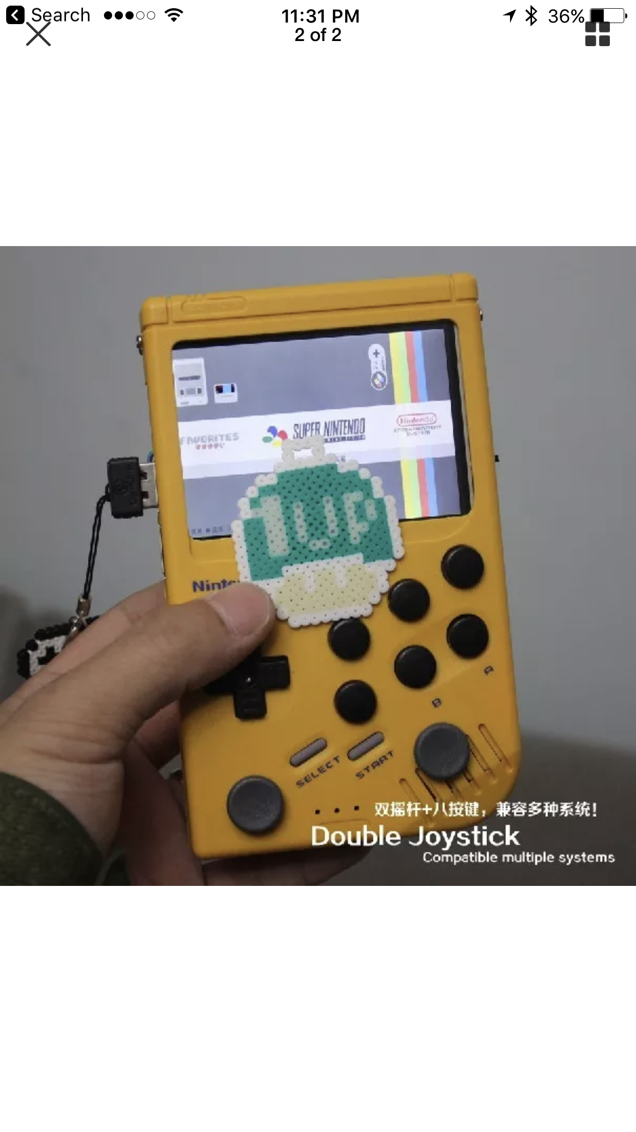

1up sent me a prototype today for what I asked for. 6 button and two joysticks. Looks ugly, but I think it will look much better in all black with black buttons. Good for ps1 and n64. Here's the pic. He quotes me 449 which isn't bad considering my GBZ's go for 400 on eBay with zero joysticks, 4 buttons and 240p. All the crap we order from china he probably gets for pennies local.

That's the worse looking GBZ I've ever seen
