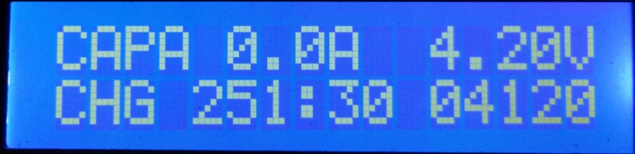

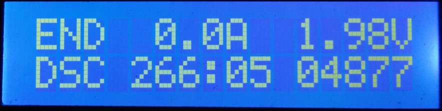

Ok people, numbers are in. Some look good, some less good and none match ones provided by manufacturer ( shocking :roll: ).
I did all test acording to datasheet provided with batteries - 0.2C charge current from empty to 4.2V and current drop to 0.01C, disscharge at 0.2C from standard charge 4.2V to 2.4V.
And results are:
End of charge test
Charge: 5383mAh
End of discharge test
Discharge: 4877mAh
Timing charging at 1.1A till 80% of average (of both) capacities
"Quick" charge till 4120mAh: 4h11min30sec
Still plan on doing few more tests with 1A charge current to match adafruit charger and with smaller diacharge current - I think gbz uses less than 1.1A.

Not bad results! So they appear a bit more like 4800mAh battery (picking the lowest discharge number).. that's still not bad! Makes you wonder what cells they actually put in there? Have you opened one up yet? Usually they have written on the cells themselves (seeing as there are 3x in yours) .. for 5700mAh they should be 1900mAh.. perhaps they are 1600mAh?
As for discharge, between 400-600mA (at worst) I get on mine, at worst that's 8hrs and best at 12hrs!

kite wrote: .. for 5700mAh they should be 1900mAh.. perhaps they are 1600mAh?
Nope, haven't opened one yet but I guess I will have to.
kite wrote:As for discharge, between 400-600mA (at worst) I get on mine, at worst that's 8hrs and best at 12hrs!
Yes I found your stats in one post so I have set new discharge test to 700mA...will see what happens :) But I think we are good for a days play by all means :o

I opened one pack and there it was...a bit of a problem. Cells inside didn't match tag on the outside. On pack it says 445256 and on cells is 405456. There is no info on capacity but it has to be less since used cell volume is 5.6% smaller.
Will have to talk with manufacturer about this.
I got 7hrs at 700mA. I think we are covered for flight over Atlantic with this baby :D
