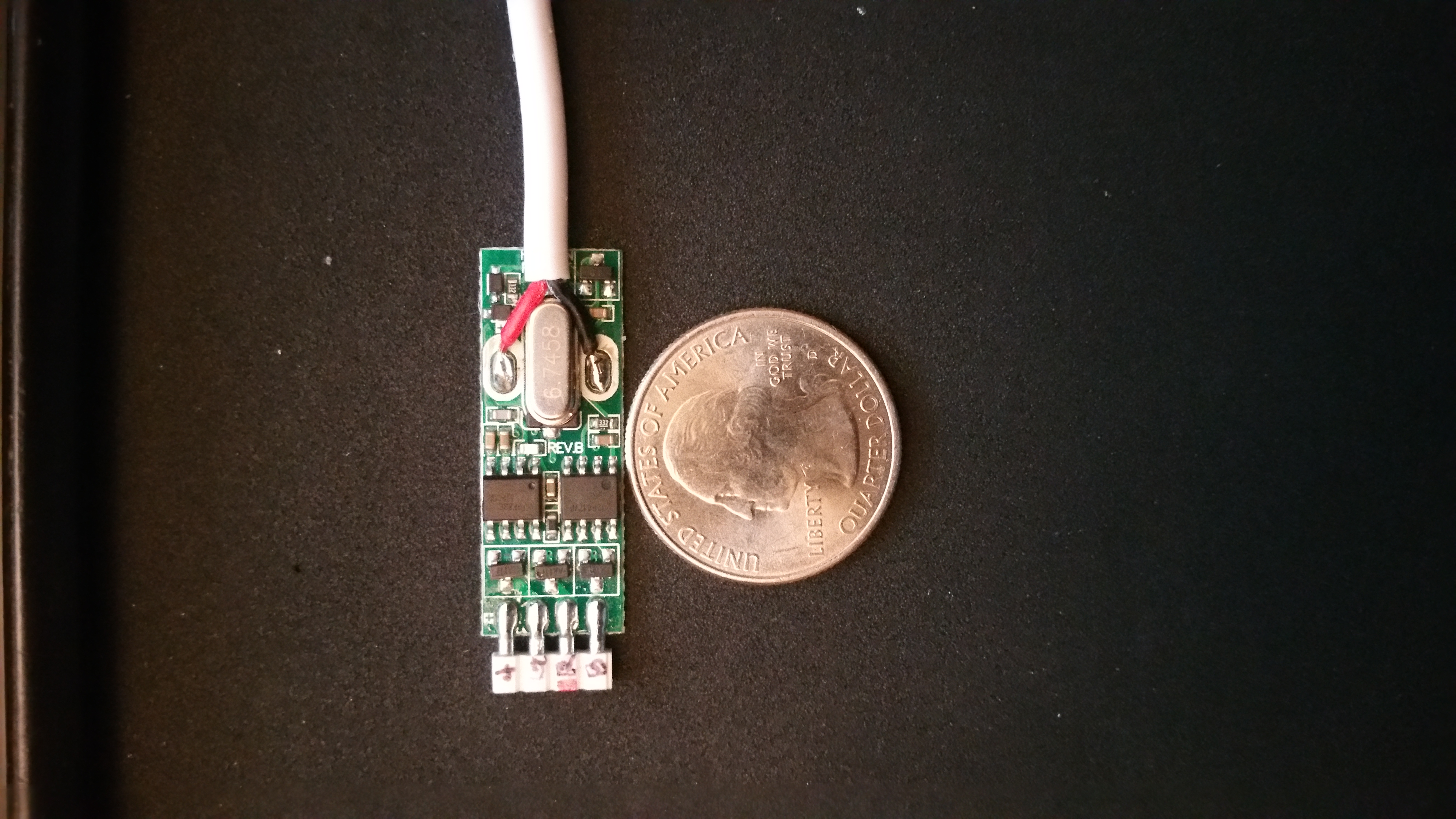

SkybotLivendale
Posts: 22
Joined: Mon Sep 19, 2016 11:49 am
Re: D56: Gameboy Pi3
Post by SkybotLivendale » Thu Sep 22, 2016 10:37 pm
DirtyBullets wrote:
Kilren wrote:The LED buttons are a fun feature. How are you planning on controlling them and will it be interactive?
na they are just slow changing RGB led's and will add it to a switch inside so you can turn on or off to save power... :geek:
I've been looking into this myself, because there doesn't seem to be a good way to make a compact slider for the RGB LEDs colors.
So far this is the best I've found.
https://smile.amazon.com/gp/product/B00 ... UTF8&psc=1
You can strip off the out coating and wire it up probably pretty easy. Here's what the bare board looks like:
