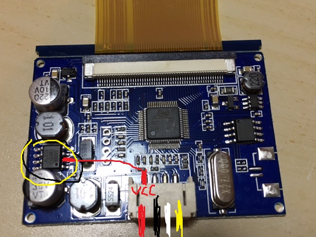

I ordered this one from Amazon: https://www.amazon.com/BW-3-5-Inch-Moni ... B0045IIZKU and got the variant 7 screen of the Screen Wiki page. I followed the second method that is posted there to make it 5V compatible and it worked.

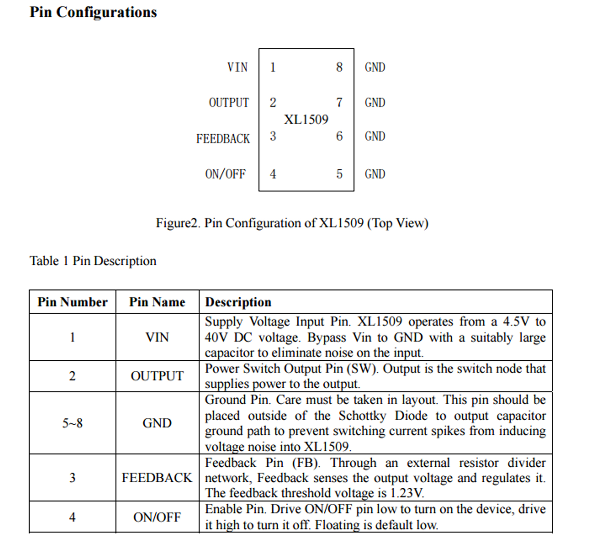

- XL1509 datasheet-2.jpg (1.05 MiB) Viewed 11741 times
- IMG_2628.JPG (127.86 KiB) Viewed 11741 times

I have a v9 as well but it appears to work on 5v without modification but I have only tested it soldered to a pi zero so don't know if audio will give any interference. Does anyone else have any experience will a BW v9?
If it is recommended to mod the board, I'm a little confused by the mixed messages on what to do. One post I've seen simply has a jump cable from one of the chip pins (and it's hard to see exactly what pin it is) and the wiki says remove the chip as well. Is anyone successfully using a BW v9 that can show me a picture of their working board?

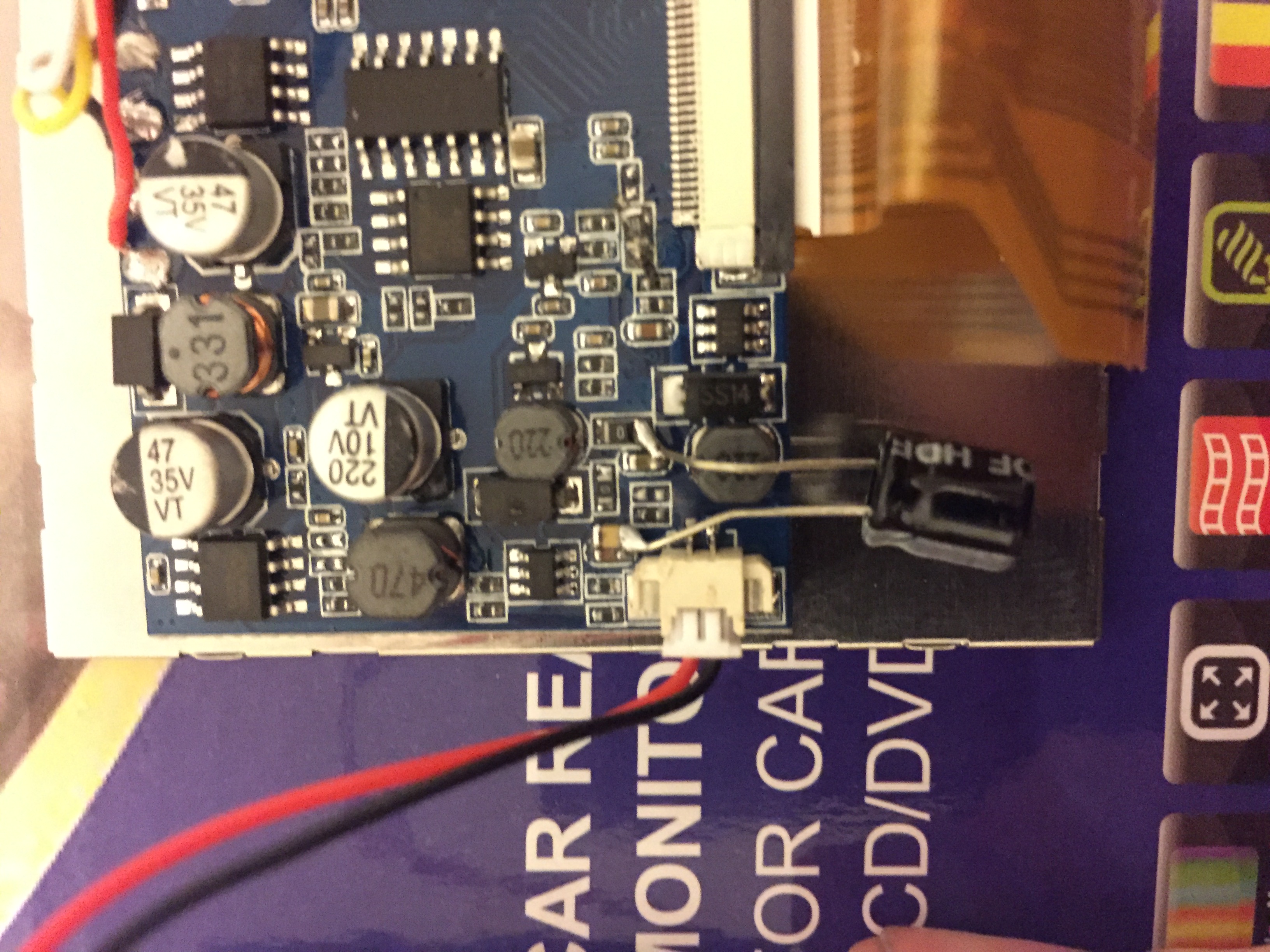

I have a v9 screen and followed the advice in this thread to get it working on 5v.
http://sudomod.com/forum/viewtopic.php?f=8&t=2110
The wiki entry for 5v modification was not there when i got mine but this method is much easier and i can confirm it works. There was recently another user with the same problem and he confirmed this works as well. This picture was taken by him.
- 20170110_094924.jpg (931.46 KiB) Viewed 11642 times
