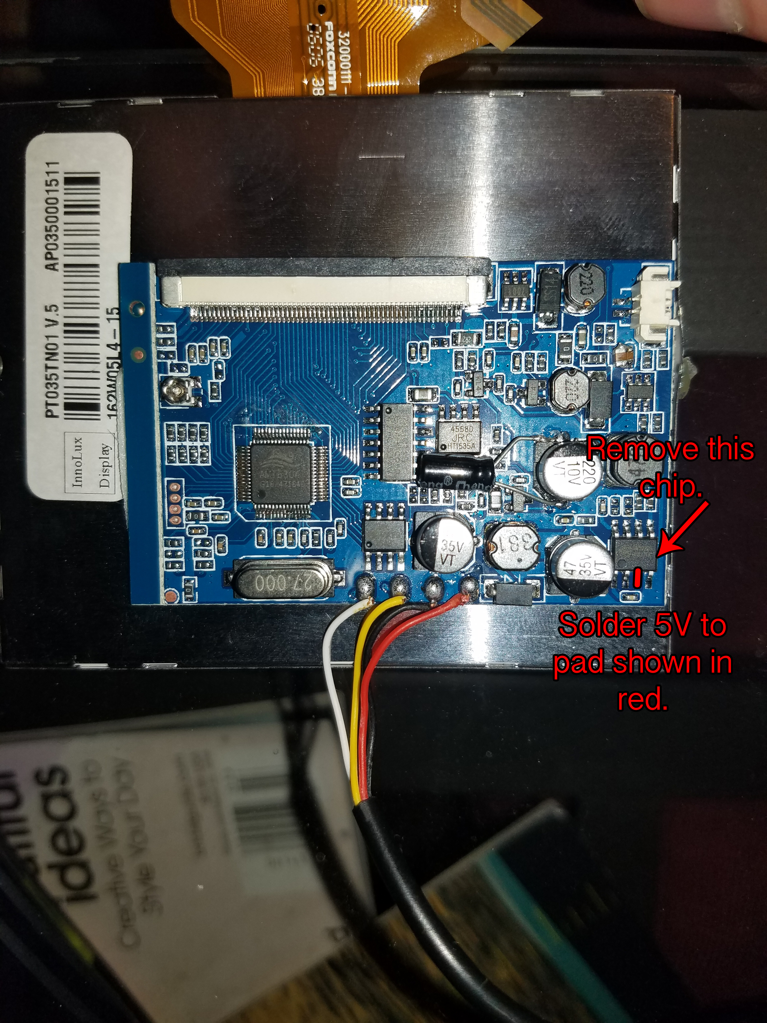

I am thinking from the looks of things (by comparing to other boards that were shown in this thread) that it would be pin 2 that I am suppose to connect? But I am not sure where it is suppose to lead to.

Zeek wrote:Anyone seen this screen before? Does it need to be converted to 5V?
Just got this board the other day and 5V out of the box was a no-go. So, I removed the chip in the corner and changed the 5V entry to the second pin from the lower right of the desoldered chip. Not the easiest to explain so I made an image in Photoshop. Hope it helps, I can confirm this works. This screen is one of the nicer looking screens I have seen. ENJOY!
Thanks for the help!
I posted an image for this screen a few pages back, It is the chip on the left you have to solder 5v to:
Mischief wrote:
pjmills81 wrote: Hi Mischief, Do you have a picture of how you did this?? Thanks
Soldered the 5V to the pin I marked in red:

Ah okay it wasn't labeled on my board so I looked for the one that was and tried to get more info on it.
Thanks Mischief!
Will this Change anything? It's in a different spot on my board than yours.

So i had the first (wiki-style) gearbest screen, burned the board, ordered a second one, which is the "new" generation gearbest screen obviously. I used the same soldering as you, works fine.

Zeek wrote:
No, it shouldn't matter. The image I used was a photo I took from another Sudomod member so I could help them. My actual board I have lacks the capacitor that I've seen soldered to these driver boards. A capacitor is nothing more than an electrical component meant to store an electrical charge. Kind of like a battery, but not. Ignore the capacitor and as long as the board is identical otherwise, this mod should work.
The part I'm having you remove is a switching voltage regulator. It sees 12V, which is what would be assumed to be connected to given these are for vehicles, and converts it to 5V.
These boards are already running off 5V, we're just moving the 5V power wire to where the regulator would otherwise be outputting 5V from the stepped down 12V.
The 12-5V regulator becomes useless in this scenario and is thus removed.
Hope this explains it a bit better for you.
