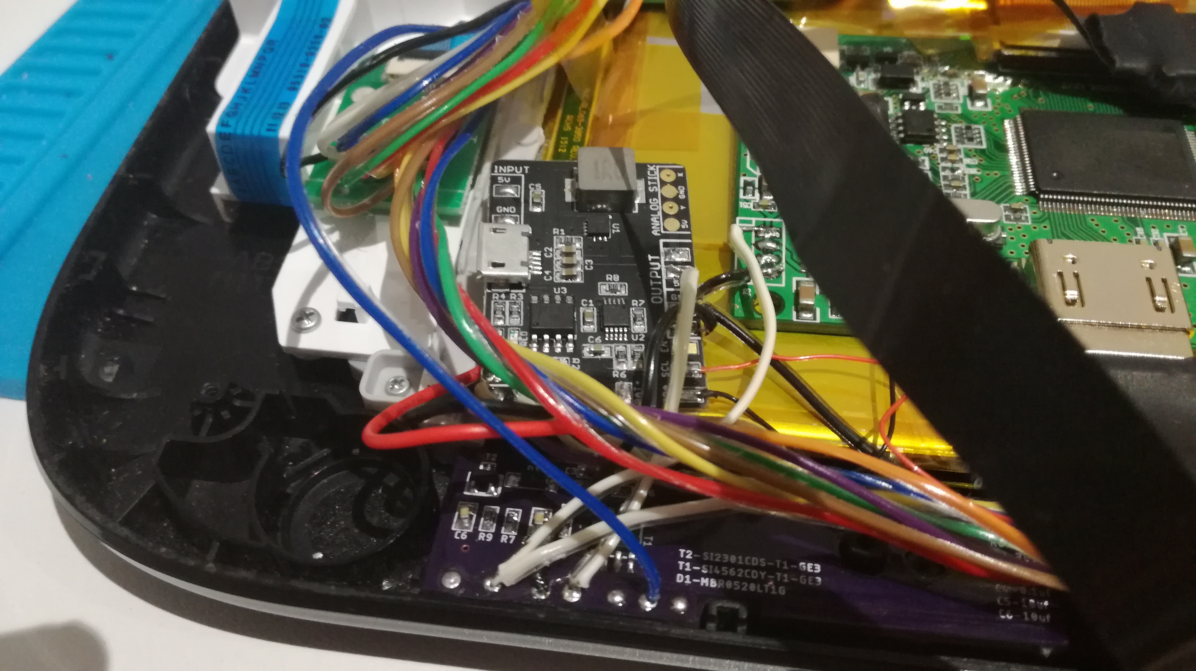

Post by djobbydjobba » Thu Jun 06, 2019 12:19 pm
Hi Banjokazooie ! I have just finished my build and I'm using your code. I experience a strange behavior with the analog sticks. My left stick works flawless, up and down on the right stick too but left and right are recognised like left and right of the other stick...
My first thought was a bad solder that could be in contact with another pin, resoldered everything, same result.
Then I took an analog stick from another spare working wiiU gamepad, same result.
Then I used a brand new teensy, same result.
Then I tried different analog pins on the teensy and changed the code accordingly, same result...
It's driving me ****ing crazy ! Needless to say I double checked any short with my controller...
Have any of you heard about such a thing ? I'm lost !

Wiring issue, double check connections, rewire or change the code .

Ok. Don't know how it is even possible but it turned out to be a software issue with emulation station. Fresh installed and everything's fine. Sorry to bother you.

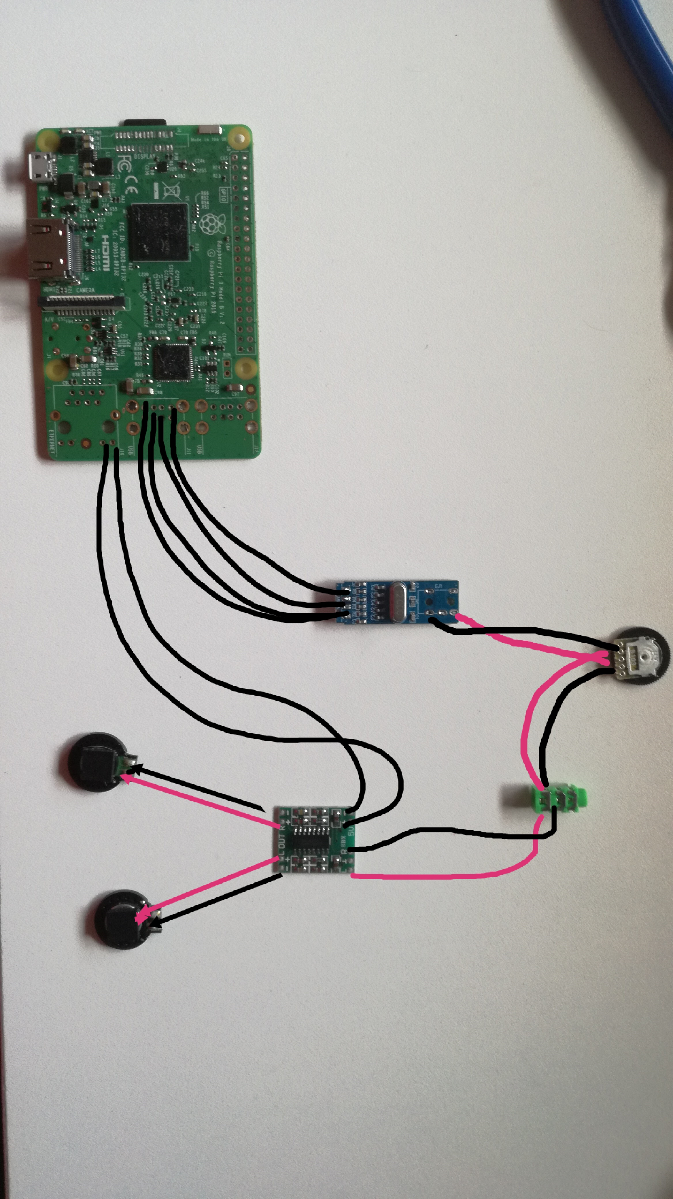

Hi, I'm almost finishing my project. Everything is fine, but I have a question with the audio.
Is the connector that carries the DAC that I have removed it valid for the circuit?
I want that when I connect the headphones the audio is passed to these and that the speakers stop working and when I remove the headphones the sound returns to the speakers.
If the one with the DAC is not valid, which one do you recommend?
The diagram that I send is a bit so you can see how I plan to connect it. I'm not saying that the drawing with the connections is fine

It will not work with the green audio jack as you need 5 pin connector

Post by Noxta » Tue Jul 02, 2019 4:27 am
Could the USB DAC be removed and connected to the jack connector of the pi itself?
