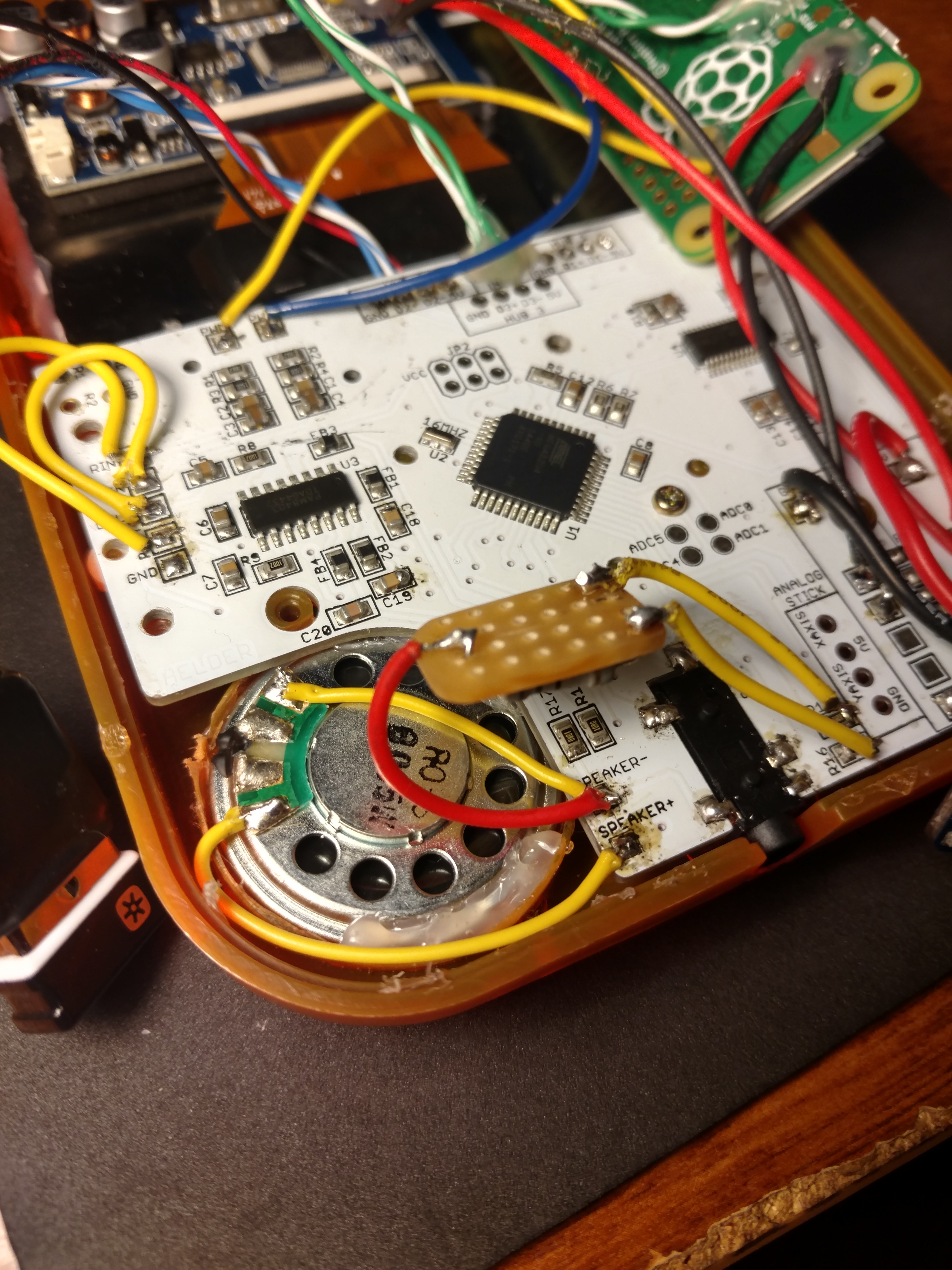

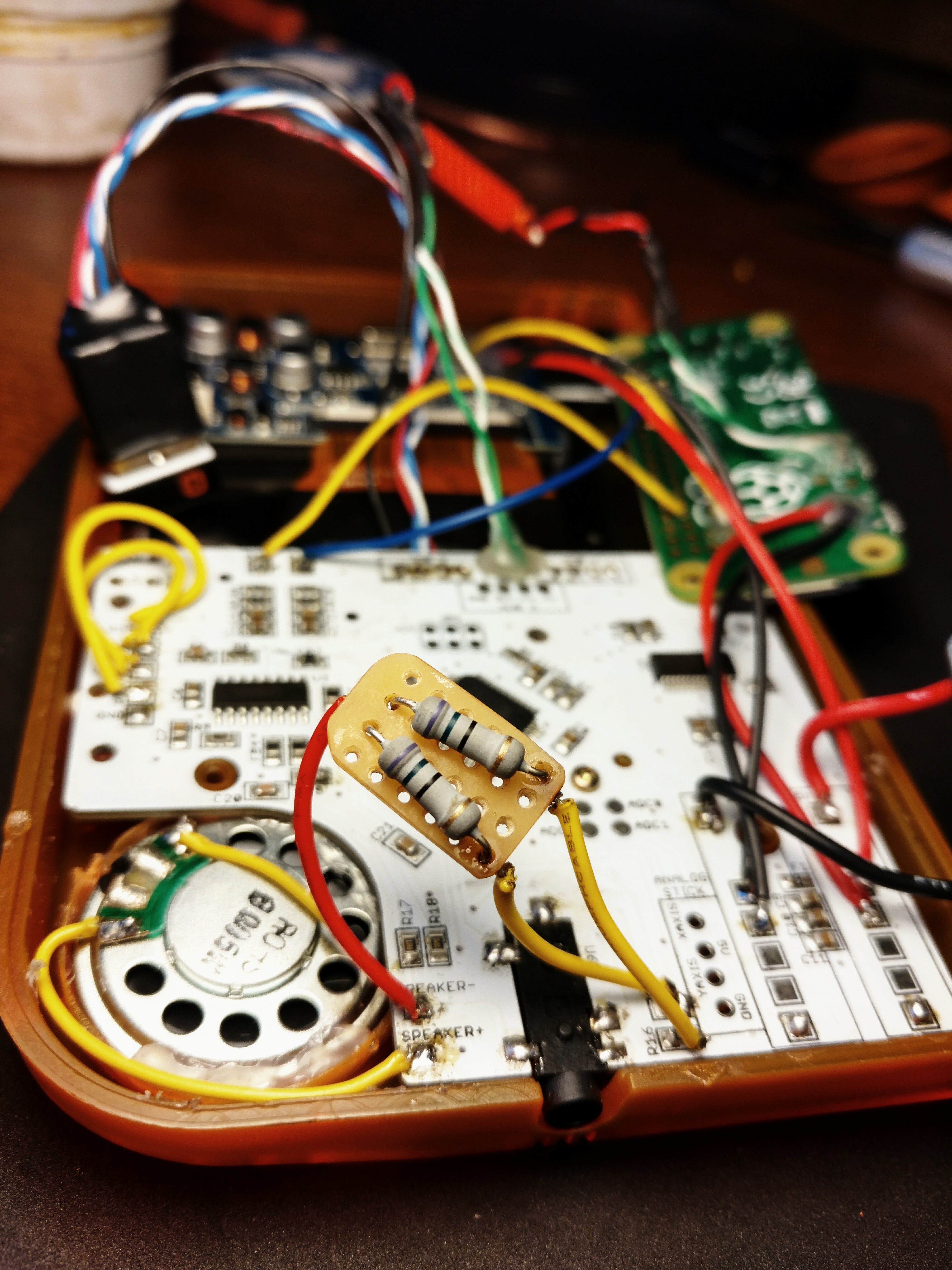

Issue: Extremely choppy and quiet audio through speaker.
Solution: Added resistors as suggested by Helder which, instantly increased the volume and reduced the choppiness to a very playable level. No other steps were required apart from hookup as shown on Helder's wiring diagram and the config file, both of which are found on page 1 of this thread.
My setup: AIO 2.2A with 5 pin audio jack, Raspberry Pi v1.3, Adafruit Powerboost 1000C TPS61000, and 8 Ohm 1/2 Watt speakers https://www.amazon.com/gp/product/B00WW ... UTF8&psc=1
Parts Required: Two 75ohm 1/2 watt resistors, Three 1.5 inch long pieces of extra PWM or audio wire and a small piece of perf board.
Resistors from https://www.amazon.com/gp/product/B0002 ... UTF8&psc=1
To do:
Place resistors into the perf board parallel and adjacent to each other and solder the ends together on one side to make a U shape.
Solder a wire from the bottom of the U, on the side you just joined, to the Speaker - pad on the AIO.
On the other side of the perf board, solder a wire from the end of one resistor to the right side of R15.
Solder another wire from the end of the other resistor to the right side of R16.
Done

Thanks for the info! Would it be possible to take a picture of the underside of the perfboard. I would like to see how you joined the "Speaker -" wire and also where is one of speaker's (yellow) wire going to?

Can you confirm fro the picture that the negative speaker wire and red wire from the perf board both go to the negative speaker pad?
Cheers[/quote]
Yes you will have two wires going to the "Speaker -" pad. All of my wiring is done as per Helder's diagram. Then I added the resistors as described and pictured in my earlier post. You're going to have to use your imagination a little bit, but the red wire from "speaker -" is joined with the ends of both resistors.

Ok so you have just put 2 resistors in parrallel of the speaker (the end of R15 &R16 are directly connected to speaker+)
So in theory we just need 1 resistor (150o) between speaker+ and-... This is weird but I will try this hack tonight.
