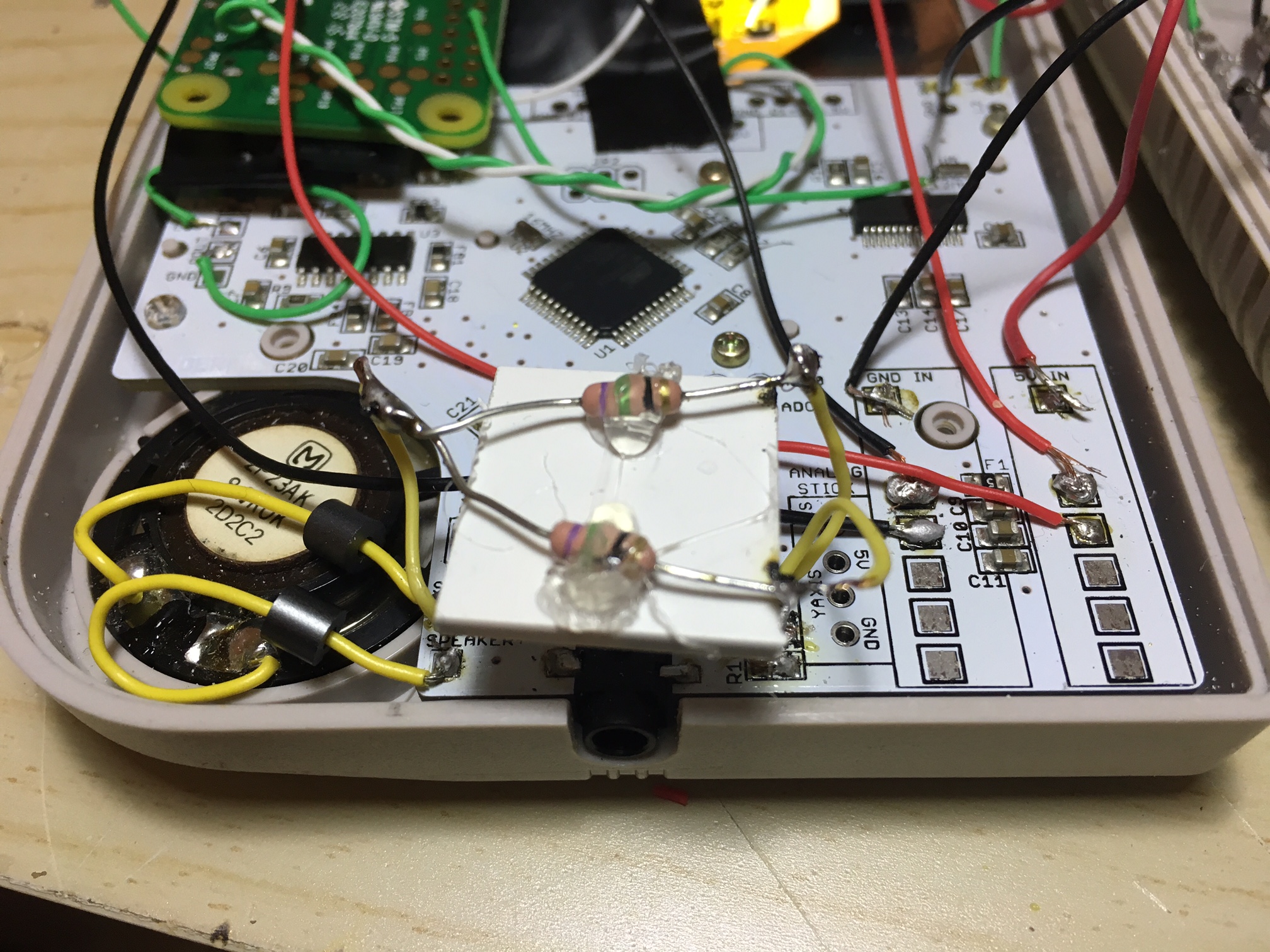

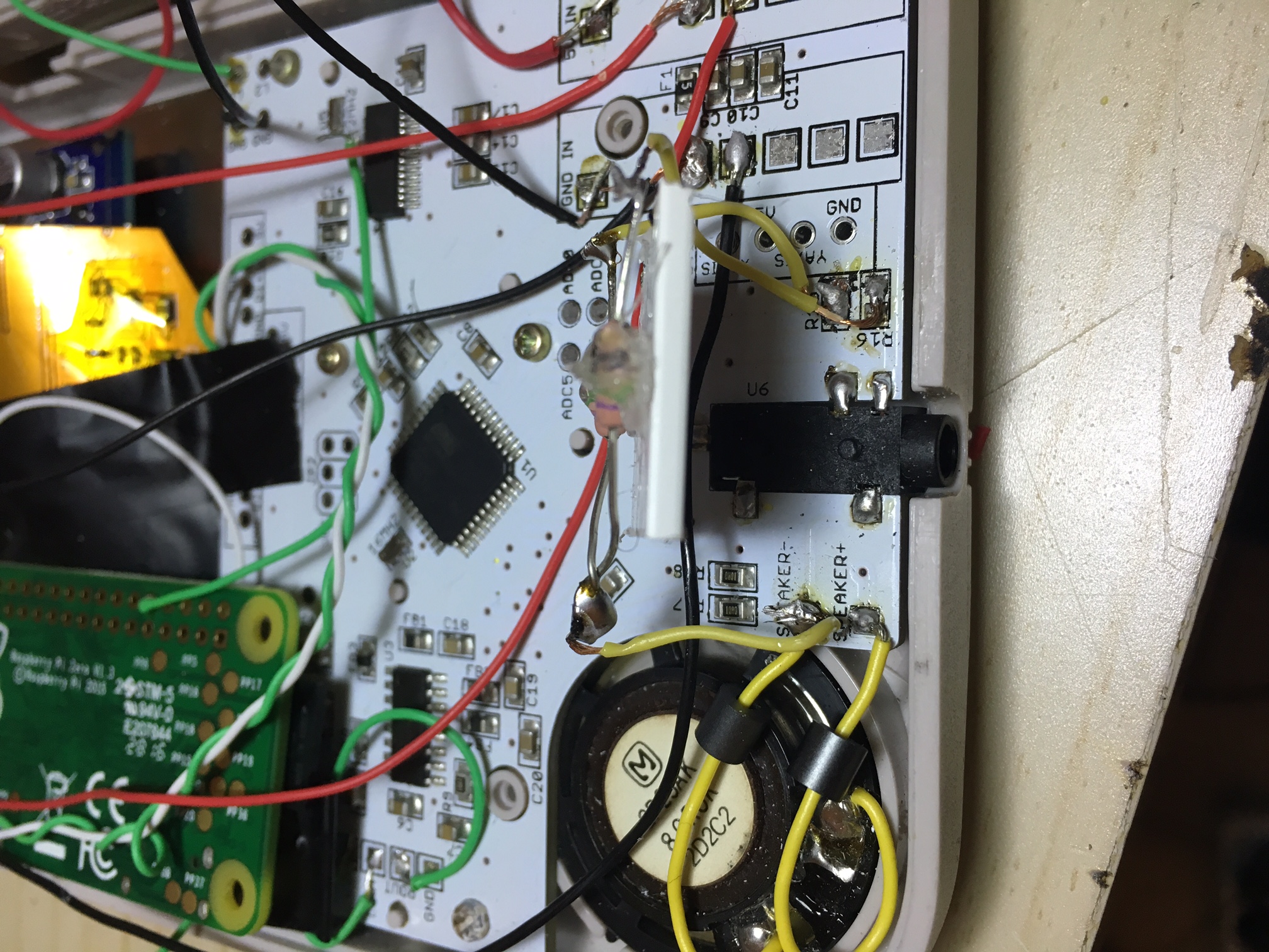

Post pictures of your wiring and does the headphones work? did you use the PWM Audio in the config.txt in the first post?dongilles wrote:
Sadly this did not work. Still no sound. Do you have some other options?
I recently had someone send me back their board for repairs (I tested it before shipping) with the USB and after getting it I could see that the pads were burned right off. So pictures are needed to see if any kind of damage and or wiring mistakes might the issue.
Hey Helder, thank you for your message.Helder wrote:Post pictures of your wiring and does the headphones work? did you use the PWM Audio in the config.txt in the first post?dongilles wrote:
My headphone is working but there is a lot of static.
see the pictures below for the audio wiring, are there some other pictures you need?

Try moving your PWM audio wires away from power and data lines, I see your Pi is right above the PWM solder pads and I can't really see the PWM wires and how you routed them, shorten them too so there is less interference and possibly twist them too like the usb wires.dongilles wrote:
