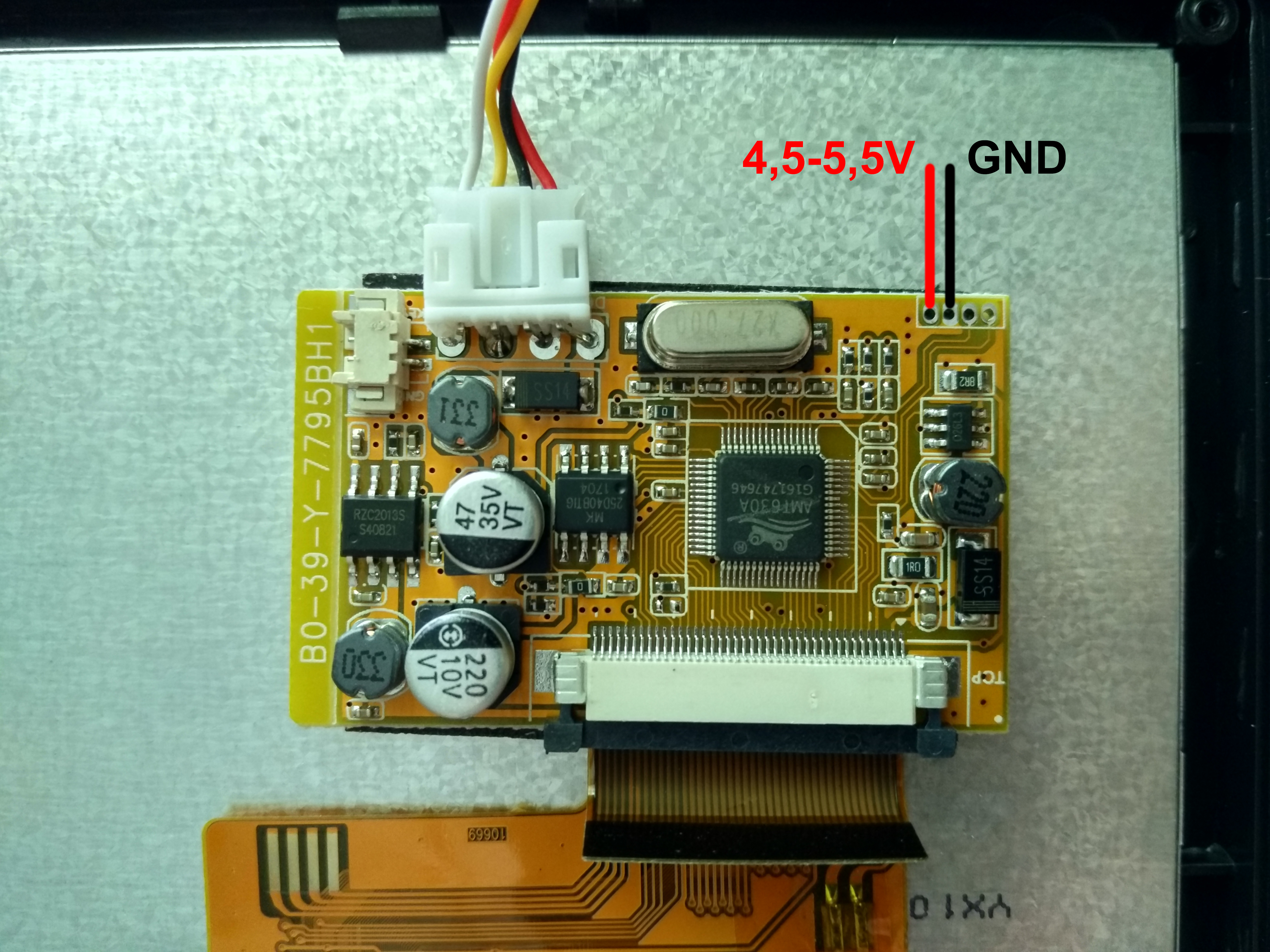

Hi guys.
I bought this one for my project: http://s.aliexpress.com/JjYBVFFf
It's very easy to power it with 5v.

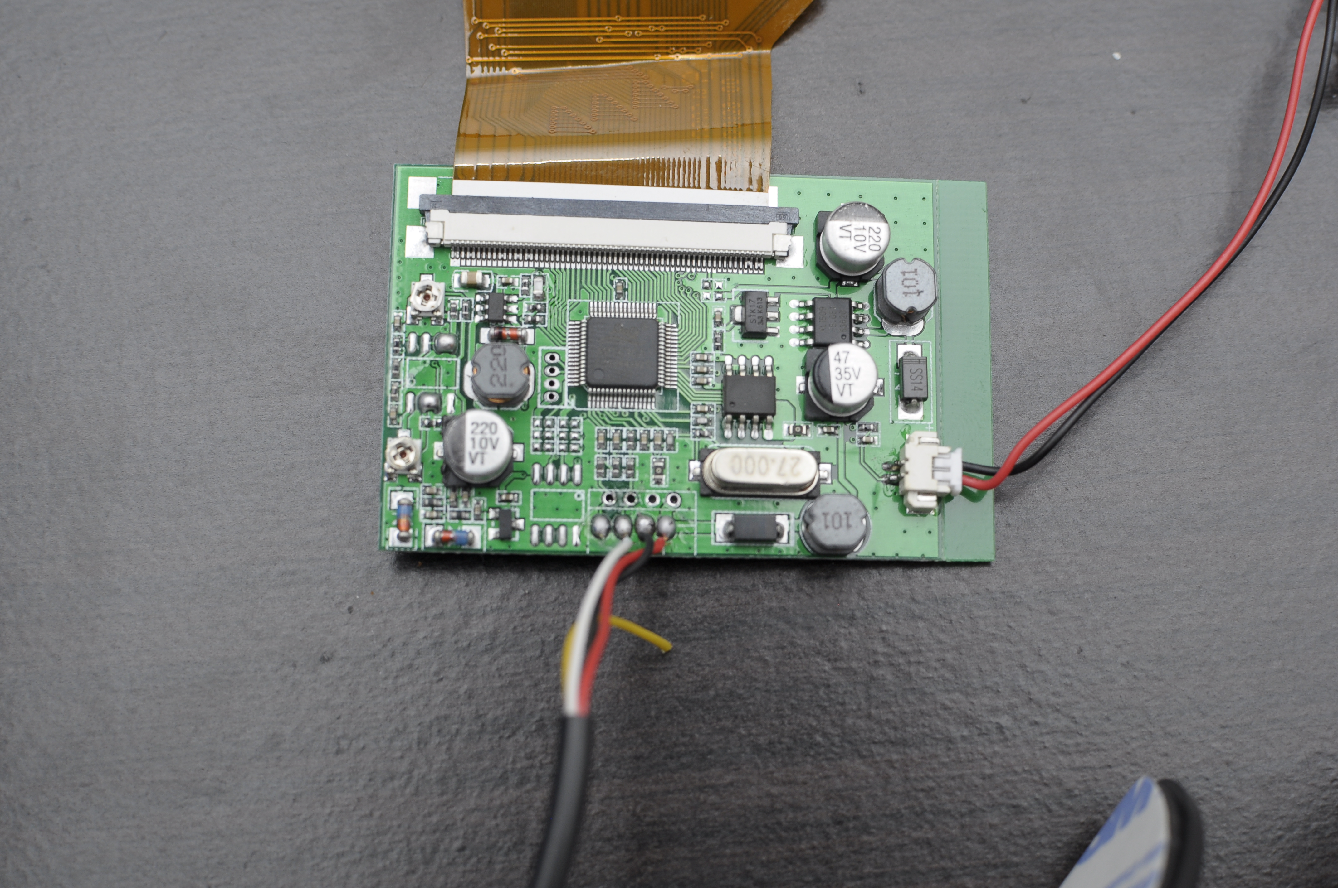

Mine just arrived from eBay. Looked like all the others and came in a nondescript white box.
Has a 3.3v regulator on the left, and looks like quite a bit of the right side can be trimmed. I haven't hooked it up yet and could do with suggestions for the jumper wire. No button board and looks quite a bit simpler than others. Halp pls.
Board has no markings on the back, "FY-3500" on the front, and identifies the voltage regulator IC as "LM2576-3.3"
According to Texas Instruments Data sheet, the far left pin on the IC should be power input...so if I add a jumper from that to the red, would that work?

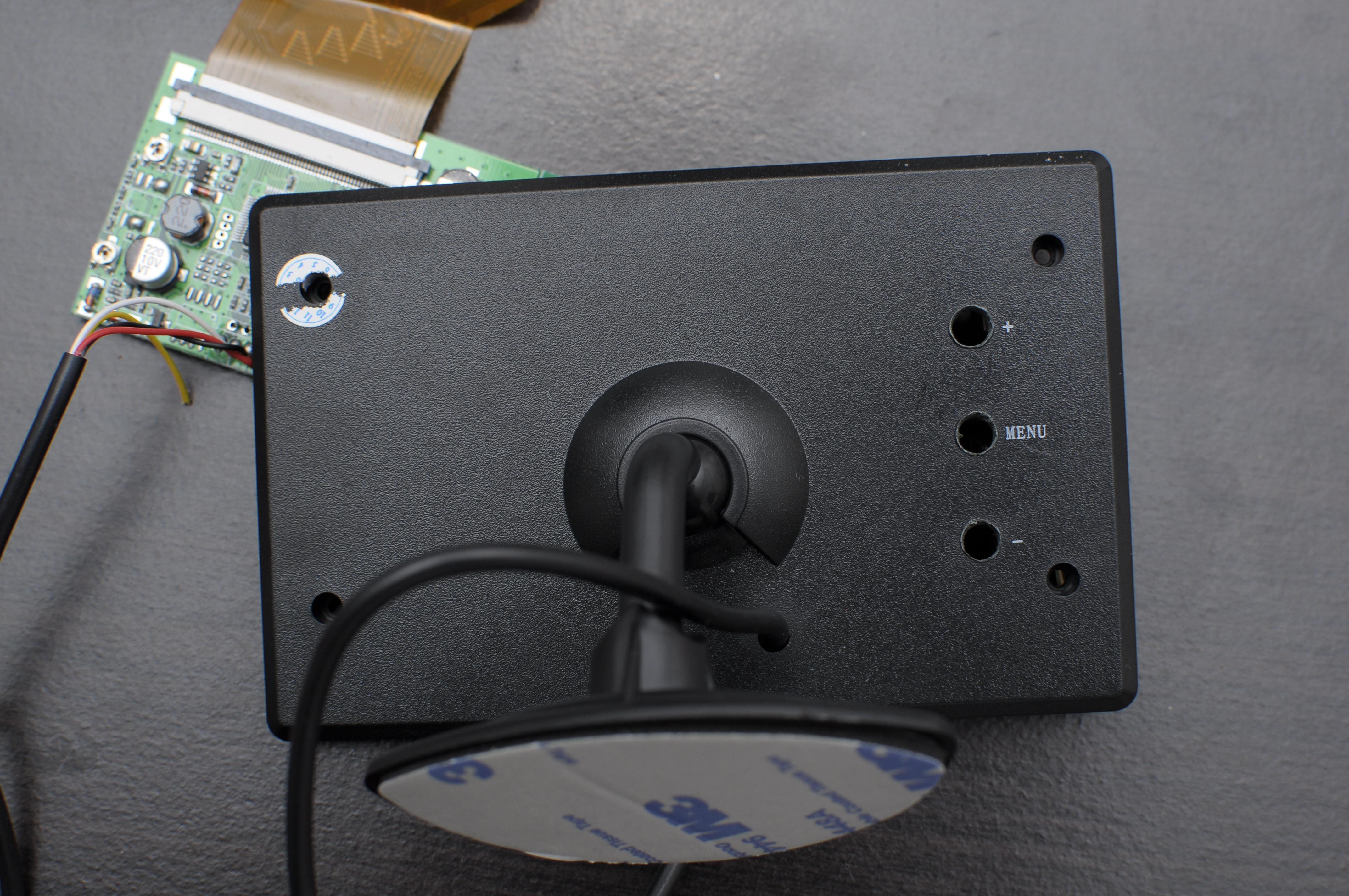

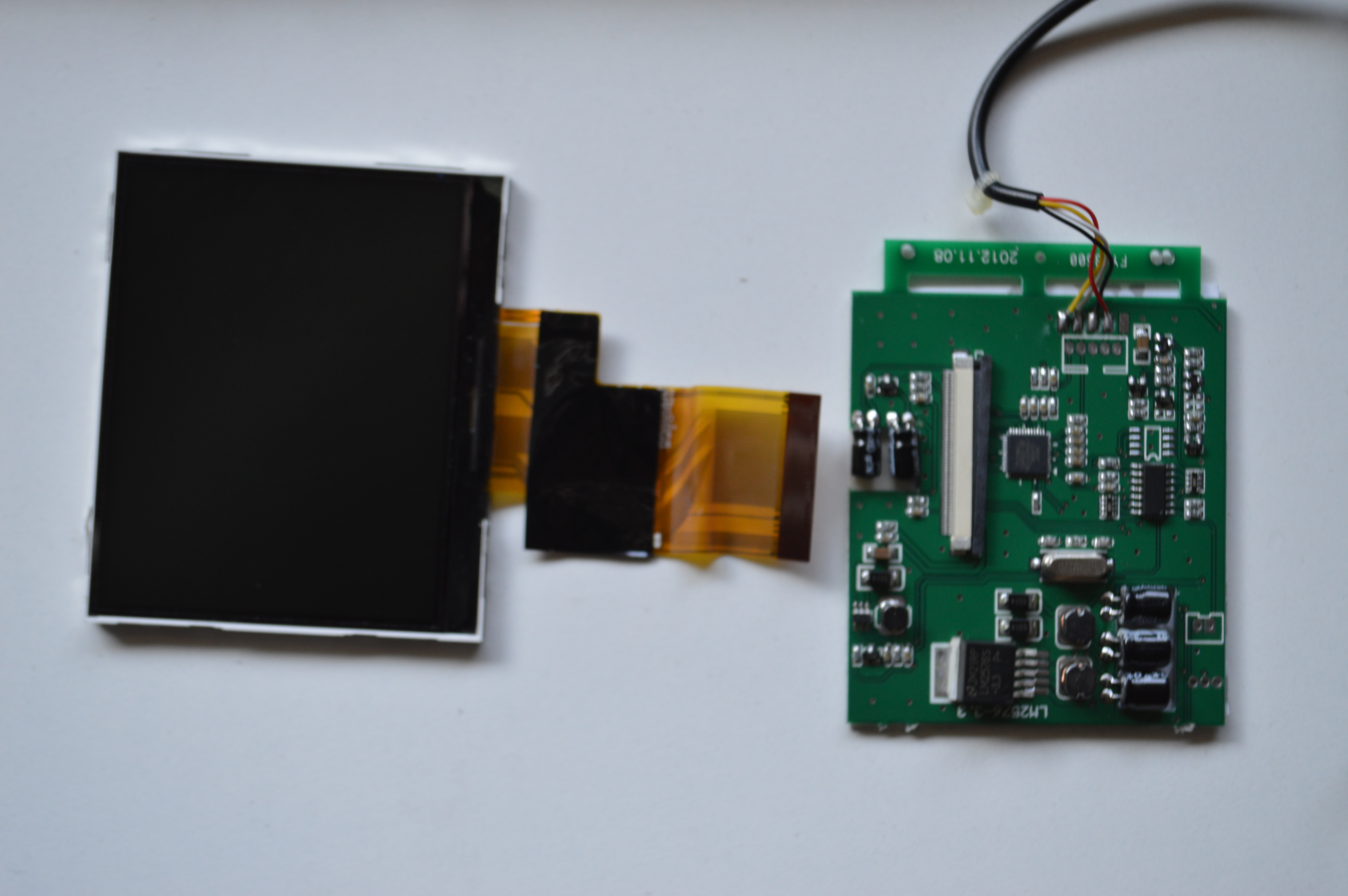

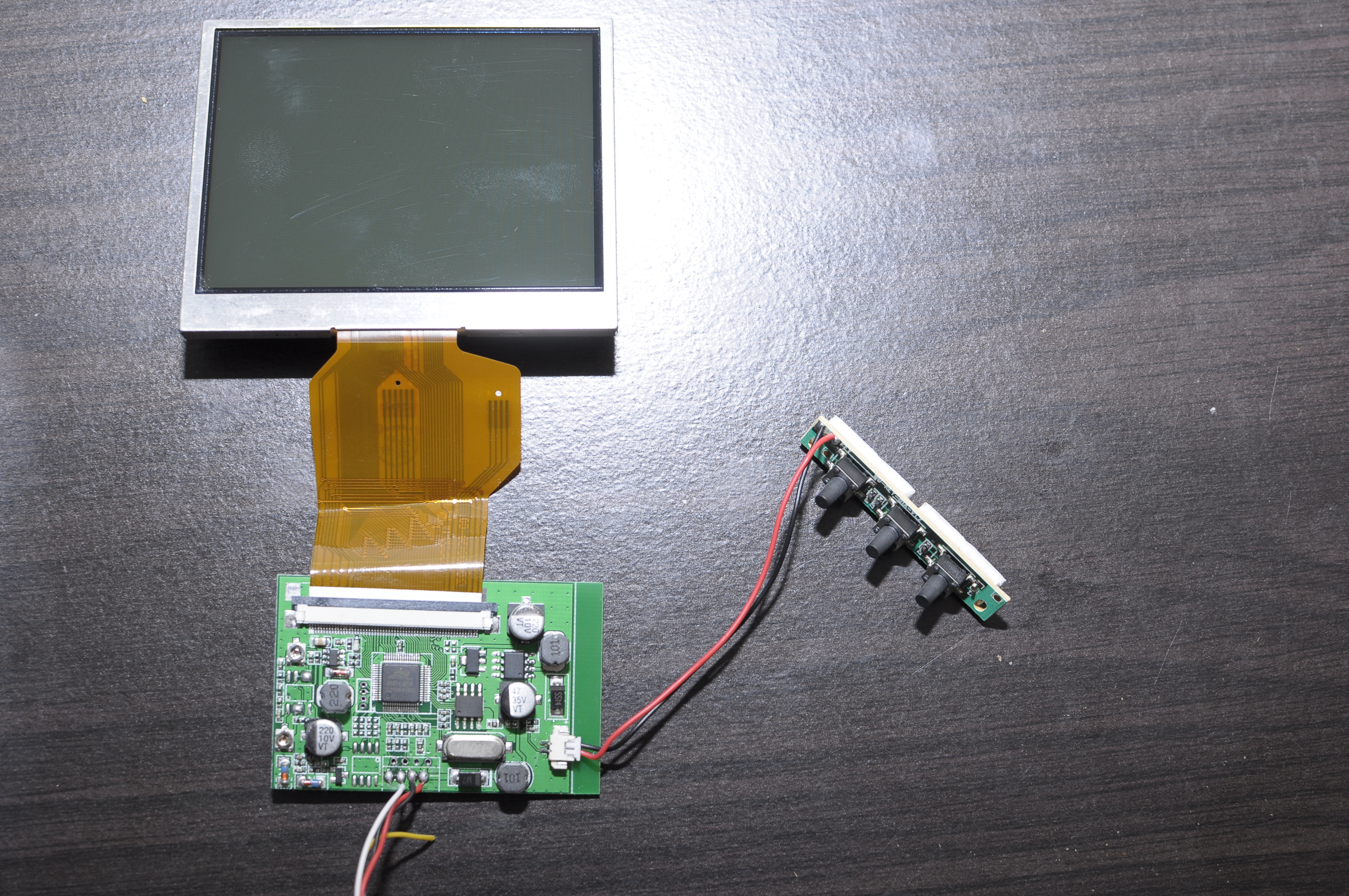

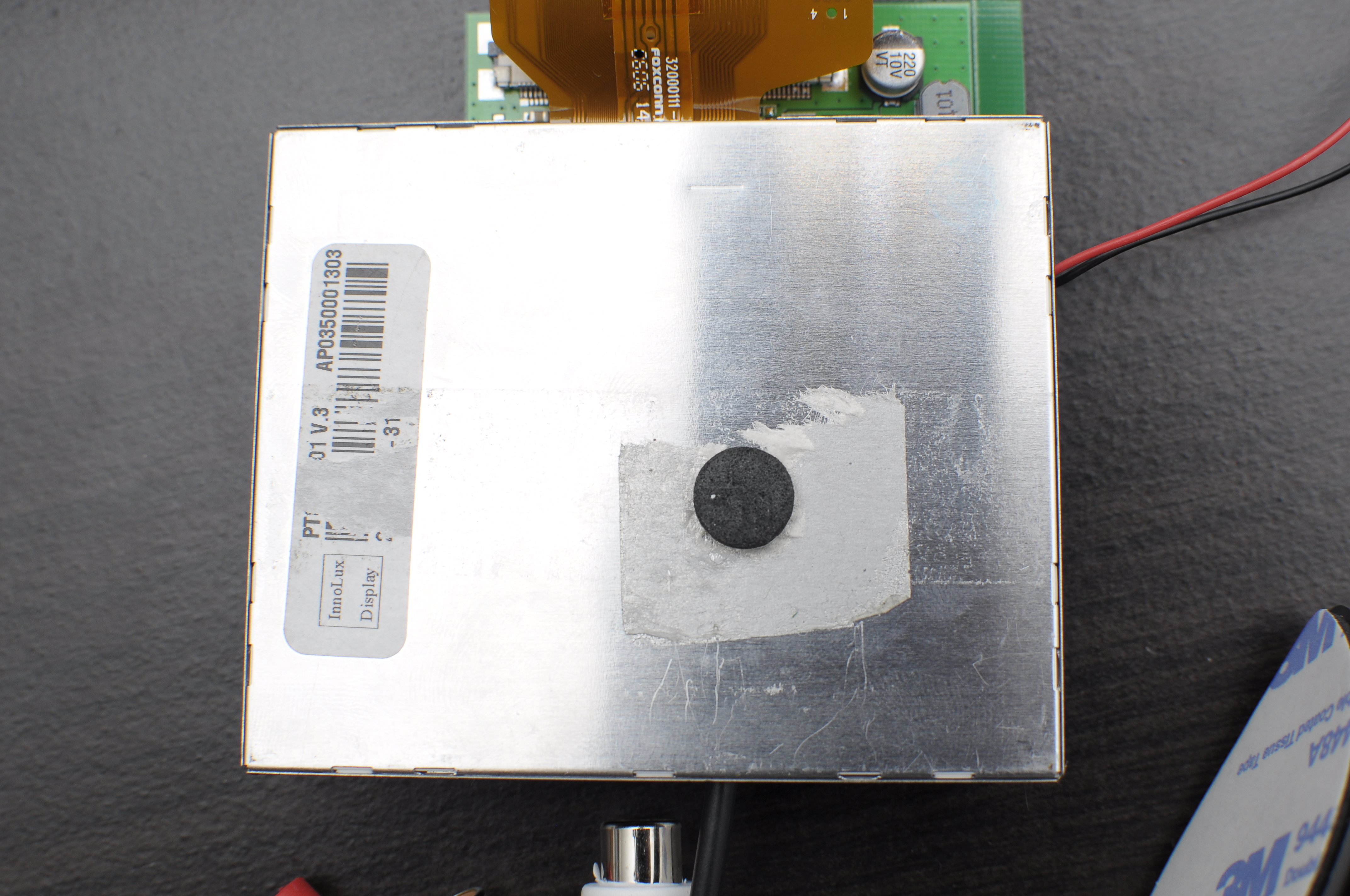

So I'm just beginning my build and I bought this screen on ebay. Listing said it was 640x480, but I doubted it because of the price. After taking it apart, it looks like it might be used or refurbished.
Here is the ebay link: http://www.ebay.com/itm/331729506573 The sellers name is vovotrade
There's a sticker on the back that said Innolux display, I looked them up and they don't make a 3.5" 640x480 display. I just got it today and haven't had time to play with it. I thought I would post some pictures because this circuit board looks different than the others on the wiki.
