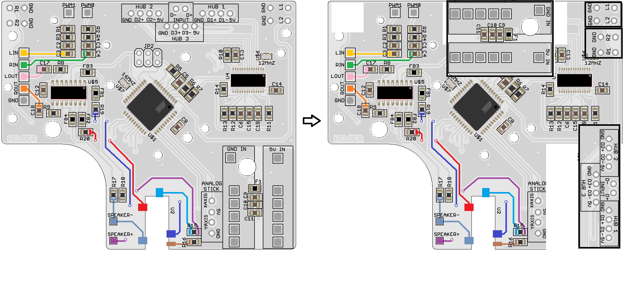

Well, if everybody asks for the same features on a different handheld, it obviously is going to look like Helder's AIO. From my experience with his board, a few components could be better placed. the powerstrip is very far at the bottom which made me use a lot of wire to connect everything. USB can indead be placed on the side. sound configuration is perfect, no need to change that. Last thing would be the L and R wires: I think most people open the GB like the would open a book (opening on the long edge) which makes it a bit tidious to connect one of the back buttons to the far opposite edge. I would prefer the backbutton wiring being on the same edge (either right or left).
But this is just my experience with his board.
Eccho
Posts: 235
Has thanked: 86 times
Been thanked: 106 times
Re: Game Boy Zero - Pocket Edition
Post by Eccho » Fri Aug 18, 2017 3:58 am
Something like this:
Mad Paint skills, I know 8-)
Post by Helder » Fri Aug 18, 2017 6:25 am
Might be possible but a lot of the placement of parts is for routing purposes. Cutting and pasting things with an image editor isn't how circuit boards are made. If your placement isn't possible with a 2 layer board then it likely can be with a 4 layer board.
The problem with a 4 layer board is price and complexity especially when trouble shooting problems and extra time needed to make them. I'll take those suggestions into consideration though.
