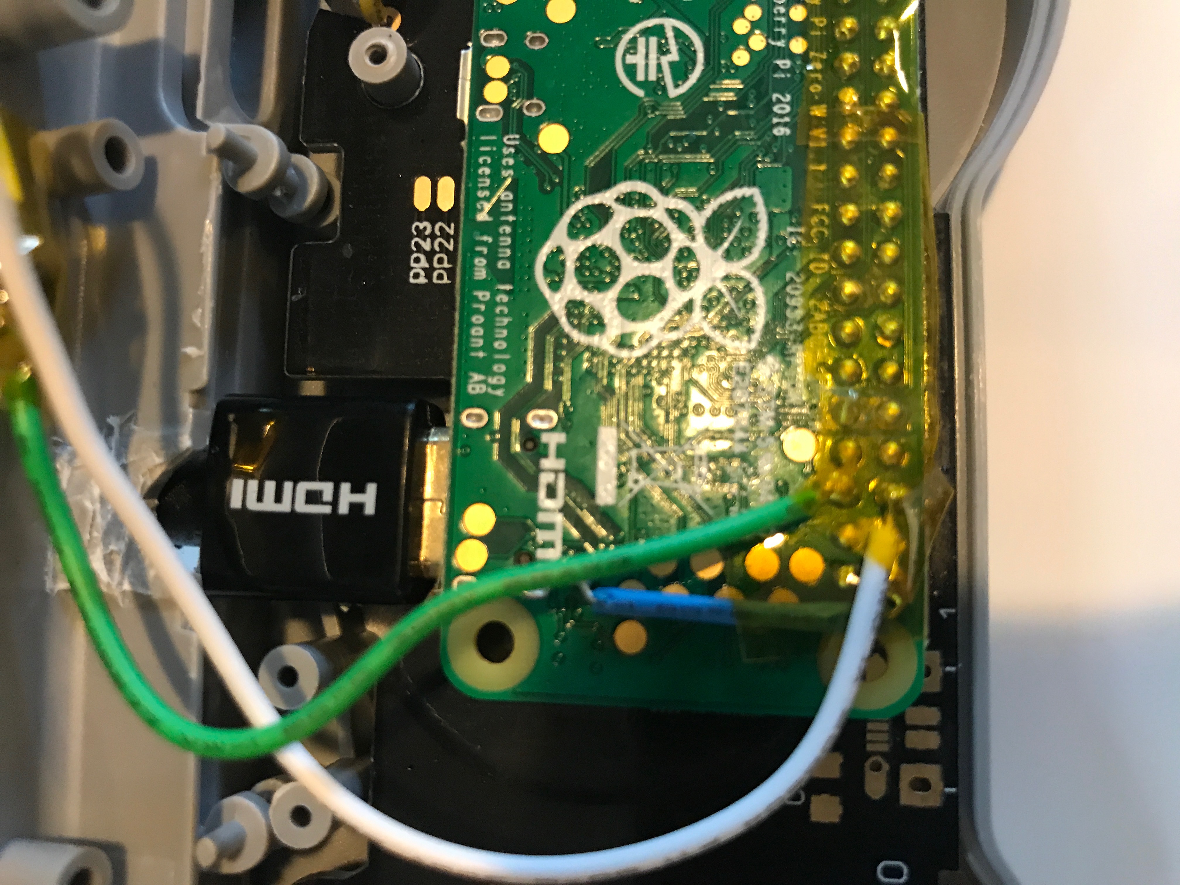

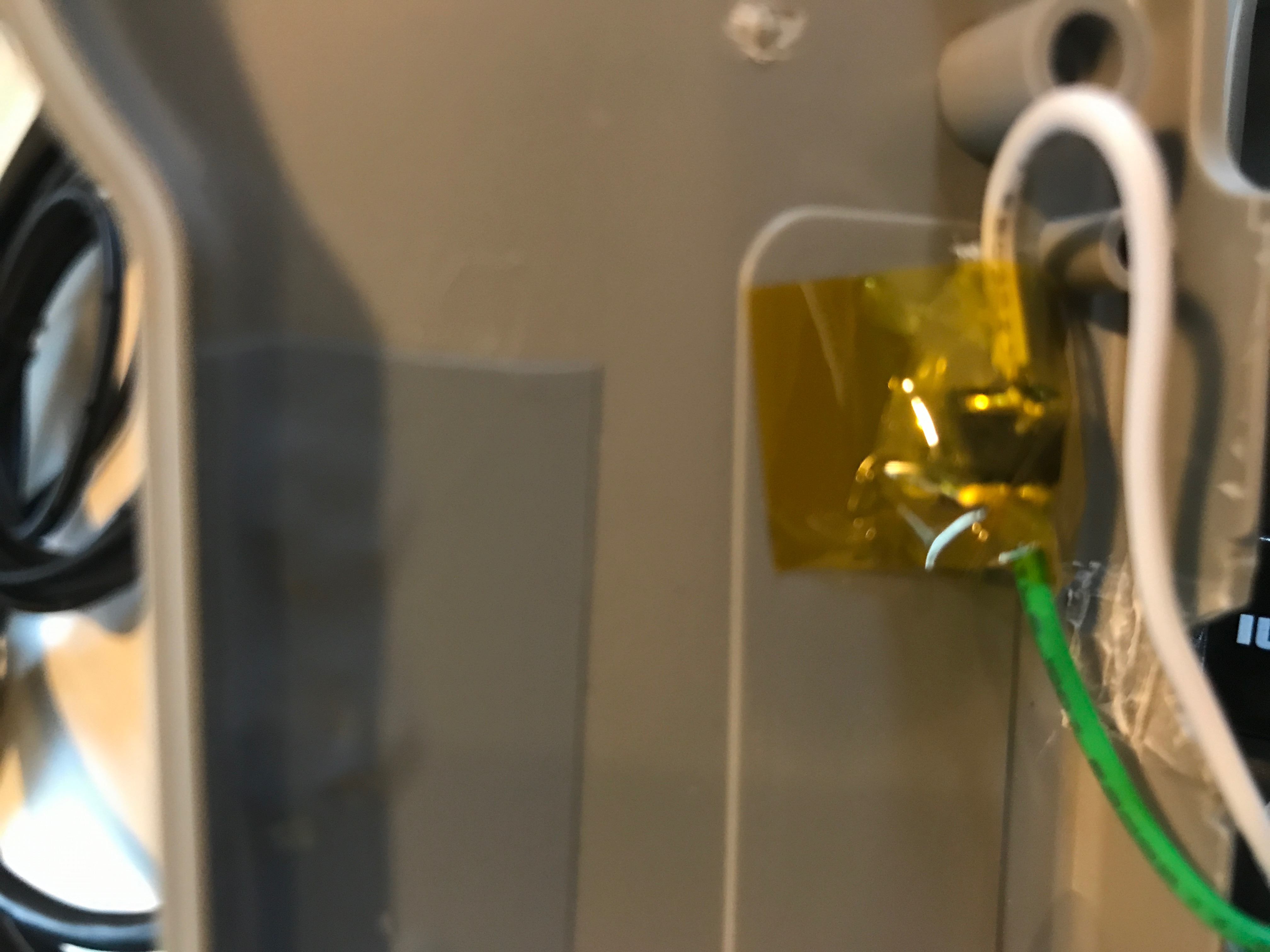

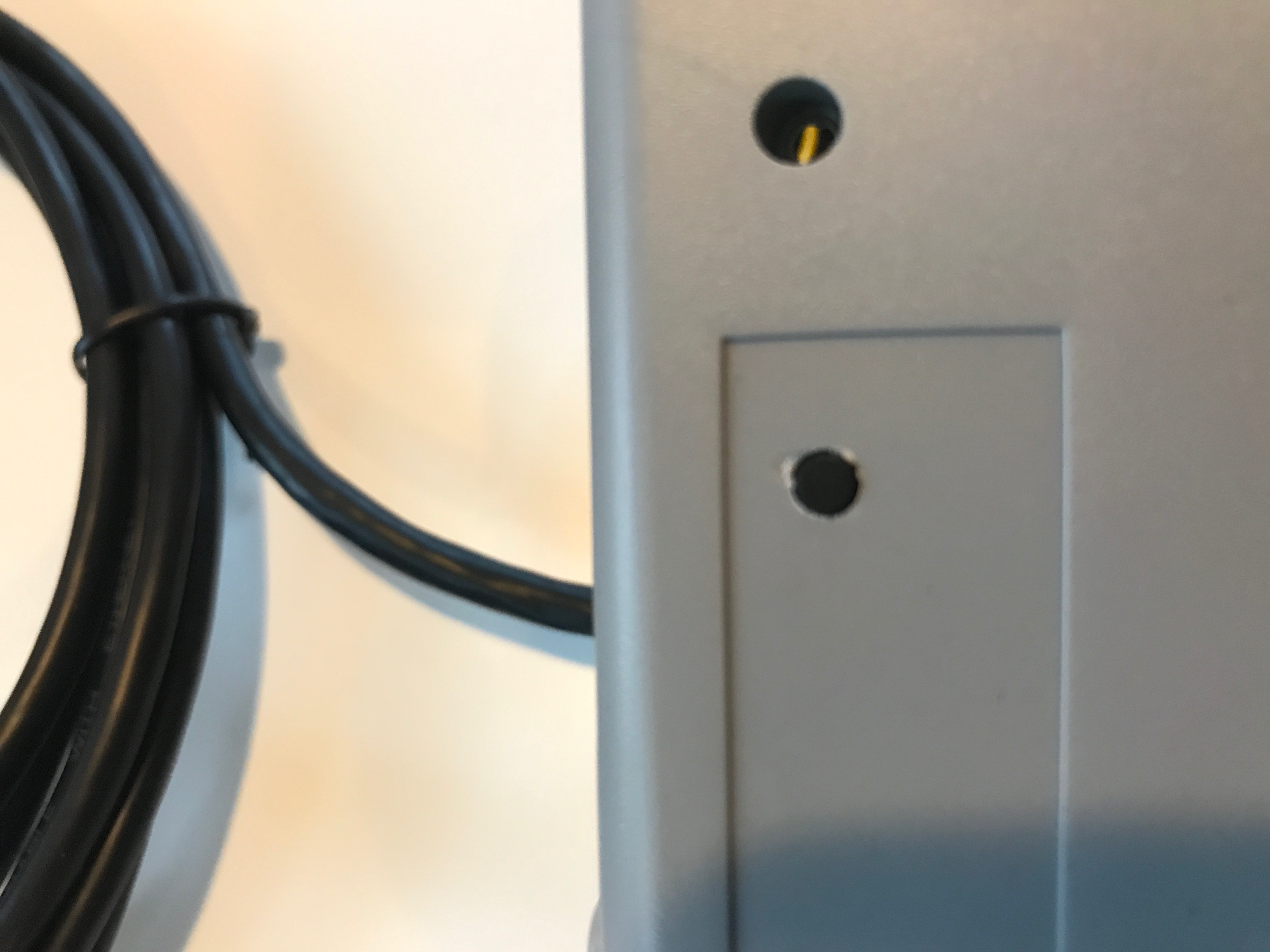

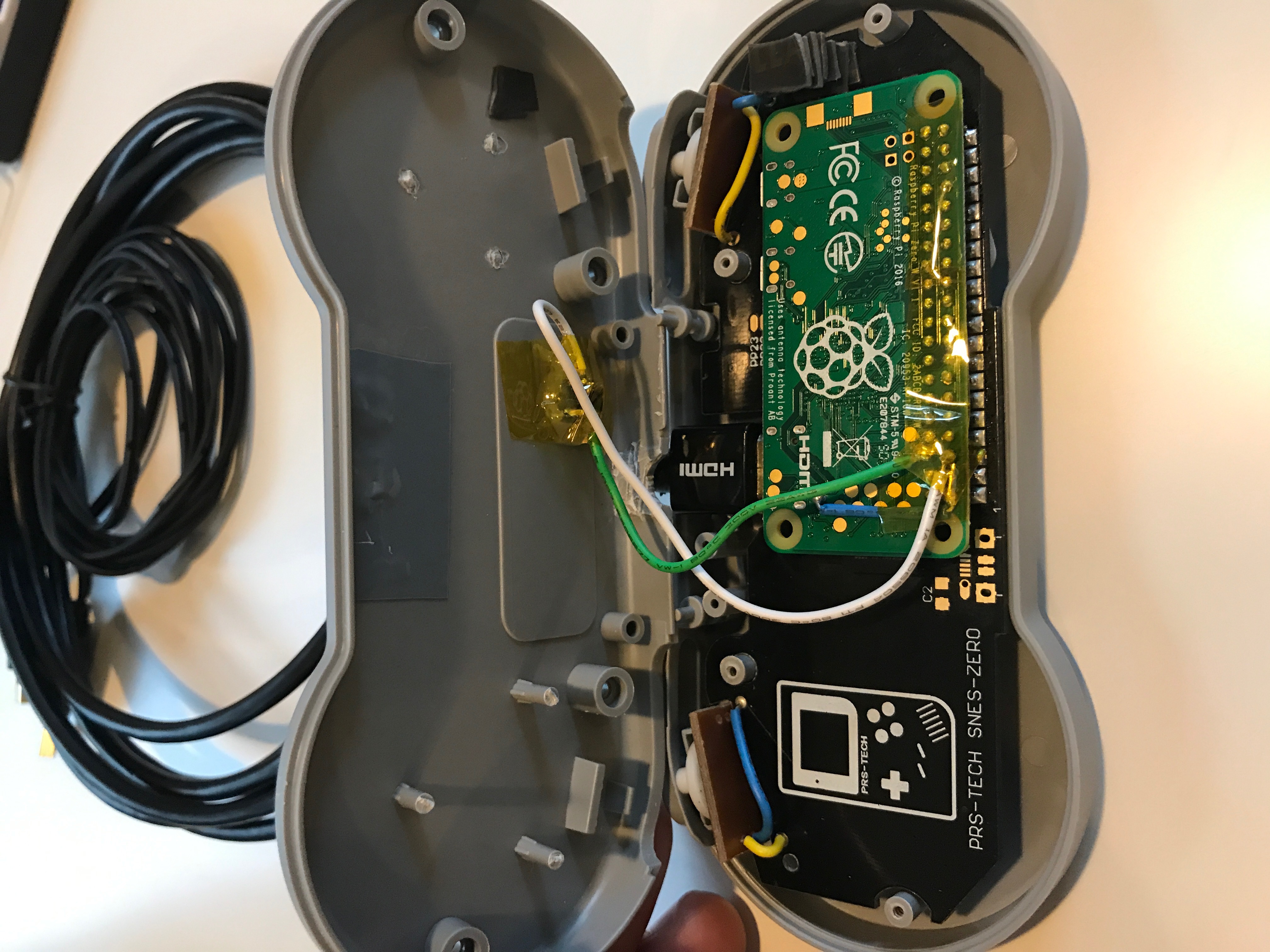

Got mine on Tue.
I actually bought a cheap nameless SNES compatible controller. The inside of it is obviously different from the build images but it was very easy to accommodate all of it inside. Had to desolder and resolder new wires for the L and R buttons. They were very different and short for the board, but that was not too difficult.
Also, while I was at it, I added a small tactile switch at the back of the controller (hot glued it), soldered to pins 5 and 6 on the pi, and using 8bitjunkie's install (http://pie.8bitjunkie.net/retropie-shut ... e-easy-way) to add a soft shutdown and on switch. Could be a nice addition to the next version of the board to have easy soldering pads on the board for these two pins.

drafterITA wrote:
Sat May 20, 2017 1:19 pm
If you have some time could you show the inside on how you wired the tact switch and the glue work? thank you very much :)
Will do. I am on a business trip abroad this week so will take care of this after I return beginning of next week.

Post by diko_d » Thu May 25, 2017 1:21 pm
Here you go! :D
Here you go! :D
Thank you very much!! It looks neat.. especially the kapton tape on the contacts, I think I'll do the same :D
