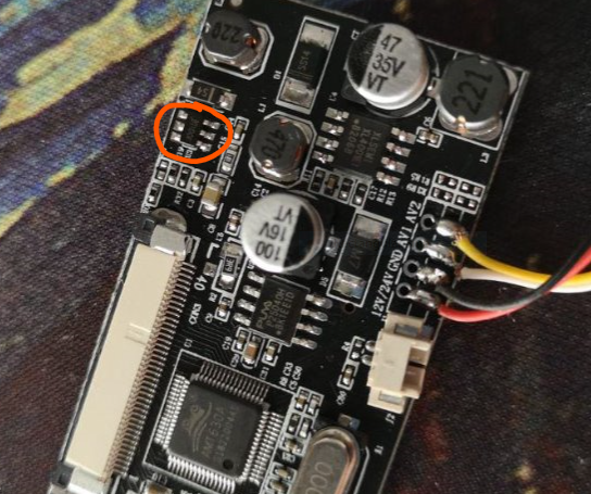

McGyver wrote:
Sat Jun 29, 2019 7:42 am
One way could be:
-power the board by 12V.
-measure on which inductor you get 5V to ground.
-one this point you inject your 5V finally.
Thanks, I'll try :)

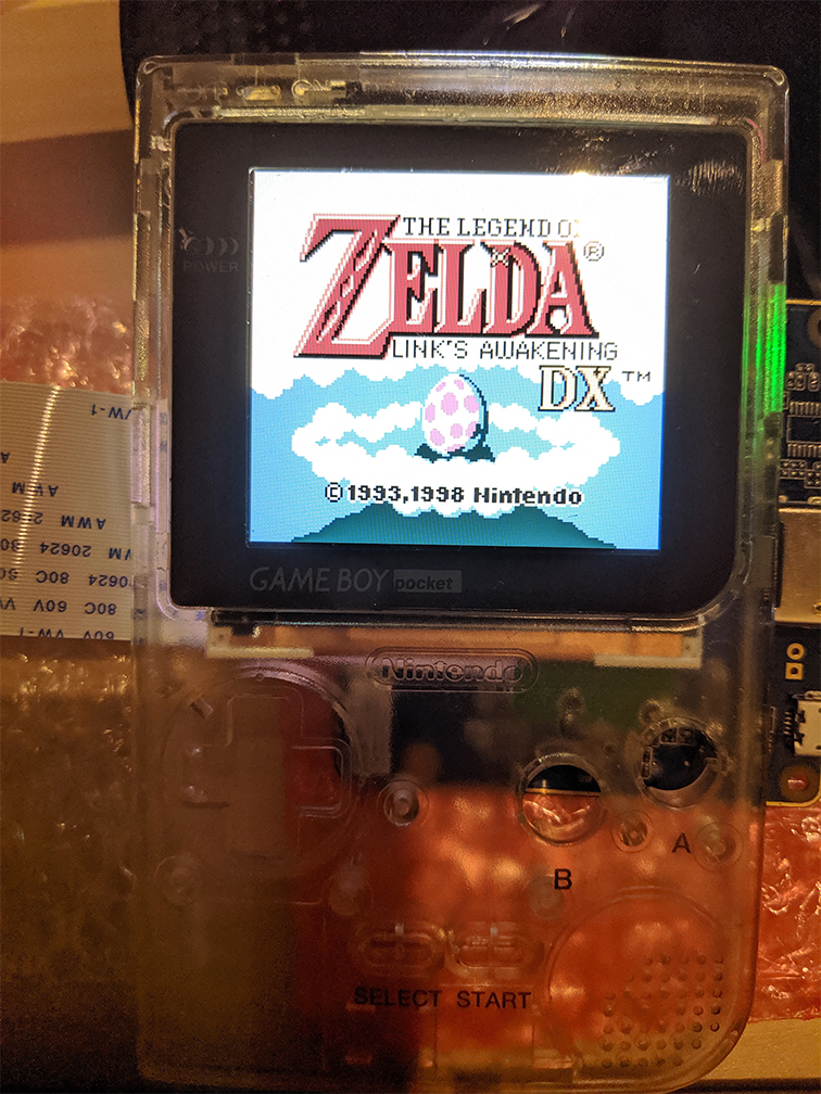

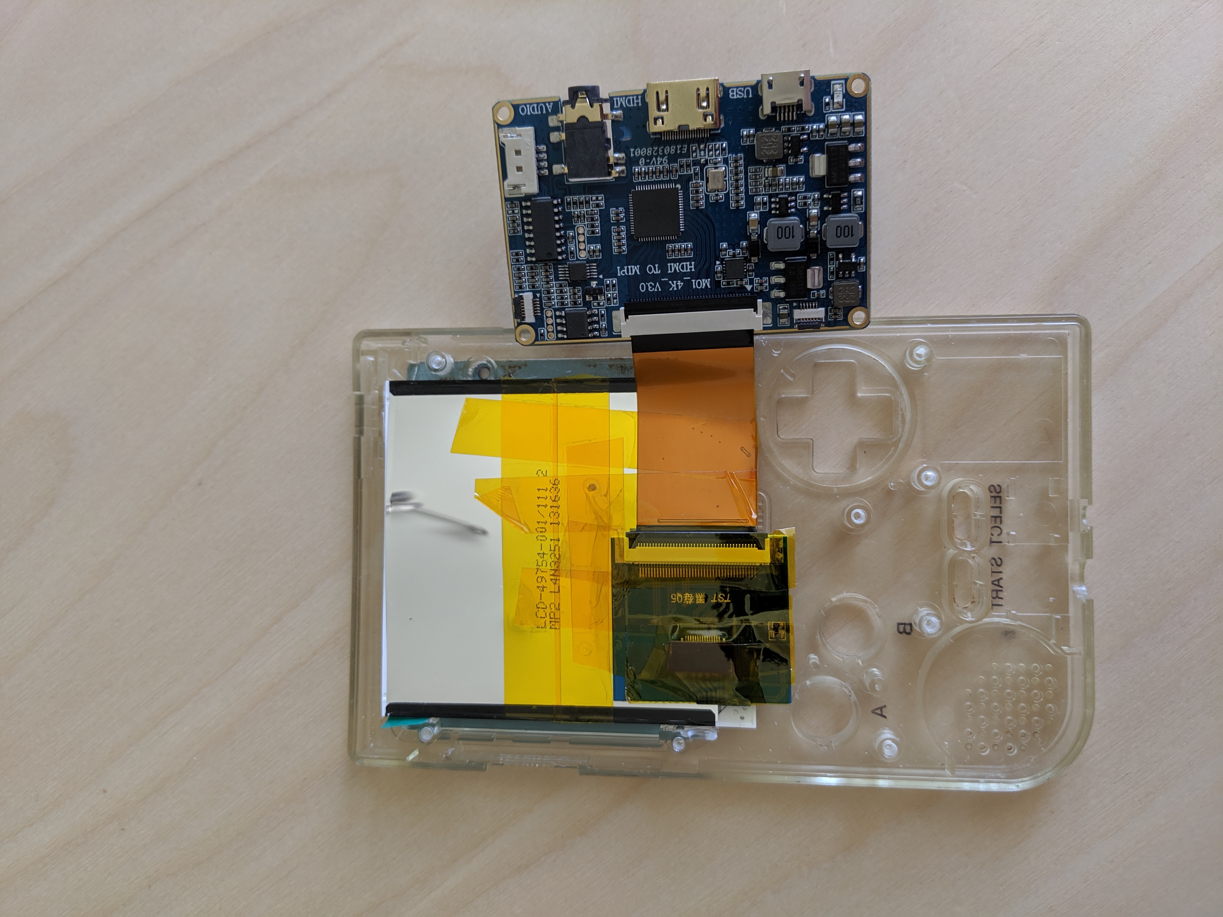

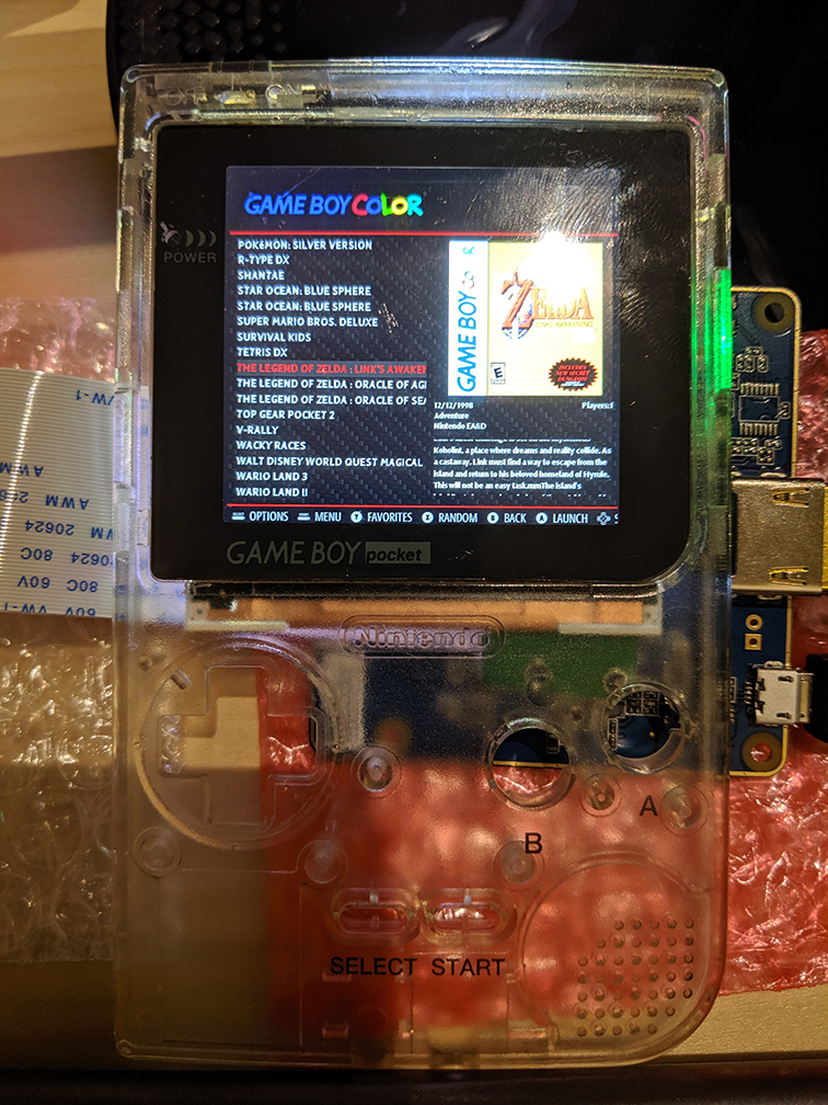

Hey!
From these previous pointers I found a shorter term solution. I found a very similar screen (supposedly from the Blackberry Q5), 720x720, 3.1", but IPS instead of AMOLED. However, you can find them with a MIPI to HDMI conversion board, so they can be connected directly to a Pi (Zero in my case), and they work at 5v.
I'll have to spend some time creating a slimer mini HDMI to mini HDMI cable to save space, but they already fit very well inside the GB Pocket. The conversion board conflicts with existing Pocaio kits, but I still have faith to fit everything into a Pocket. If not, a DMG would be okay in the meantime :)

luischo wrote:
Sat Jun 29, 2019 4:05 am
Hi everybody!!
I'm new here (and my english is not very good...), I was reading al this thread but I haven't find info about my lcd screen chip. I put some pictures if someone can help me to change this 12v to 5v for a raspberry zero.
Thanks a lot!! Its a very good and helpfull thread :)
If you need more photos or info, I'll share them.
I cannot see from the picture but this is probably the 5v regulator.
Check it's datasheet.
luischo
Joined: Sat Jun 29, 2019 4:02 am
Post by luischo » Mon Jul 01, 2019 8:43 am
tinkerBOY wrote:
Mon Jul 01, 2019 4:10 am
THanks a lot, I'll try, but I have broken the piece, I need to order a new one :( :(
