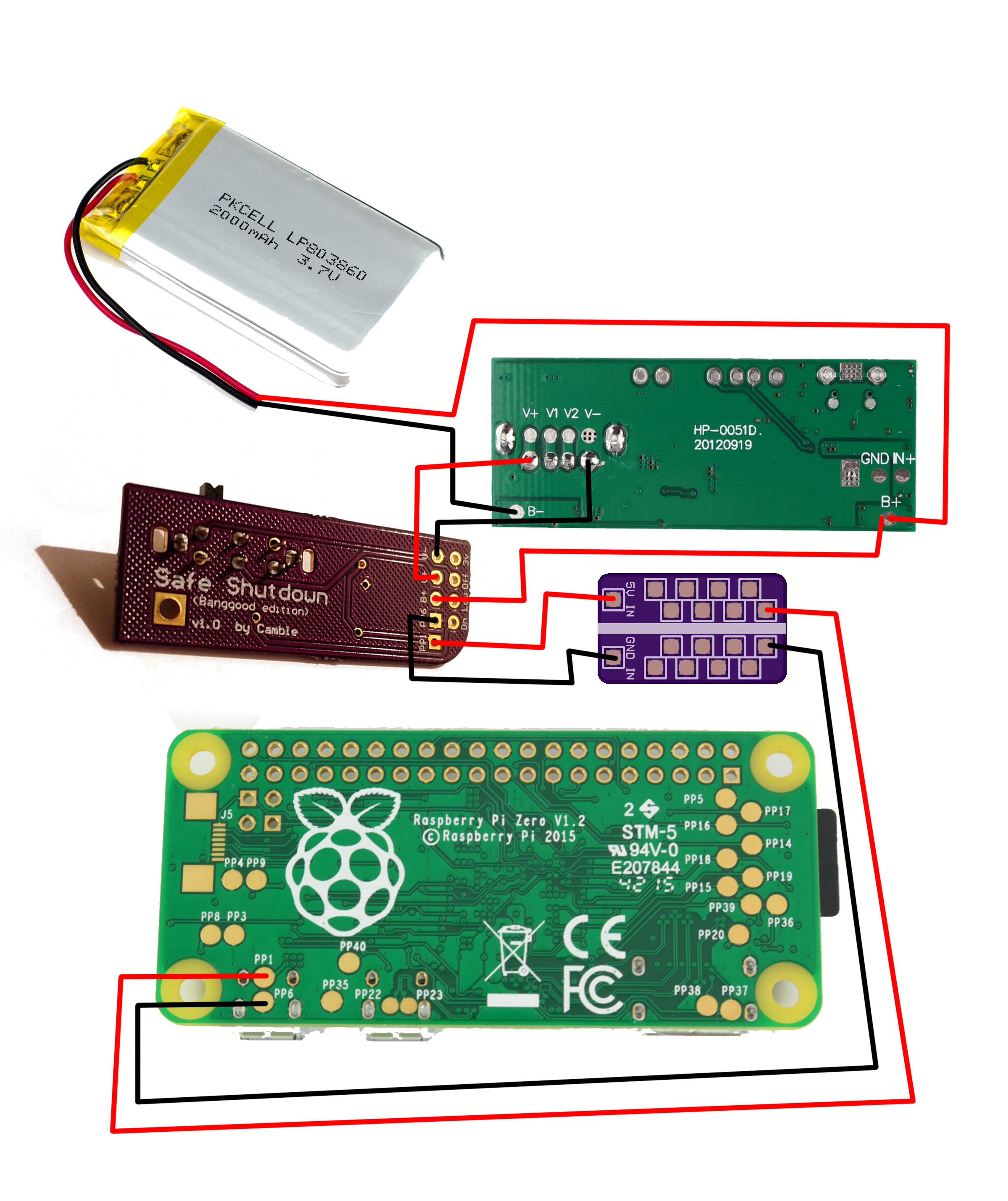

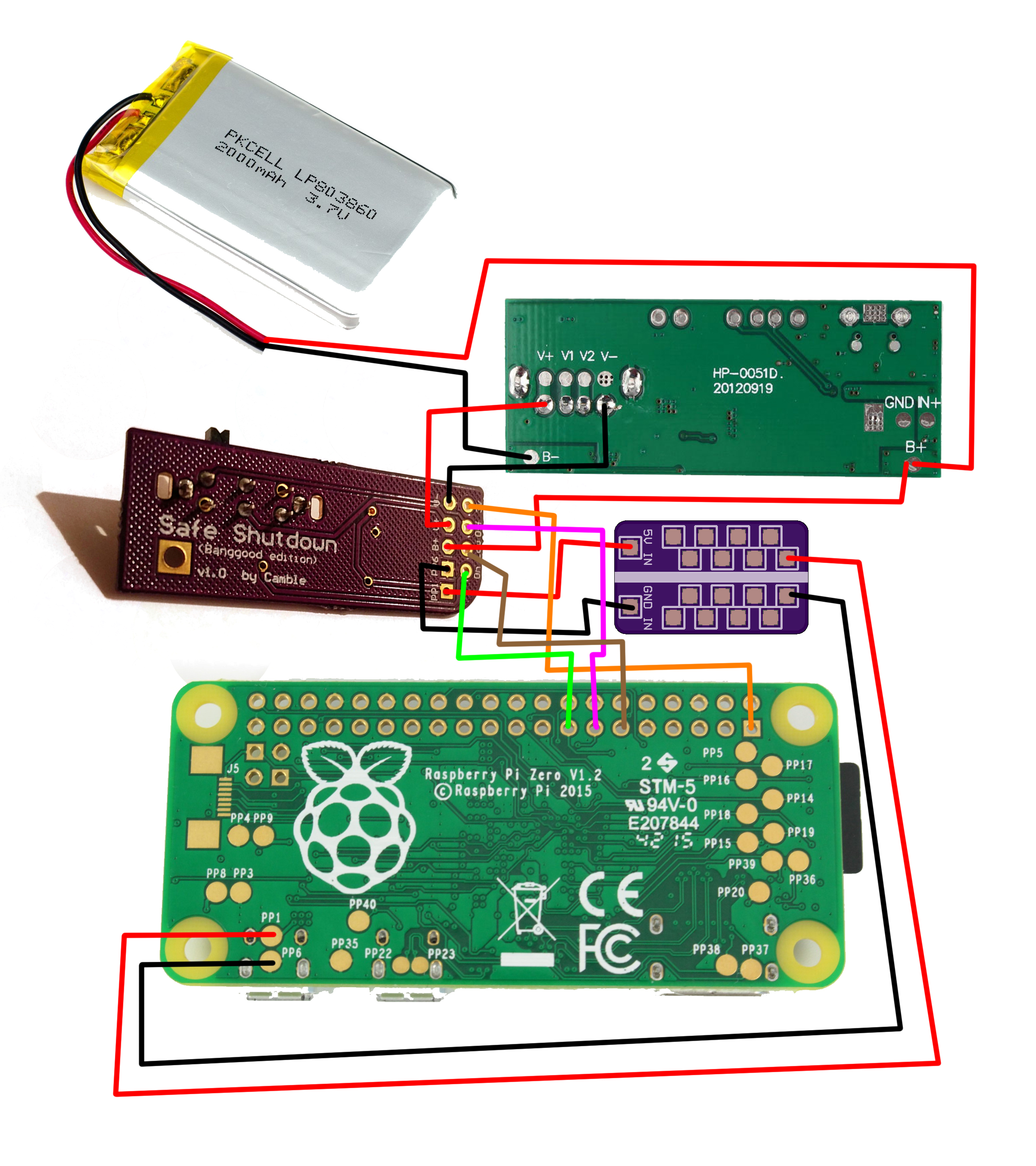

I just tried installing this circuit and while everything powers on (the pi, the usb hub, the screen and sound) all I get is a black screen. Should I have installed the script before I soldered the gpio wires? I haven't tried desoldering the GPIO wires yet just because I don't want to go through the hassle if I don't have to.
EDIT: I desoldered the gpio connections and I still just get a black screen. So here's how the connections looks right now.
Without GPIO:

With GPIO (it looks a bit of a mess because I didn't plan the placement too good when I started but it gets the point across):
with GPIO.jpg (2.11 MiB) Viewed 10052 times

@winnetouch Your wiring looks fine. Can you try connecting the BangGood power supply directly to PP1/PP6 to see if you get the same issue?

Camble wrote:
Tue Sep 26, 2017 9:42 am
It was wired directly before I installed the switch. But I'll desolder and try again and see. Will report back.
