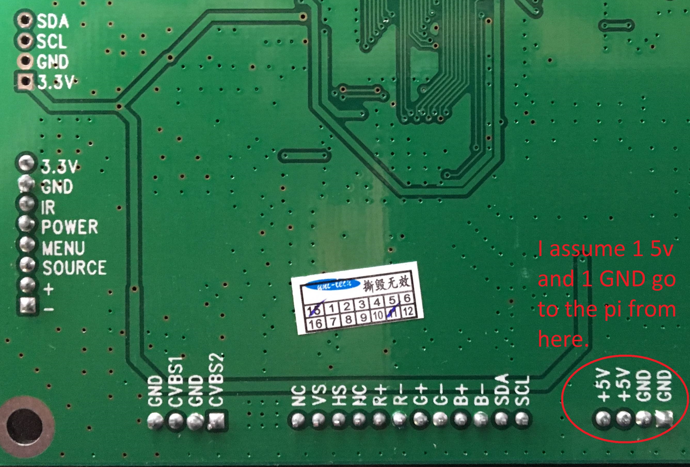

Cannikin wrote:
dirtybeagles wrote:Do you mind showing us how youth connected your screen? Did you have to convert it to run off 5v?
Yep, mine runs off of 5V just fine. It has 5V and GND connections on the controller board so I just wired one each of the 5V and ground GPIO pins on the Pi to those, and then the composite signal from the Pi to the controller board as well. You don't really need the separate composite ground wire as ground is ground and as long as you've got one you're good to go.
So we need to wire BOTH of the 5V connections from the board? Both to two of the three connections on the powerboost?
Cannikin
Posts: 127
Joined: Wed May 11, 2016 3:10 pm
Been thanked: 36 times
Re: Full VGA resolution (640x480) 3.5" display, composite in
Post by Cannikin » Sat Jun 04, 2016 8:57 pm
Ganreizu wrote:So we need to wire BOTH of the 5V connections from the board? Both to two of the three connections on the powerboost?
Nope, any 5V connection on the control board is the same 5V so you only need to hook up one.

And third :) I guess you have to explain it to my like I am 5.. on the back of the board for the screen, I am not sure which one is the composite for video I need to connect to the pi video.

CBSV1 is the composite connection. You could do CBSV2 as well, it's just a different input on the screen. Once you wire it up you have to use the button board to change the input to the composite source you picked, the screen will be black until you do that, so do not desolder that button pin connector yet.
