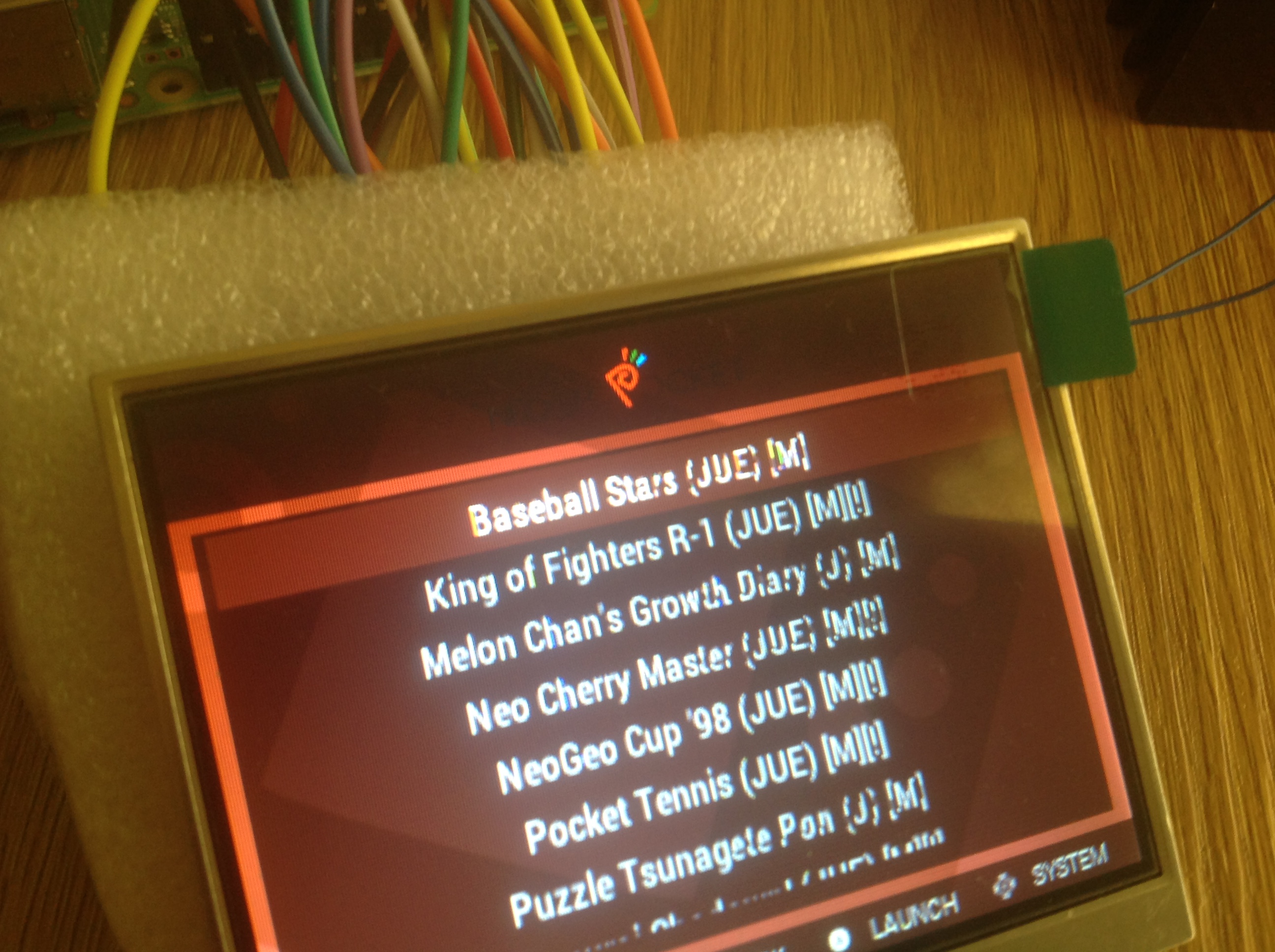

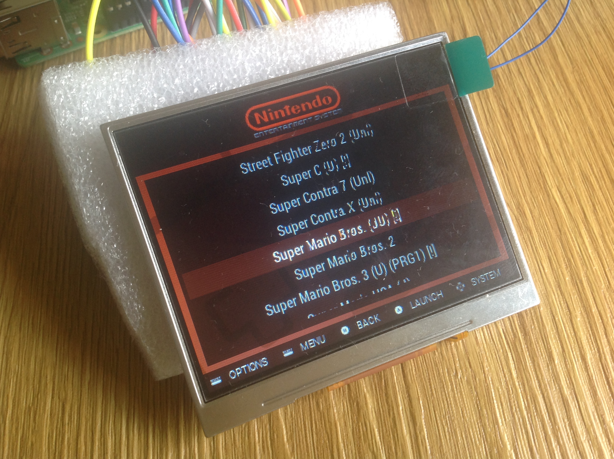

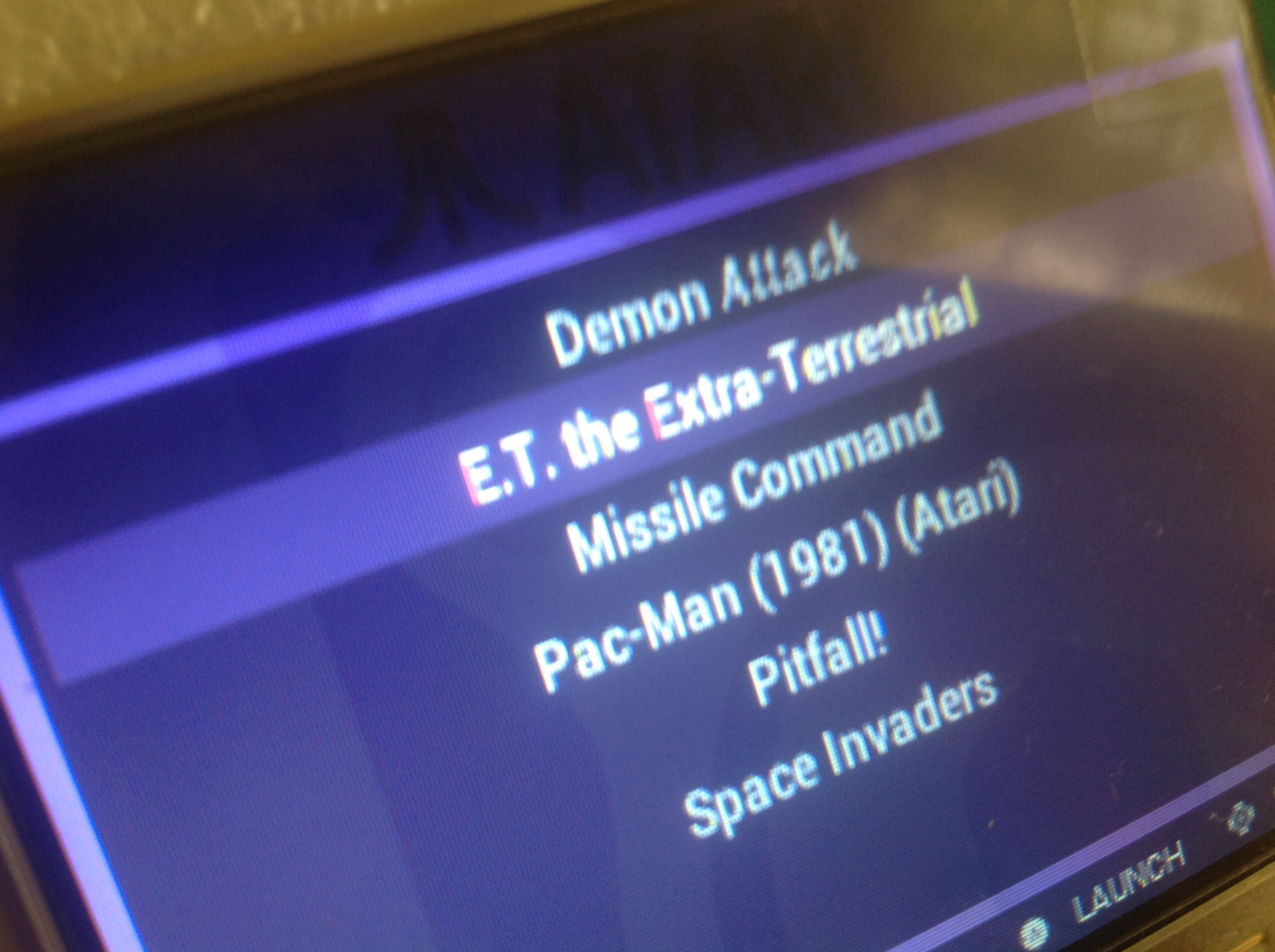

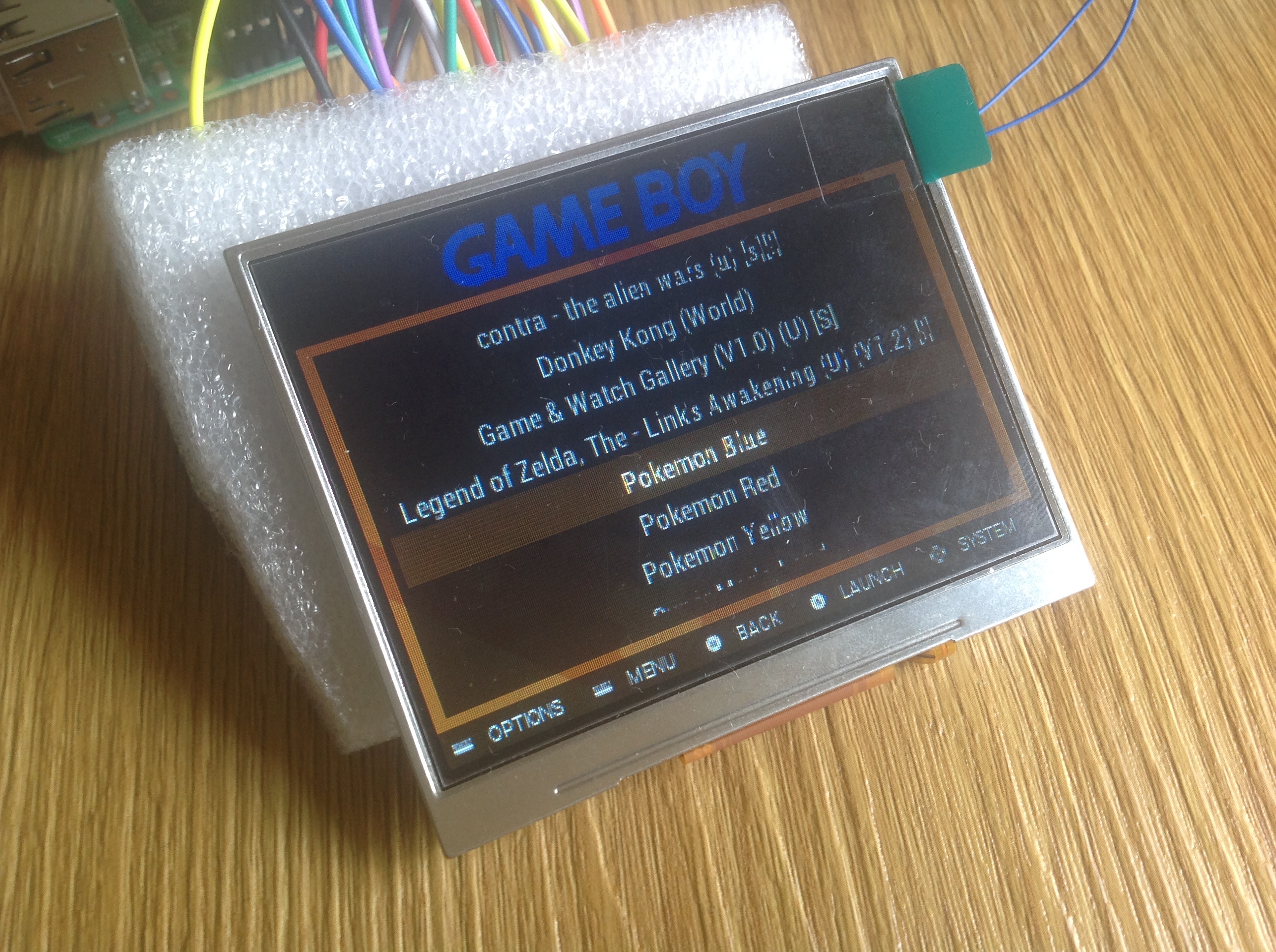

I tried both dark and light version but text are a little rugged and some red/yellow color on the edges. Im using it on a screen in 24bit or 18bit DPI mode.
