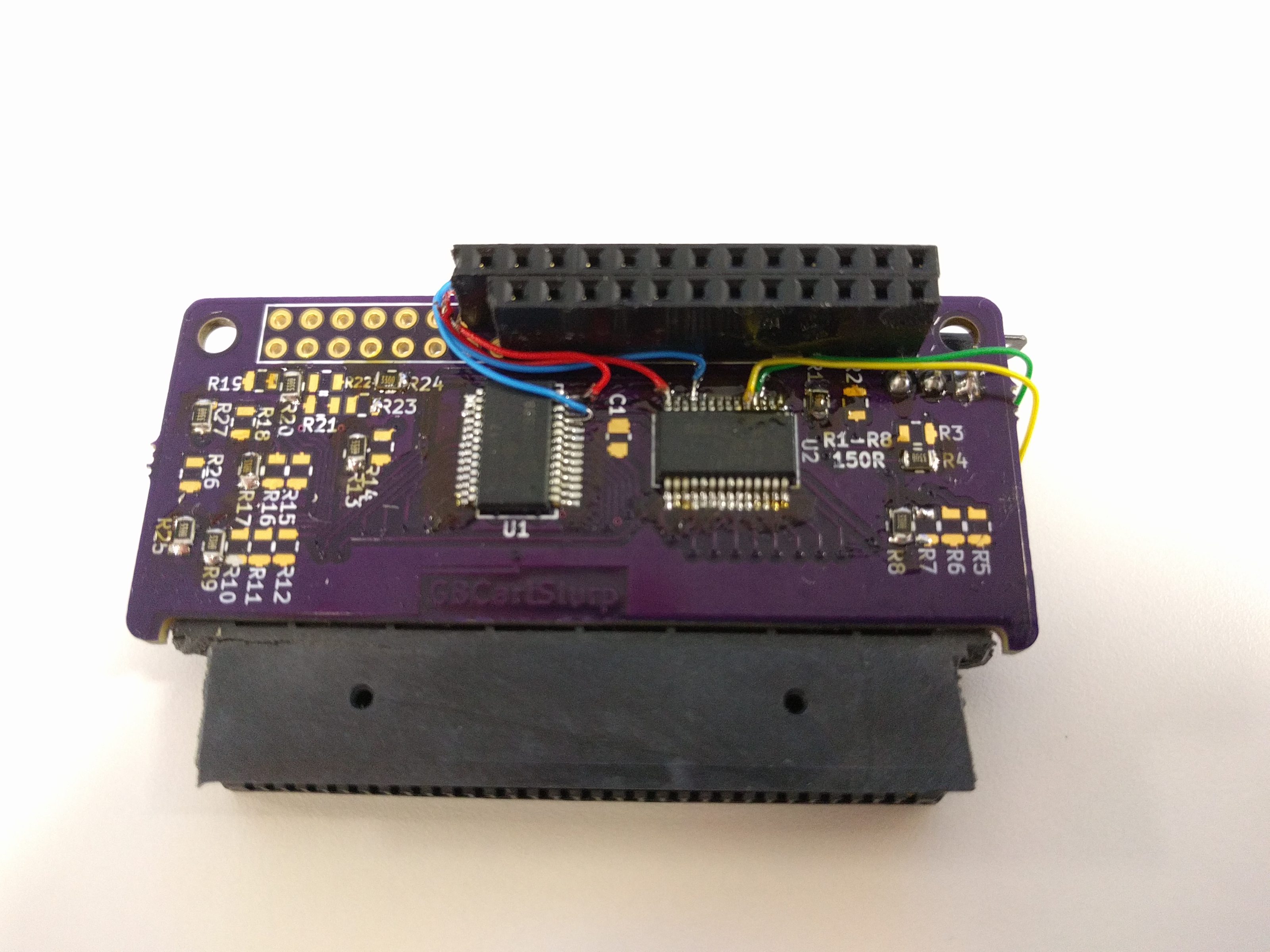

I hacked one of the I2C boards to have the SPI chips on them (they are mostly the same but obviously take SPI signals instead of I2C, so 2 pins have to be re-routed and 2 new pins have to be connected PER CHIP) by dropping the header socket connections out of the socket, and wiring the appropriate SPI header lines to connect with the correct (former) I2C positions, and wiring new jumps from the SPI header pins to the chips legs directly. Quite a task on fine pitch SSOP chips I can tell you!
anyway the result is a working (if fragile) SPI version of GBCartSlurp.

The mods to make the I2C version SPI compatable:
(and only a token number of LED's installed for easy testing)

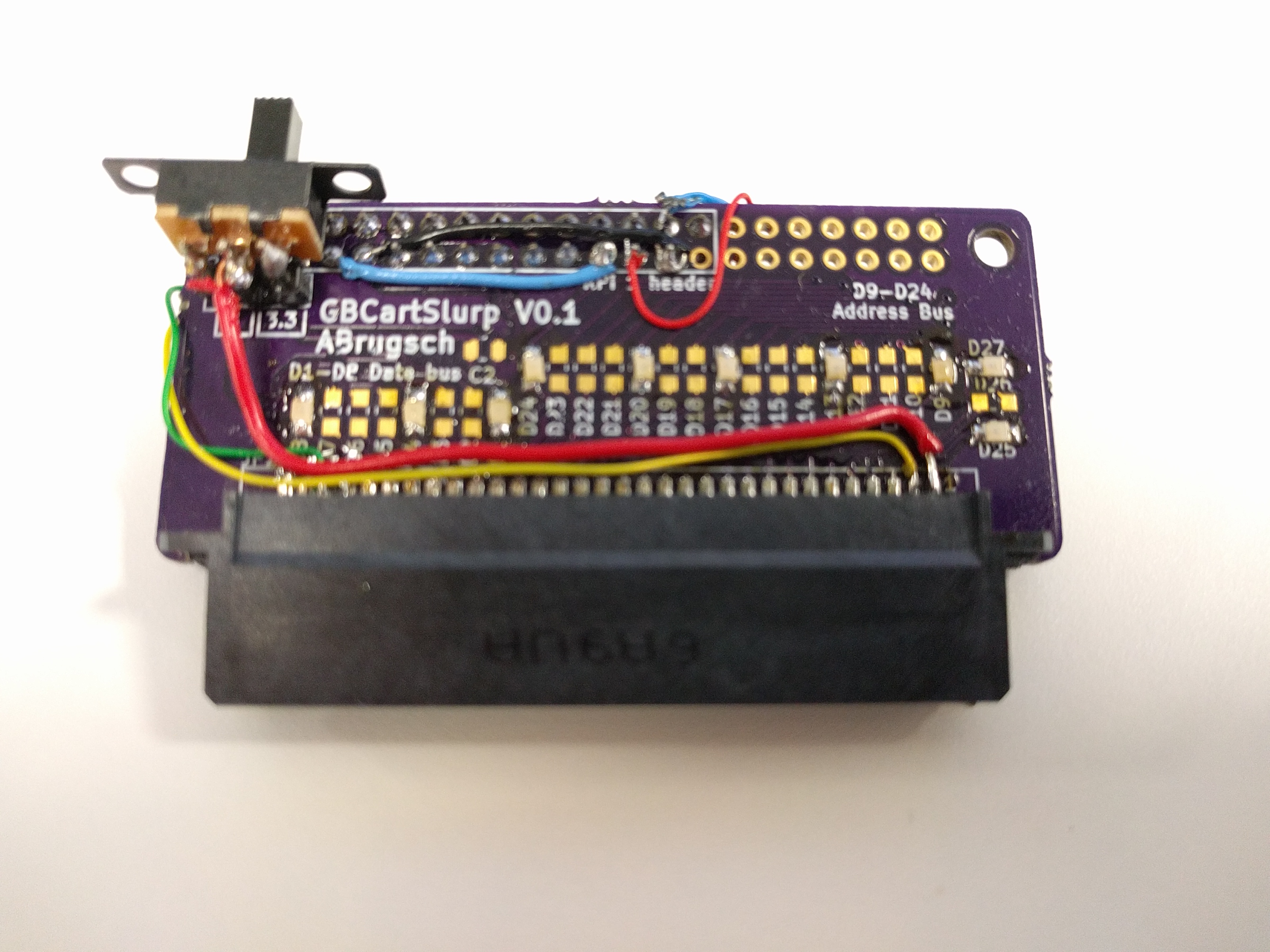

so after wiring up the I2C->SPI board above, my actual SPI boards arrived and I've built one up:
I'm still trying to get sequential writes working, but even if I don't it's probably not going to increase speed anywhere near as much as just the switch from I2C to SPI.

the difference is in the PCB pin arrangement. on the NDS/DSL it's surface mount. GBA is through hole. Look closely at this pic:
I'm going to maybe make a Through hole version eventually but it's REALLY low on my priority list
