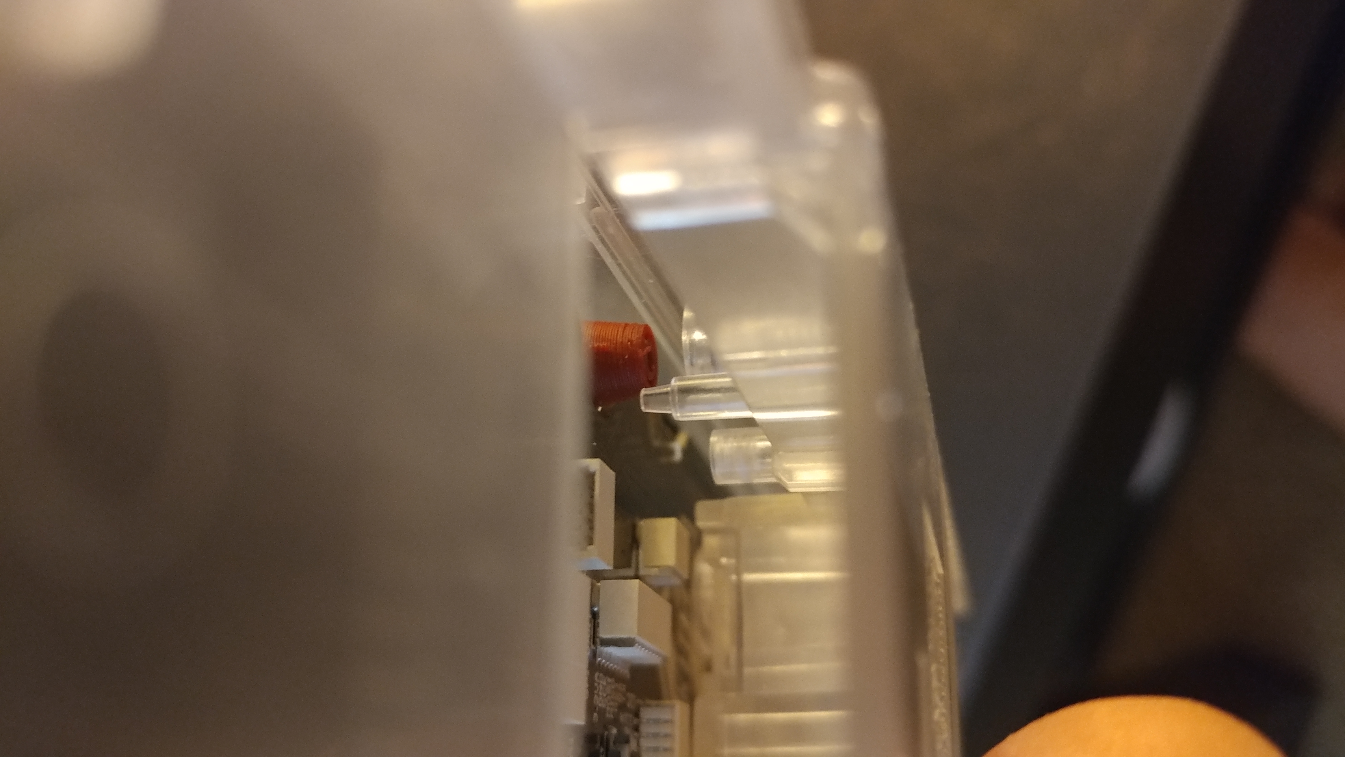

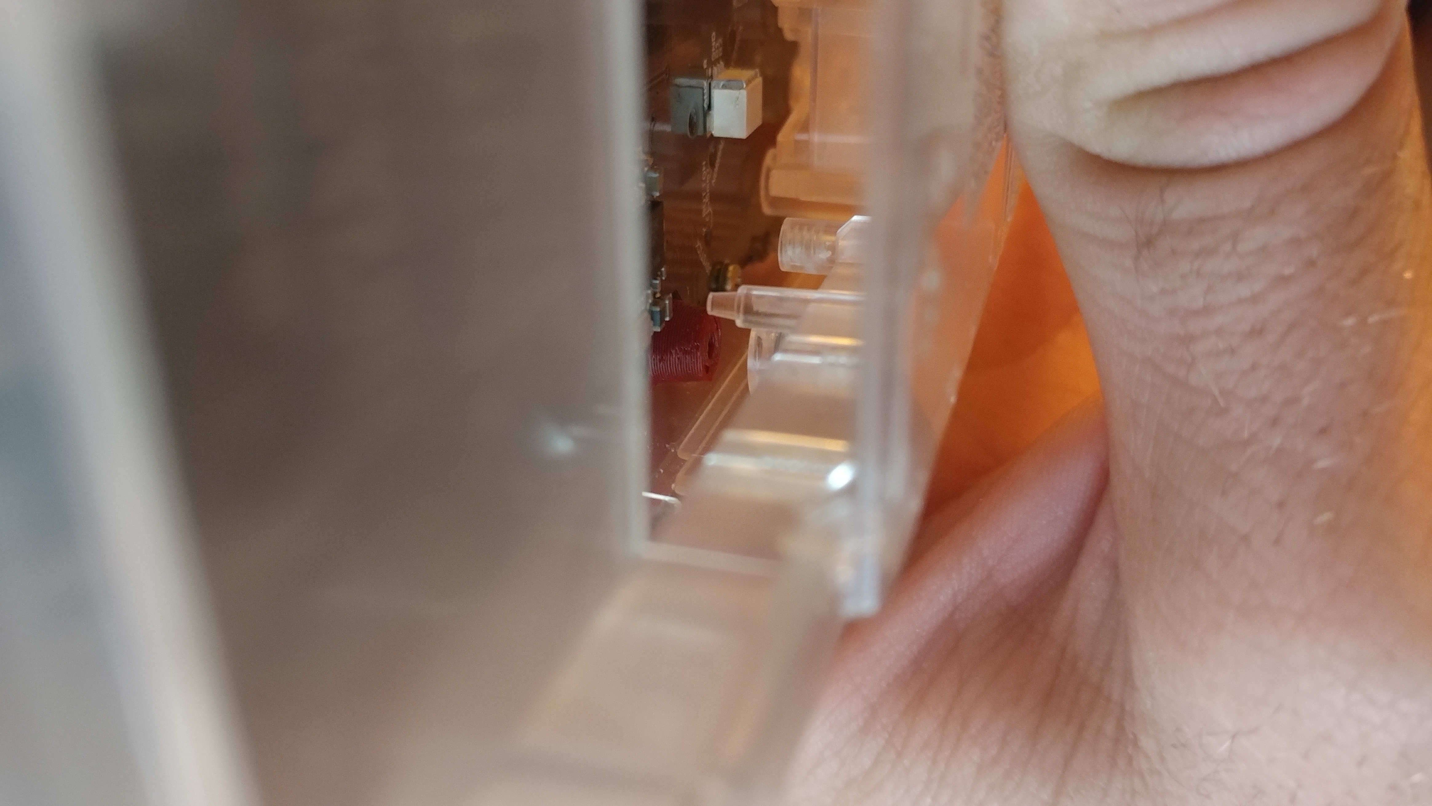

I printed your screen bracket and noticed that the bottom screw posts have about a 1/4 inch gap between them and the back of the case. Is there a reason for this?

If it touched that post it would interfere with Kites daughter board and not close all the way. The other side is the same way in case you used original GB cartridge holder which has the same height. If you look at the bracket you will notice that the two post on the volume/USB side are slightly shorter. That is by design to accommodate that daughter board that gets sandwiched between the main board and the case post.

Ok cool. Thanks for the help and all your hard work making this.
