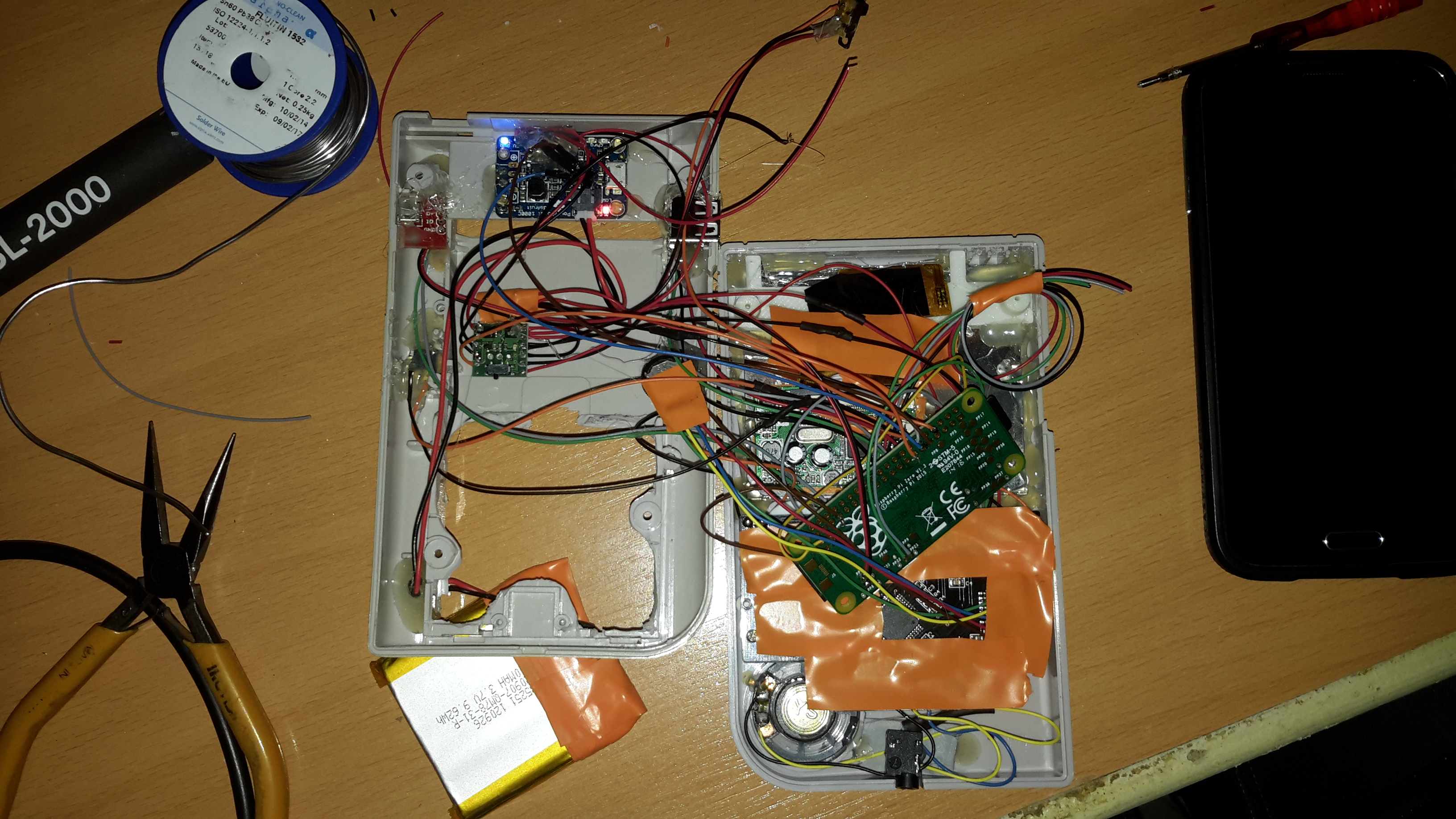

When i connect my lipo to the adafruit power boost, the blue and red led are shining.
If i push the power button all will be work but the retropie restart all the time. It comes the de logo from retropie and after that it restart again, again and again :(
have someone the same problem or is it a config problem?

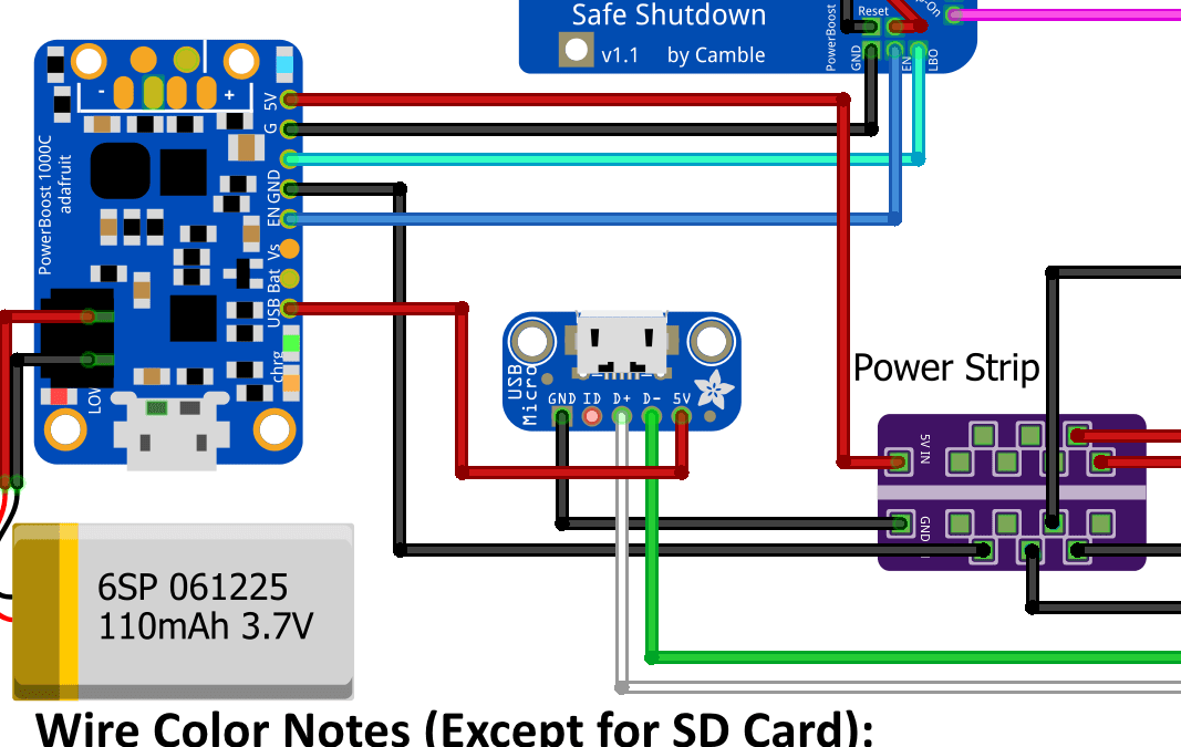

Post by DeltaShadow » Thu Sep 22, 2016 6:14 am
Just wondering why the main ground is run from charging port rather than powerboost is there a reason why this is or does it really matter?
hueblo
Posts: 175
Has thanked: 78 times
Been thanked: 81 times
Re: [GUIDE] Wiring Diagrams: all-in-one board, graceful shutdowns, audio-only board
Post by hueblo » Thu Sep 22, 2016 10:06 am
DeltaShadow wrote:Capturepwr.PNG
I do believe it does not matter

Does anyone have a schematic or diagram for just the BangGood Power Supply.
Something that shows how the battery goes in, where the battery gets soldered in? And how it goes into the power strip?
Any other caveats that are important does not have to include any safe shutdown stuff.
Thank you
