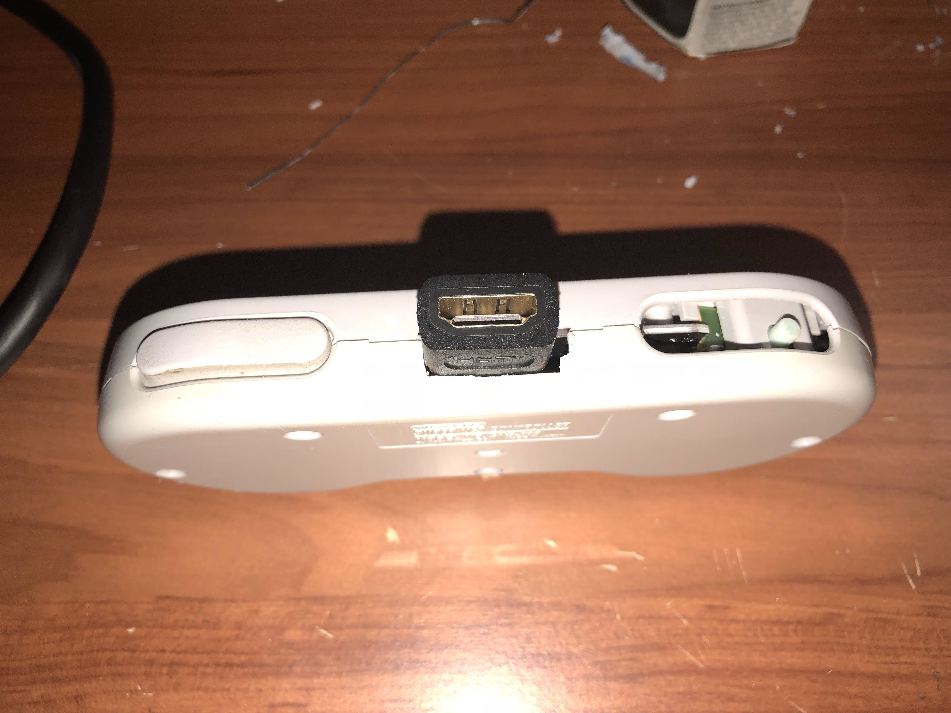

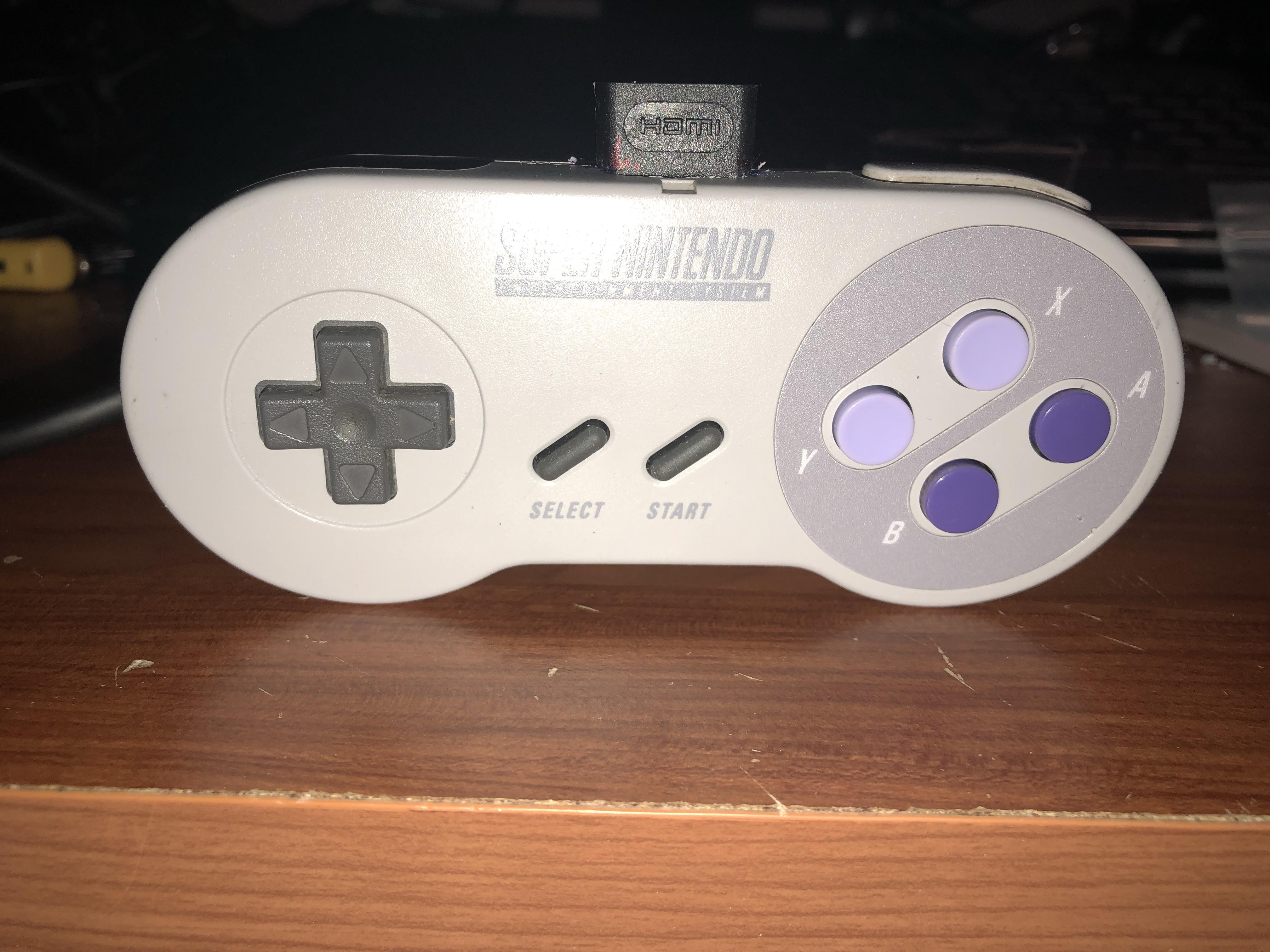

Re: [For Sale] PRS-Tech SNES-Zero. Complete retro gaming in a SNES Controller
The cable did not work. So I have done my own mod and it works great! I did it on an old controller case but I will get a different one and clean it up and make it look nice. This is my prototype
Well, that's extremely disappointing.......
The engineer in me would love to focus in the cause of the power problems............. I did something similar to what you are showing and ended up damaging the HDMI connector. It now has intermittent video when I move the controller due to a lack of strain relief.
