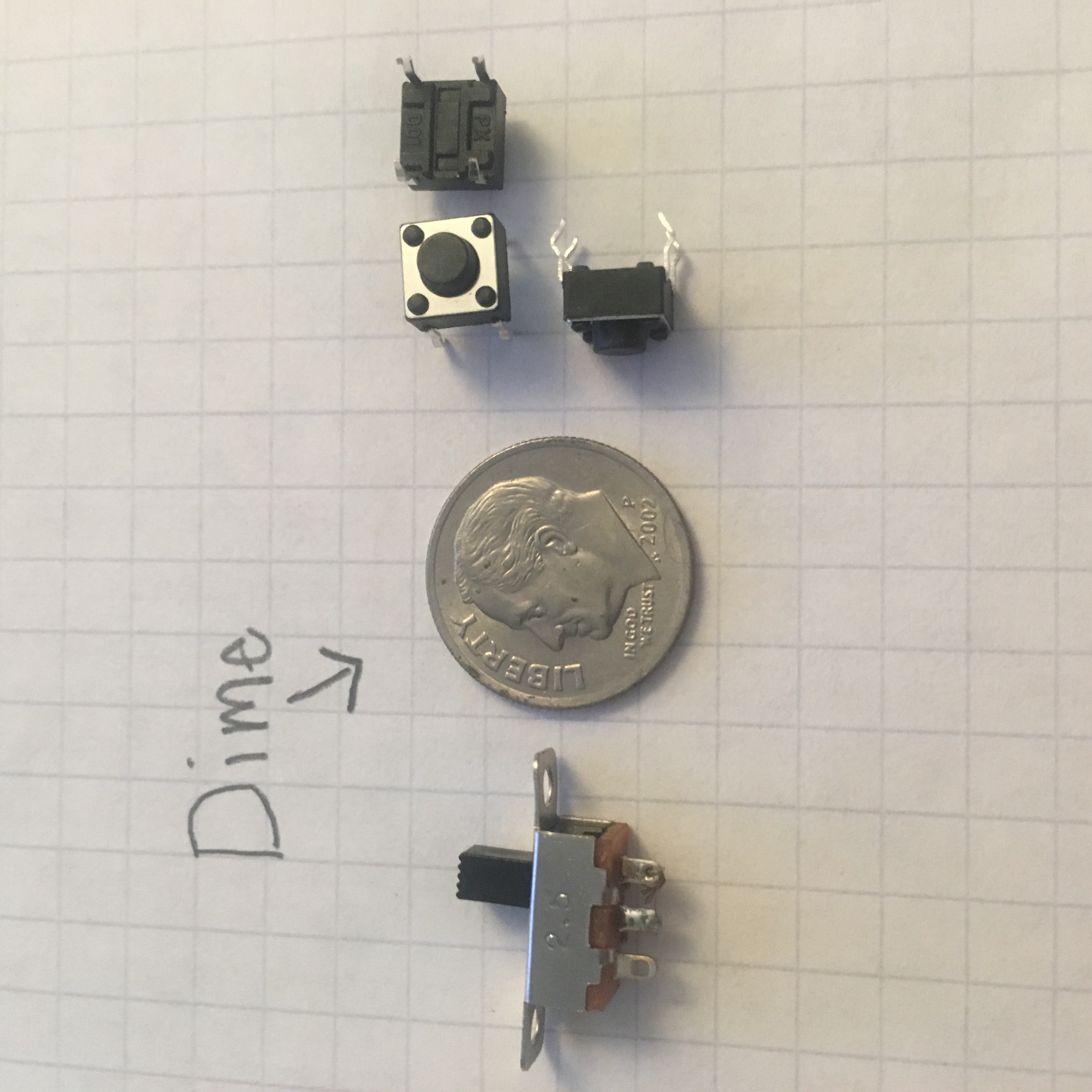

Re: mintyPi Frequently Asked Questions **READ THIS**
Post by mmacneill30 » Mon Jul 17, 2017 9:31 am
Hi, does anybody know if these parts will work for the MintyPi?
