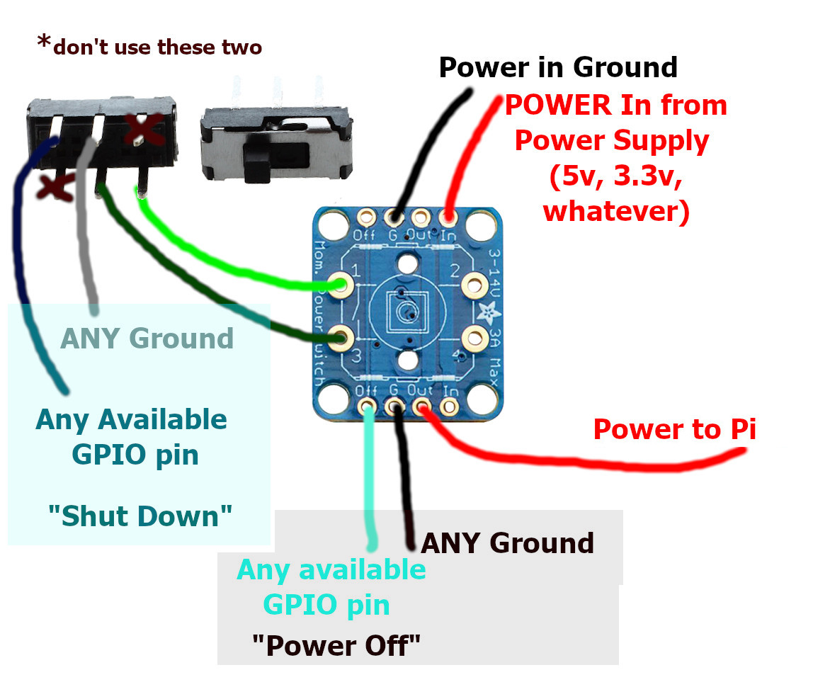

For those struggling with a way to achieve a Safe (software) Shutdown, here is how you can wire the Push Button Power Switch breakout board with any power supply / PSU, using a DPDT sliding switch.

Wiring:
Software:

and that's it. It should power on when you switch to the one side, then trigger the shut down command when you switch to the other side, which will send a signal to the board to power off at the "off" pin when it is done. If the pi is locked up, or otherwise not responding to the shutdown/poweroff sequence, all that you need to do is switch the switch back-and-forth again and it will cut the power - no need to open up the battery compartment to disconnect it!

I haven't tried it, but I think if you have a PowerBoost or other PSU with an "engage" (en) pin that turns it on, you would just need to wire one more wire from that "en" pin to the unused leg of the switch that is on the same row as the "shut down" ones, and I think it would work the same
