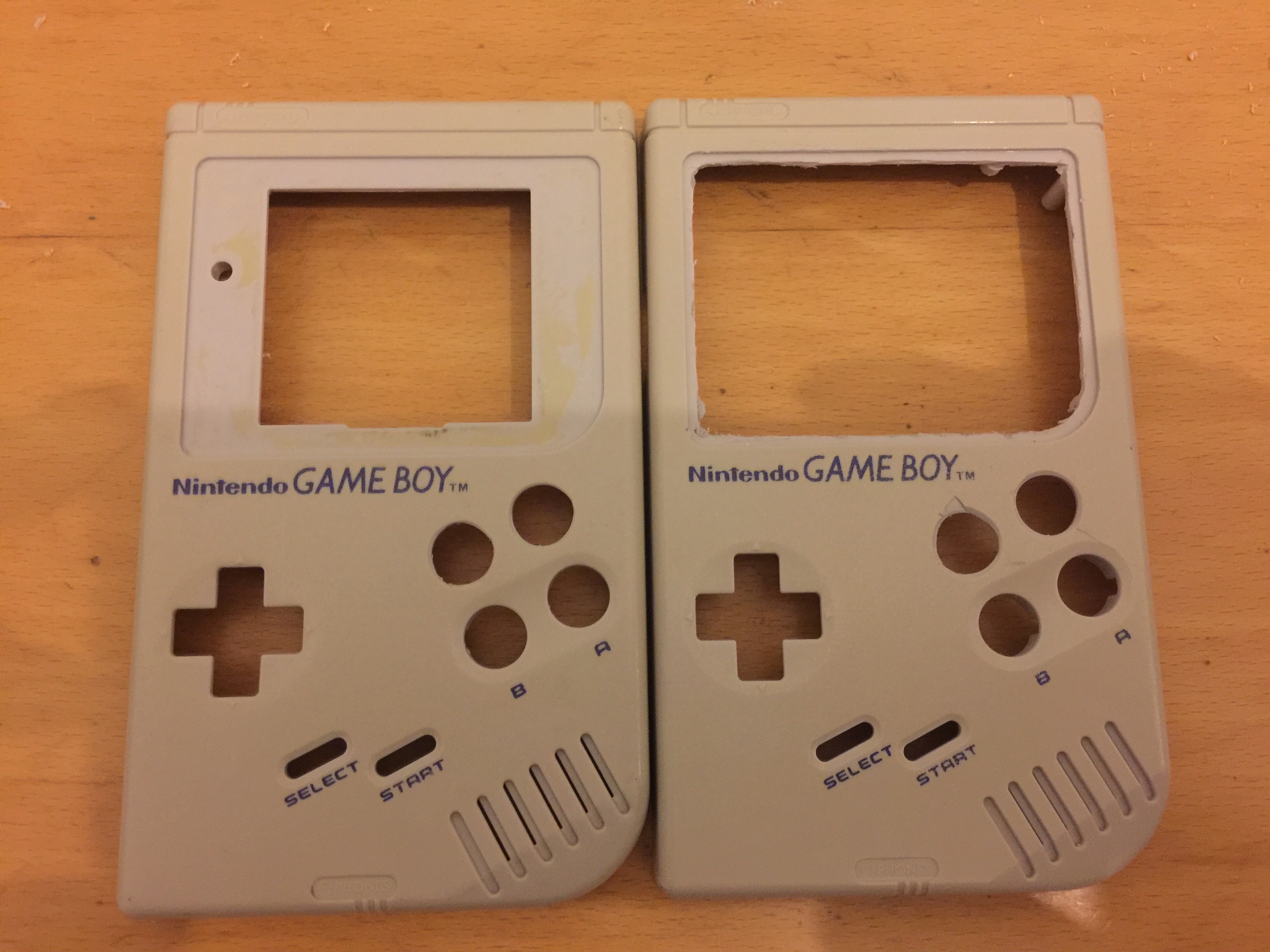

While drilling the button holes on the right GB, the drill got stuck and small parts of the shell cracked apart. Nothing major and fine for myself, the left one is still fine and will be my nephew's Christmas present...
Bezel on the right like looks ok already, this hasn't been finished with sanding paper yet.

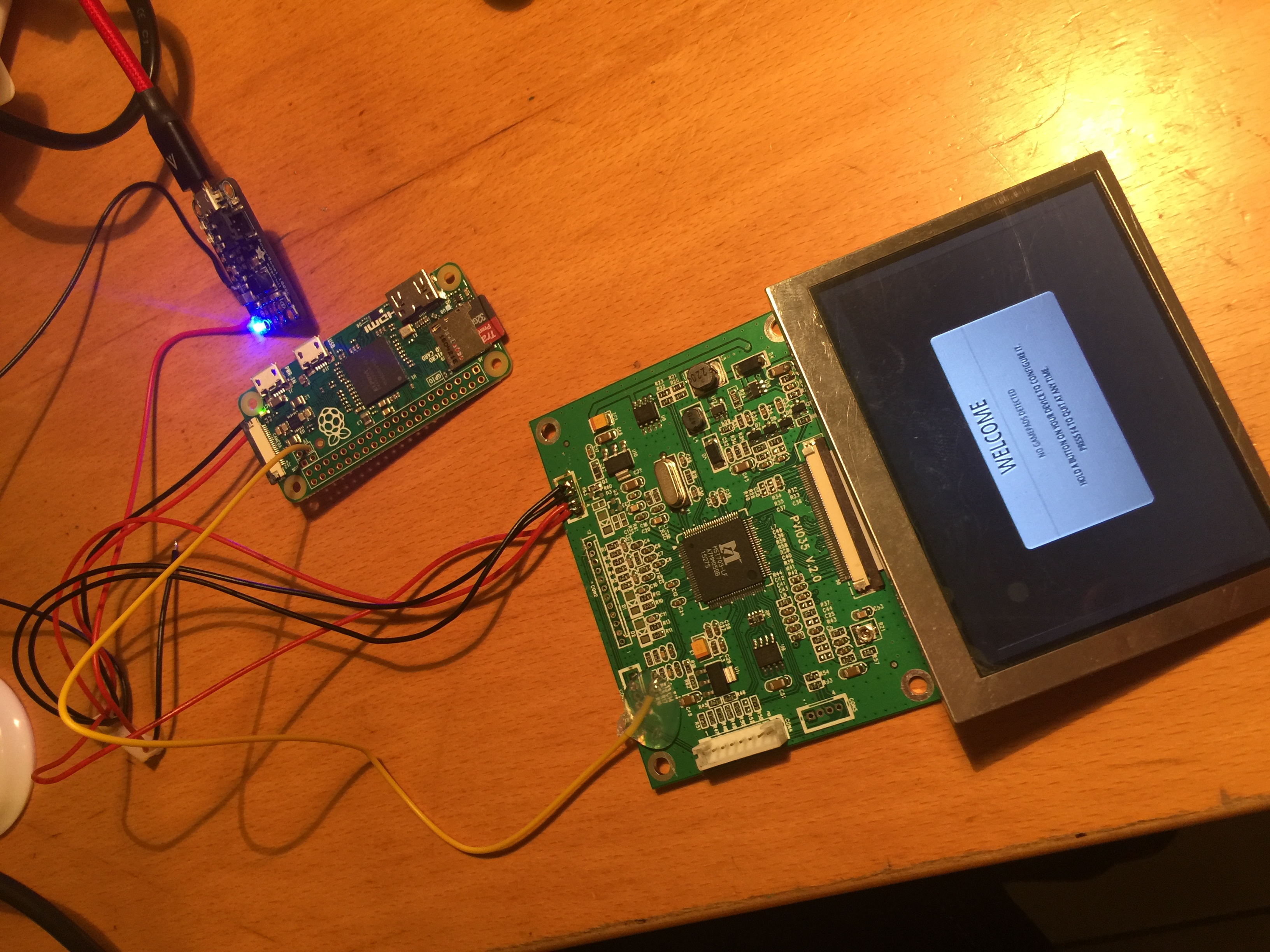

I also started the wiring, the screen is alive. Here I also made a small mistake when desoldering the pins, too much heat and the small copper rings in the whole were gone. After using my Xacto knife, I was able to solder directly to the printed outline, unfortunately I didn't use hot glue the first time, so that connection also ripped apart. Some small piece of copper was still available and I managed to get it working, and this time I secured it using hot glue.
I'm quite sure that I wouldn't need both 5V and GND cables provided, but as this part seemed to have some damages from desoldering, I chose to be on the safe side.

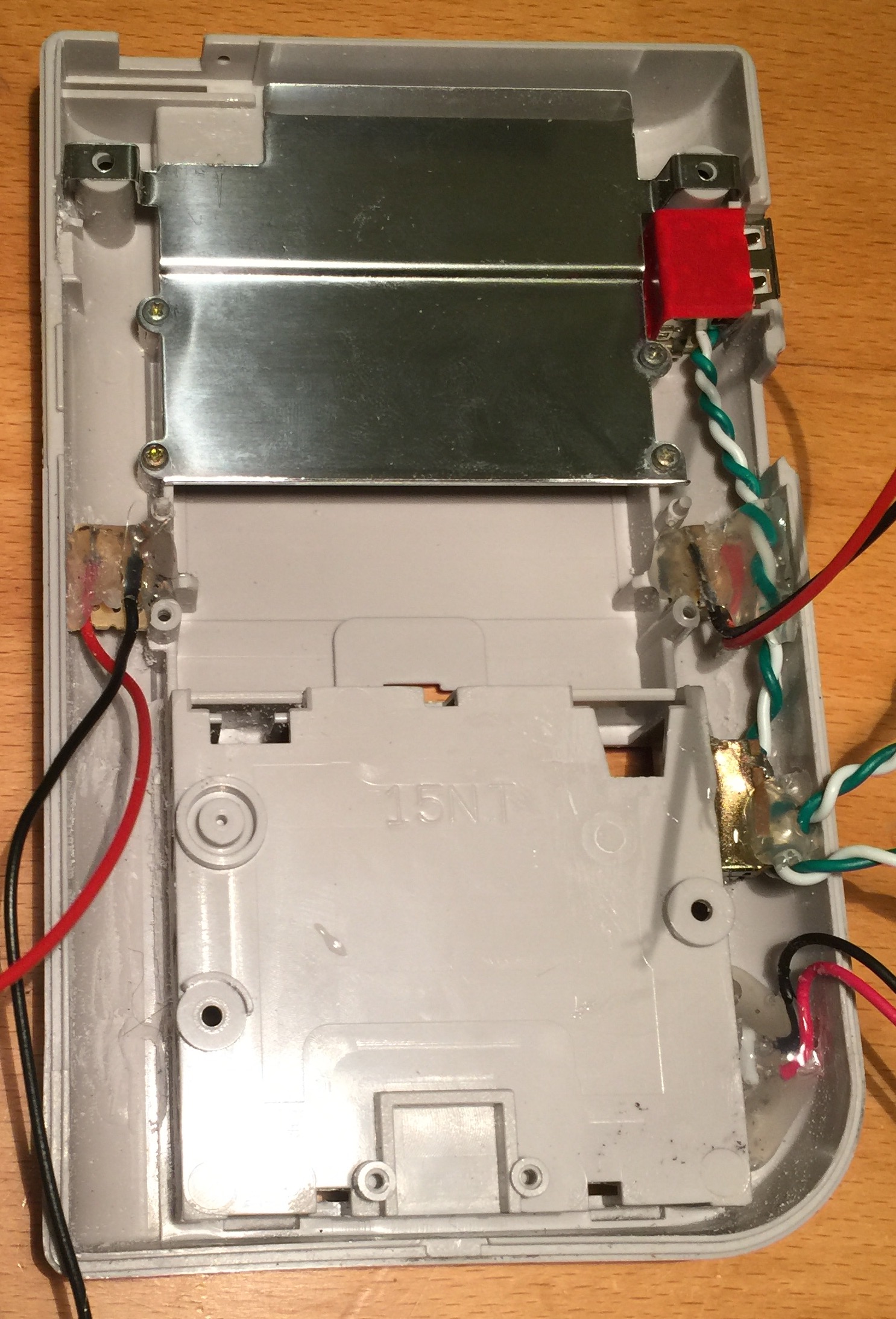

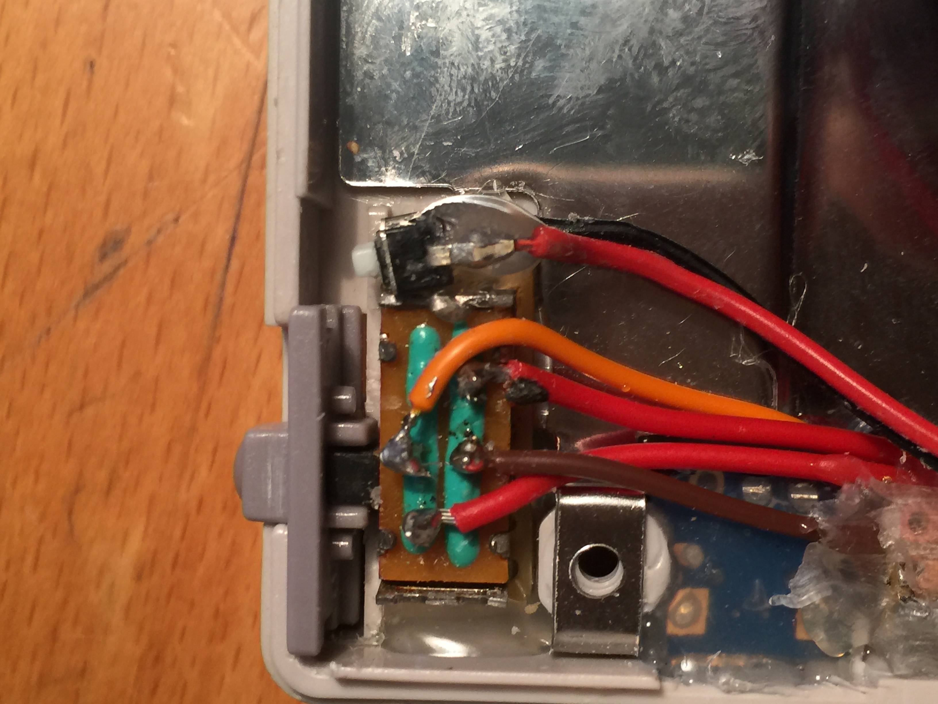

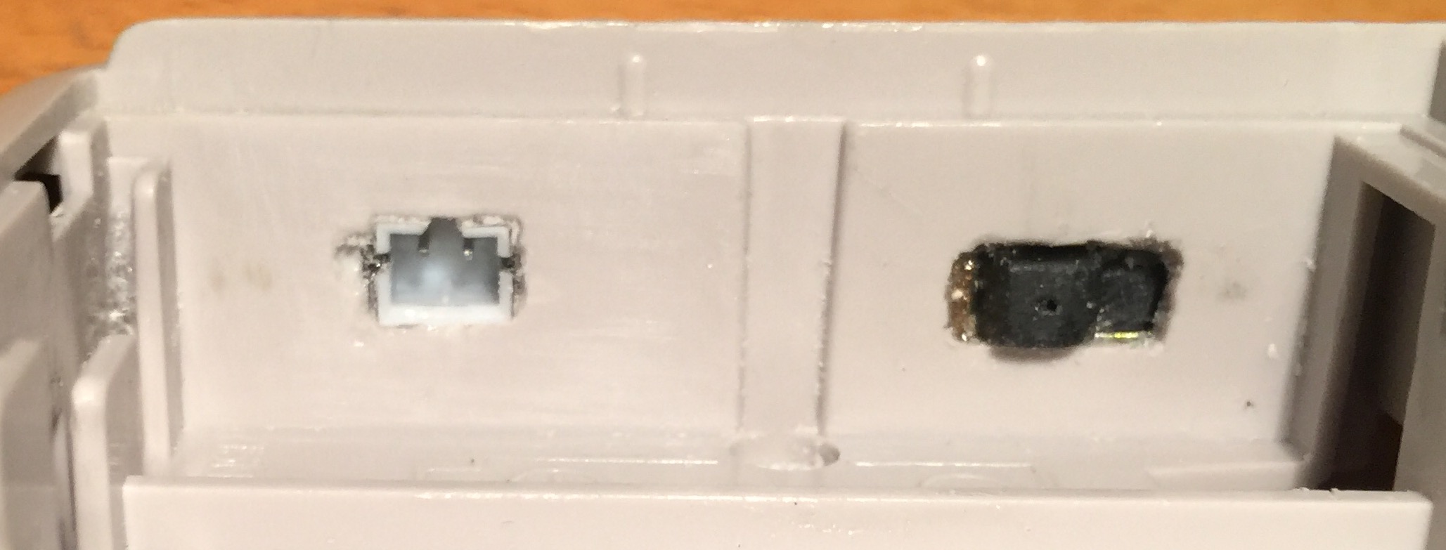

I added the tact buttons on the back, installed the USB port as well as the switch at the battery compartment to be able to choose between USB to Pi or control board to Pi.
As I found the fitting battery (still not here yet), I also added a connector to the compartment. Both cuts are not super clean, but working.

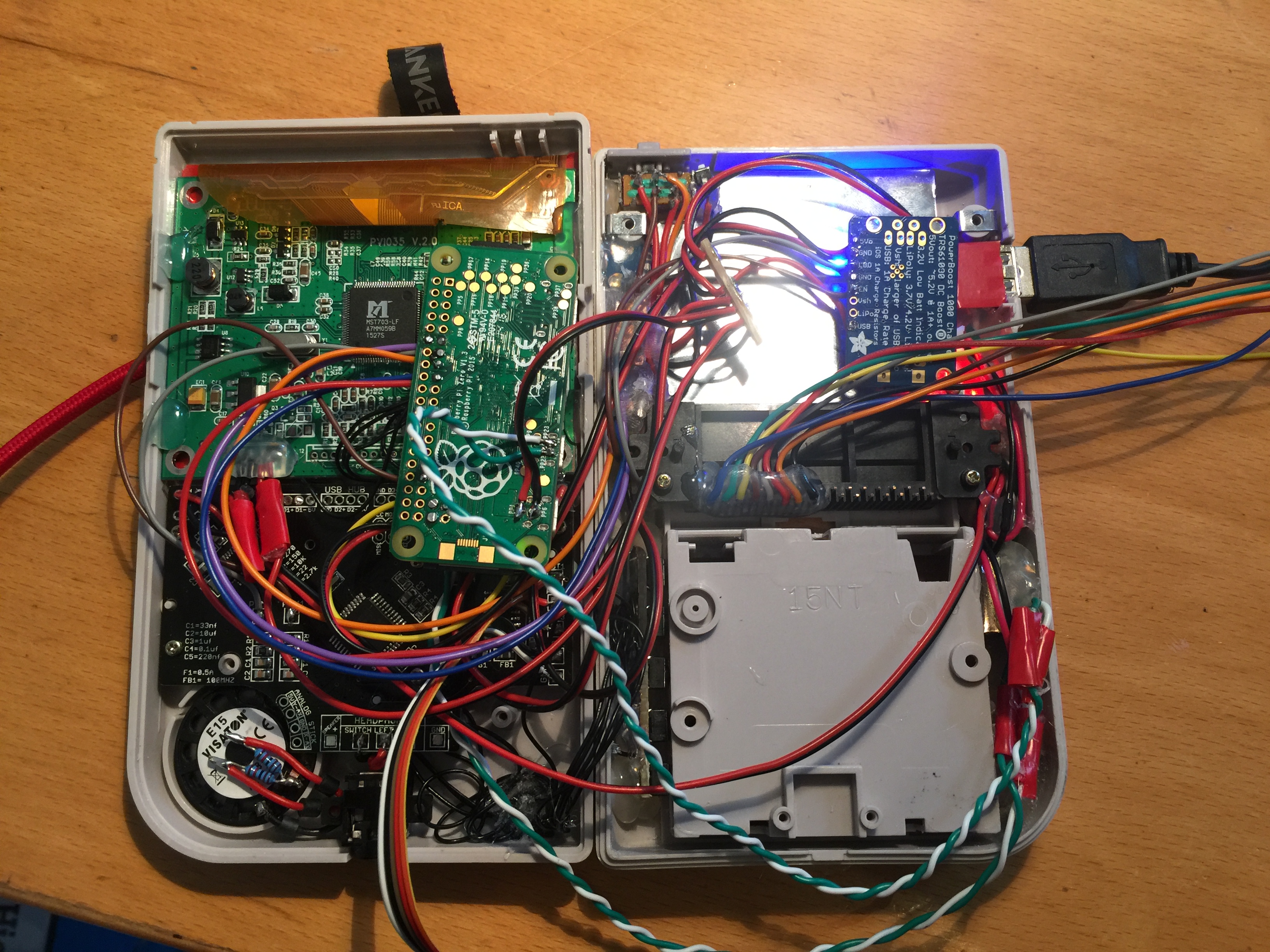

I'm done with putting everything together more or less.

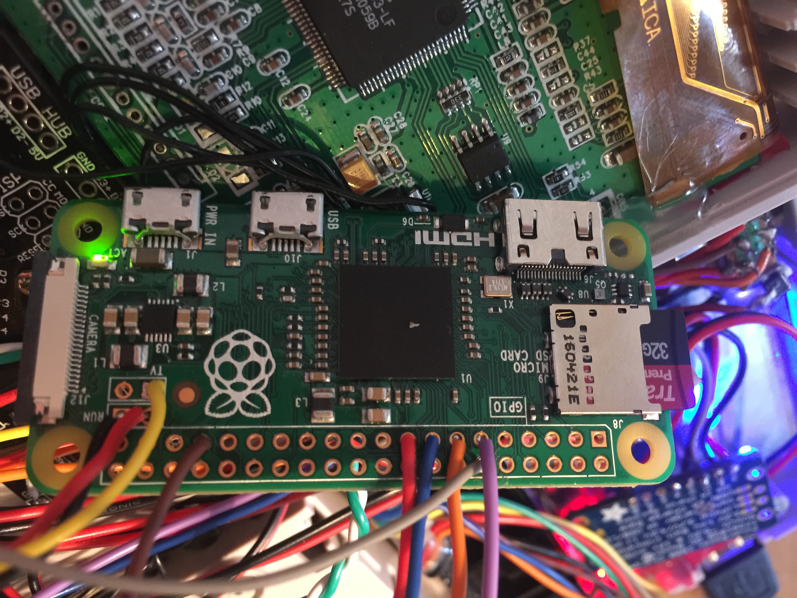

Unfortunately I have two major issues at the moment:

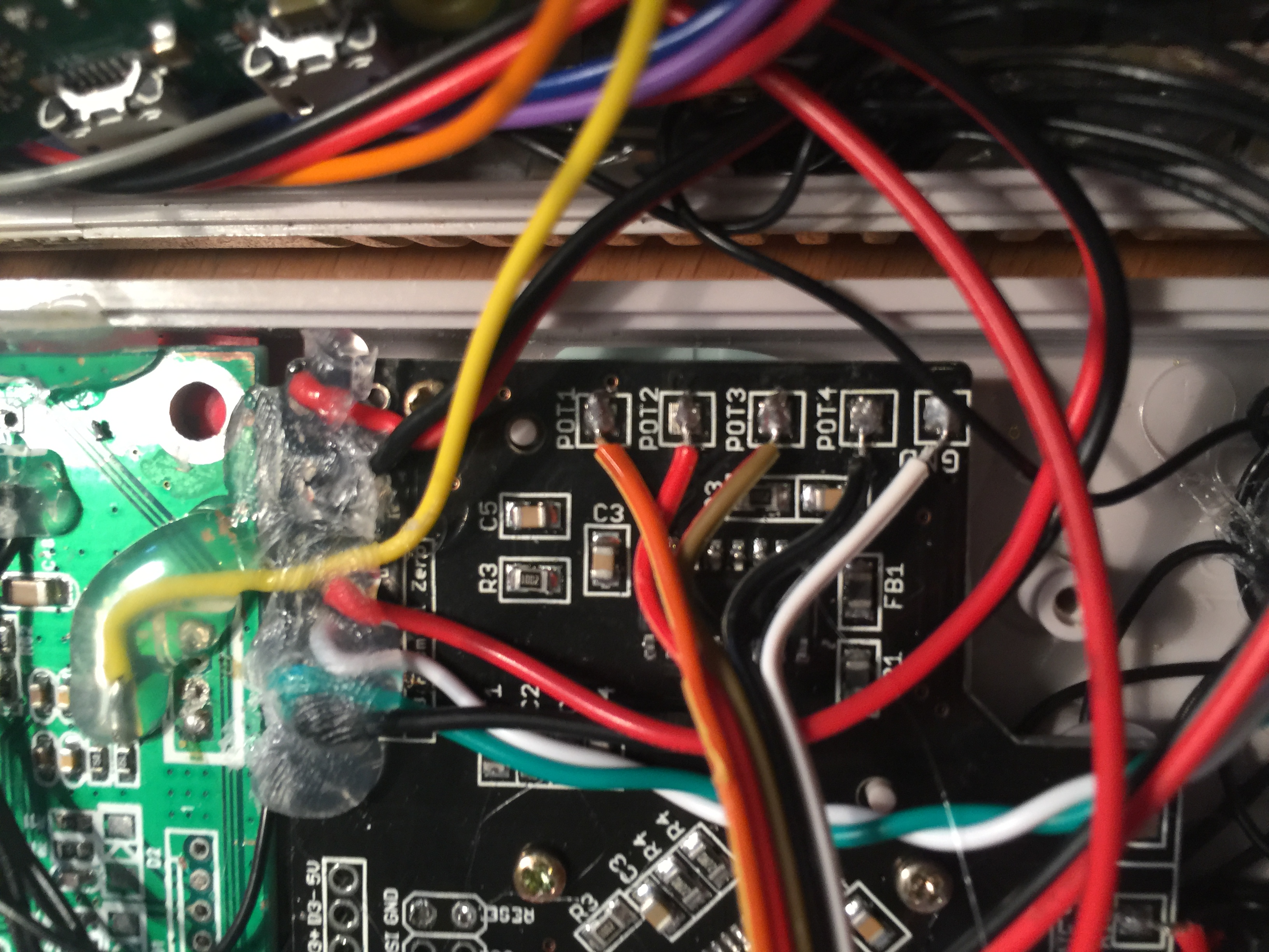

1. No sound.
Using the standard wiring diagram and updating the config.txt per the PWM audio guide didn't bring any result.

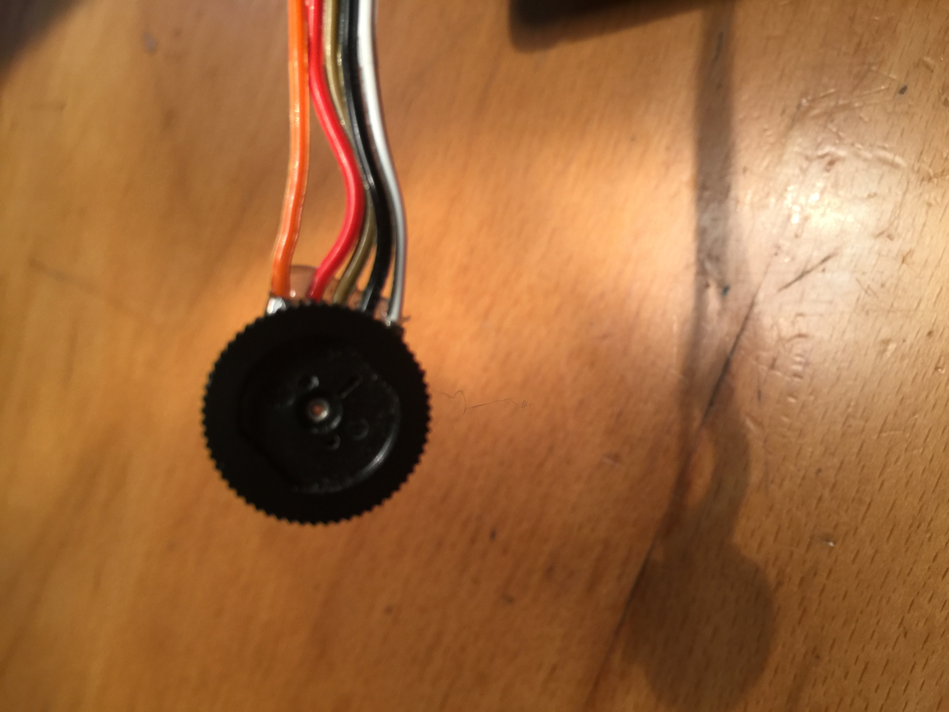

Pictures show connection on PI, brown and grey cable. And also the connection to volume wheel...
2. Power switch works "wrong way"
When putting in a USB cable, having the switch in the off position, the system still starts. Sliding the switch in the on position shuts down the system. I have added the graceful shutdown, but self-build. I see the potential problem there, but have no idea how to fix this.
Wires on the switch are:
top left: 3,3V on PI
top right: Shutdown (GPIO 27)
bottom left: EN (Powerboost)
bottom right: connected to Drain
The board is located at a different location in the GBZ, therefore not visible in pictures.

Sound is working now. Eventually found out that I need different wiring for my GB jack, added this in the headphone jack guide by Fleder.
Power switch at least works as it should, but I'm unsure about the safe shutdown. Going back to work and check my wiring again...
