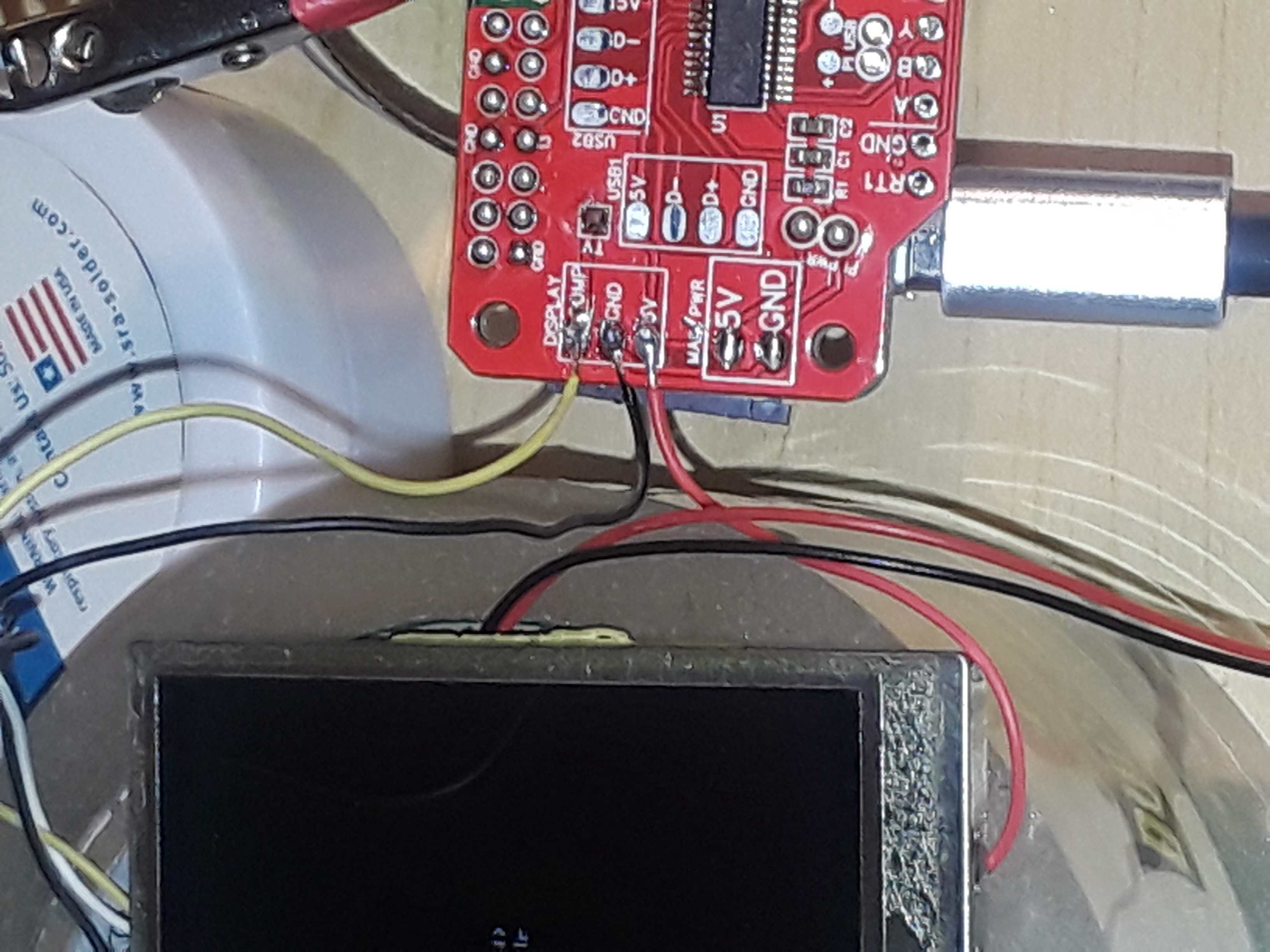

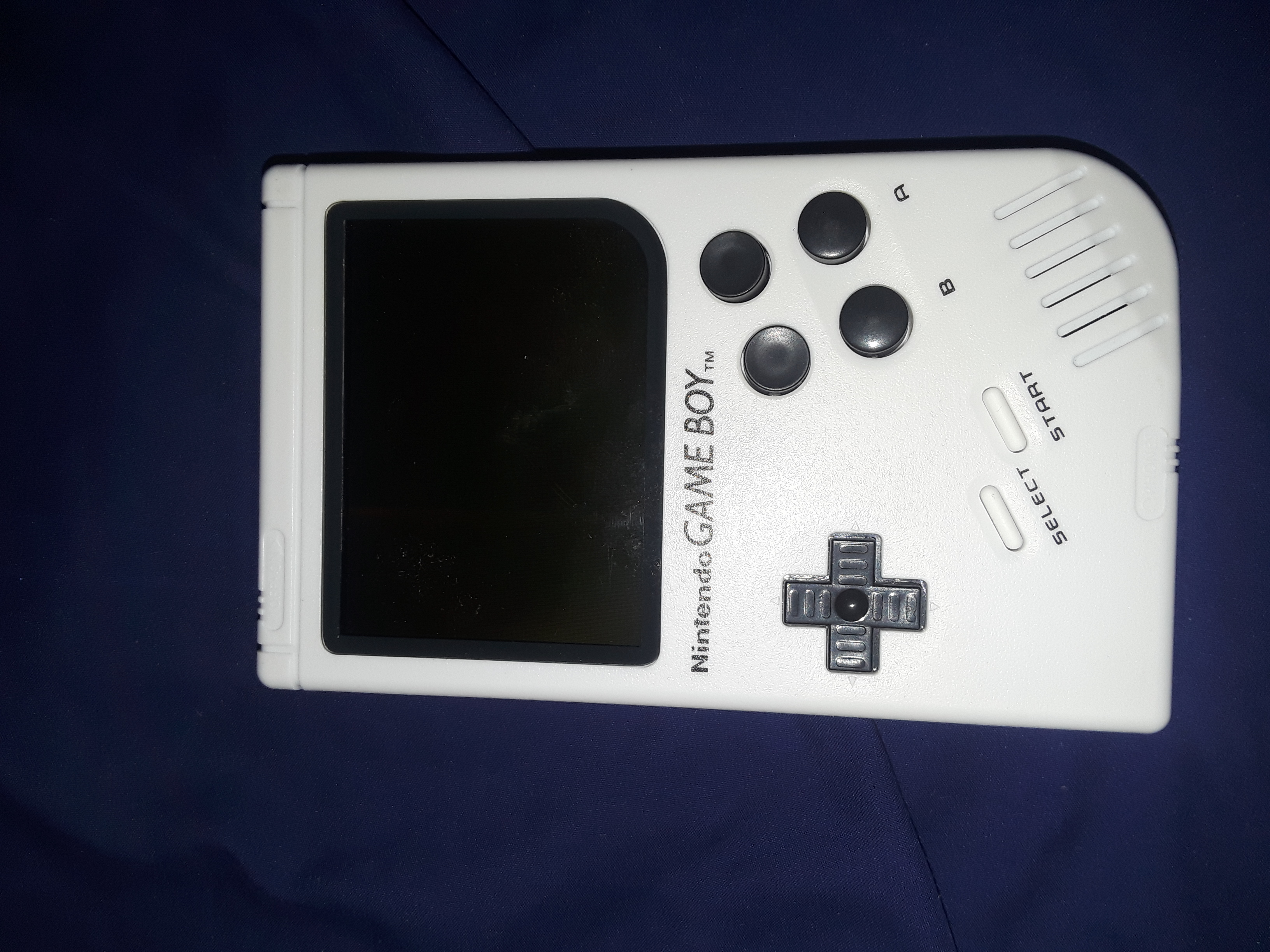

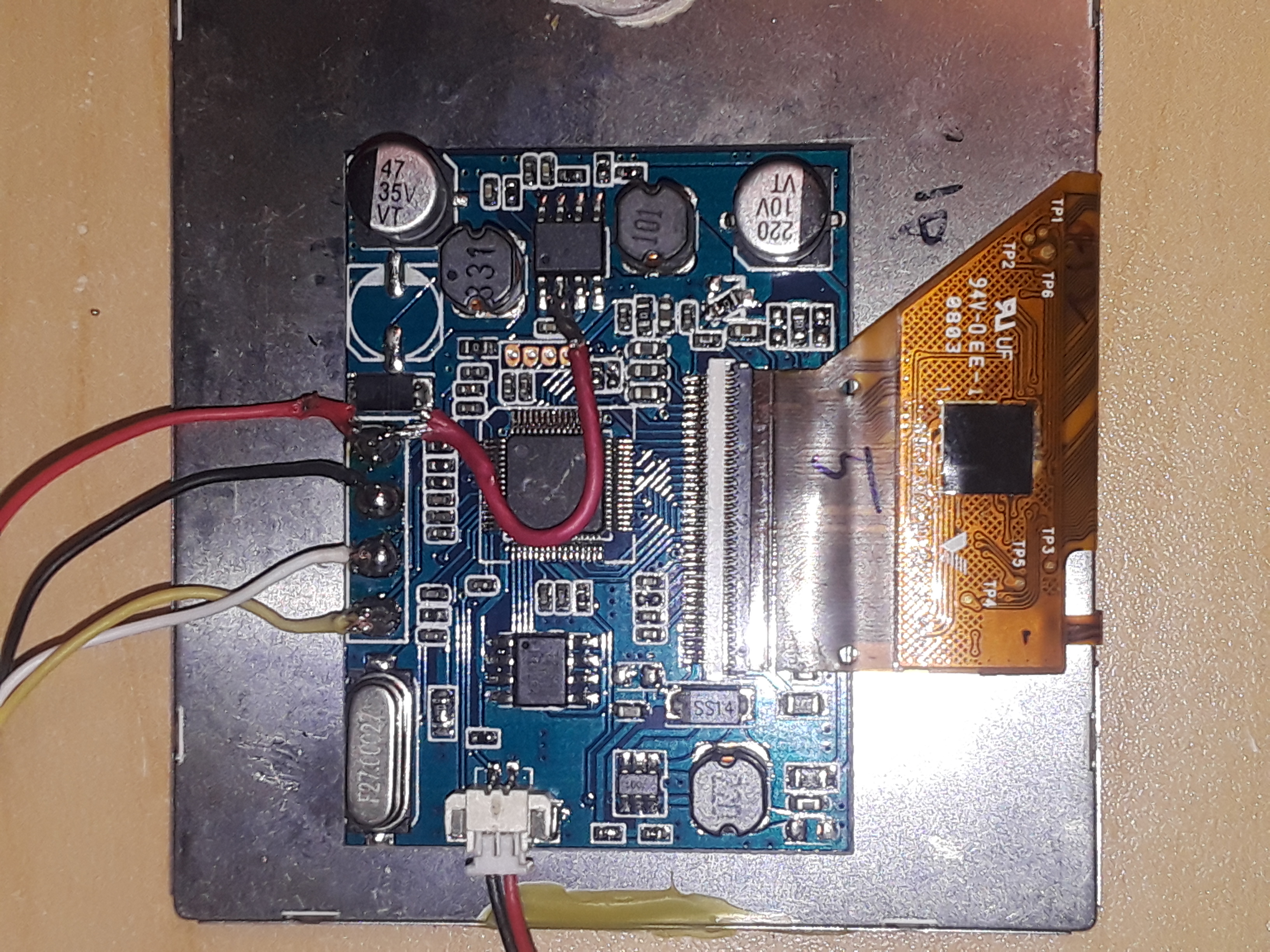

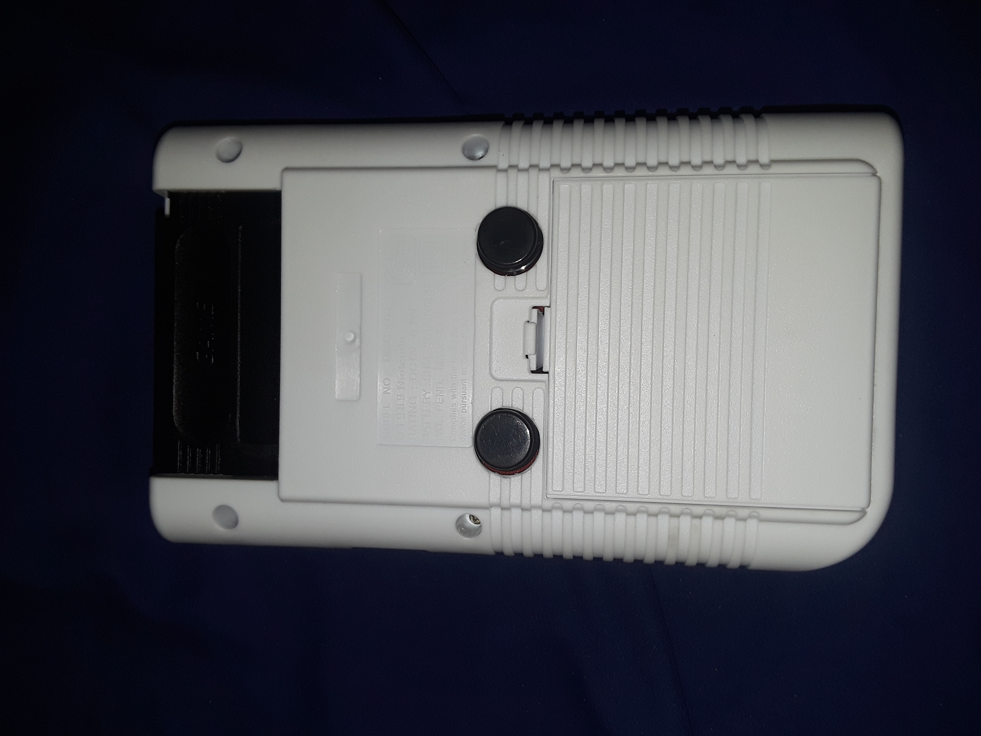

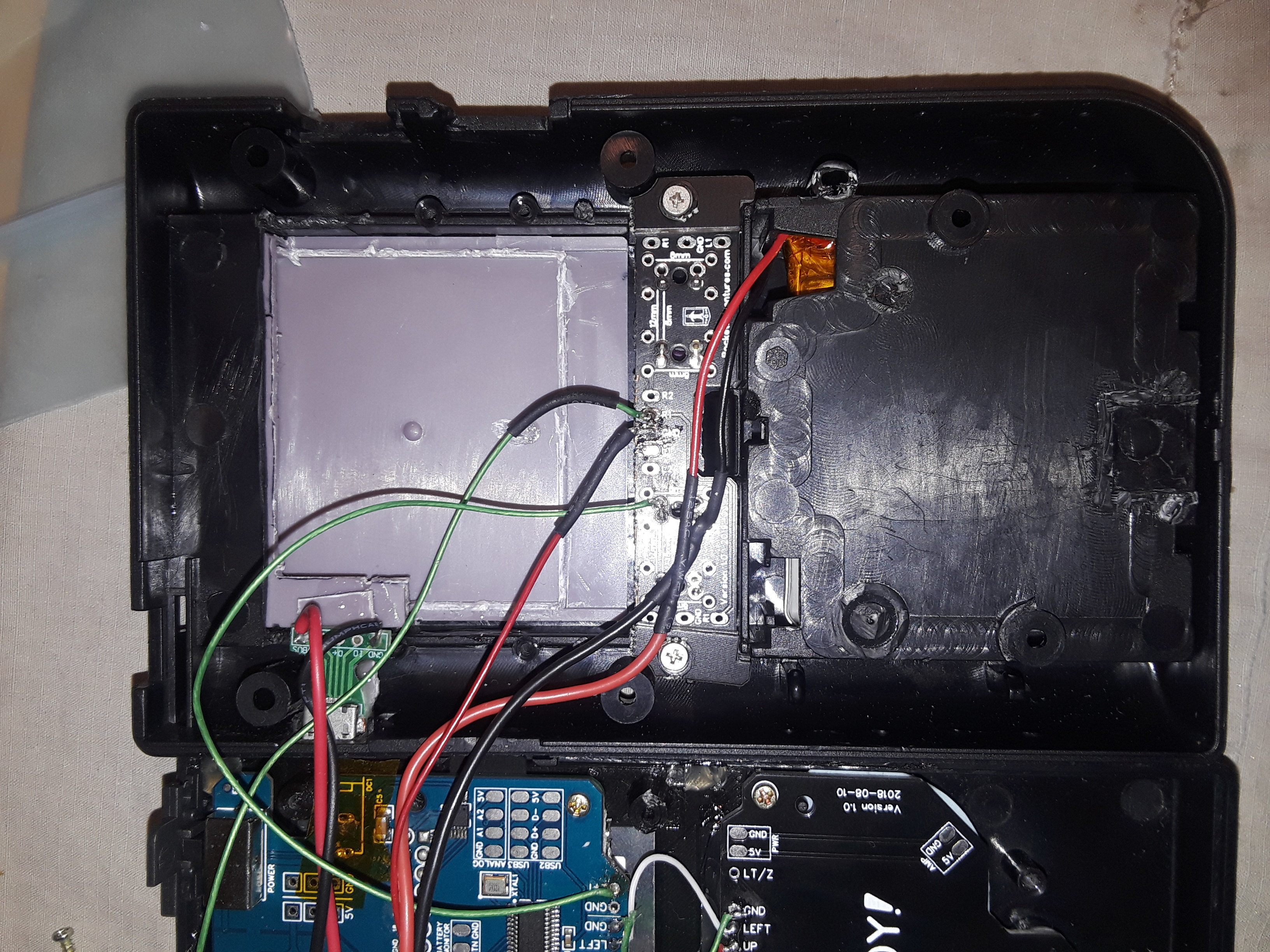

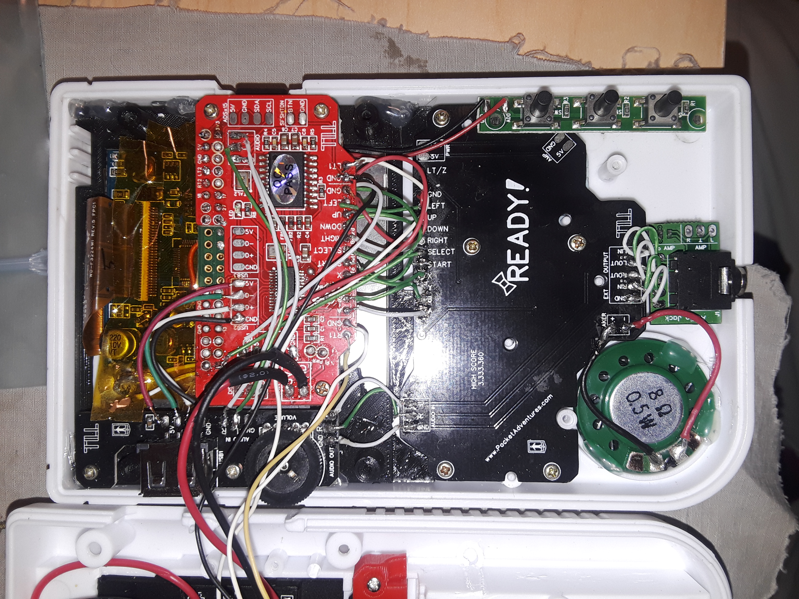

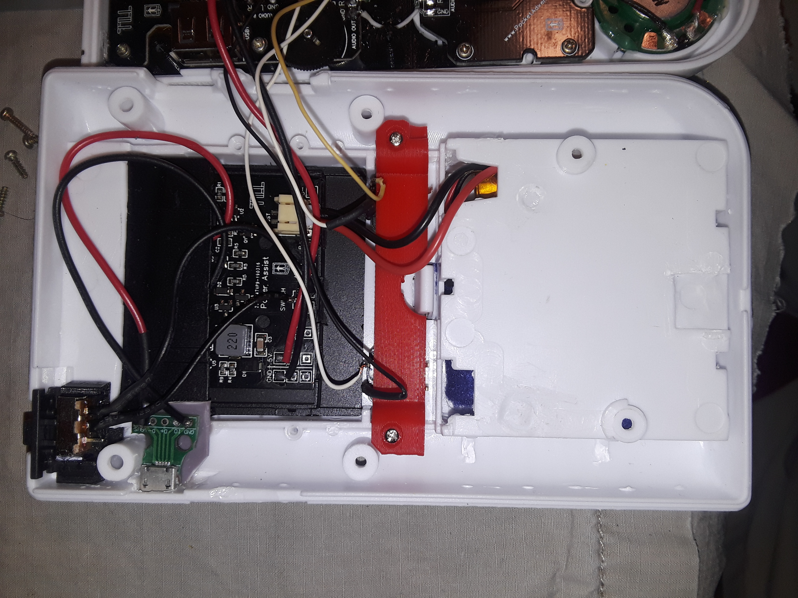

First off, here is a black and white build based off the "stormtrooper" build I saw on this site when I was doing research. It consists of a Pi Zero W attached to a Pocketadventures GPIOAssist Pro with a PocketAdventures USB/Potentiometer board and button board. It uses a 3.5" inch screen from a backup board - the circuit board wasn't one of the types listed on this site, but I was able to modify it to run off 5V. It comes with a pcb that you can adjust the brightness and stuff which fits into a cavity next to the battery bay. It has two back buttons which uses a 3d printed bracket from online somewhere. It also uses a charging board from Pocket Adventures and a switch I got off Amazon. I spray painted a regular gray cartridge a nice Matte Black and then used a clear coat; I think it looks great. The pictures don't do it justice but the screen is actually quite nice.

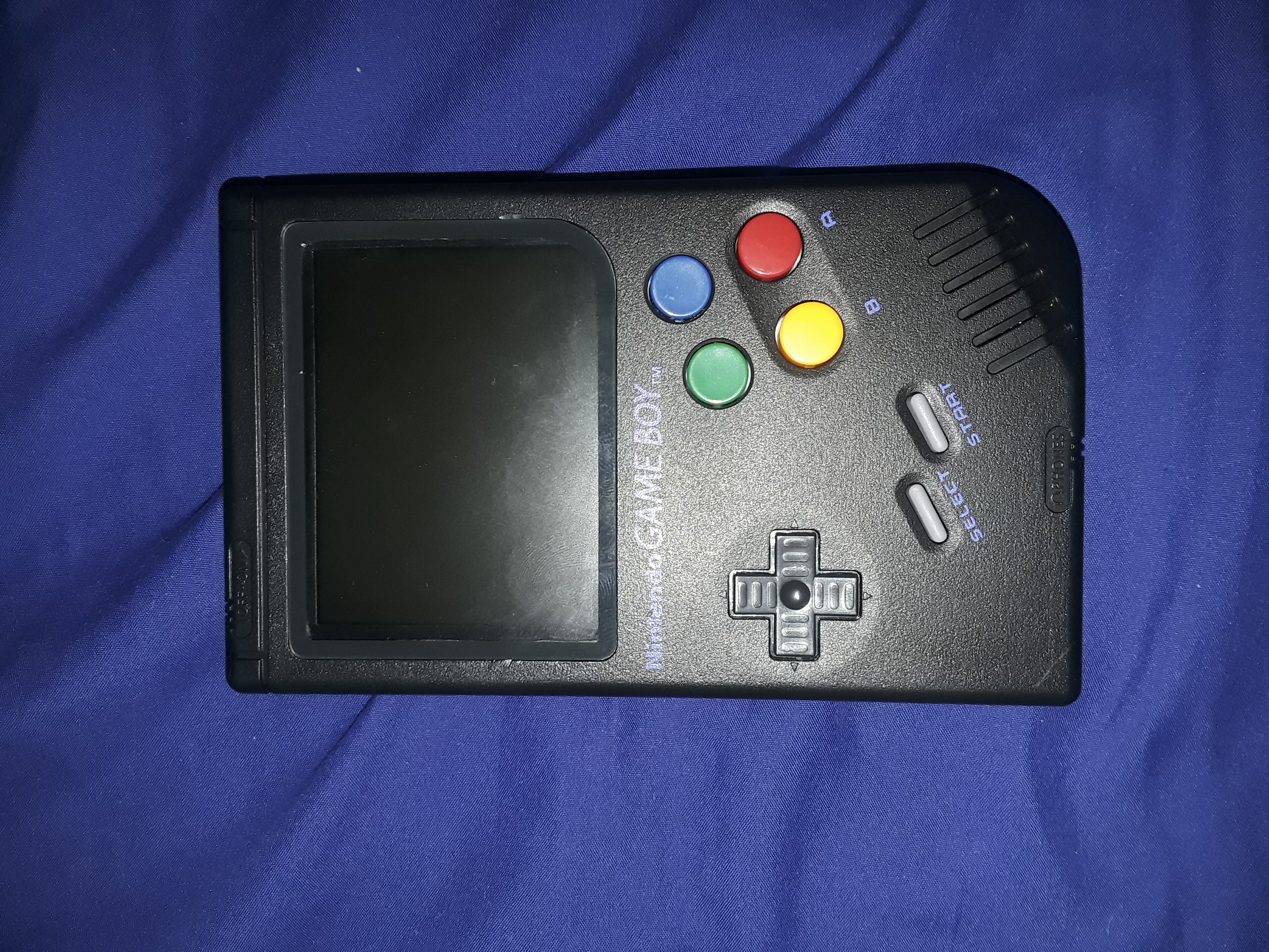

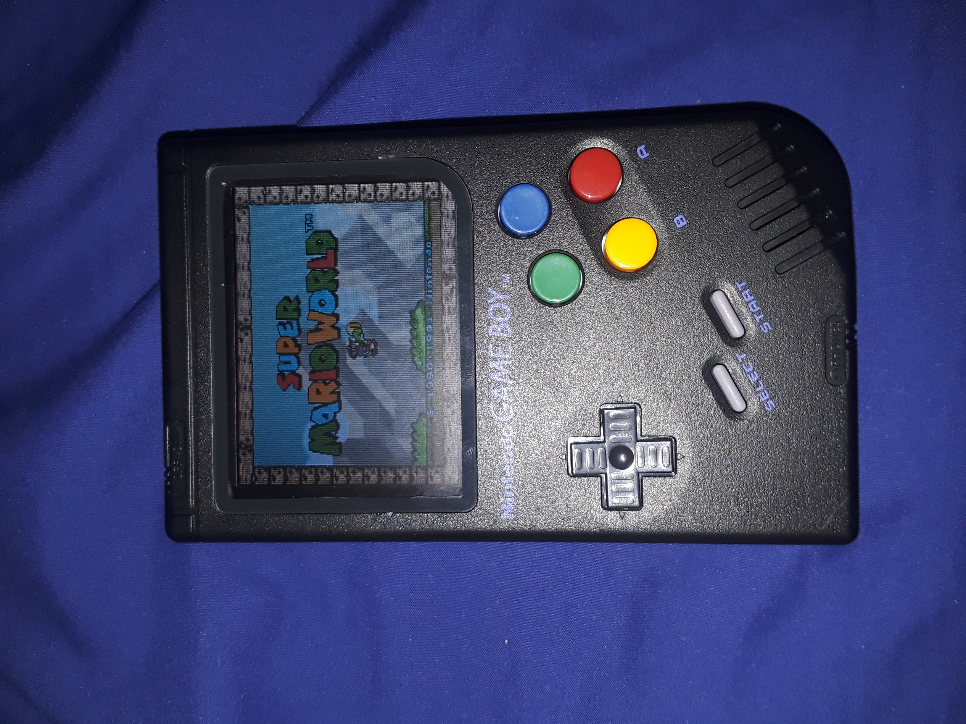

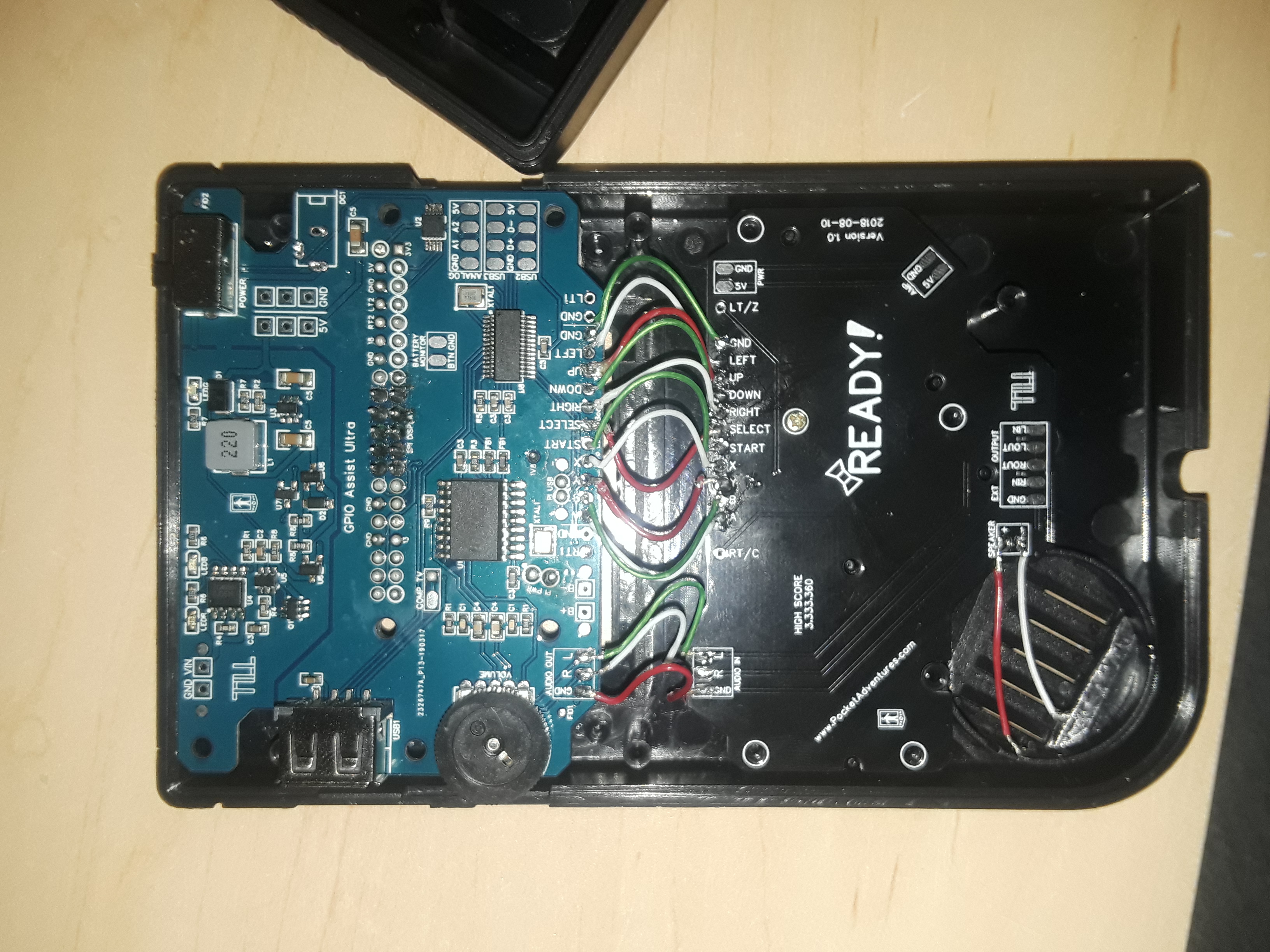

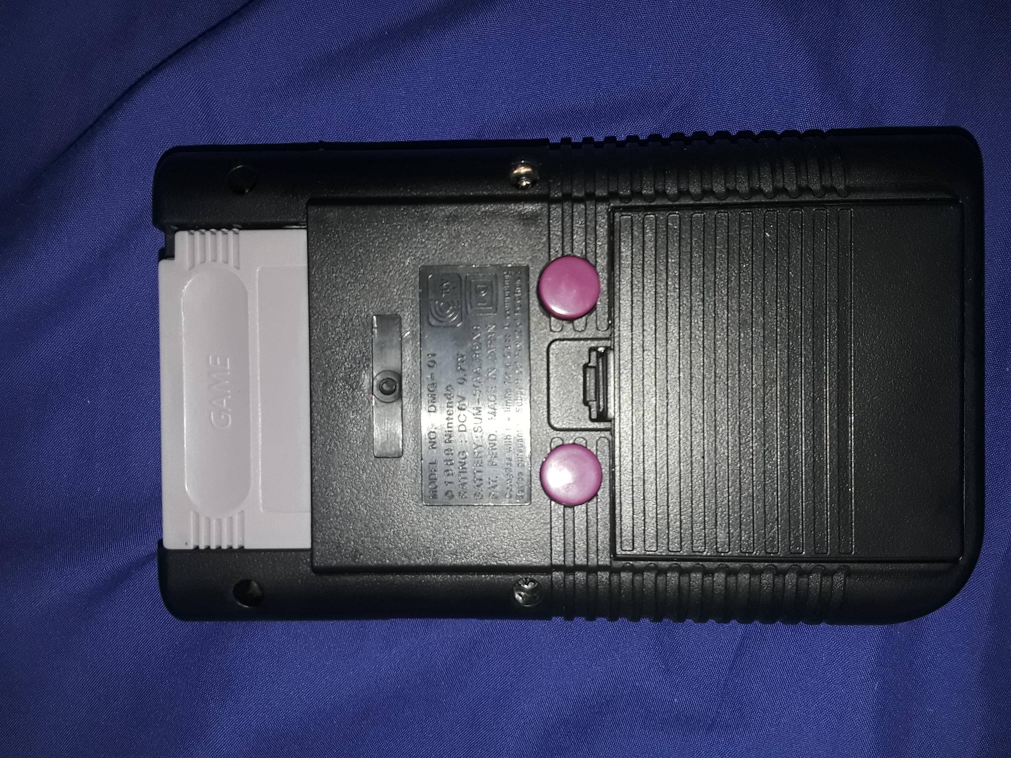

Secondly, the Black Gameboy has a more "original" feel to it, as I used SNES color buttons and the original reddish buttons as the back buttons. This one uses a Pi Zero W attached to a Pocket Adventures GPIO Assist Ultra, modified to accept a USB charging port. It also uses a pocket adventures button PCB and a Pocket Adventures Back Button board, with tactile switches. The screen is a 3.2" SPI screen attached using a Pocket Adventures SPI adapter. Overall this build was much simpler, although the SPI screen gave me trouble and I had to reflow the solder. But, I am very excited that these builds are done.

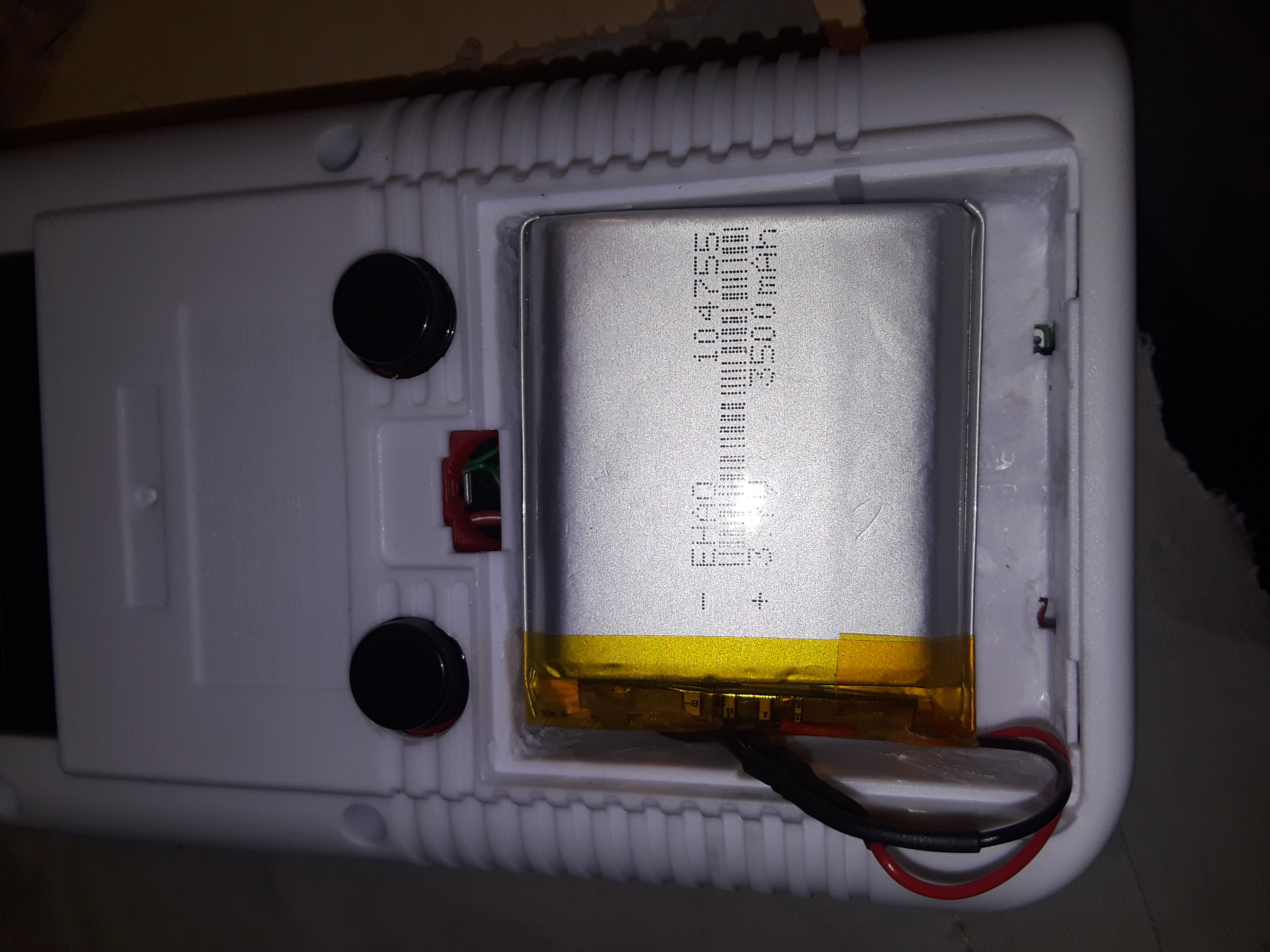

Lastly, both batteries are a 3500 mAh one from eBay and fit well in the battery bay without modification. I am still going to do some testing to see if I can improve the frame rate on the white game boy. I would also like to say that both Pi Zero's have a mild overclock and play quite well.
