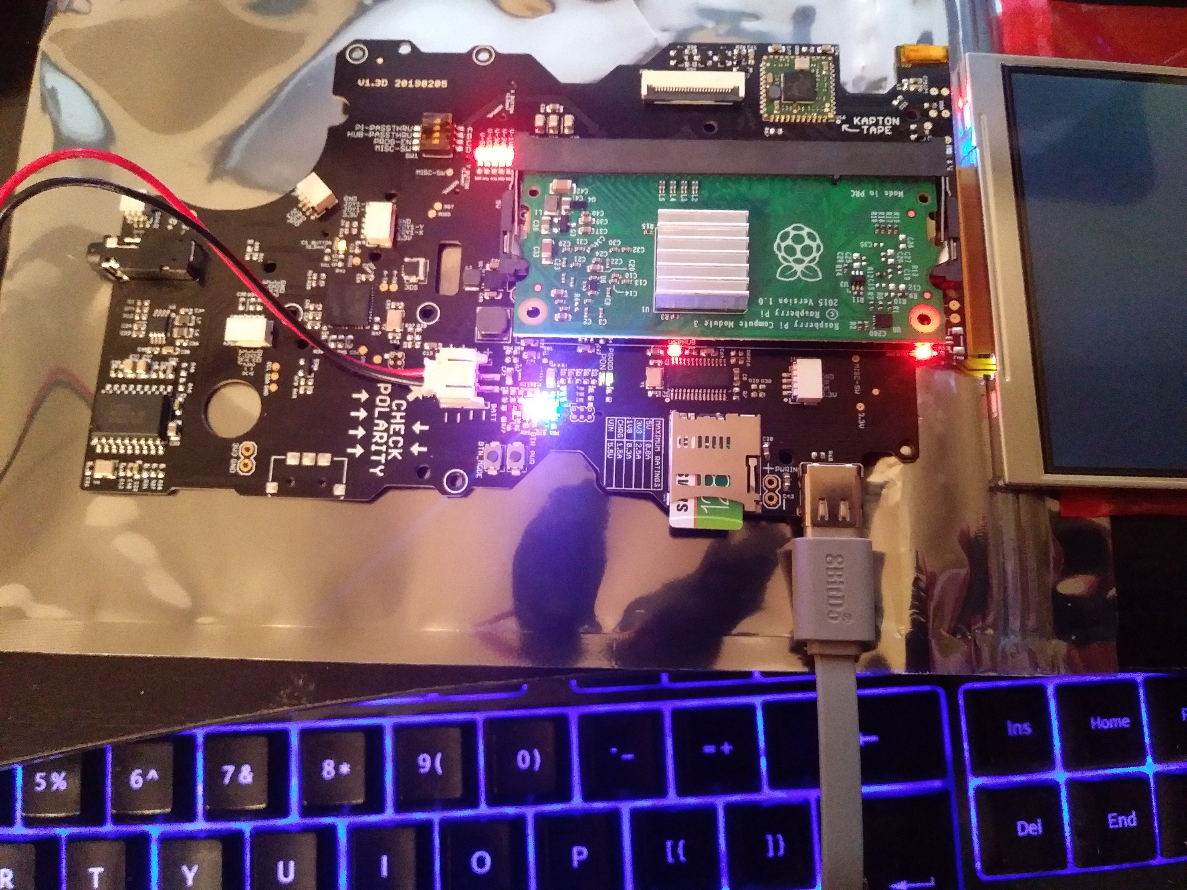

I included a picture this time since I wasn't able to before.
I did notice a light near the compute module that has the little word "overtemp" printed next to it is on, which I presume is not a great sign. This is the little orange light on the right side of the module in my attached photo.
I do have the heatsink on and haven't stored it anywhere warm nor plugged in the battery backwards. I always try to keep it from touching other metal bits or doing anything to short it out. But, admittedly, I'm not sure if this is a bad sign or not.
It is on every time I turn on the board.
Still at a loss as to what to do, so I appreciate any more guidance on this. Thanks in advance :)

Got it installed in place of the Shield OS and made sure the solder pads under the module 3 were bridged per the wiki but now when I hold the power button to turn it on as I have before and now the overtemp light will turn off, and after this, the other lights will flicker and then it will power down, still without anything on the screen. The battery and charge/power cable light will remain on however, and I'm able to re-activate power and it will do the same things in that pattern.
Tester mode was activated and the higher-resolution screen settings were activated in the config.
