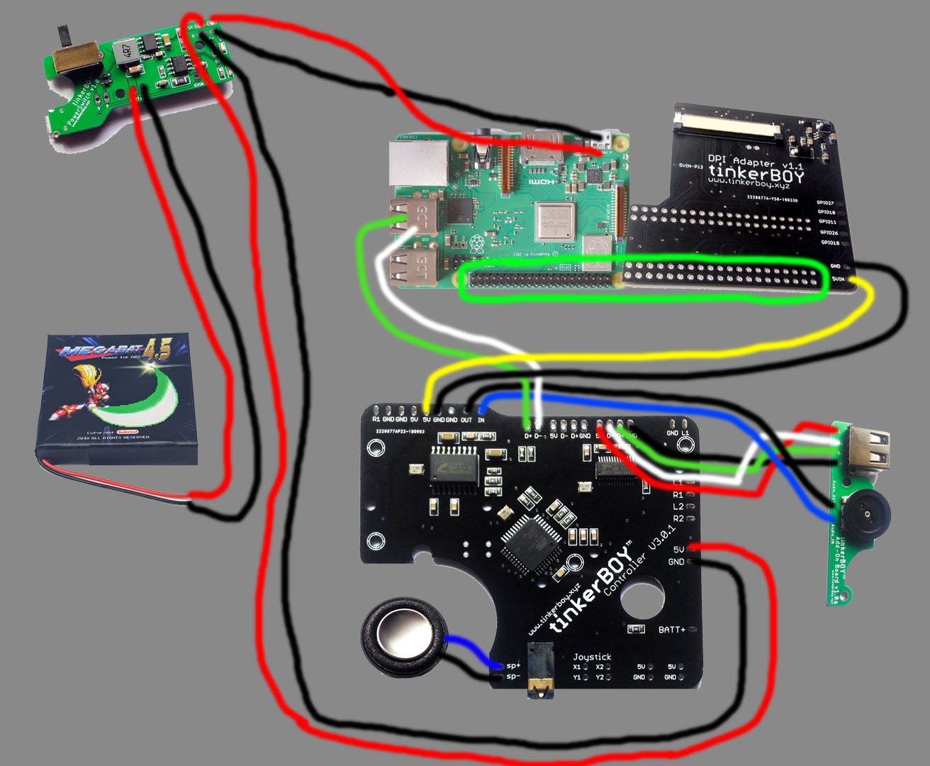

this is my wiring diagram

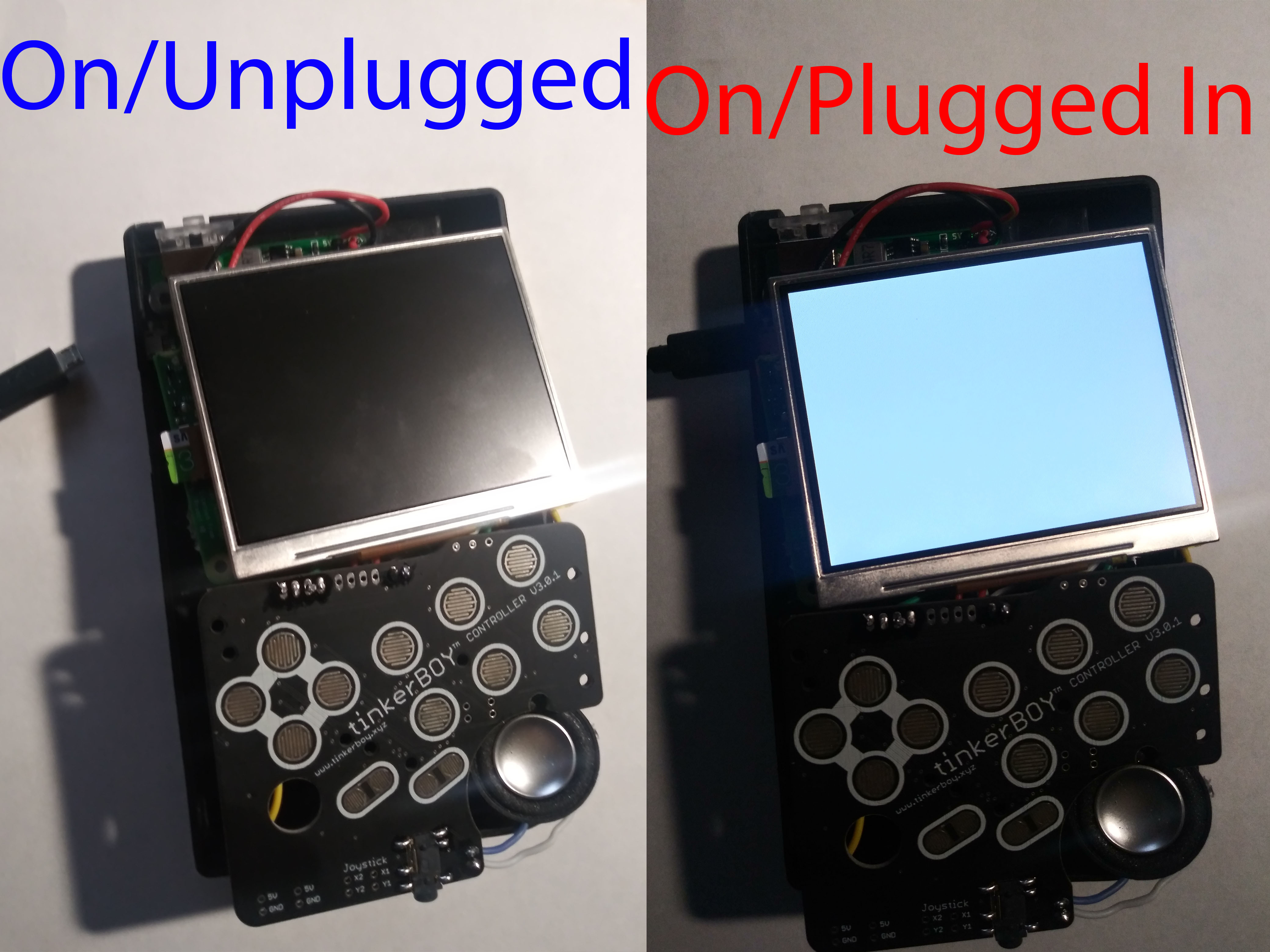

and this is what it's doing. also just for anyone referencing this, I did infact have some of the pins for the adapter not actually soldered. I used the pi zero's throughholes on the DPI adapter, not knowing that I was only testing the continuity of the DPI board itself and not the connections between it and the Pi.

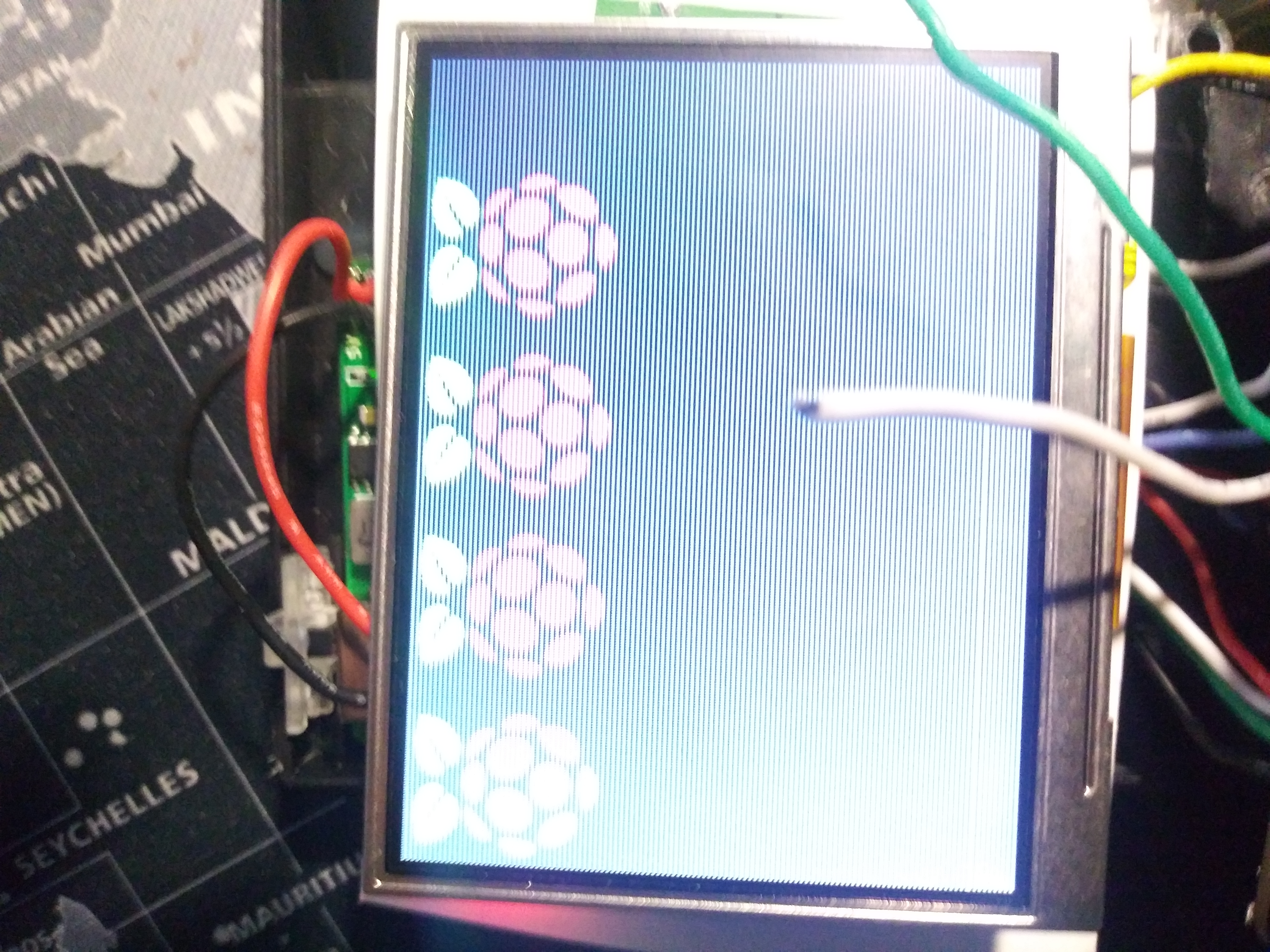

been messing around some more...... when I disconnect the 2 data wires from the pi I get video signal, it starts to load, then fades to white again.
