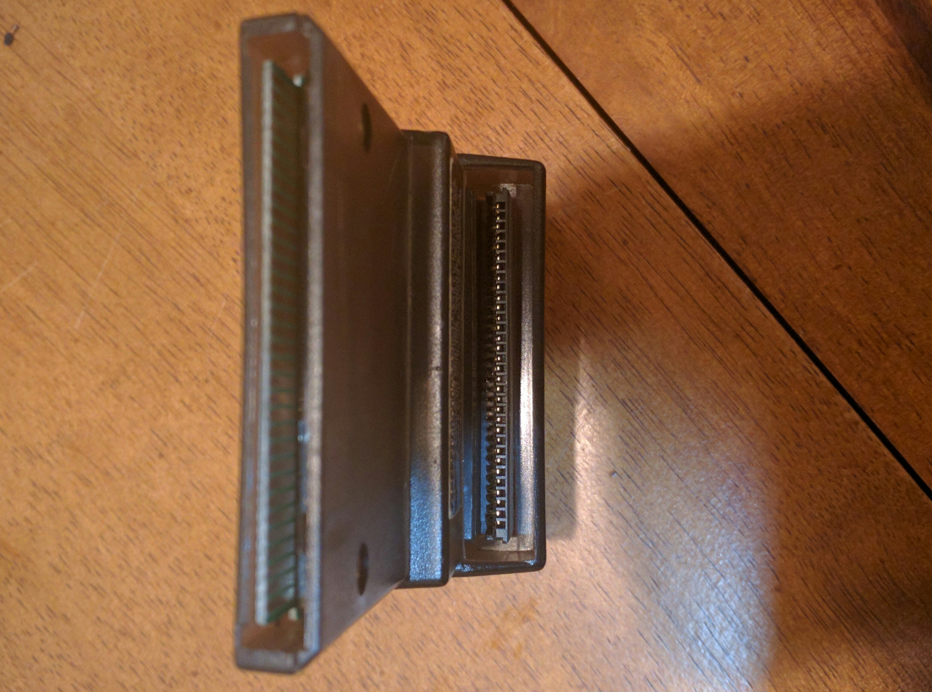

I just picked up a cheater cart and it had an extra slot. If you can't find a cheap broken gameboy or a replacement part sold alone that route should be an option.
This one is called Monster Brain.
