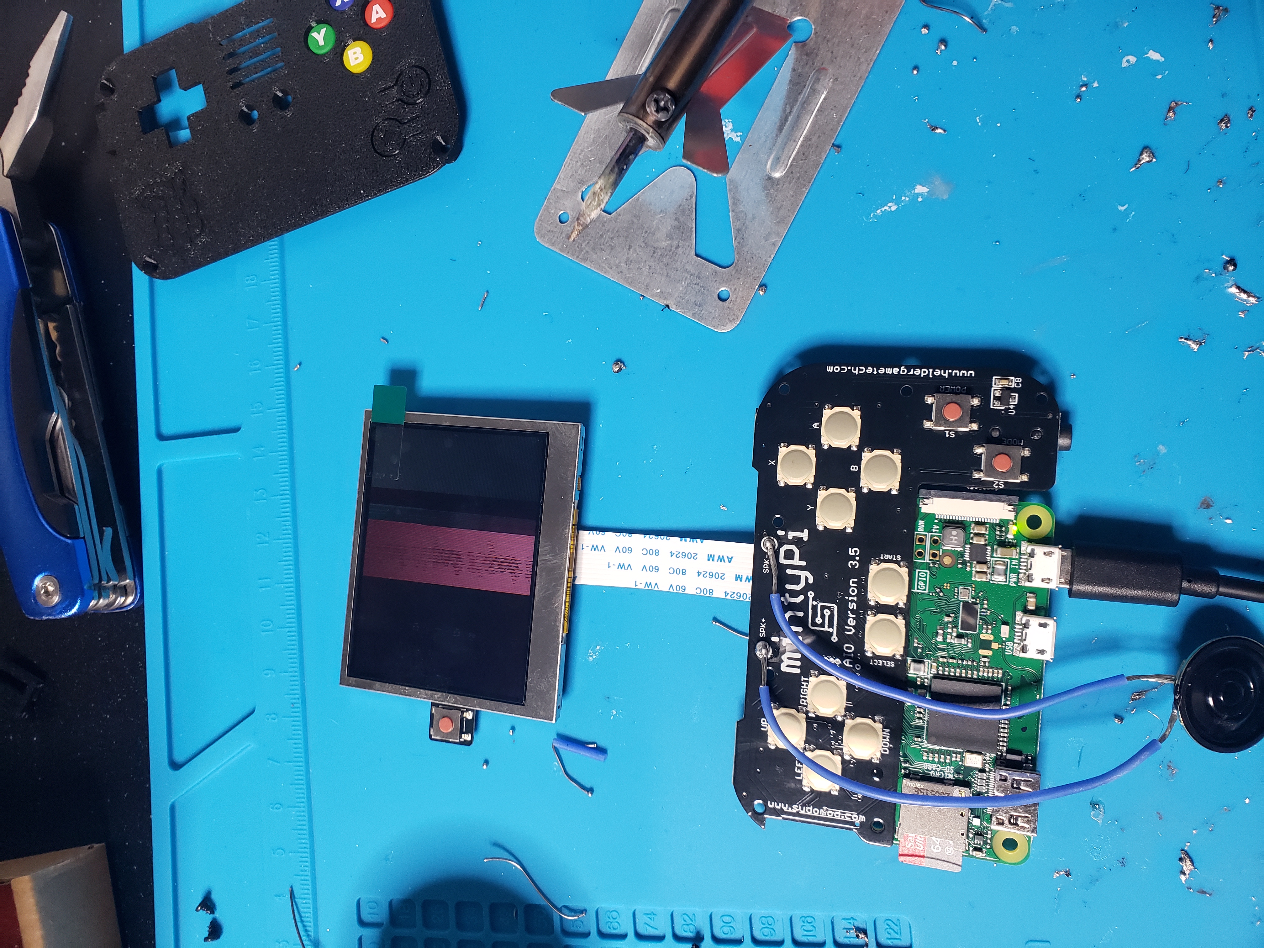

Hello all I looked through the support section and didn't find my exact problem sorry if I missed it.
This is my first time doing this level of project.
I've done several pis. But never any soldering
My screen is weird does anyone know what I did wrong? All my solder connections are good. They beep or whatever. Also if I haven't added enough info please let me know! Thanks for all your help you all seem really nice a helpful.
Image heres a pic

Are you sure you're using the right image? From what I've seen from forum posts in the past, this looks like you might have flashed the wrong image onto the SD card. Looks like it might be the lite image. I'd re-download the 3.5 image and flash the SD again.

The most up to date link is on Helder's site
https://www.heldergametech.com/shop/min ... 5-pcb-kit/
Or this is the direct link to the image-
https://www.mediafire.com/file/skv96iou ... 0.rar/file
Oh and you're going to need to at minimum tape those speaker wires up with Kapton tape or something. That looks like a short waiting to happen.

Post by Bilbosaddens » Fri Jan 22, 2021 2:12 pm
Thanks for your help! The new image fixed it. Screen works! But my right button doesn't. I know my connections are tight. What else could it be?
