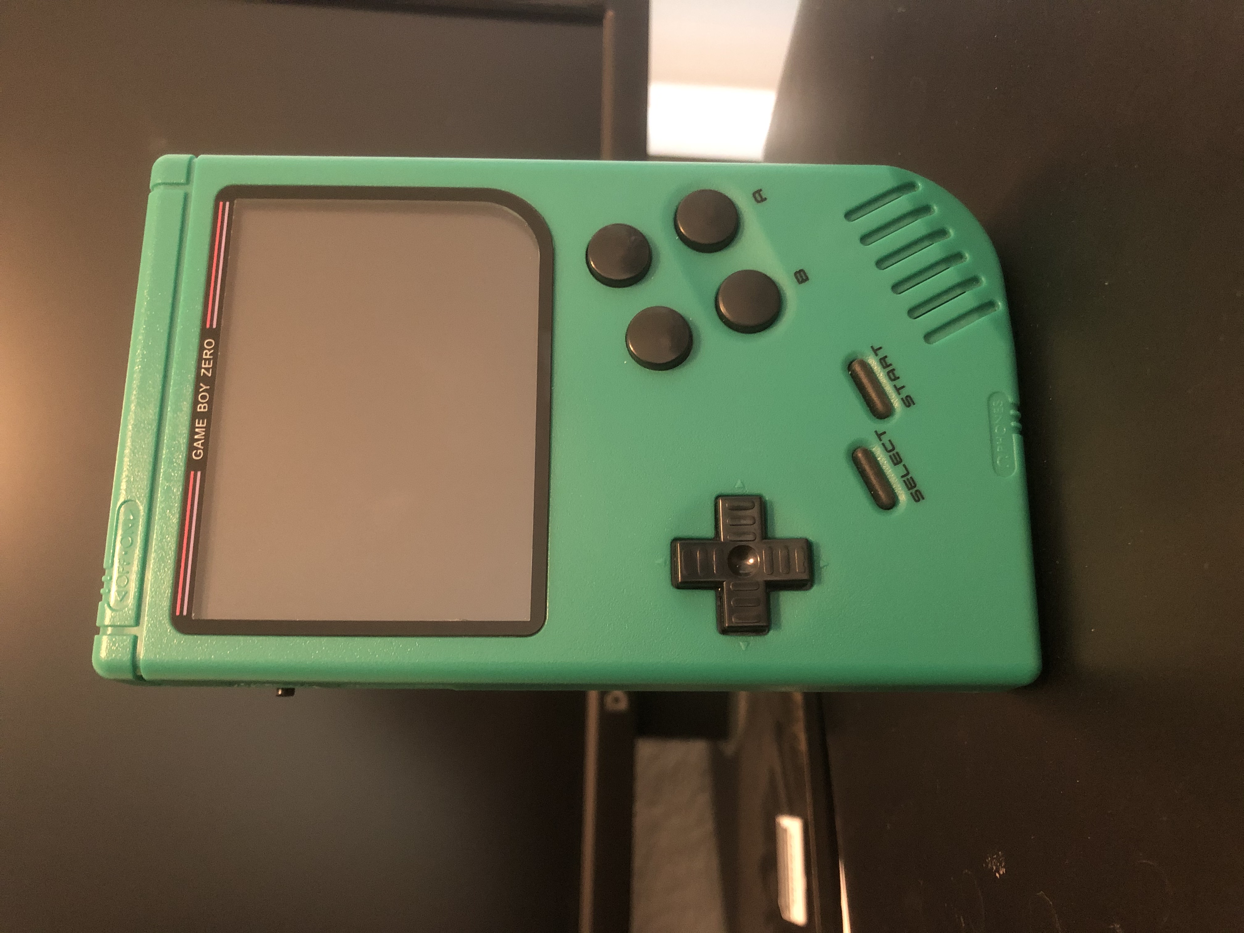

I just finished my first build and wanted to show it off and document the build. I'll also be listing the various issues that I still want to work through and hopefully get some help fixing them.
For those of you who are too impatient to read my long-winded Game Boy history and motivation behind the build, check out the final result below! :lol:

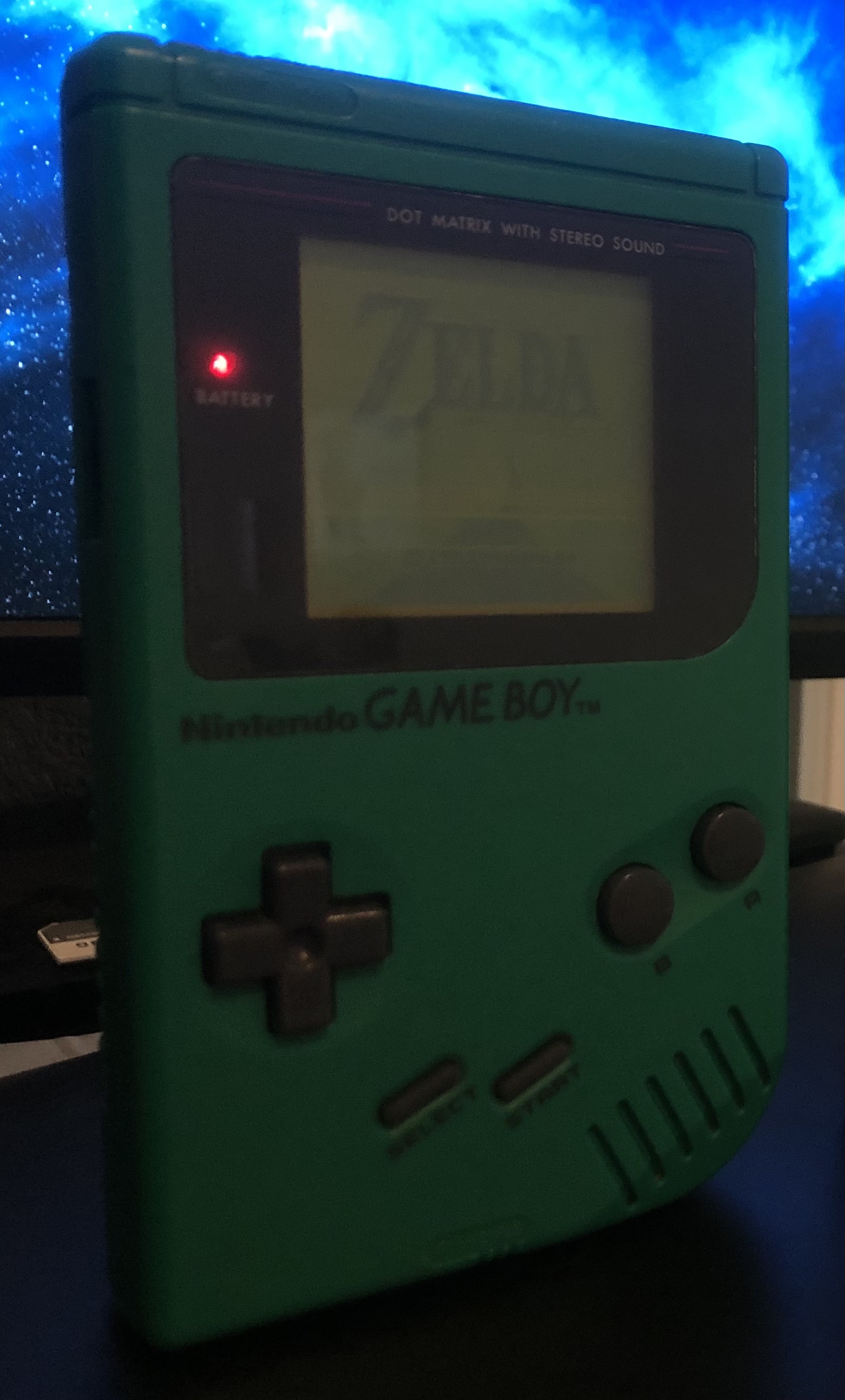

Okay, now for the boring stuff! I got my first Game Boy in the mid-90's. It was a Play It Loud Green Game Boy much like the one below which is currently listed on eBay:
play it loud original.jpg (360.52 KiB) Viewed 12040 times
I loved that Game Boy and was so proud of it, until I loaned it to some kid on the playground and it disappeared. That was the first and last time I loaned something out without keeping constant eyes on it. That Game Boy being stolen from me was a defining moment of my childhood and may explain my chronic distrust of everyone and overall cynicism towards the nature of people and kids in particular. Kids are little assholes. But I digress.

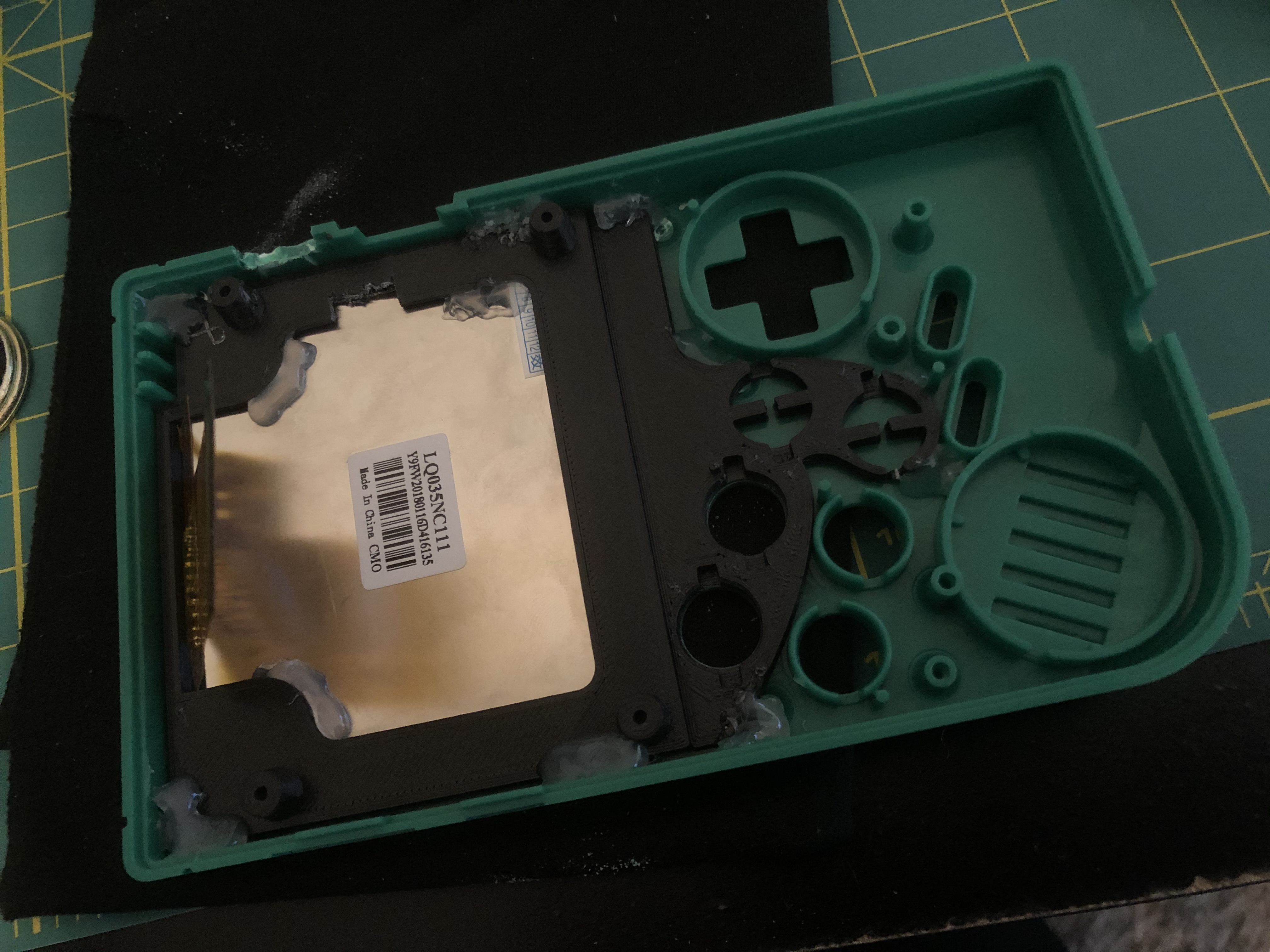

The screen hot glued into the front of the shell:

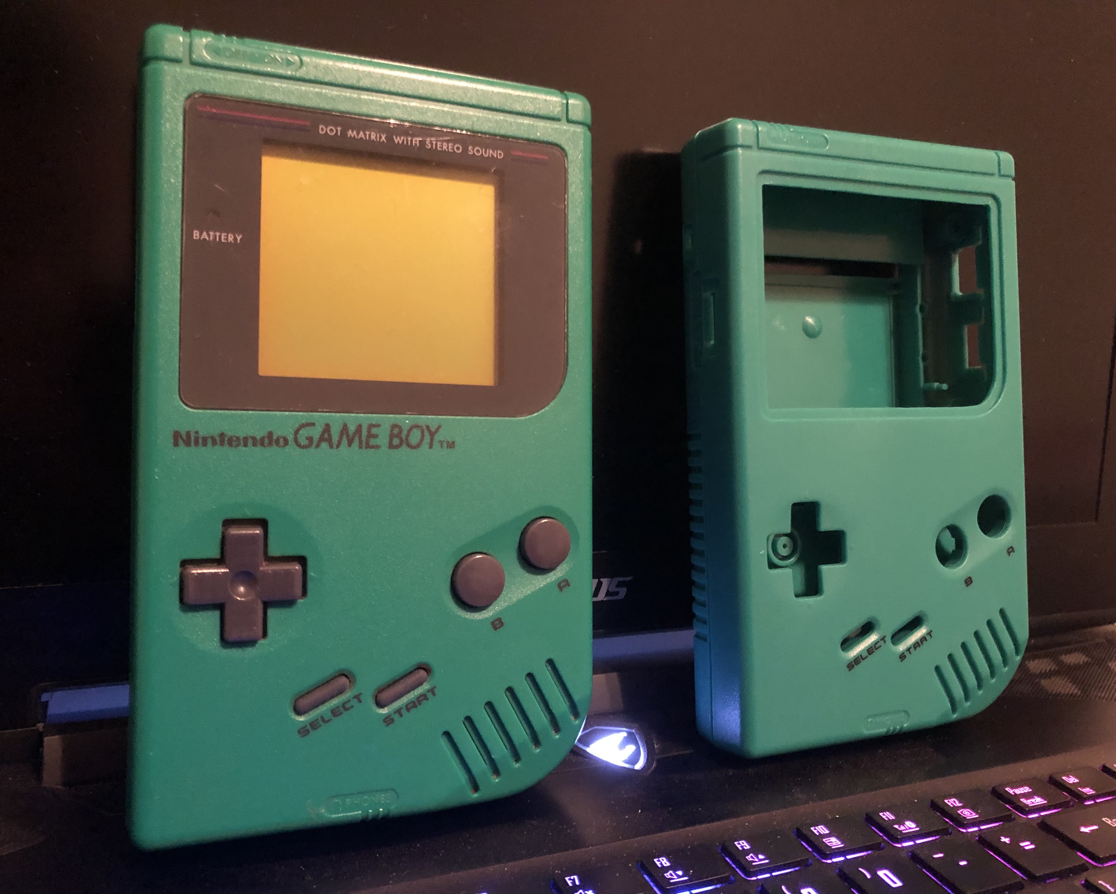

Compared to the original Game Boy which I decided not to use as a donor:

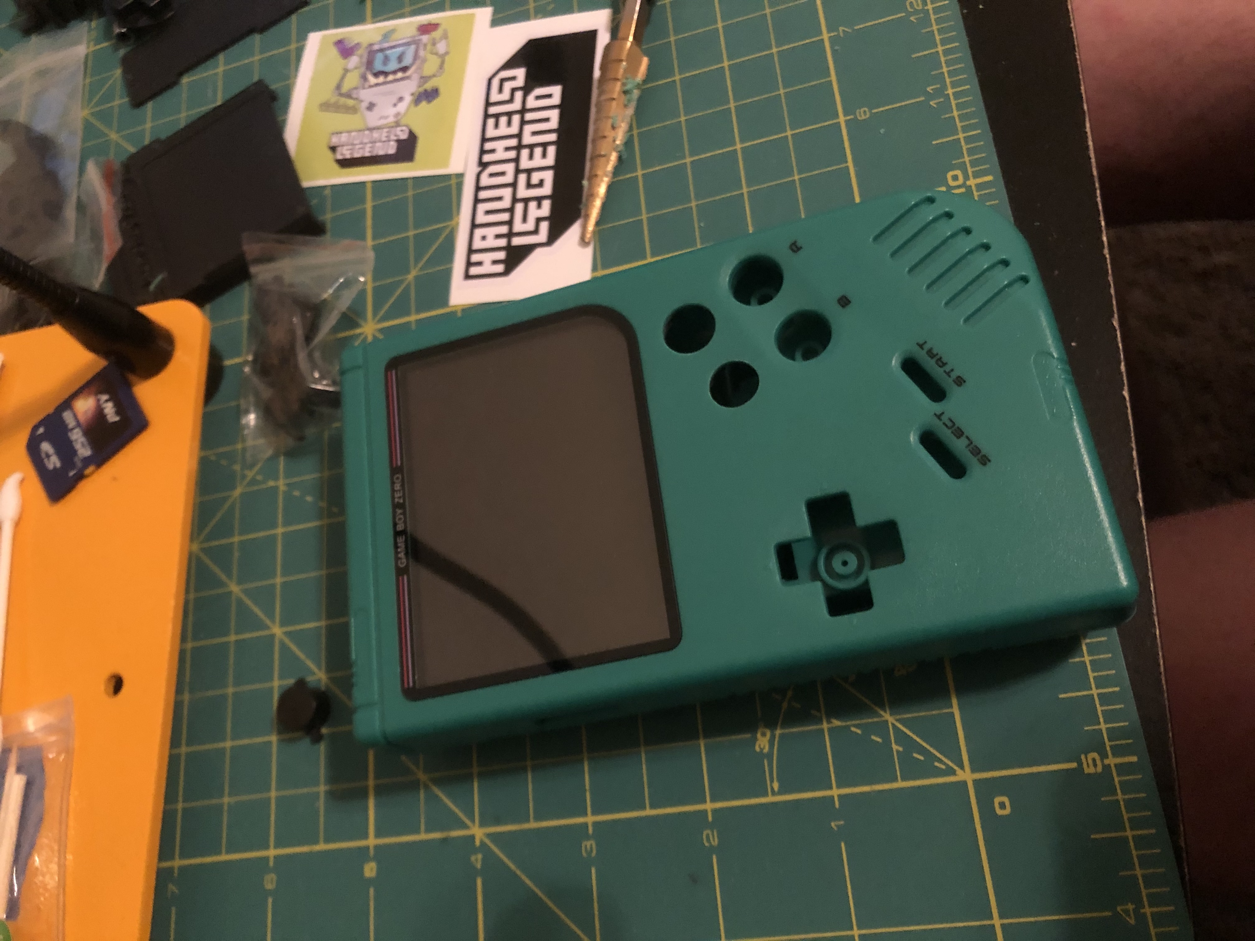

After making the X and Y button holes:

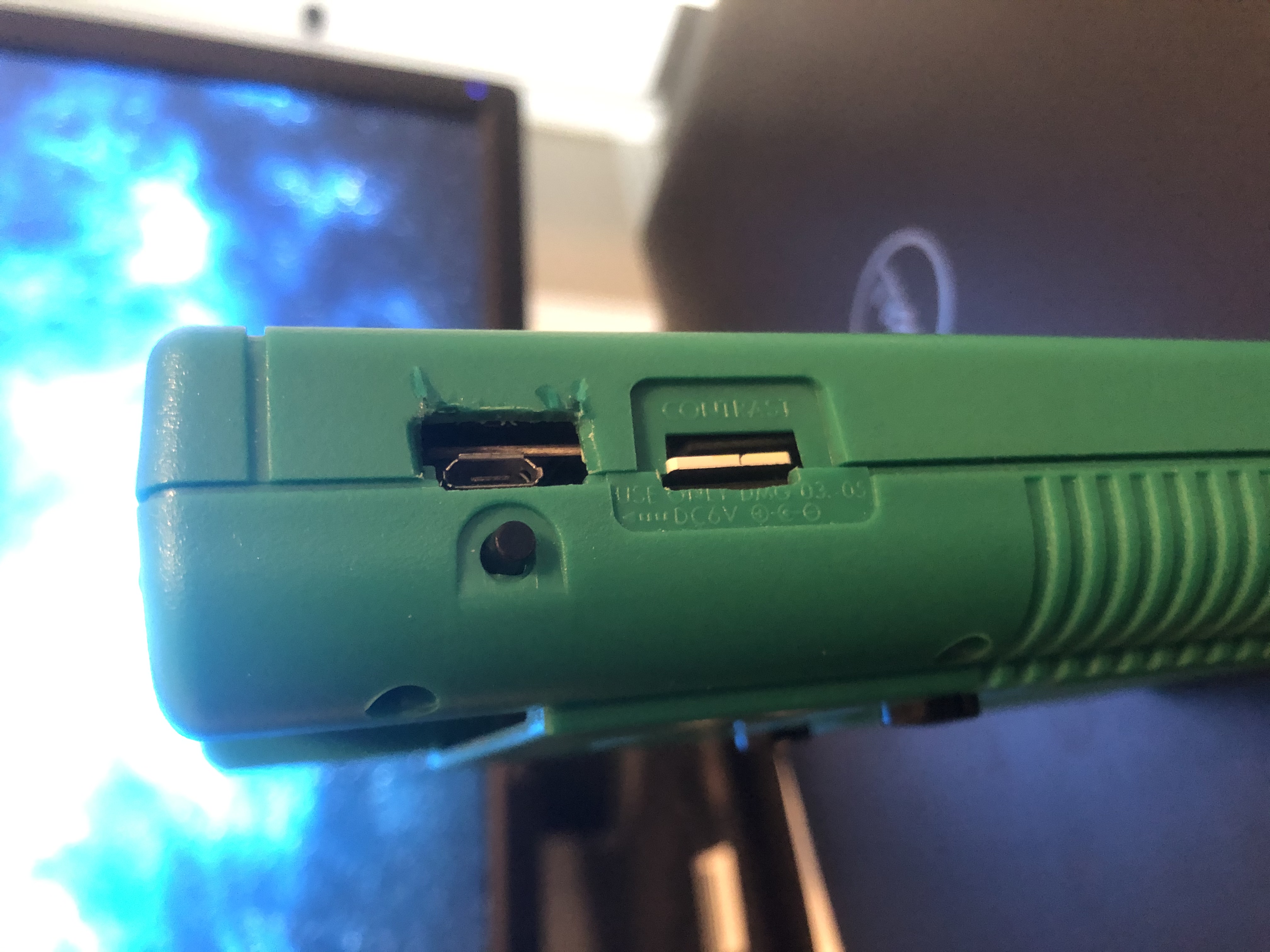

Janky side cut job, not my best work:

Next to an original Game Boy:

Final build:

3. The janky hole I cut for the micro USB charging port is horrible. I can barely get a plug in there. Need to bore it out more and make it looks less terrible

6. Screen has too much pressure on it, causing slight ghosting at one location. Need to relieve pressure from the screen
