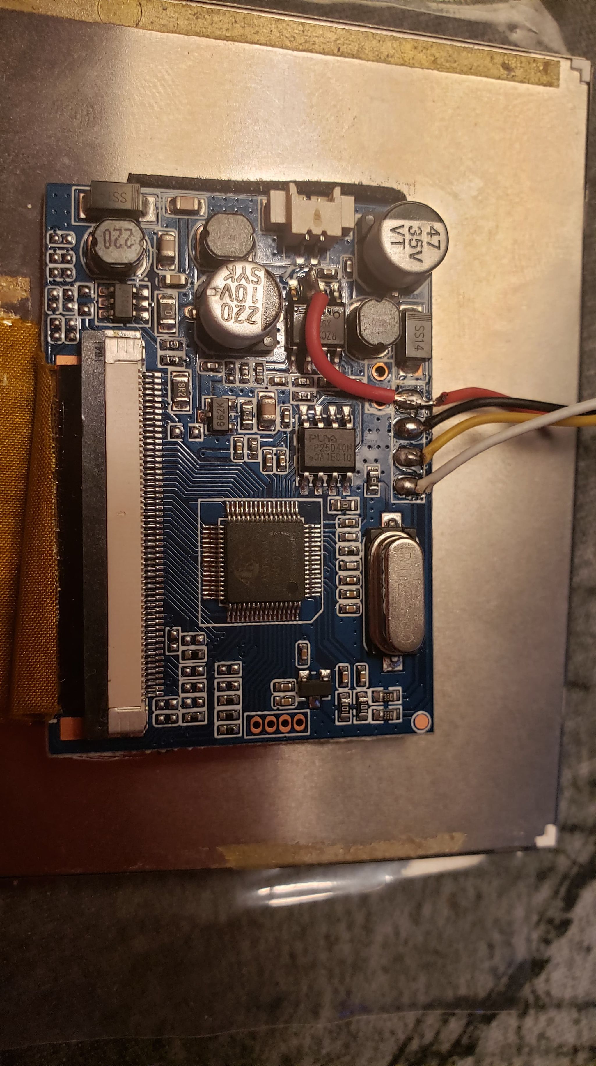

I made some progress on the display board. I have gotten the display working. It no longer shuts off. I took a shot in the dark based on another post mentioning connecting to the 5v leg of a specific IC. I am quickly learning how to search for things! I was looking for the post that led me to that but i ended up accidentally finding a post that wouldve solved my problem smh....
Solution post: viewtopic.php?f=44&t=7371&p=70145&hilit ... ker#p70145

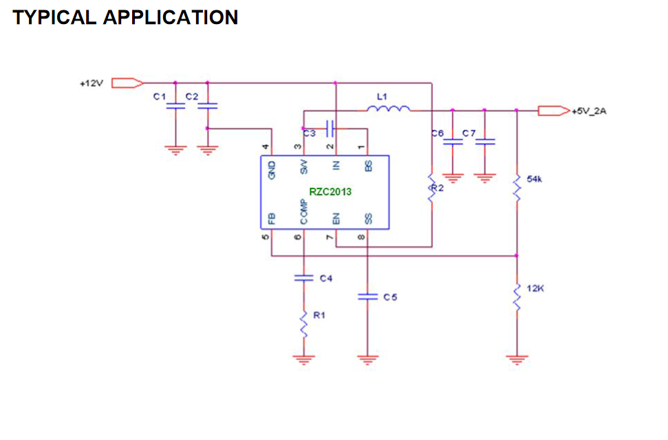

My solution in case that doesn't explain it well. From my understanding. the power supply is meant to run off a 12VDC power supply (backup car camera probably will run off of a 12v supply as its already there.) The RZC2013 IC (You should be able to read it on top of one of the chips on the board) is a converter that drops it down to 5v to power the screen.
According to the Typical applications, pin 3 on the chip should be where you put you 5v jumper.
typical application.PNG (145.33 KiB) Viewed 2496 times
boost converter map.PNG (202.39 KiB) Viewed 2496 times

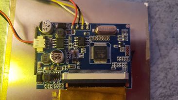

I've done so here:
5v Jumper run.jpg (822.9 KiB) Viewed 2496 times
Better angle.jpg (663.64 KiB) Viewed 2496 times
Not my prettiest work but I am new to soldering on such small connections. The display seems to work! It is a bit blurry not quite sure if thats just because of some settings that need to be changed or something but this fixed the flickering. Feel free to ask if you have any issues. I am currently building my first zero and am always learning. If i haven't run into the problem myself heck i can sure teach you better ways of finding what your looking for :) If this helped you out Don't worry! you will get it!
