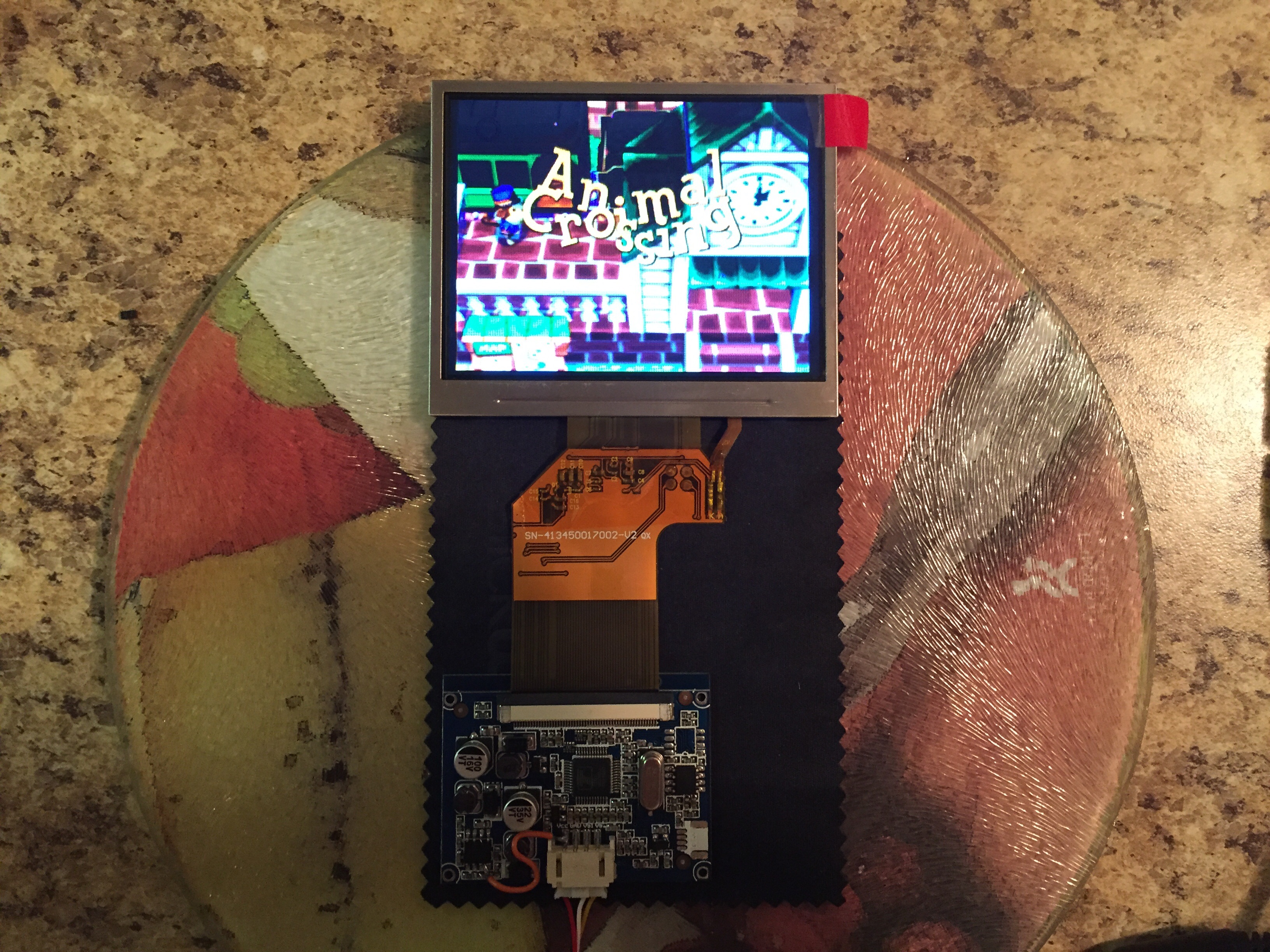

I see you removed the screen from the metal enclosure in order for it to fit. Any tips on doing that before I try?
Thank you,
John D
Technically mine wasn't fully enclosed, just partially. Post of picture of your monitor and I'll let you know if it looked like mine.

Post by JohnnyFYVE » Fri Sep 30, 2016 8:57 pm
I grabbed one that wasn't enclosed in those Back Up Cam cases... here's a pic:

Post by NyteFury » Thu Oct 06, 2016 11:30 pm
Sorry for the delay! I've been super busy with life this past week.
My monitor was a backup camera one and just had a simple plastic and then partially enclosed metal casing for the screen once it was popped out of the main enclosure. I've got another I can pop open and take some pictures.
