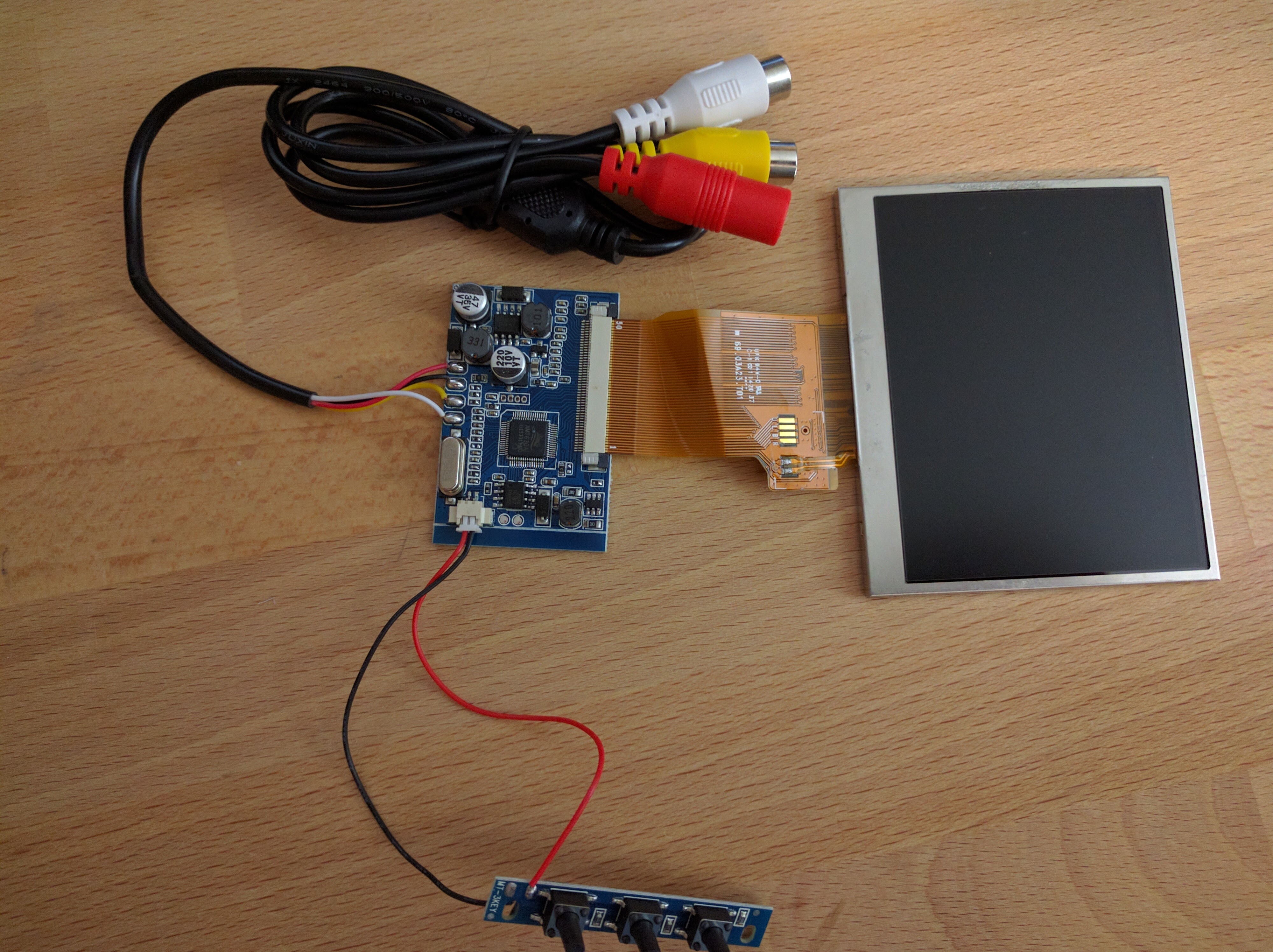

This is the backup camera I have that I got off amazon. Looks like it is the correct one that Wermy was talking about in his information thread. Does anyone know or have tried converting it to run off 5v yet? That is what I need to know.
- IMG_20160511_063306.jpg (2.23 MiB) Viewed 10576 times

I received some feedback that the screen I have my be able to run off 5v without any modification. I will be testing this hopefully tonight and will report back.

@dirtybeagles I have the exact same screen (same board and everything) and can confirm that it does run off of 5v.dirtybeagles wrote:I received some feedback that the screen I have my be able to run off 5v without any modification. I will be testing this hopefully tonight and will report back.
(sidenote/ Im having trouble prying it open though for some reason theres only one screw but the thing is on there tightly.)
