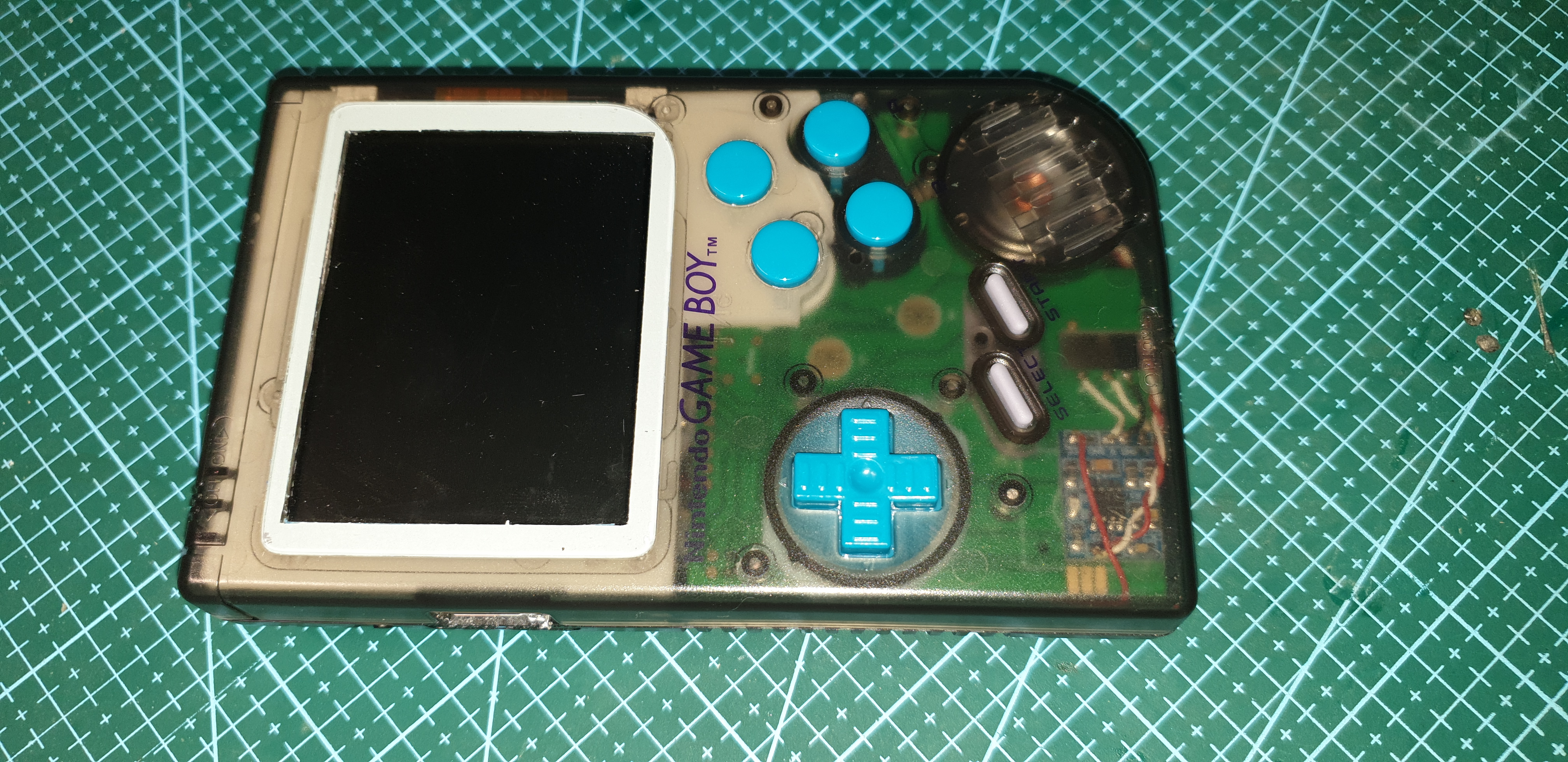

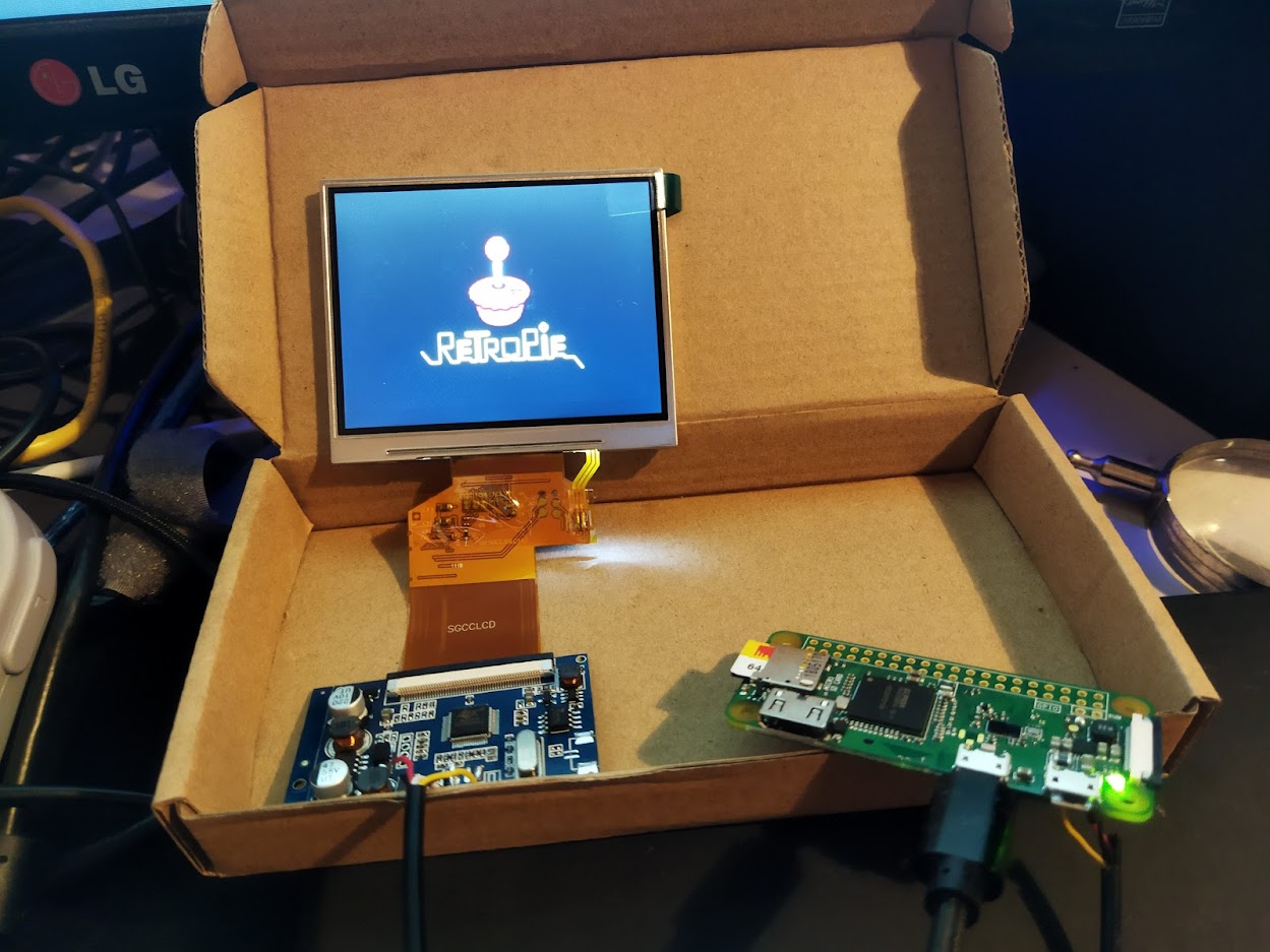

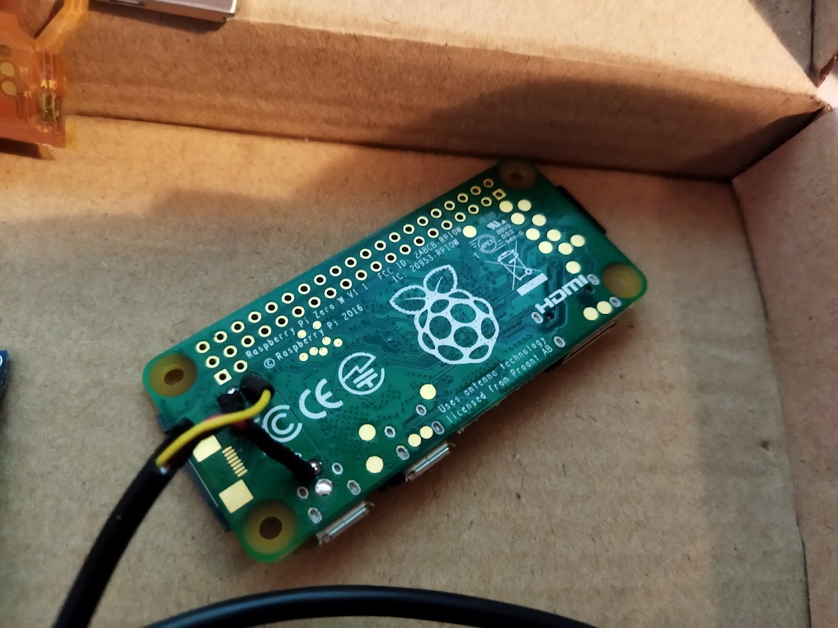

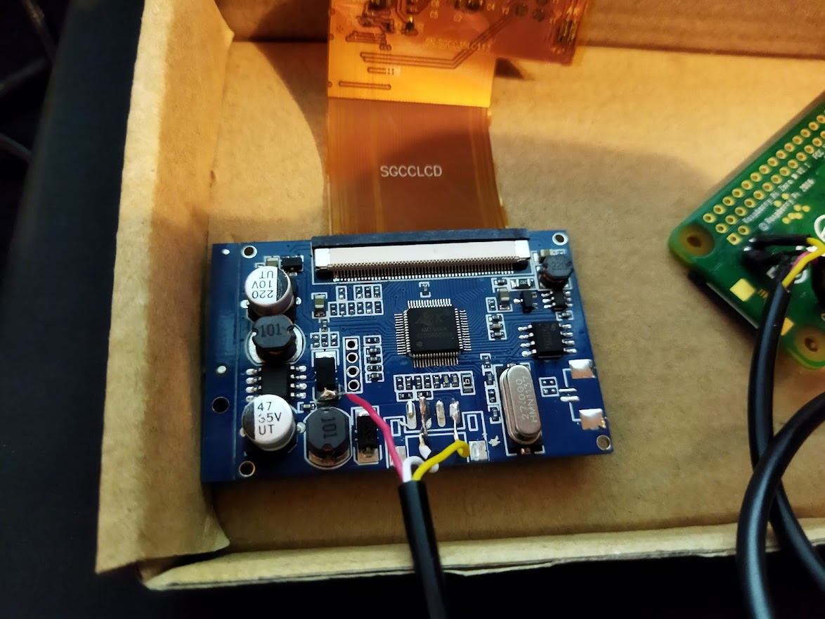

Post by Spykerwolf » Sun Aug 15, 2021 9:41 pm
Finally started the project :-)
Got the display, hooked it up via the USB GND & Video pins. Had a few glitching/lines across the screen so performed the 5V mod (even though this display should work without it). It's perfect now. Also started enlarging the display surround - still waiting on the lens protector so it looks a bit rough at the moment:
