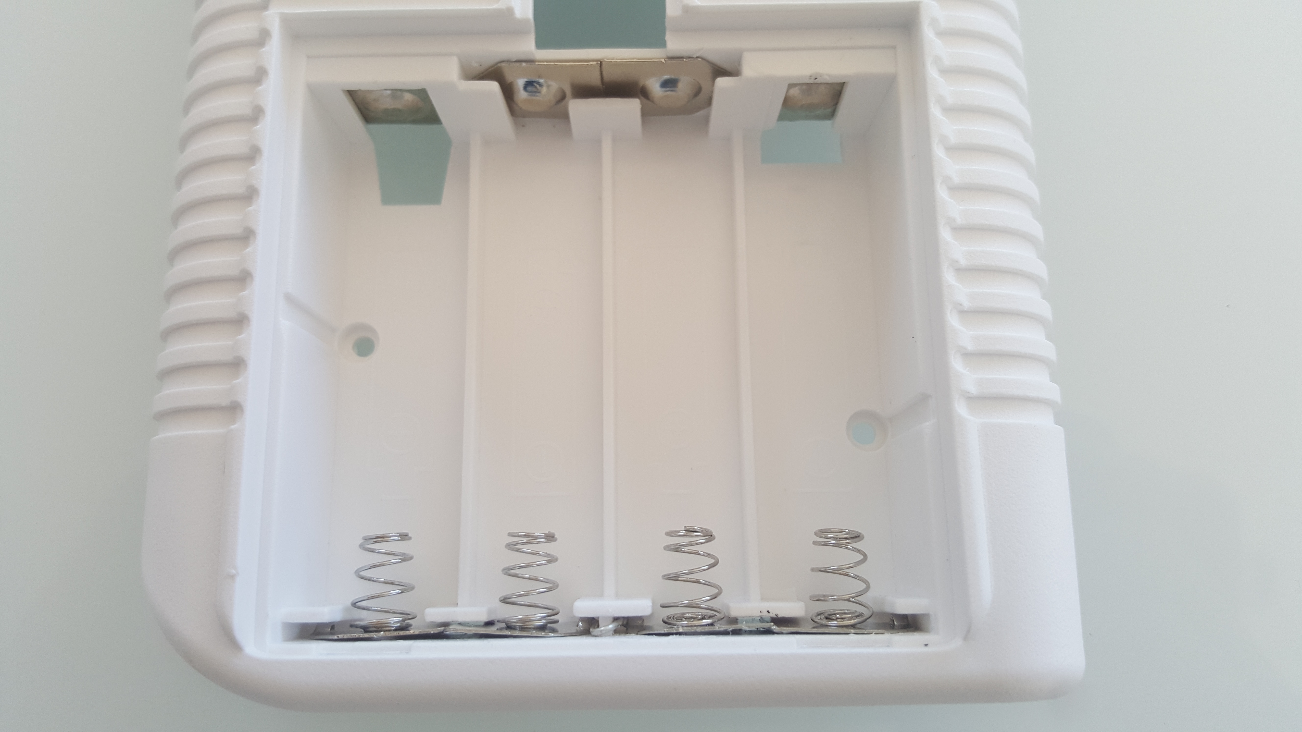

If you just wire the small metal pins (that hold the batteries in place) together (the right way) you might keep the battery compartment intact and just swap out the batteries for new ones (the same model).

Yes, be careful. The existing contacts will have the batteries in series.

I know, and I could modify it to to have them parallel using the existing parts and have each battery be removable easily.
I just figured that it's safer to create a complete pack in the same form factor with minor changes to the battery compartment and replace the pack all at once when needed. I don't know who besides me will play with it and doesn't know how it's set up and puts another half charged one or a normal battery laying around in there

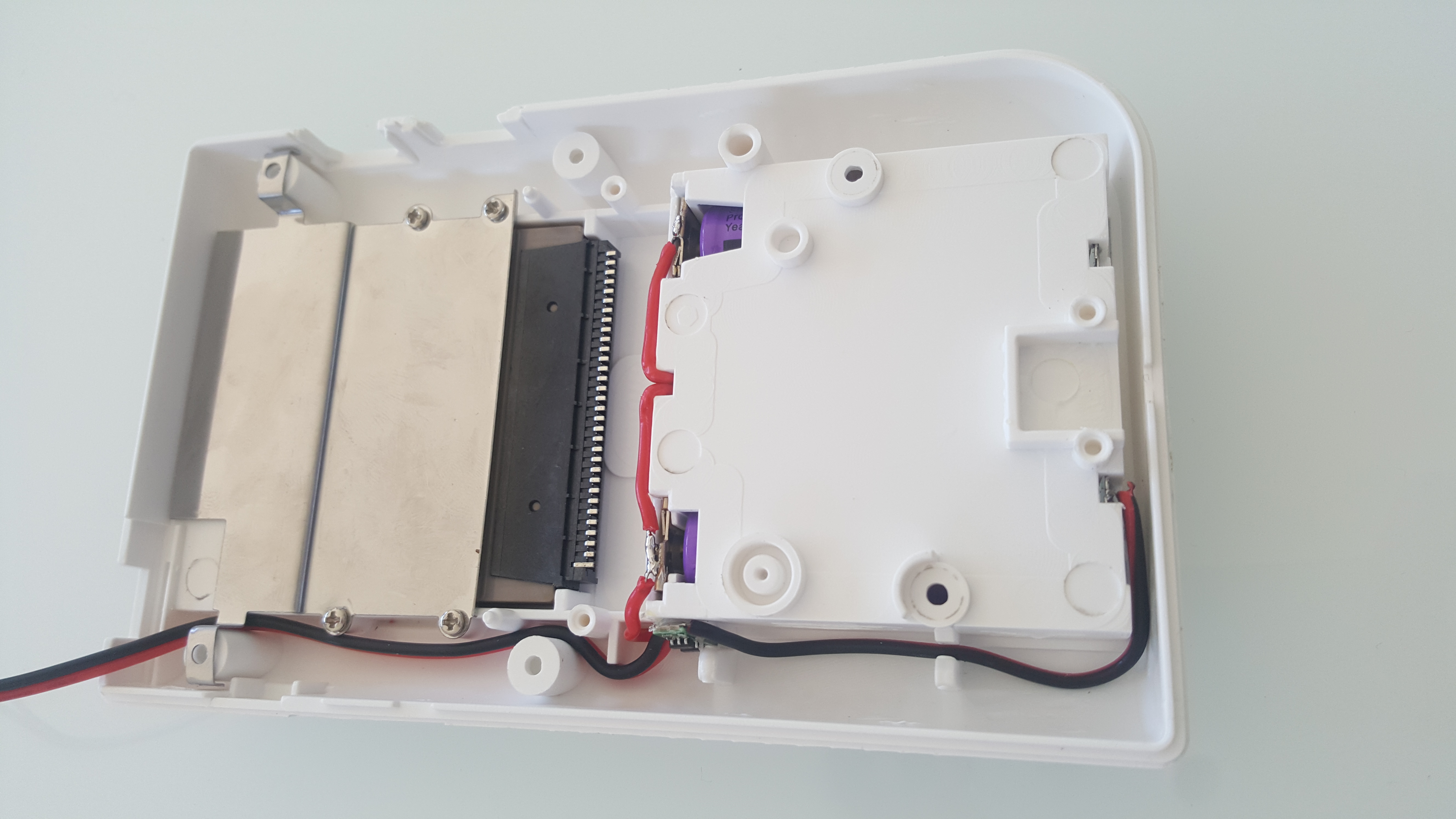

Ive done exactly what you're asking. Will post photos in the morning. Ive been charging and monitoring temperatures. So far so good. I also have a battery protection circuit on the battery bay in conjunction with the powerboost and a disconnect/hard reset switch to completly disconnect power from the batteries if need be.

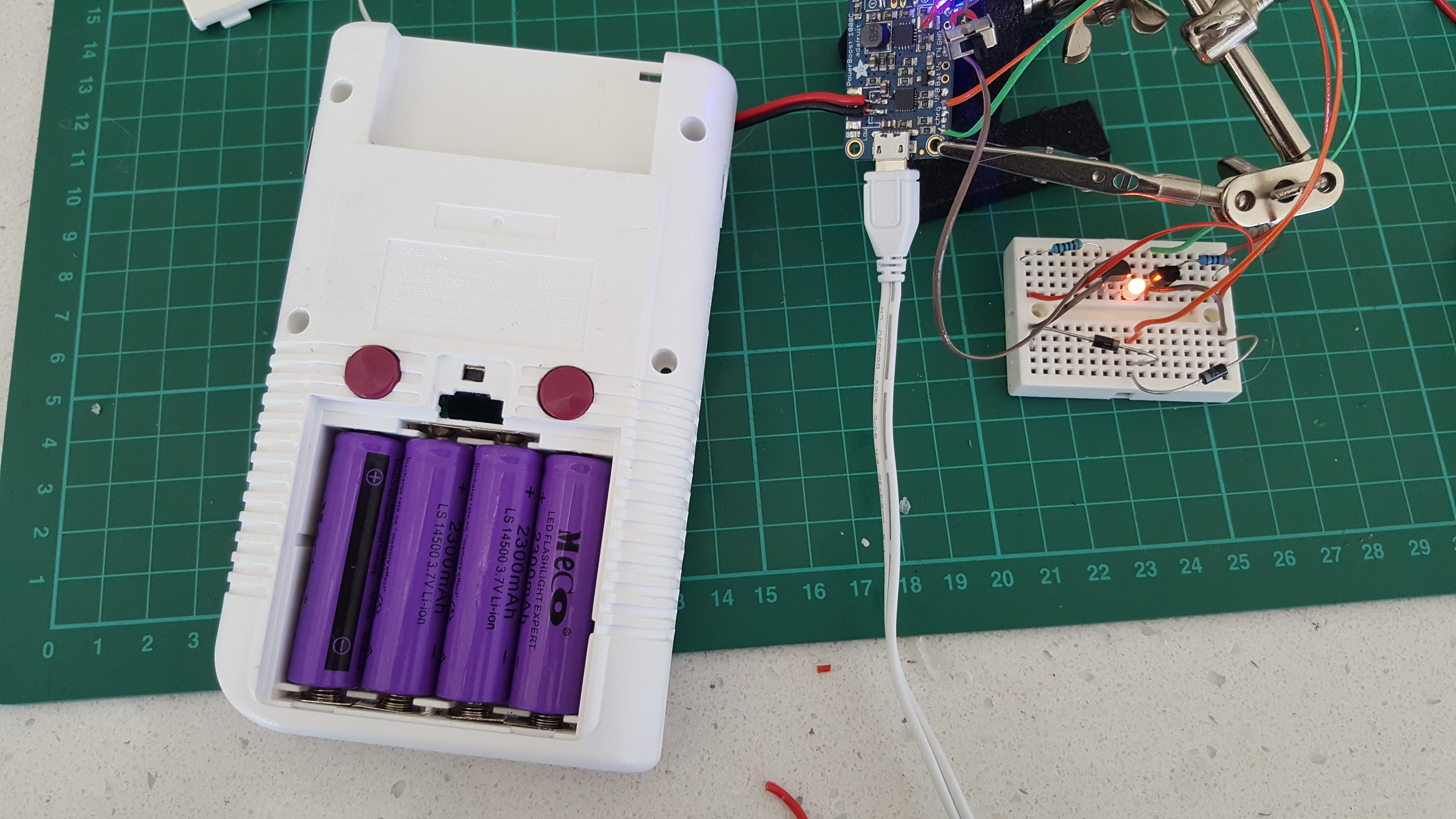

Here's what I've done.

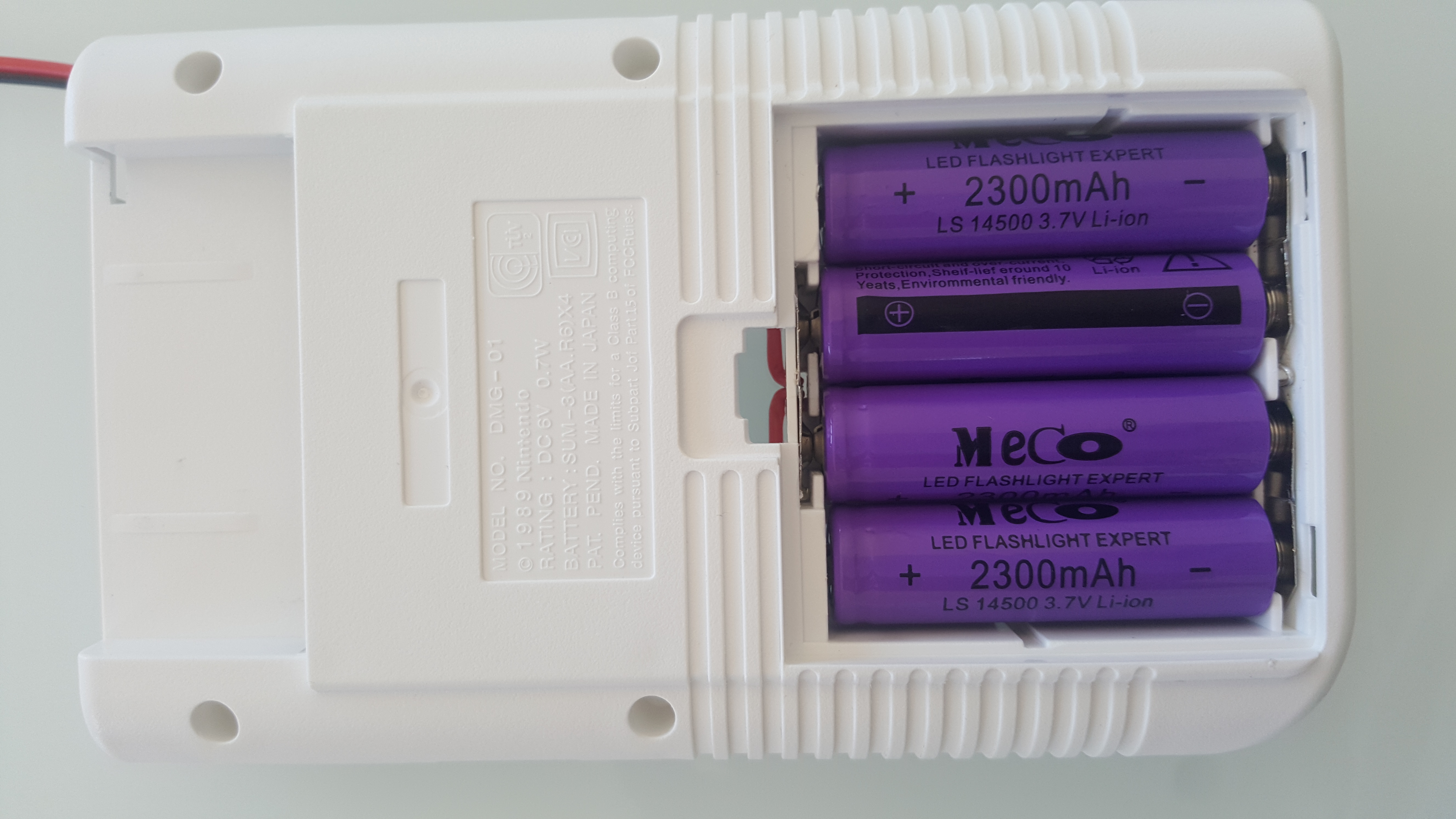

The first photo shows where i"m at with it at the moment. It now has a disconnect slide switch on the red + lead, after the protection circuit. It's mounted just above the battery clip between the L1 and R1 buttons and i've shortened the knob so that its flush with the surrounding case. This means i can't bump it accidentally while using it.
You can just see the battery protection circuit on the side of the battery compartment in the backside photo.
You can also see a charge status LED on the breadboard that i'm working on. I've broken out the Powerboost LED signals to a single 3mm, Bi-colour, red/green LED. This way i can mount the single LED next to the 5v input to monitor the charge status. The transistors won't be there in the end. I only had a common cathode LED but i've ordered some common anode LED's which won't need the transistors.
I haven't hooked up the low battery signal yet but like the powerboost itself, the LED will glow red for low, amber for charge and green for full.
