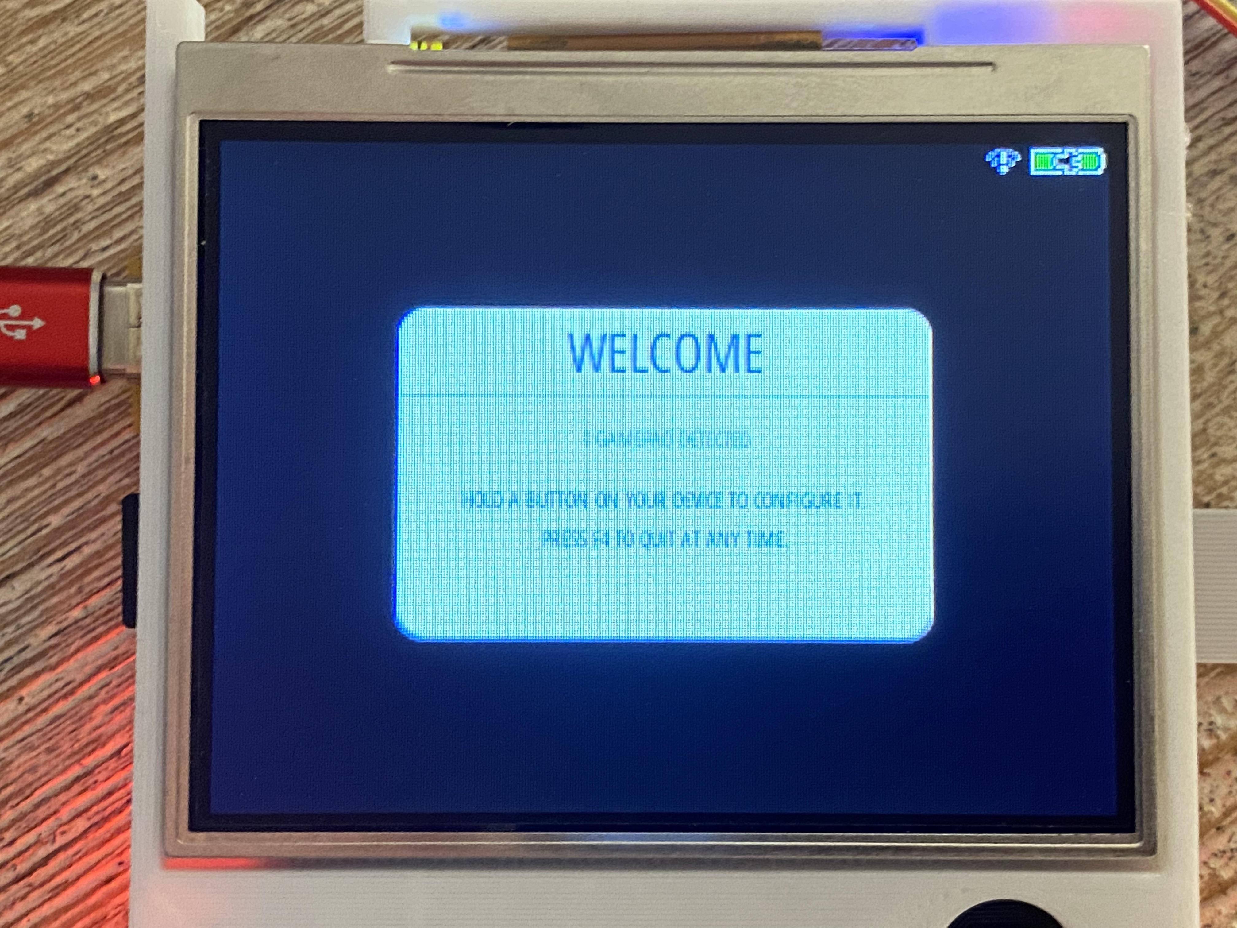

The WiFi icon shows an exclamation mark "!" and in the WIFI menu of retropie the WIFI scan finds no other network. When I put my SD card (Circuit Sword Software v1.3.3) into one of the other Swords, the WIFI immediately connects with my local WLAN and the scan also shows all my neighbours networks.

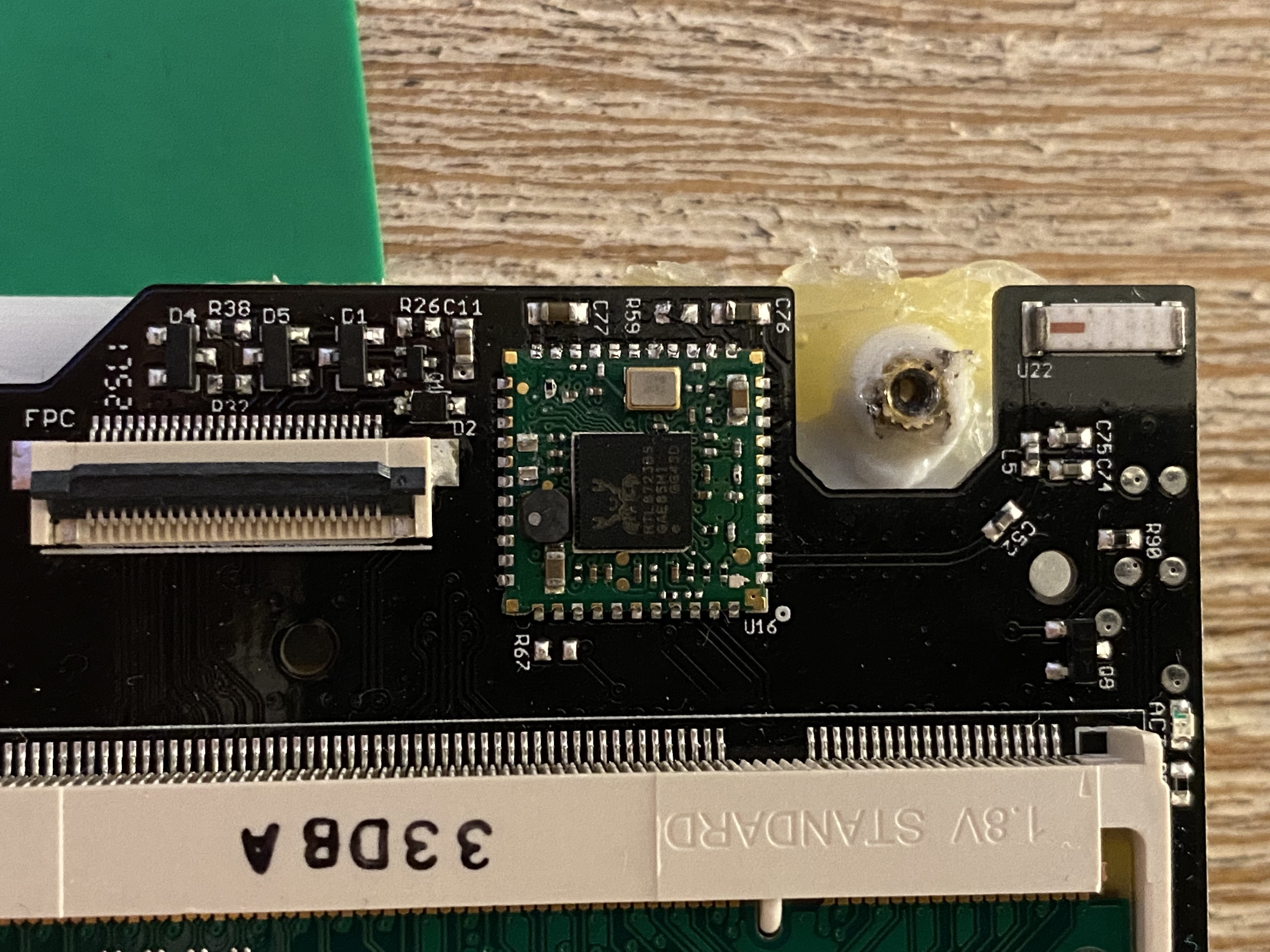

Thanks for the reply, I tried with USB-C power but without success. I can rule out a faulty CM3 module, as I tried 3 different modules and the same module works in another board. As the WIFI is a separate module on the board and the kernel and network driver is loaded correctly, I think it must be something broken in the HF part of the WIFI. So either something is broken in the WIFI module or the surrounding SMD parts are misplaced or not soldered correctly.
I added a picture of the PCB, maybe you can spot something odd.

Is R59 missing? Hard so see dark components on that picture. And the wifi module in that area looks been reworked on the joints?

No R59 is there, although being placed a little diagonally. However it looks ok and seems to have contact. Regarding the joints, for debugging purposes, I gave them some extra solder where it looked like there might be too little, but it didn’t change anything -.-
