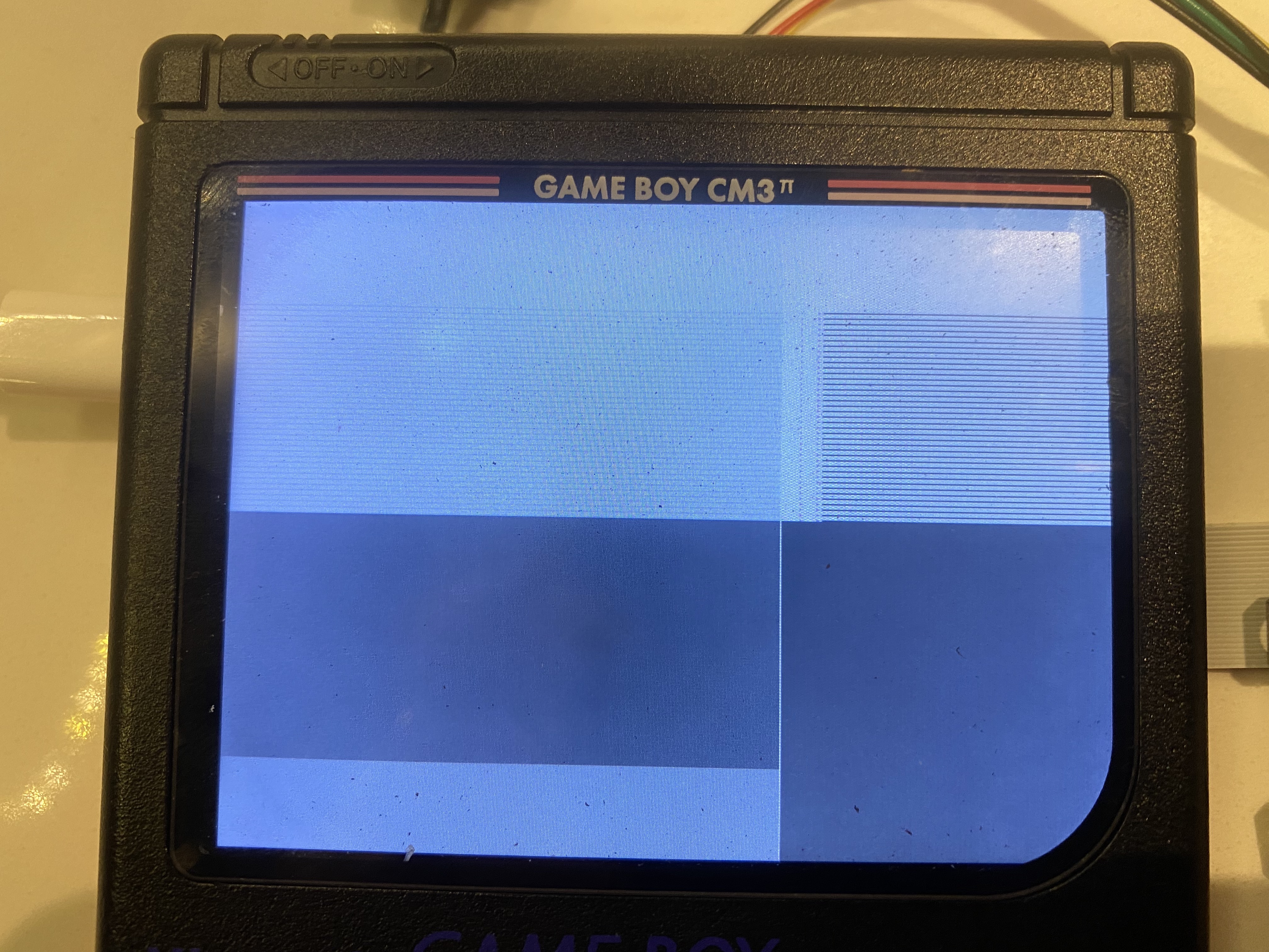

when I turn it on I get a bunch of lines on the screen:
It is booting up, and when I flip the power switch and turns off.
I have two of these monitors with the Green Tabs (newest version I believe) - so I tried the second monitor, exact same issue. I tried my old SD card from my previous Circuit Sword Build - Same/similar issue.
I also tried swapping out the CM3 with my old one, same issue.

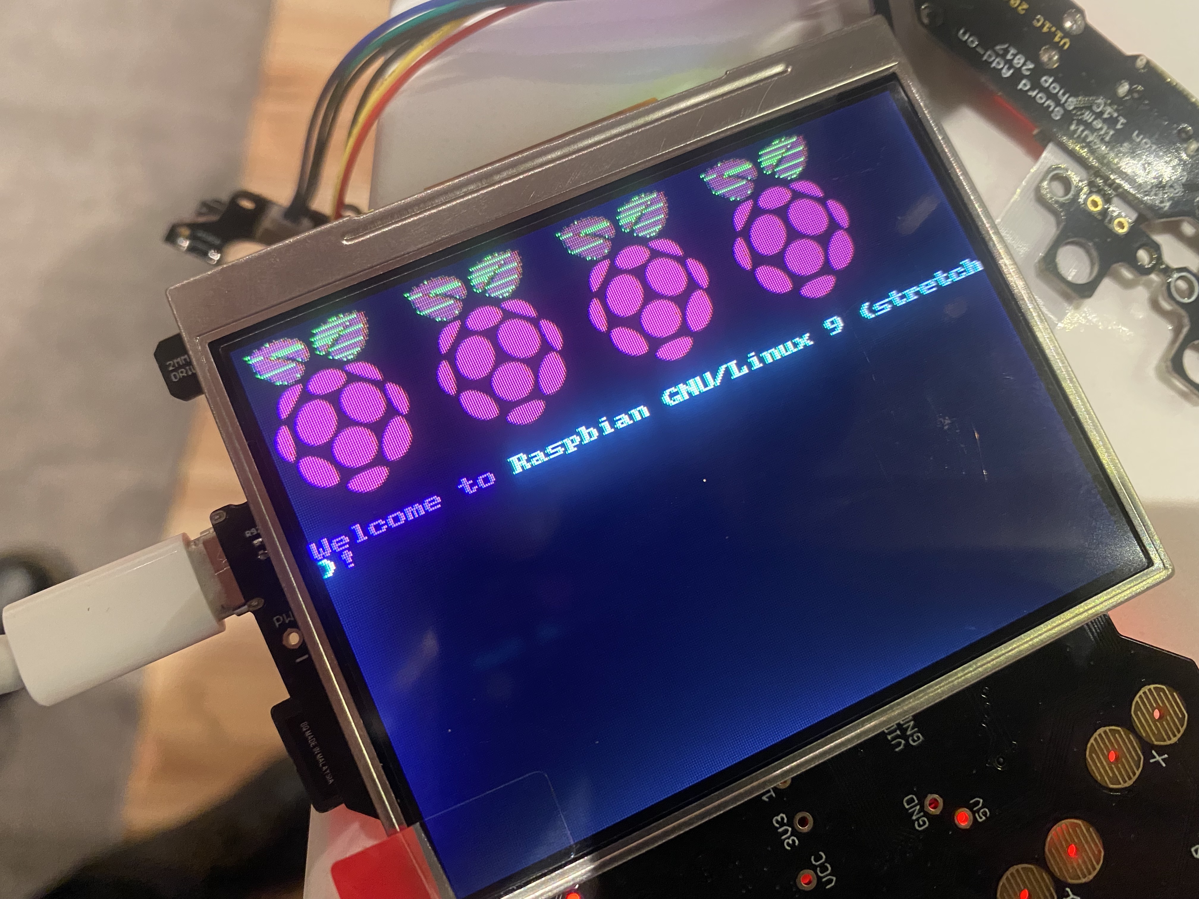

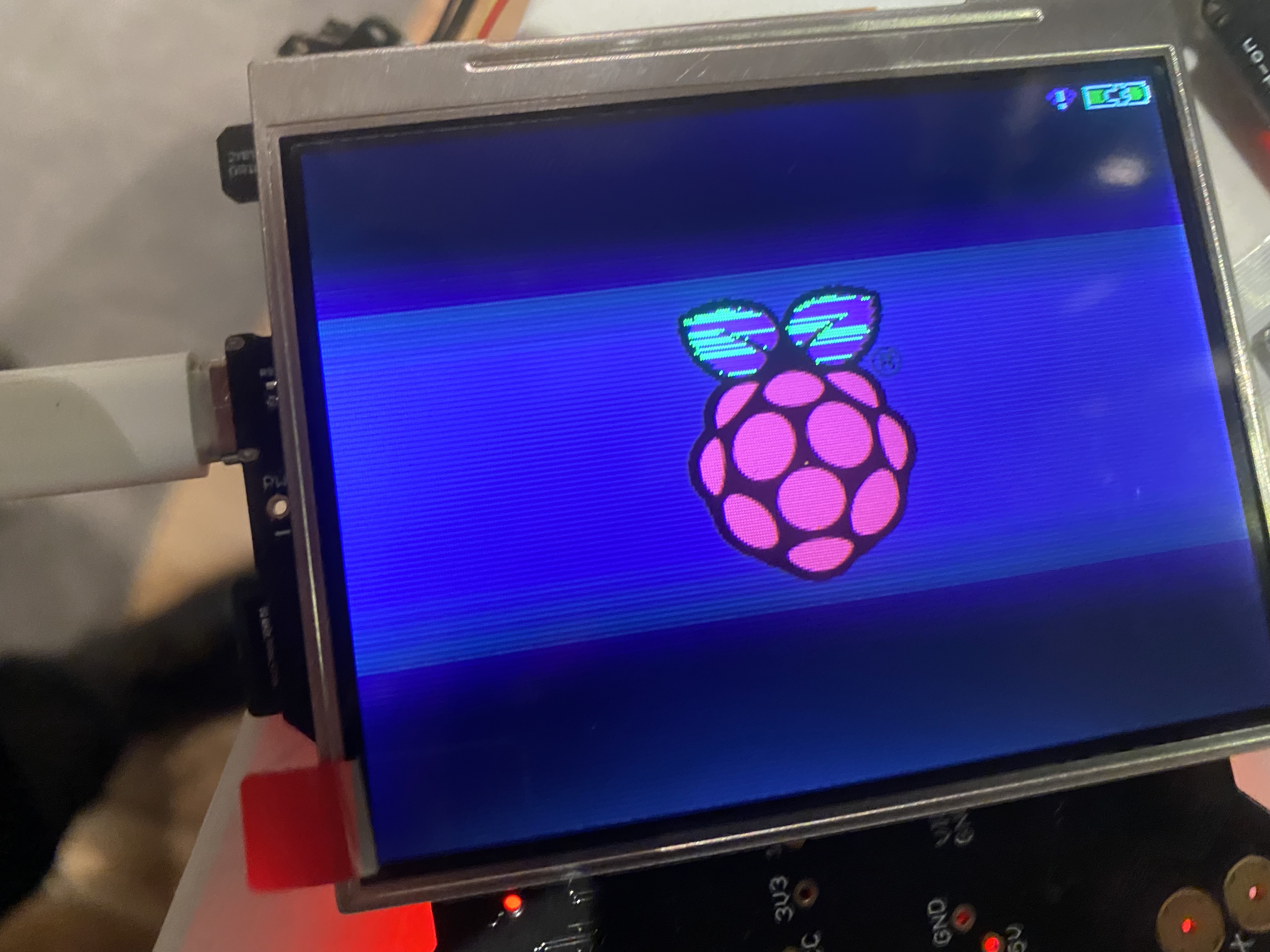

Now if i try to boot it up with the old screen, and newly flashed SD card I get this:

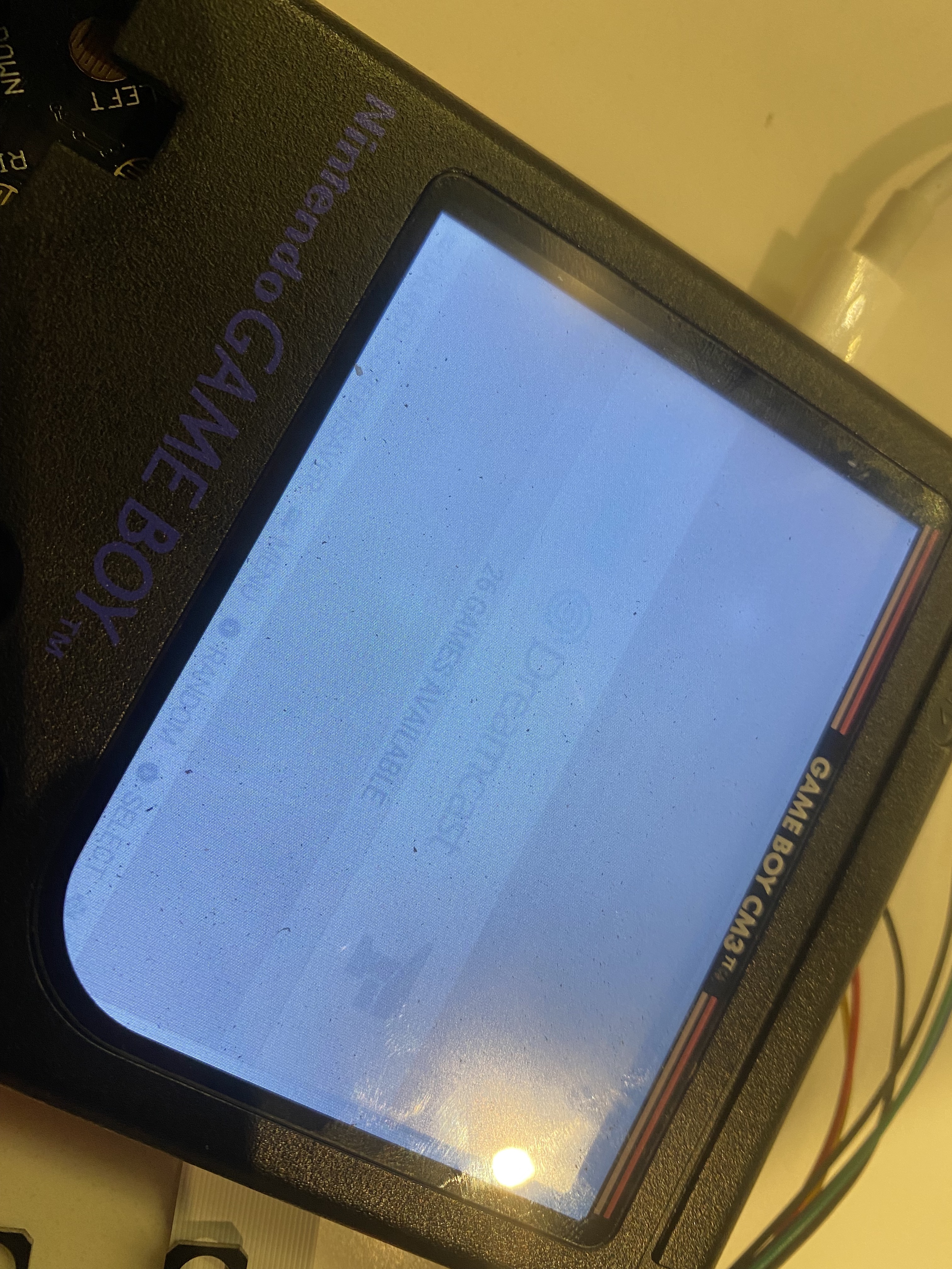

If I use my old SD card attached to the old screen, it boots up but it looks really blown out / low saturation

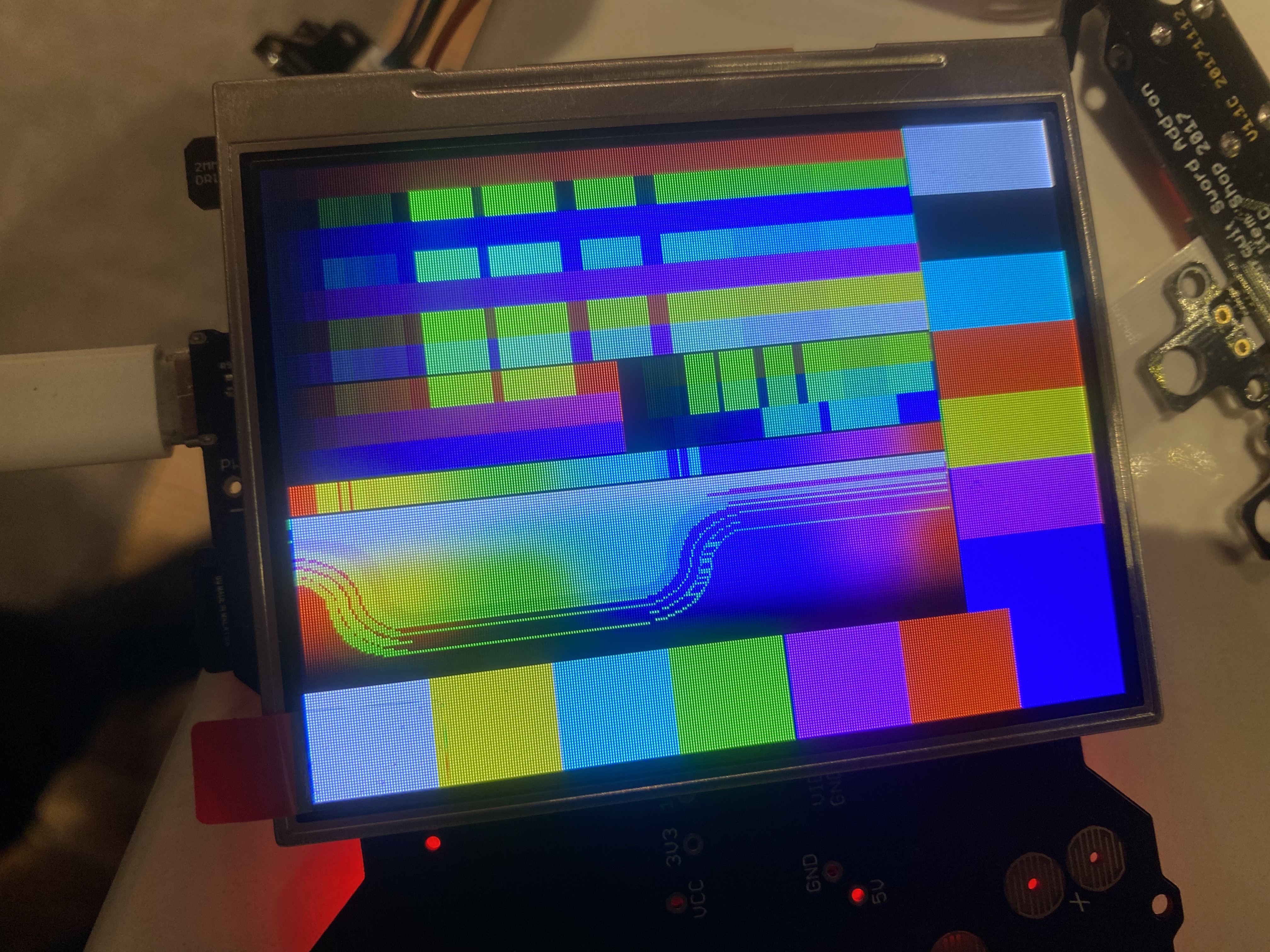

I finally realized I have a third screen, this one has a red tab on the screen protector (I thought I bought the extra monitors a while back to replace my old screen). With the newly flashed SD card this kind of boots up, it goes through a cycle, and reboots, the colors look to be all over the place.

I've recently unpacked my CSO 1.1e, and ran into the same problem. There are a few threads over in Kite's support sub-forum about this too. The short version is that there may be solder bridges on the display FPC socket or even the CM3 socket on the other side of the board.
Here's a short youtube video that shows the problem (and solution):
For my part, I think I've actually damaged my CM3. I've taped off the affected pins with kapton tape, and found a few that are stuck low, and one that is stuck high. That's not really reparable unless I can find another CM3. Rumour has it that the CM4S will be backwards compatible, but failing that I might have to bodge an SPI screen in. Until then, I guess I'm playing headless :lol:
