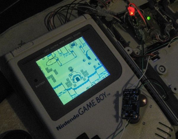

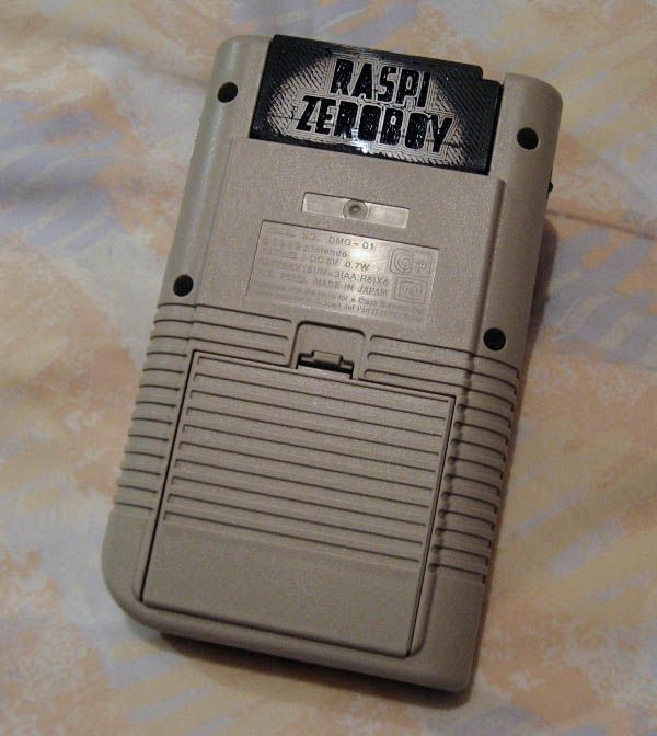

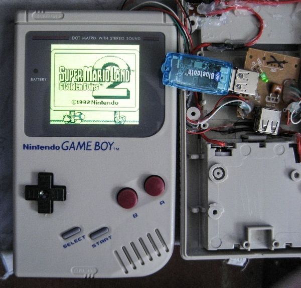

With thanks to Wermy and this amazing forum I've managed to start building my own custom creation using a Pi Zero as the base. I had a few feature requirements, initially hoping that it would end up being practical. Some ideas I had to shelve but a few were practical and I included.

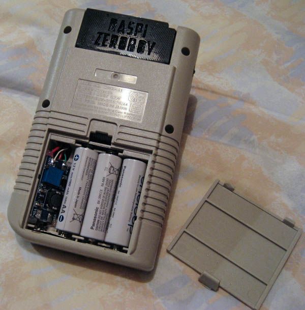

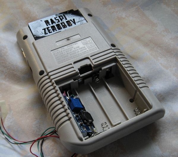

-I wanted to be able to run mine off AA batteries, just like the original Gameboy (mine will run off 3x AA's instead of 4 though). Therefore I could use the original battery compartment and change batteries very quickly.

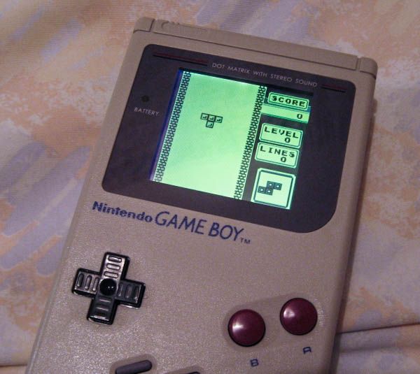

-Also wanted to keep the original screen size and to keep the unit looking as 'stock' as possible. Along with doing as little dremel work as possible.

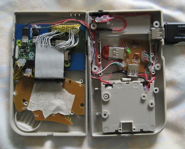

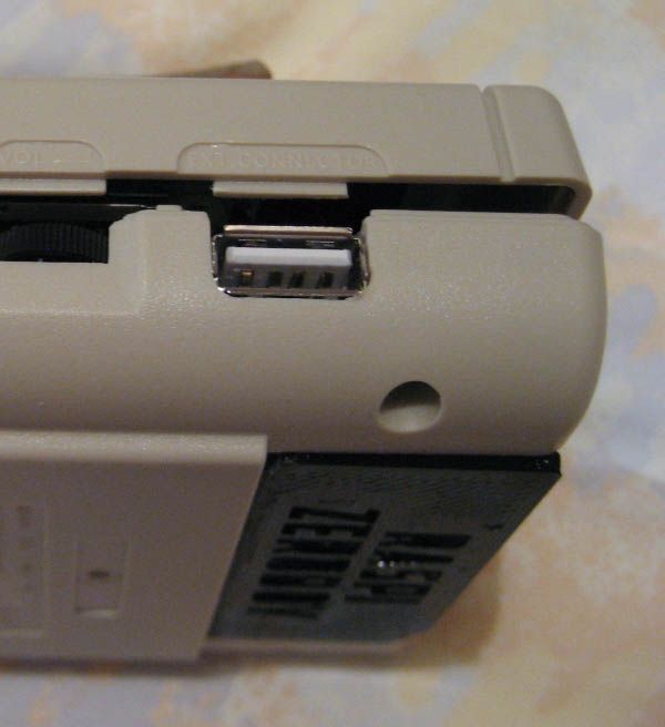

-Use a cheap usb hub to add extra USB options.

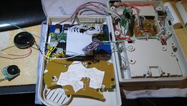

-USB audio dongle with amp for half decent sound.

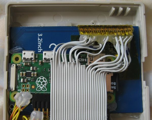

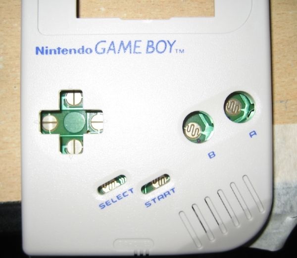

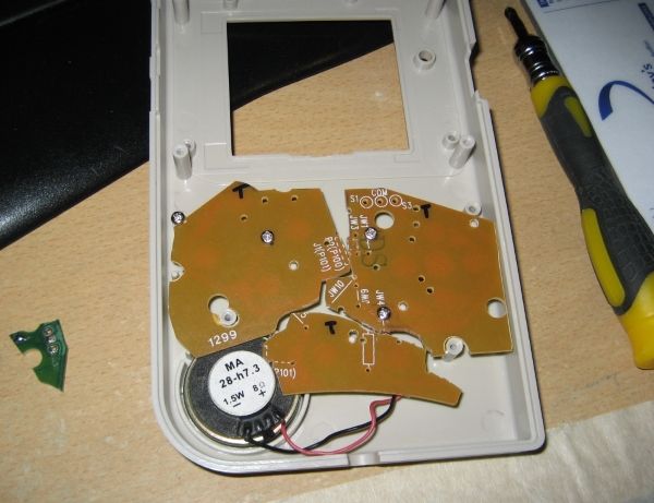

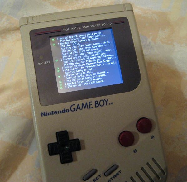

I cannibalised an old PS controller clone to make the button pads. Wiring up the lcd I got was a real chore. I'm not great at soldering to start with but managed in the end. It's a 3.2" and I had to mod the case a bit but I'm using the overscan option to just display the middle section. It looks pretty decent now it's installed, and straightened up. Nothing worse than a wonky looking screen.
I think I need to work on conserving power now, as with it only running on 3x AA batteries it lasts a little over an hour at the moment.
Also the boot up sequence takes a fair time. Not sure how to improve that though. Maybe someone has some tips?

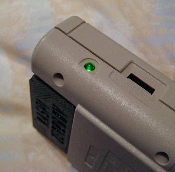

Need to add a headphone jack, extend a power led, and just waiting on some potentiometers from China to arrive and it should all be finished.

5v 2A dc step-up power converter board ... sku: MT3608

old snes clone gamepad
wiring

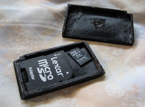

3d printed half-size cartridge
3x AA re-chargable 2100mah eneloop batteries[/spoiler]

Here's a few pics:
I've got quite far with my build and will post more pics later.
