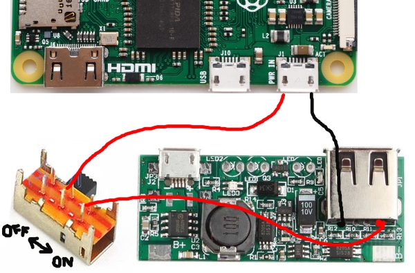

Maybe a stupid question but how do you connect the power switch to the bankgood powerboost. Any reason i shouldnt use this one over the adafruit? Thanks

No reason not to use the banggood one. I think the only other thing an adafruit one has over it is the low battery led. I'd remove the usb connector and wire it like this if it was mine, as this should allow the battery to be recharged while the pi is off:

I also thought about doing this but i couldn't find a switch that is rated for 1a. Wouldn't it be safer to use a Pololu Mosfet Switch?

I think the pi zero running draws about 150mah. :?: The switch in the wiki is rated 500mah. What switch are you folks using? If you are powering high drain devices directly via the pi then yeah you would be wise to use something like you mention.

How would you wire the battery to this exactly since there is no plug like the adafruit?

I got mine today.
The battery goes across the B+ and B- pads at the board edges.
