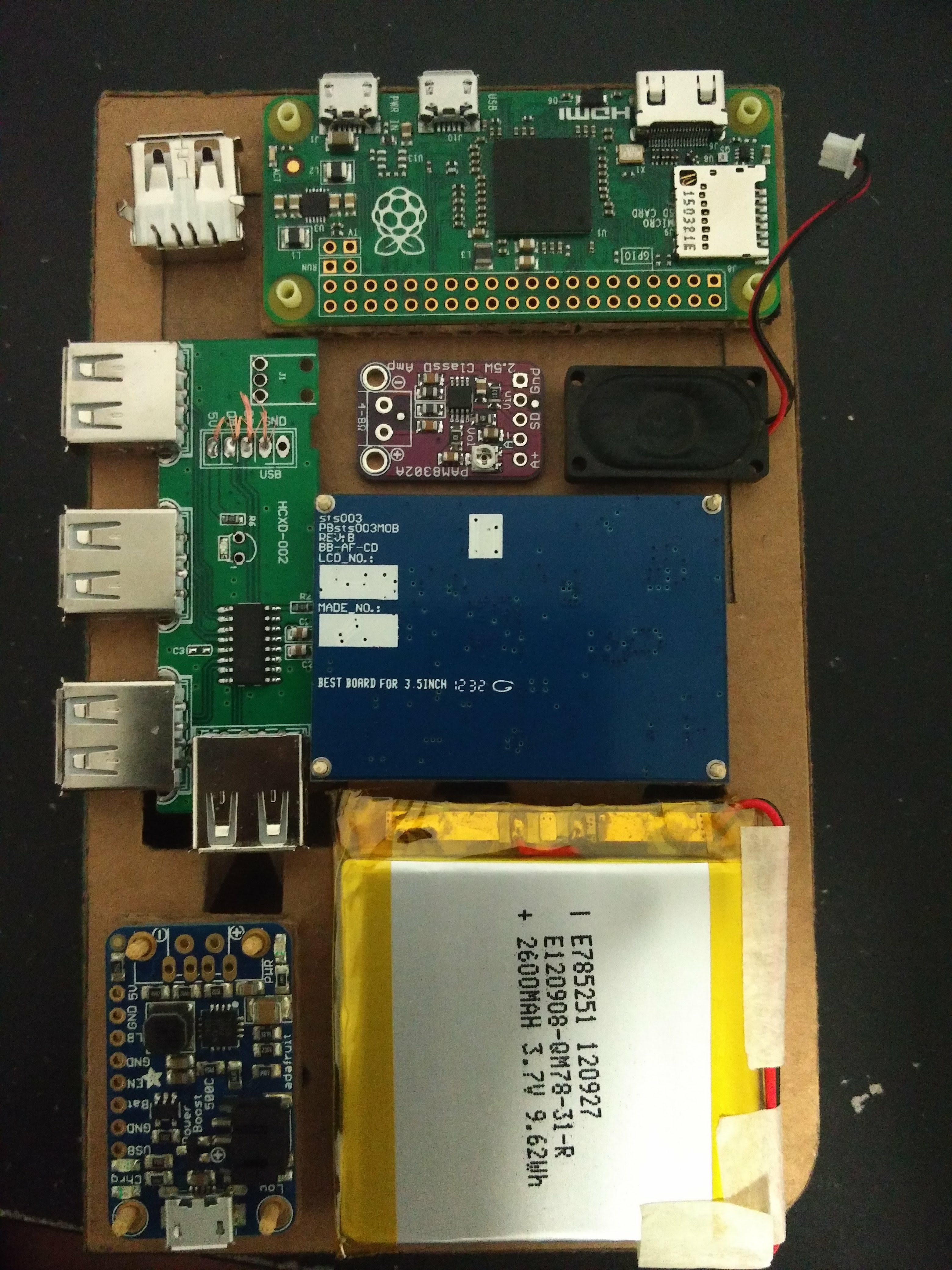

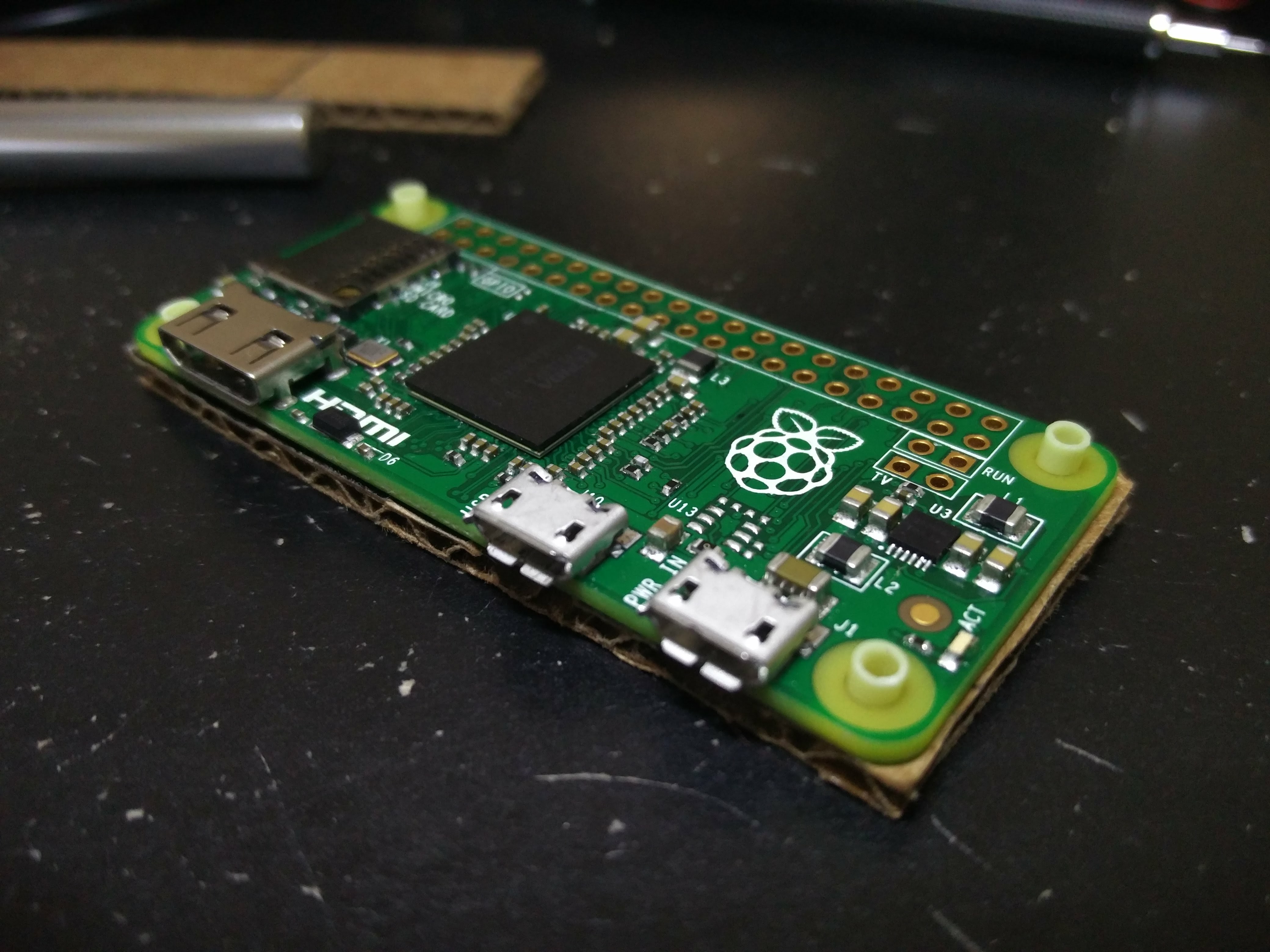

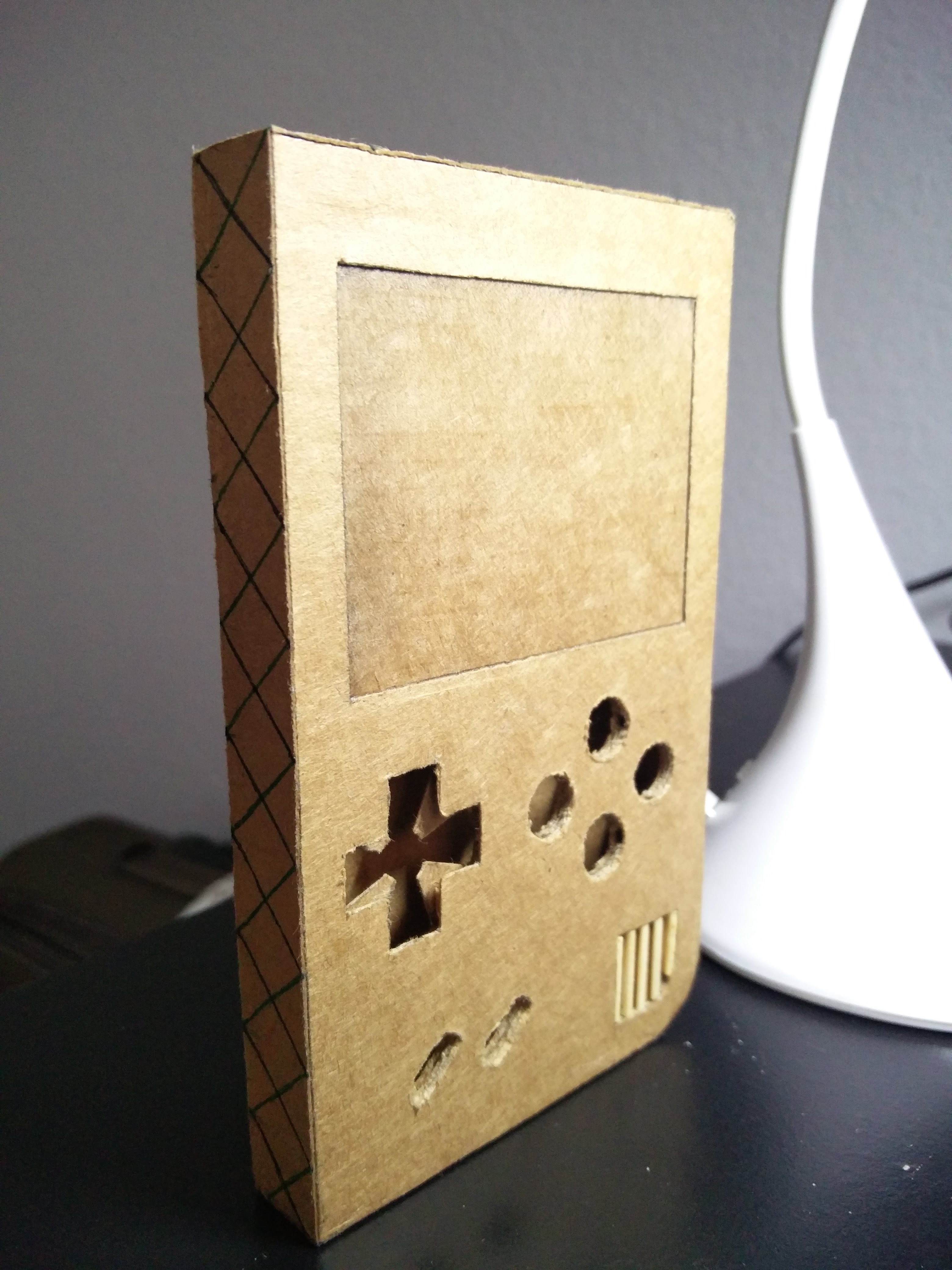

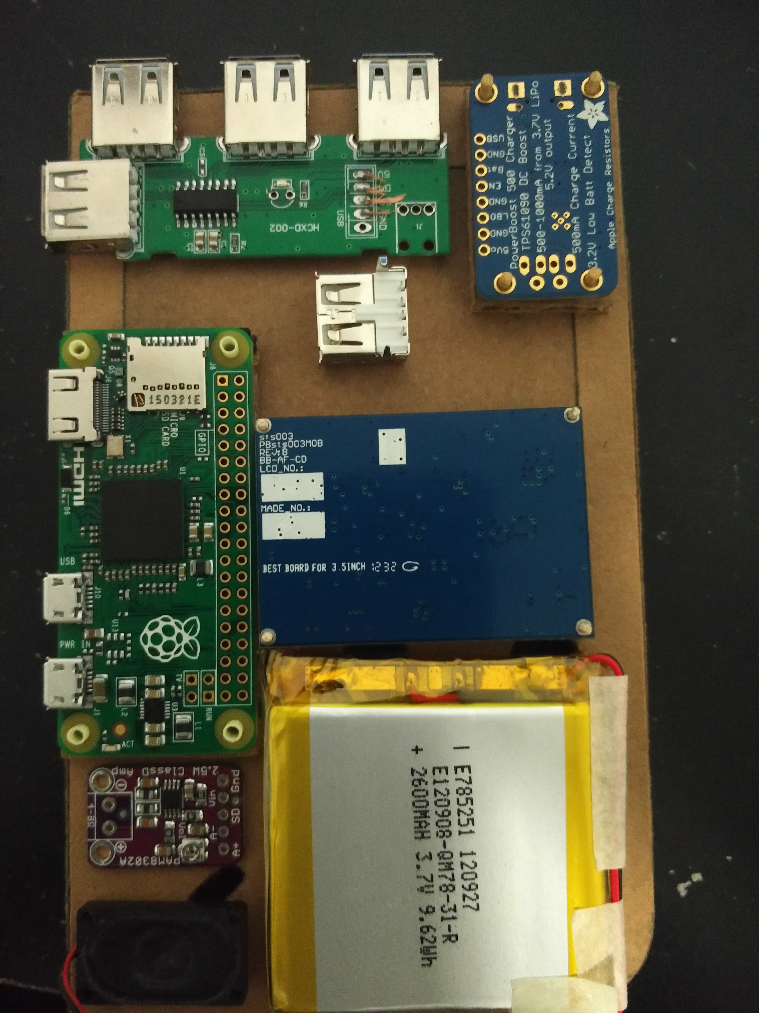

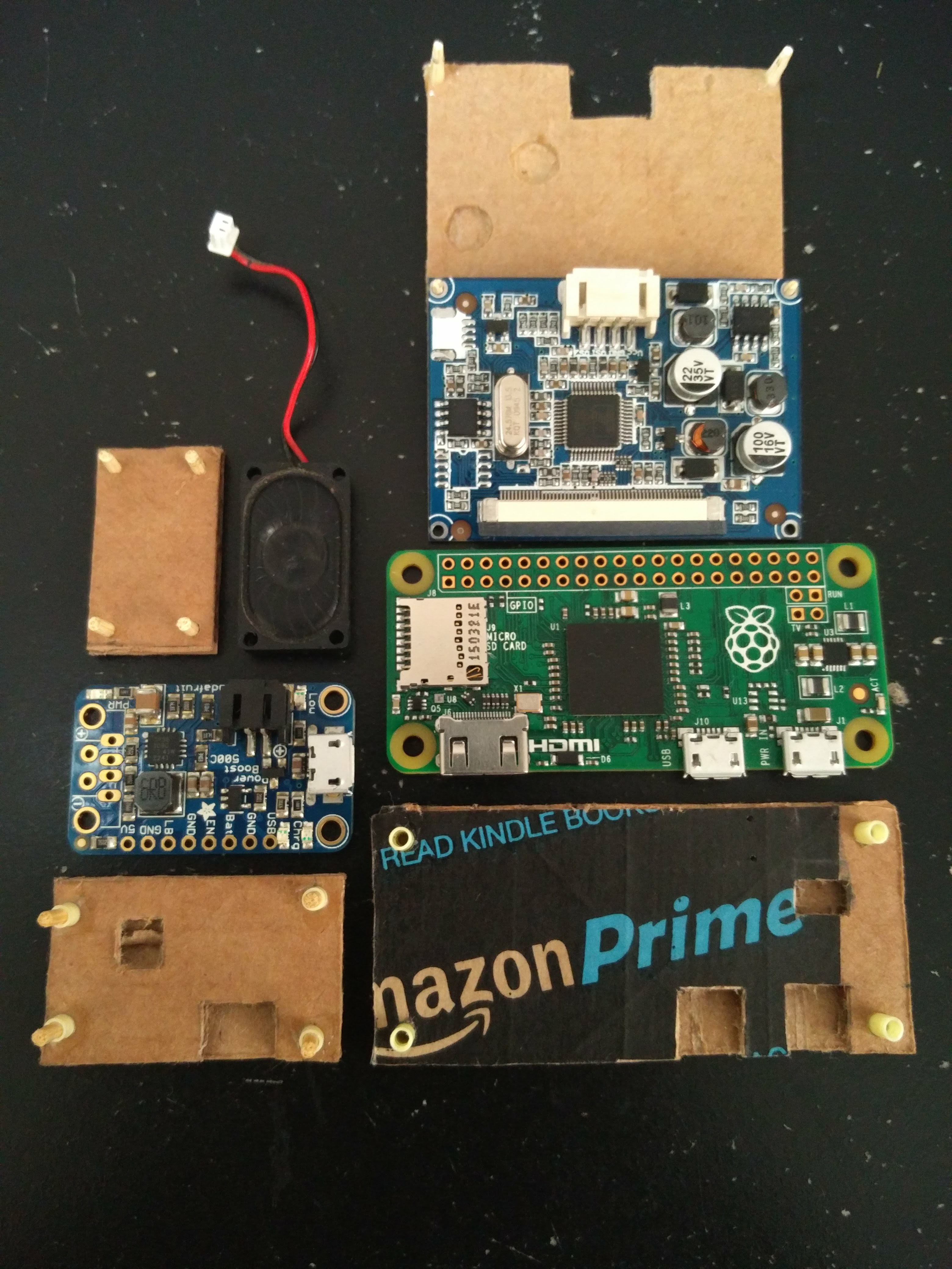

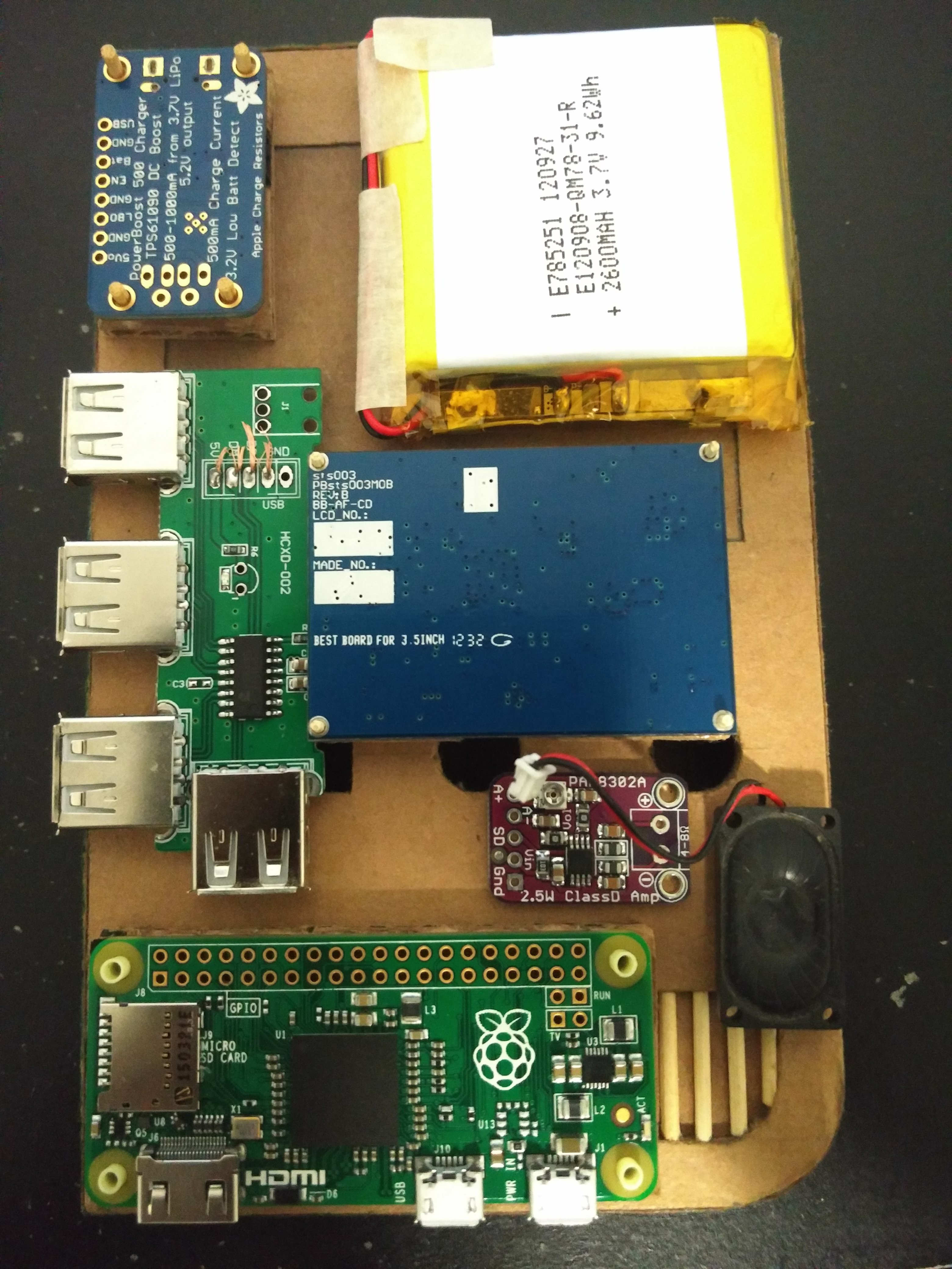

Hello guys, this is my first post here. I wanted to make a pi zero game boy but using cardboard rather than 3d printed or original mod.

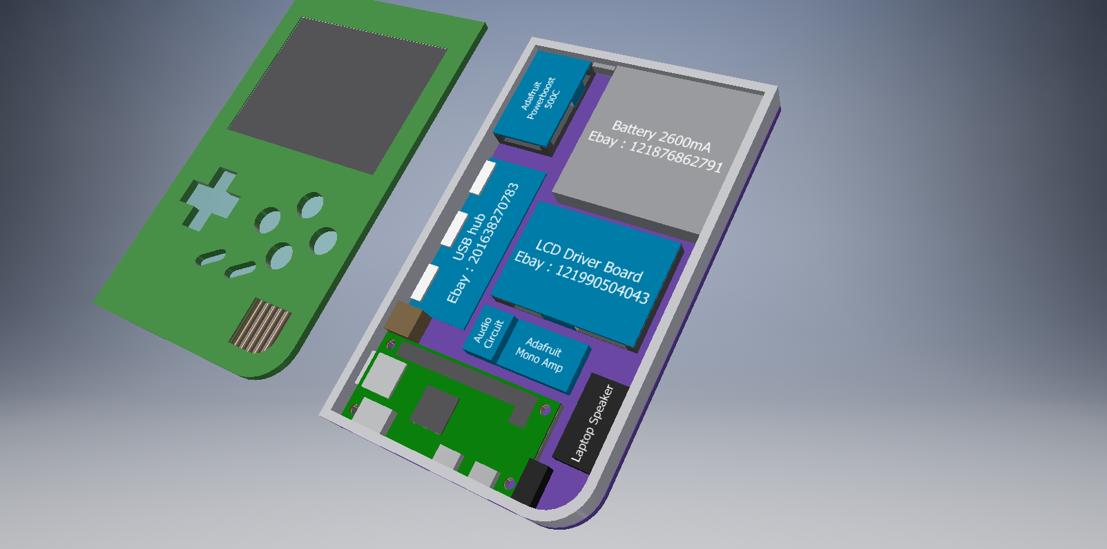

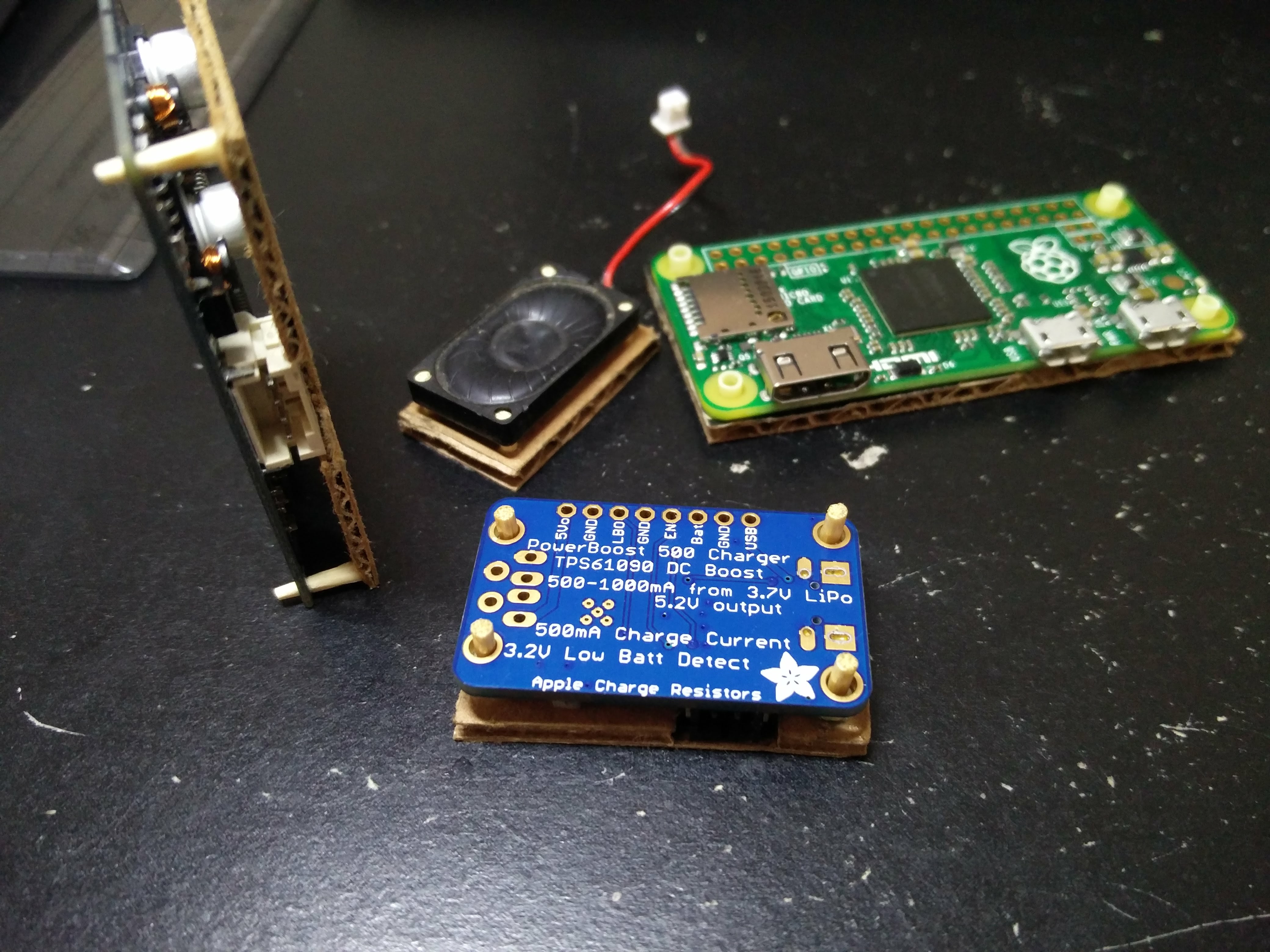

So I made a prototype with accurate dimensions and glued it together to see the integrity of the model. Then as I started getting the parts I modelled them in Autodesk Inventor and came up with a layout plan. There are three plans that I have worked out and would like to have your opinion on. The parts number bought from ebay are also listed in the images. The button holes have slits for the hinges as can be seen in the up and down button, not the dpad.
Dimensions :
  • Cardboard thickness = 3mm
  • Thinner cardboard thickness = 2mm (used to mount display driver board in blue)
  • Internal spacing = 1cm
Autodesk model
Parts and supports
Parts and supports assembled
The RPi Zero
Arrangement 1
Arrangement 2
Arrangement 3
Cardboard model

Well everyone is either using an after market case or the original one. Both are too fat for me. I wanted something slim.
I was interested in making my own from the start. If you consider the costs for the tools then things go overboard quickly. Cardboard is easy to source and to sculpt. The only disadvantage is that the case is sealed. I cannot modify the components once its all put together. An alternative would be to use screws and screw wells rather than glue to attach the back plate. Might try that too.

Interesting idea. You might want to use a power switch and a potentiometer for volume control. Although you could control volume level in software too. Might need to reinforce the areas around these things though as they would be pushed and prodded repeatedly.
I think it's best you lay out the main items like screen, and pi placement, and then work the other parts around those, than picking a certain design from the start. In my builds so far I'm constantly moving stuff around to get best wiring or to get items to fit. You also need to make sure that nothing interferes with anything else, for instance non-shielded components might give RF interferance possibly messing up audio or video. Just something to consider, you may not have this problem with your parts.

The only constraint in my arrangement is the position of the LCD controller board. Rest is free to move. Another aspect that i was told is the weight balance. My initial model (Inventor one) was too heavy on the display side. This meant that in a fall there was a high chance for the display to break. Also holding it would not be comfortable.
