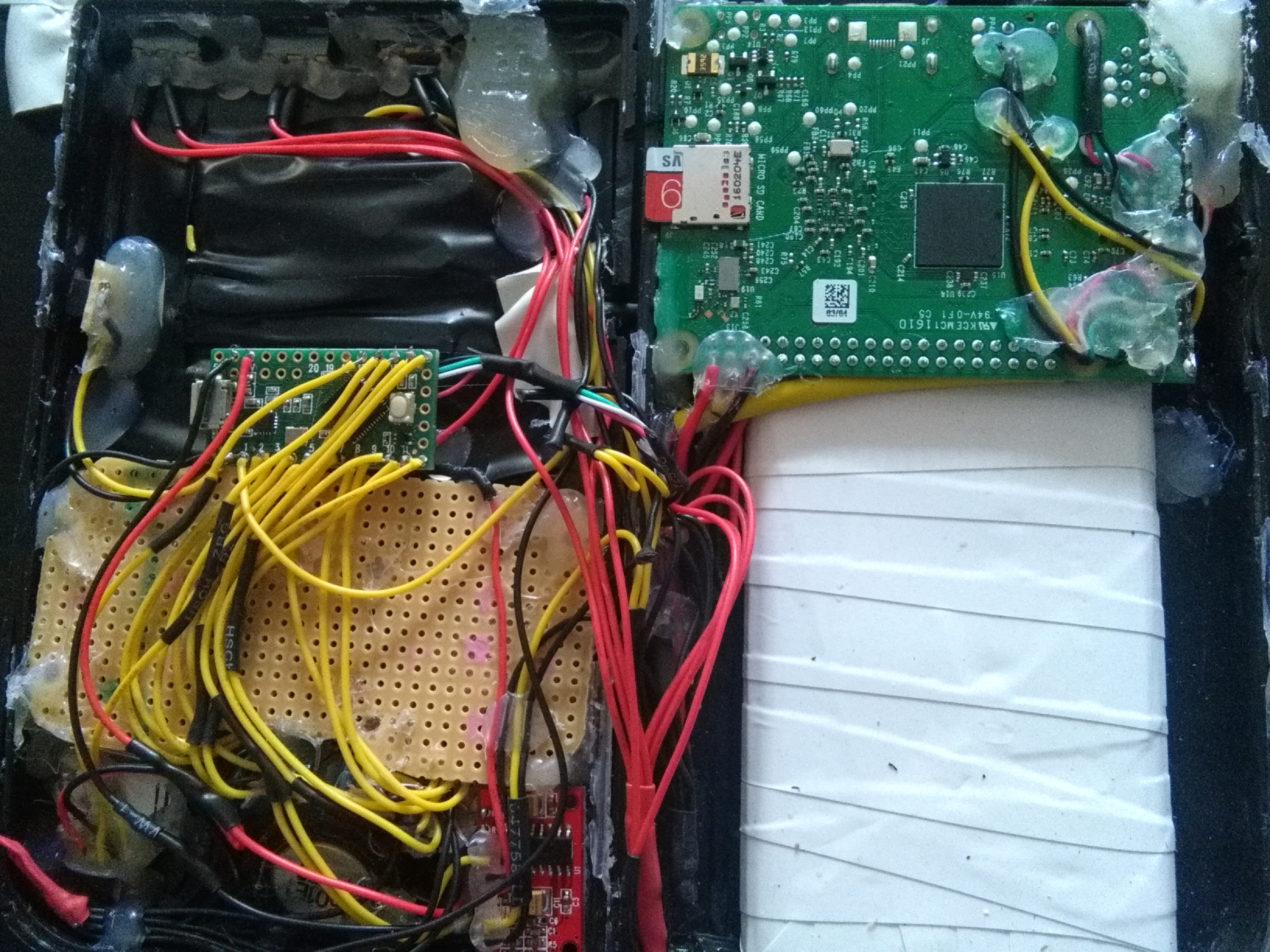

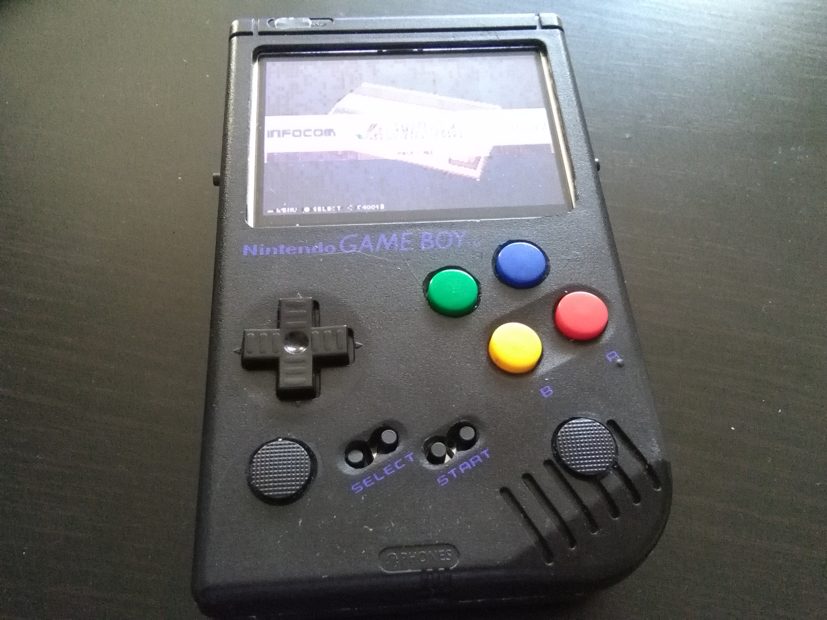

My first attempt. Tried to fit in everything I might need. Found out I didn't need a lot of the stuff I tried to add.

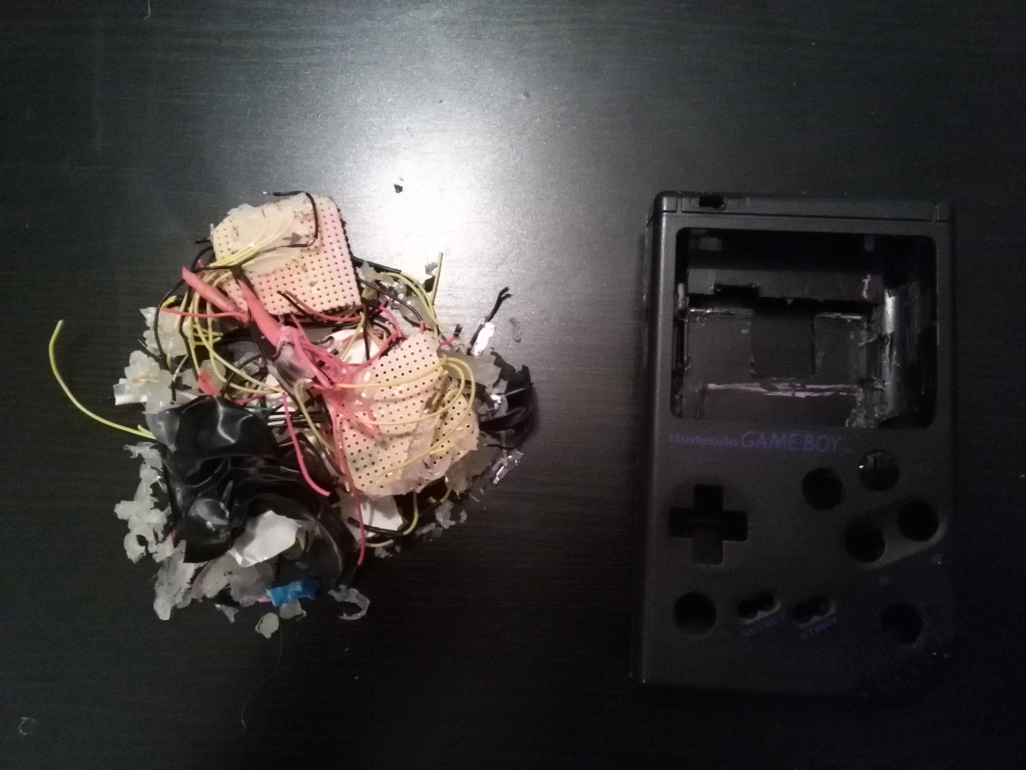

I really appreciate all the info on this site. My next build will be way better, learned a lot making this monster. Train rides are an absolute pleasure! Dismantled this for the parts to do a better job.

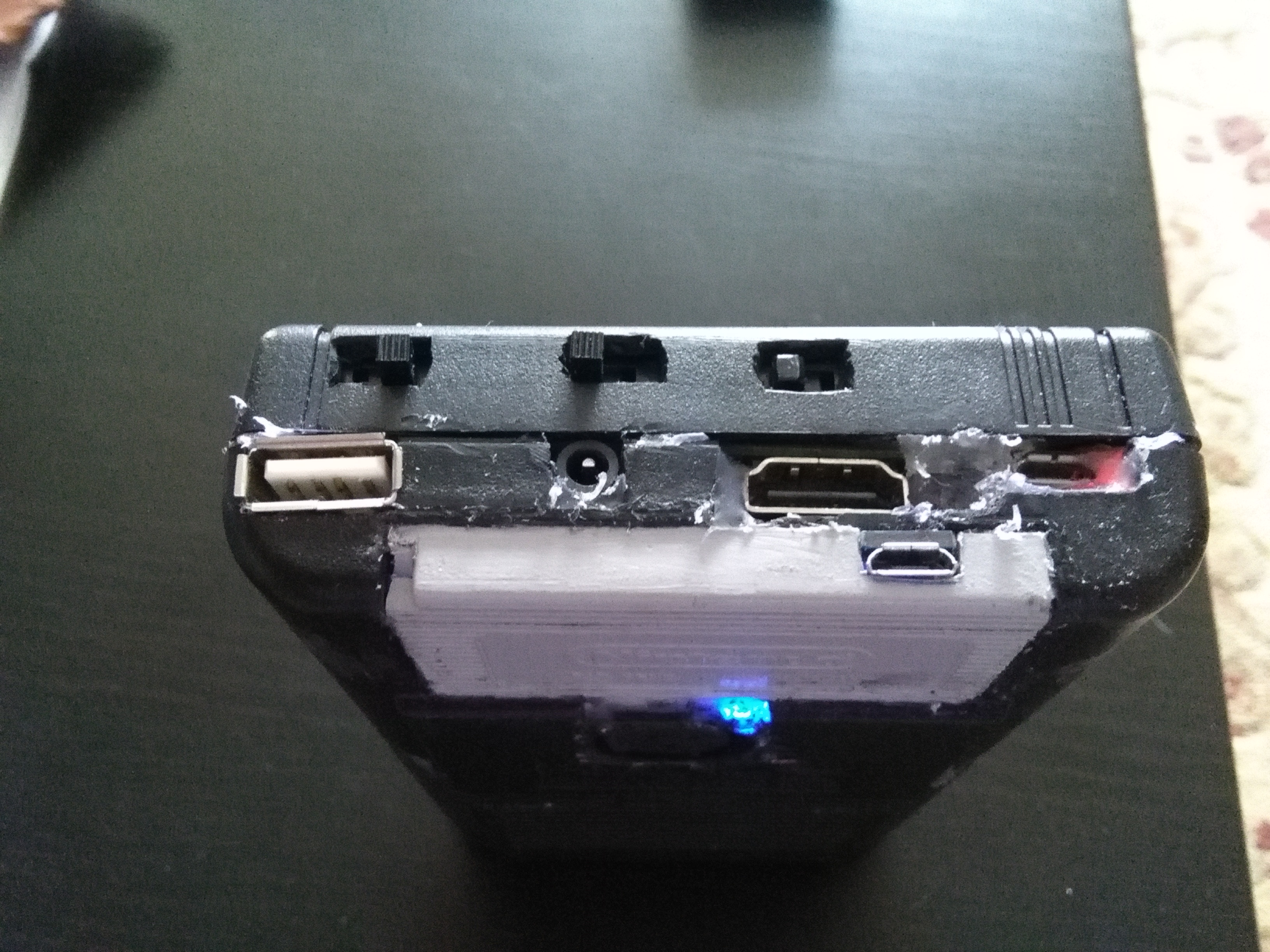

Pi positioning and fan(Heat sink and a fan keeps it pretty cool)
HDMI port(looks and sounds great on the big screen)
SD card access
Battery Size(6000)

[spoiler="The monster"]
The monster
[/spoiler]
[spoiler="Top View"]
What will be left out
[/spoiler]
[spoiler="the insides"]
The cramped insides
[/spoiler]
[spoiler="What will be left out"]
Hdmi Port
[/spoiler]

Which Joysticks do you use?

Psp1000 ones. Pretty cheap and easy to setup. I got stuck on the arduino code to make them work right as a dual stick controller but the actual install was easy.
