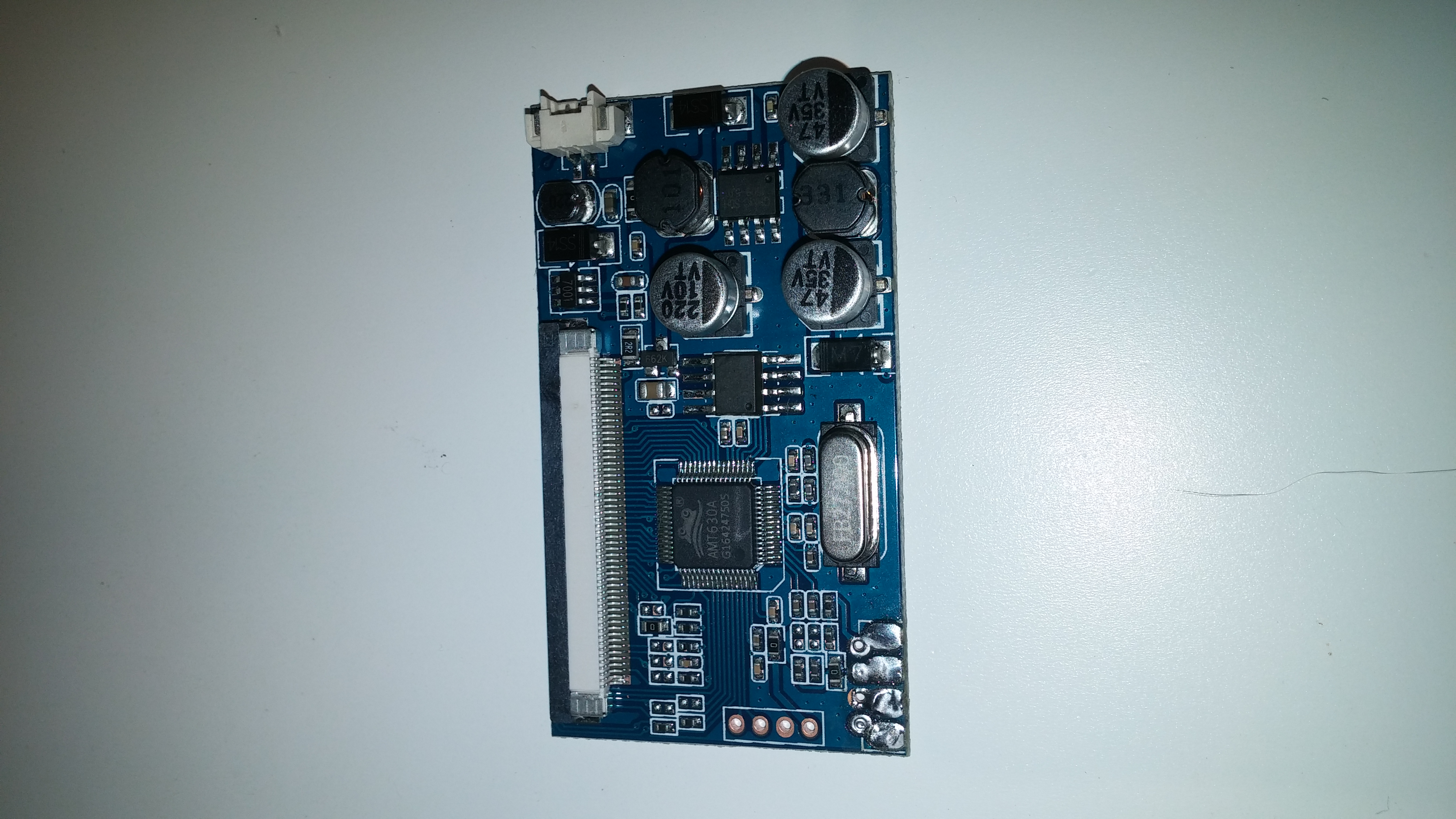

Hello everyone I could really use some help I been trying to figure out how to convert this LCD board to 5V but I can't find an answer.
Here's the picture of the board itself
ALSO: here's the link where I bought it (it was really nice well packaged and also the screen doesnt come glued to the case so it was easy to remove) https://www.aliexpress.com/item/3-5-Inc ... 04646.html
Thank you in advance.

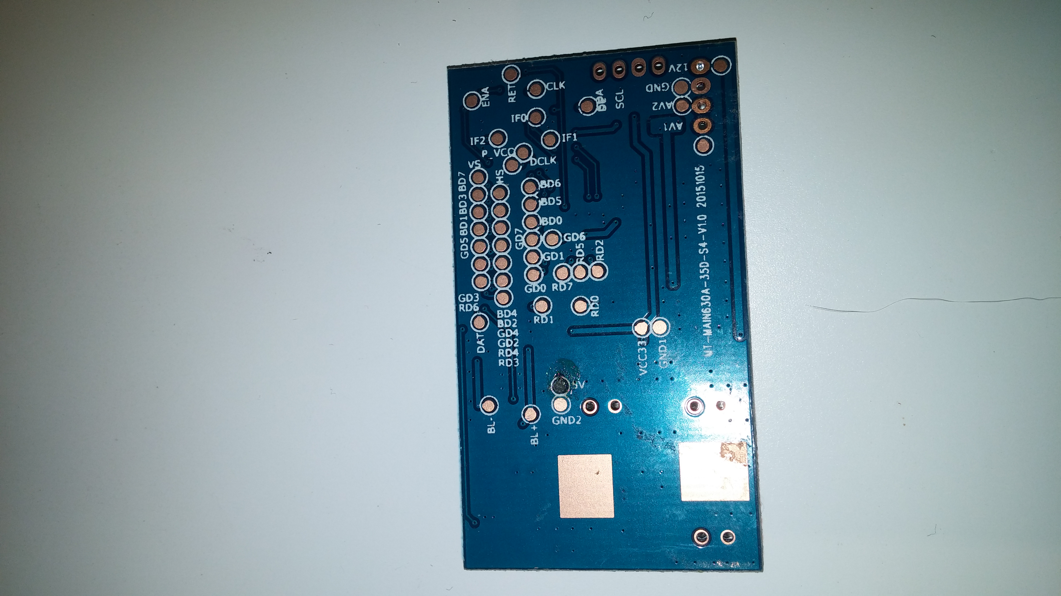

According to the wiki, you have a variant 7 screen.Pirate wrote:Hello everyone I could really use some help I been trying to figure out how to convert this LCD board to 5V but I can't find an answer.
You need to solder a wire from the areas I marked in red:
It could be that it still does NOT work after that. If that is the case, you actualy need to desolder that chip (the one with the marked pin) and solder a wire to the same marked area.
