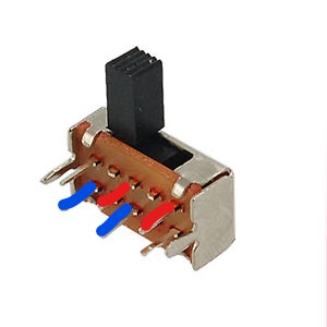

Can someone confirm the pin numbers when I look at my switch this way :

Re: I can't have a graceful shutdown...
Post by Bobrobert » Wed Nov 16, 2016 11:26 am
Pin numbers are not really relevant, the important thing is to wire it like the image below. The colors can be switched and rotated, as long as the pins you use are staggered.
Post by johweb » Wed Nov 16, 2016 11:33 am
Thanks for this clear explanation, it was just to check if I don't do something wrong. Just checking everything once more...
Post by johweb » Wed Nov 16, 2016 12:38 pm
It's working !!!
My wiring seemed OK to me but wasn't... Your picture helped me a lot. Thank you so much !
