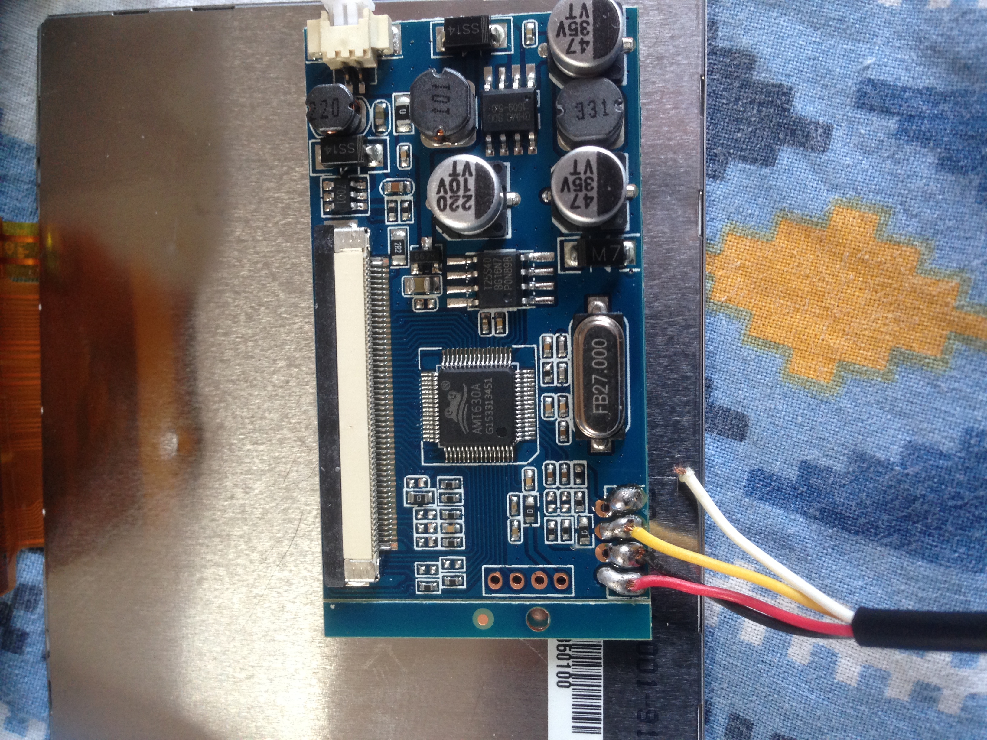

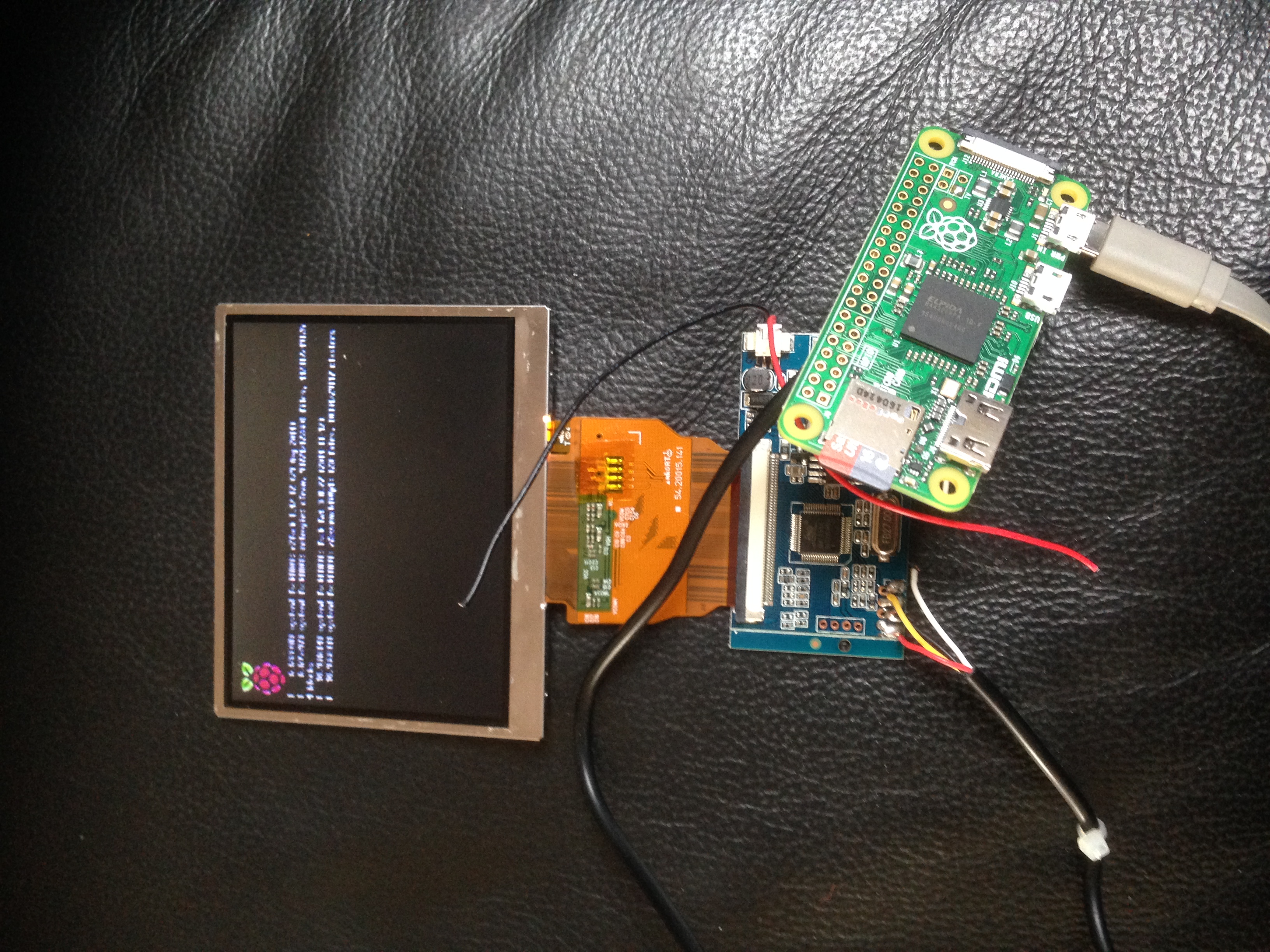

One question :-)
The display works on Network and Pi Zero.
the question is can i put it in without changes ? for bettery using ?
Deadpool: No XP? What a ripoff! :mrgreen:

Re: Newbie questions concerning soldering and cables.
Post by Fleder » Tue Jan 03, 2017 5:31 am
Ra9e wrote:the question is can i put it in without changes ? for bettery using ?
Just try it out. Hook it up to 5volts and see if it turns on.
