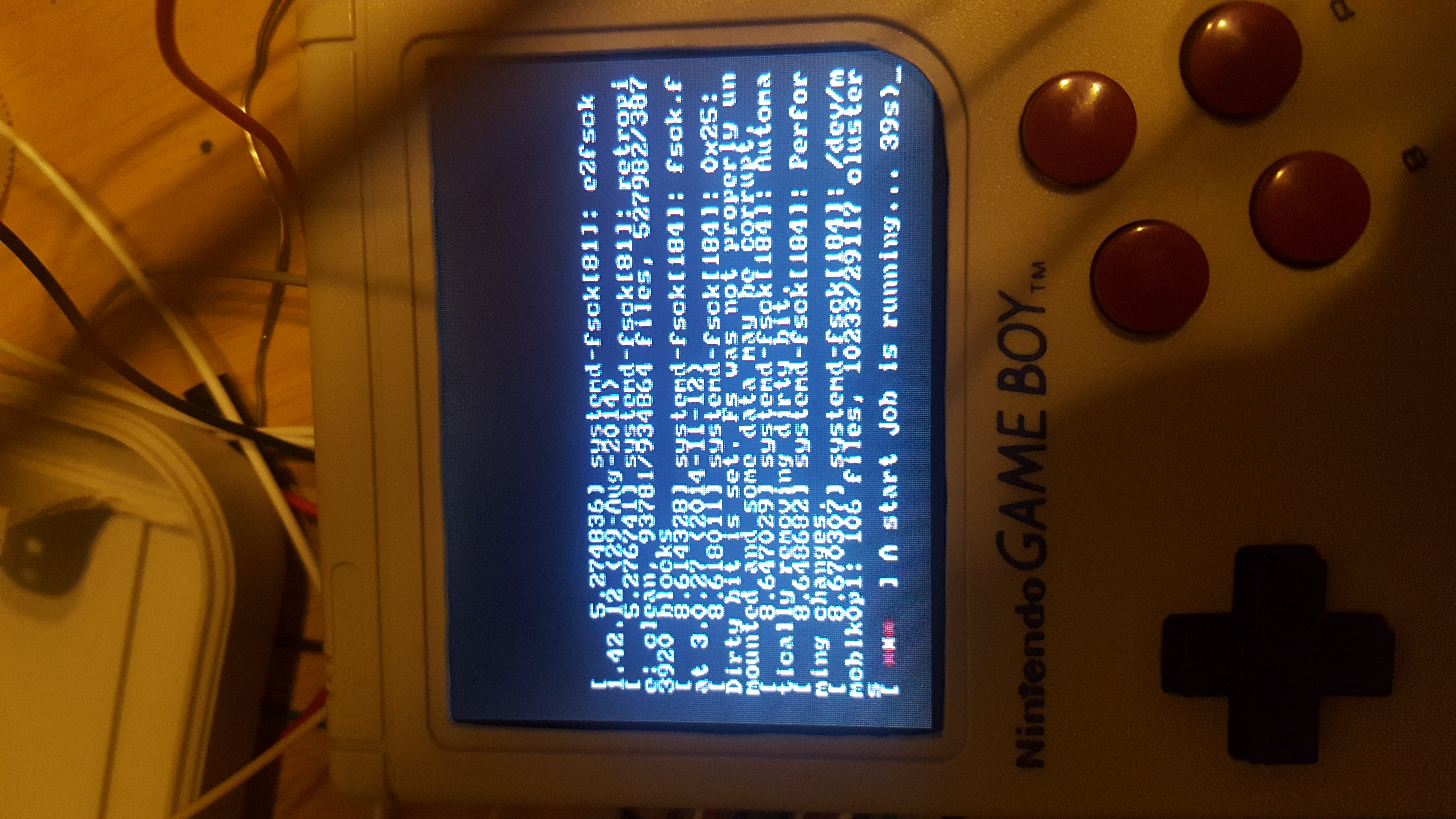

Okay I did that and it worked. Kind of.
I saw that it made the screen bigger and yes there were elements that were off the screen.
But the black border was still around it.
I hope we are talking about the same thing.
By black border I am talking about the pitch black area around the screen. I wanna get rid of that. I don't think it's possible though.
The black/grey part of the screen, where all of the pixles are, is fullly lit up with the picture.

Re: BW Screen full screen??
Here's a picture. Overscan is on. It's those pitch black lines i wanna get rid of but the pixels don't even go that far.Jace055 wrote:A picture would help describe what you are looking to get rid of beyond the overscan.
I know this is an older thread, but I saw you didn't have an answer. You likely already found out, but you can't remove that. I'd suggest getting a screen lens with a bezel to hide it if you don't want to see it.Zacarycaine wrote:Here's a picture. Overscan is on. It's those pitch black lines i wanna get rid of but the pixels don't even go that far.Jace055 wrote:A picture would help describe what you are looking to get rid of beyond the overscan.
