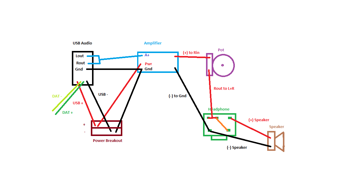

EDIT: Ok guys, finally had some free time so I'm adding the wiring schematic I used in full here. This includes a pot that will control both speaker and headphone volume as well as the addition of the Adafruit amp.

You could have the L+R output from USB to pot L or R, then output that to the headphones. I'd still have the USB ground go straight to the headphone ground. If using an amplifier, I'd put the pot after the mono sound out from the amplifier.

Only thing missing from this is a wiring schematic! I'd like to do this with an amplifier but was confused at that explanation. A visual would be amazing. Thanks for the guide

How would you do stereo with this setup? Also, has anyone managed to connect the volume wheel to this?
Should it be
Audio out -> Volume wheel -> the original PCB with a headphone jack and a speaker connected to it? Or something else?
I'm guessing if using and amplifier it would just go between the original PCB (this small one with the heapdhone jack) and the speaker?

Bump, updated to include a schematic.

Thanks for the schematic, does your speaker cut out when headphone are plugged in and then back to speaker after headphones are removed?
Im using this amp https://www.sparkfun.com/products/11044
I can get the volume working and either the speaker on its own or the headphones on its own but when i connect them all together i cant get both to work. Im sure ive followed your wiring but the only difference is that the volume wheel has its own pins on the amp and the two output pins as well. any ideas?
