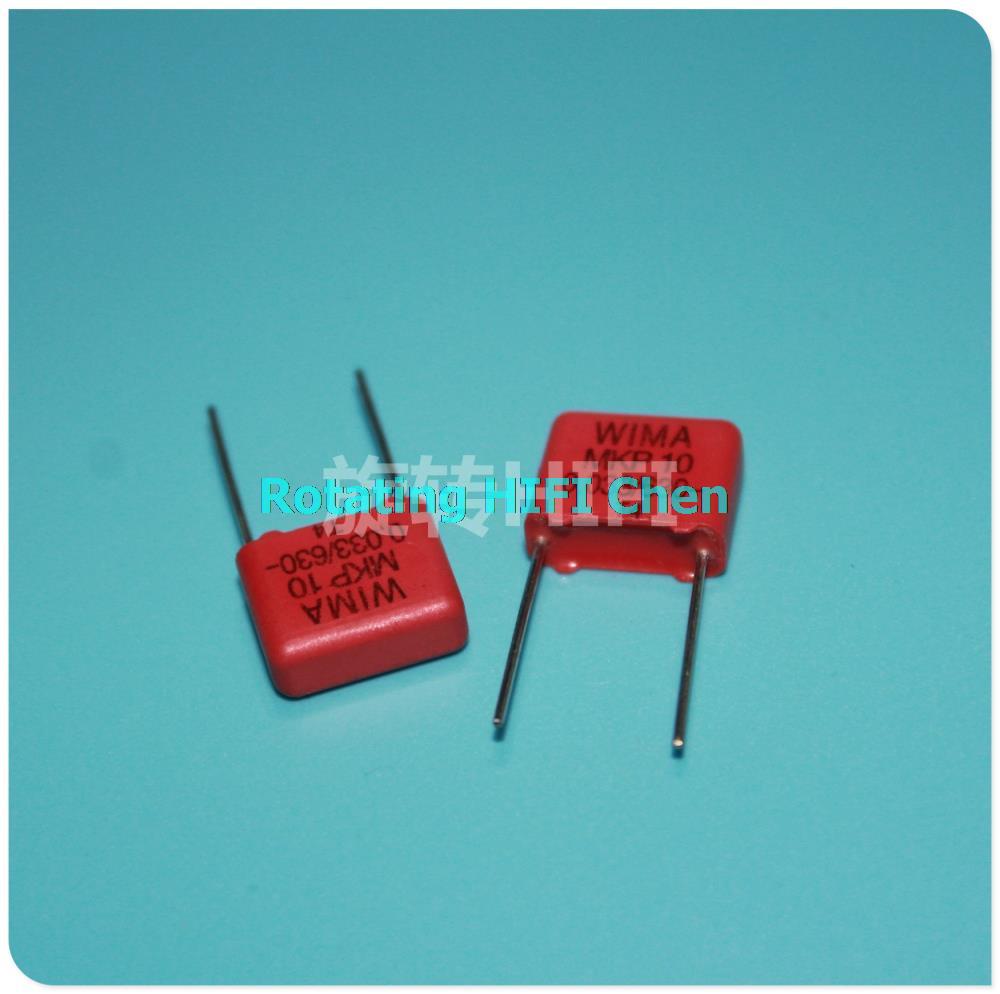

step 1) I used a 1.0uF capacitor as wermy did on his guide
my card reader did not work at all, I put the sd card on the extention and nothing happend, Ive puted the micro sd card on the pi and it did not boot as well!!! :o :o :o The pi does boot again when I desoder the card reader extention with the same micro sd card as before :oops: :oops: :oops:
Step 2) :idea: I change the capacitor and put a 0,33nF instead
The reason why I did so is because I thought that the 1.0uF capacitor might be too big for the system and that voltage could stop flowing
