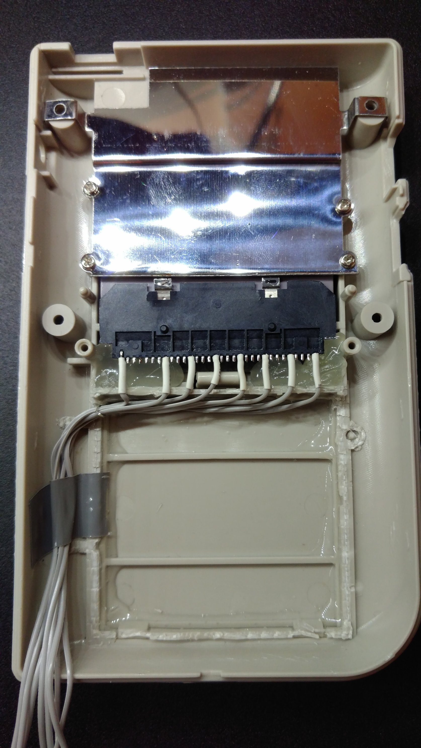

  • Case's insides trimmed to make room for battery and cartridge connector
  • Cartridge connector test fitted and installed (double sided tape and generous amount of hot glue)
  • Battery test fitted. The battery seems to be absolutely PERFECT fit for the case.

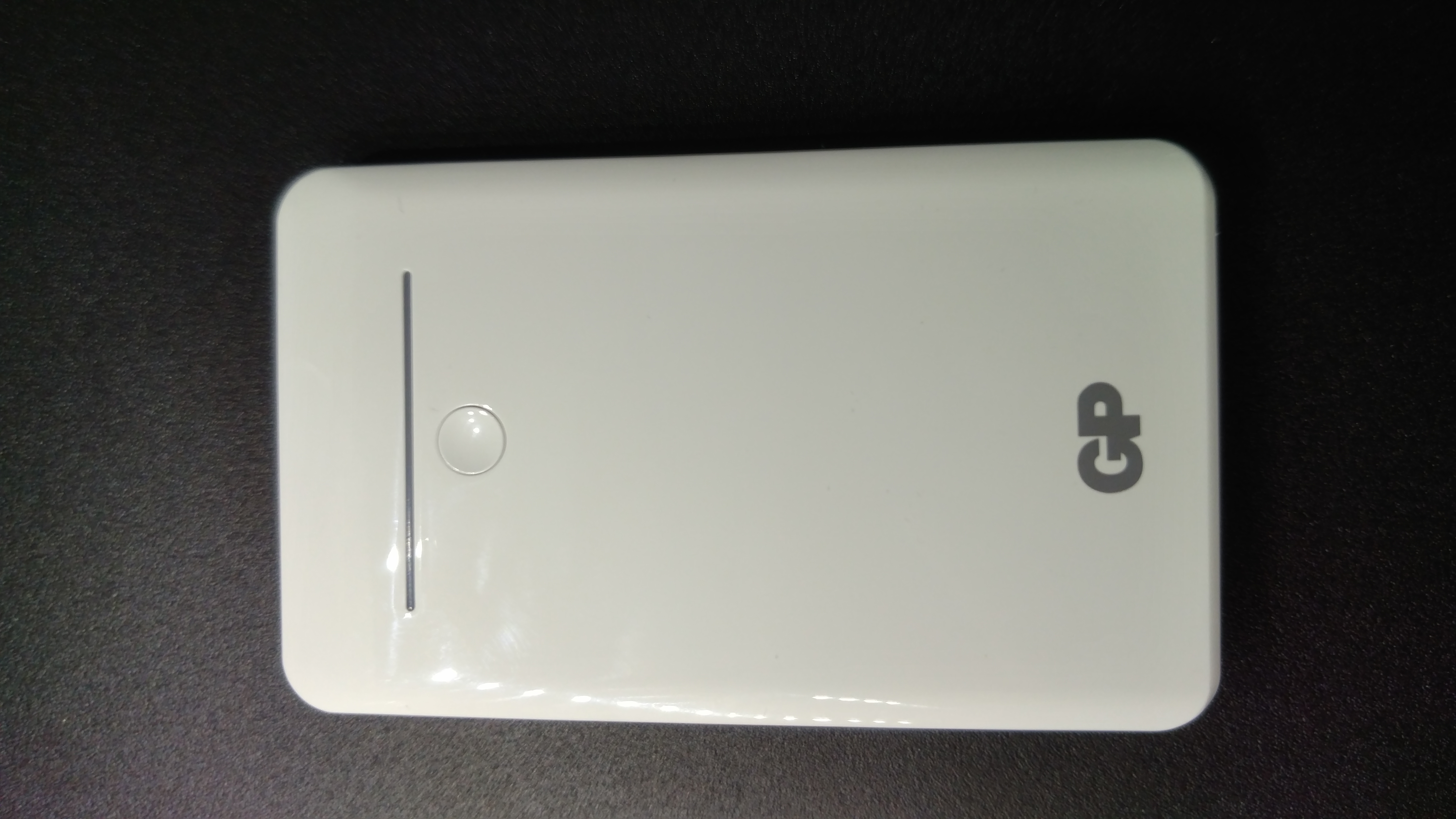

Slow day today, added new leads with connector for the battery.
Got a perfect opportunity to use Kapton tape for the first time :)
Interesting fact about this charge circuit:
Every time I disconnect and reconnect the leads to the battery the circuit/LEDs indicate empty battery and it requires about 3-5 min charging before the gauge shows full again. So it really seems to measure the real state of the battery properly? :) Never seen that happen...

Today's achievement... Soldering leads for the cartridge connector and having fun with some shrink tube :)
Let's hope this works...

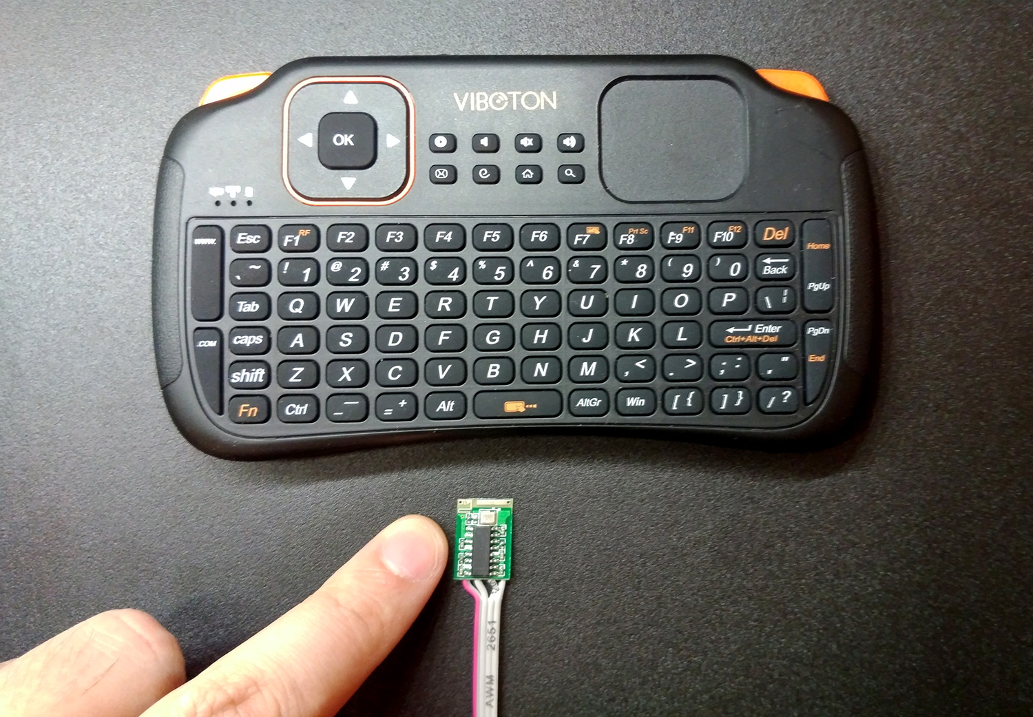

Today was time to strip the keyboard receiver from its restrictive clothes and oh my! That's one tiny receiver right there. It's gonna fit easily inside the GBZ...
Btw, it's Viboton S1, and I'm going to use it only as a keyboard, even though it does have shoulder buttons and d-pad.

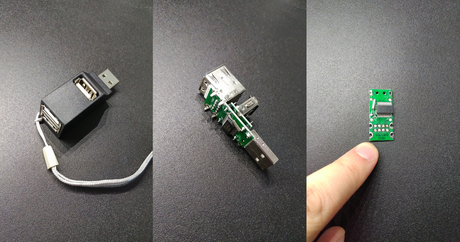

This three port USB hub (that I have tested to be working fully with Raspberry Zero "OTA" port) is getting really tiny after removing the case and all the ports.
Link to the HUB's eBay page: http://www.ebay.com/itm/Mini-3Ports-480 ... Swf05XPCS8 (price is around 2-3€/$)
I bought and tested over 10 adapters (small, without external power) and only two models actually worked with the Raspberry Pi Zero and keyboard, sound card & controller connected... Most of them didn't give enough power through... (And there have been some reports on the whole OTA thing messing power output of the Rasps port, don't really know the specifics)

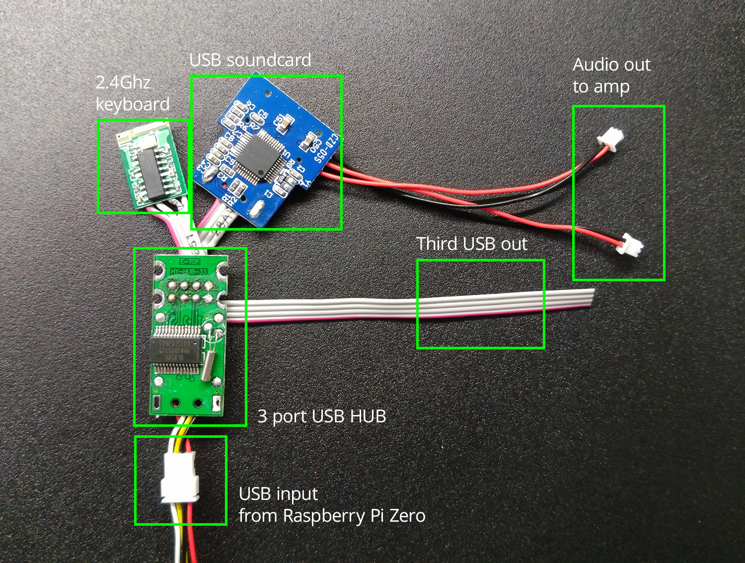

Today was time to connect the USB hub to keyboard receiver and soundcard...
Third USB output is spare at the moment.
A small explanation of the parts:

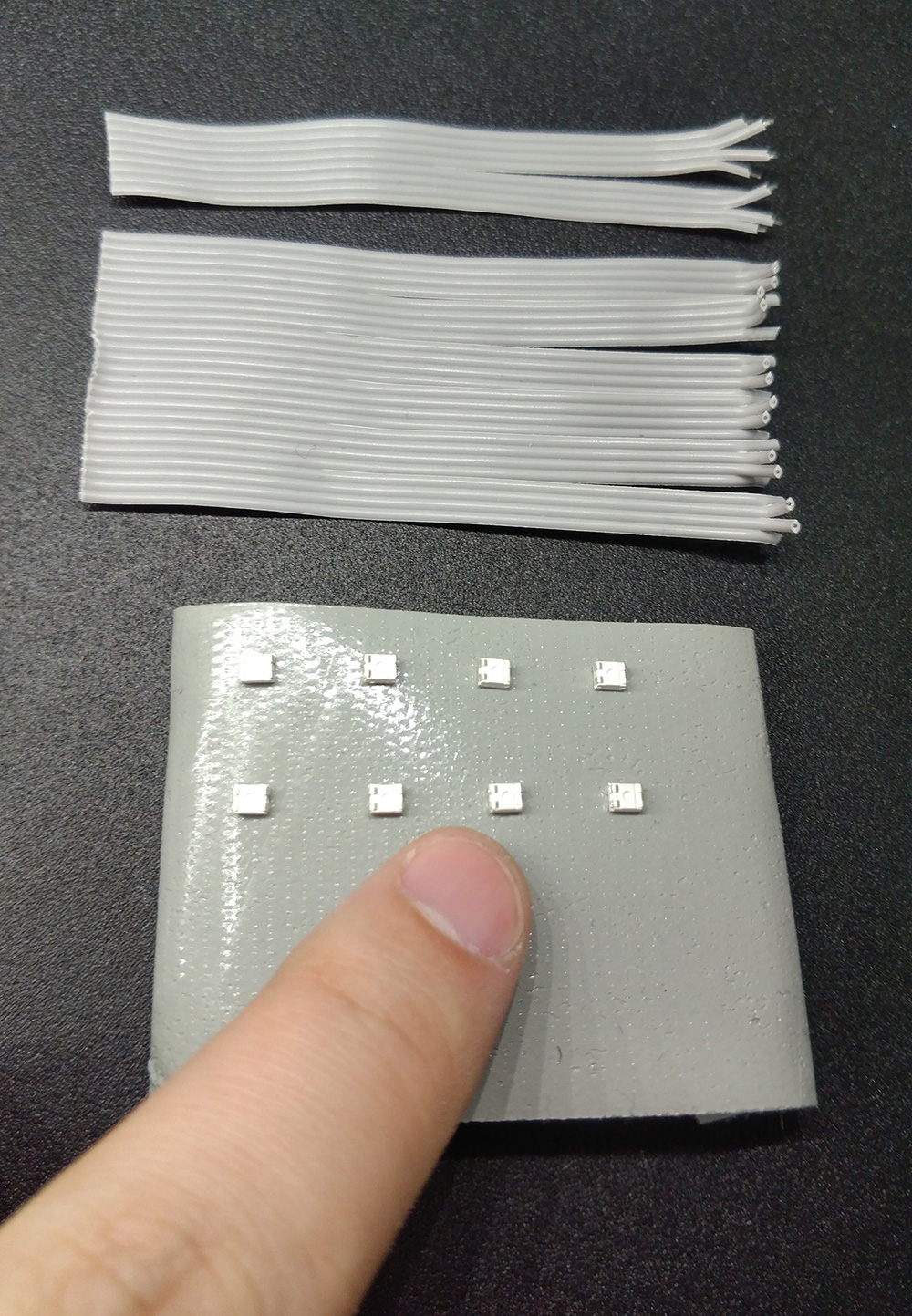

Today I had some time to solder leads for the smd RGB LEDs for the transparent buttons. Actually the soldering was not that hard after all... I was preparing for some really frustrating times.
I think finger is more appropriate size comparison here then banana:
So small!!! Tiny even! Eight pcs in total.

You should record the process, I'd have liked to have seen you solder those.
They look fiddly AF.

Gosh! I bet you have an awesome soldering skill!
That is one tiny LED. You just inspired me to use LED as well, good luck on the rest of the build!
